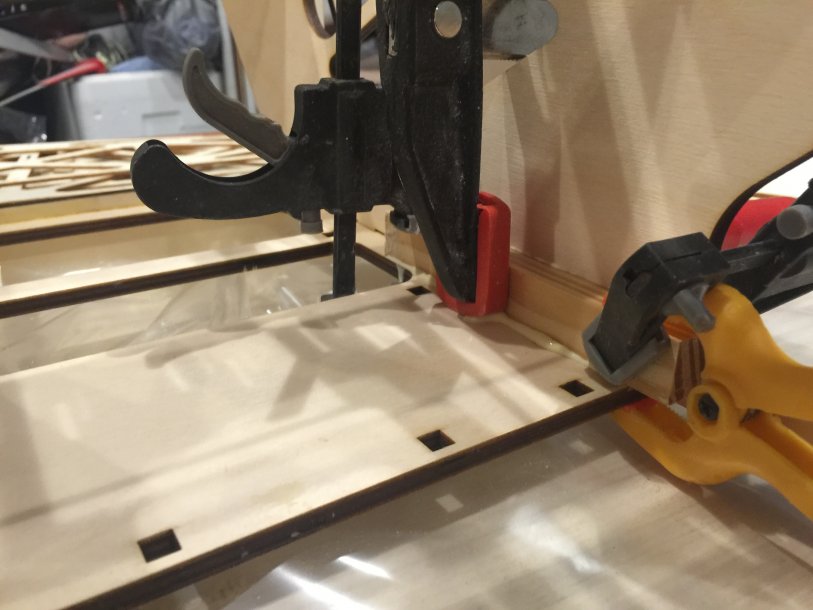

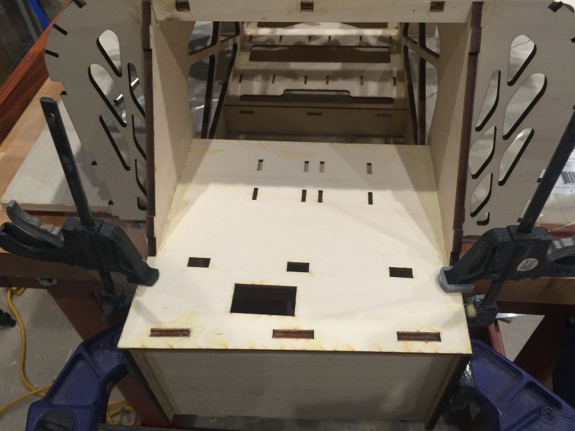

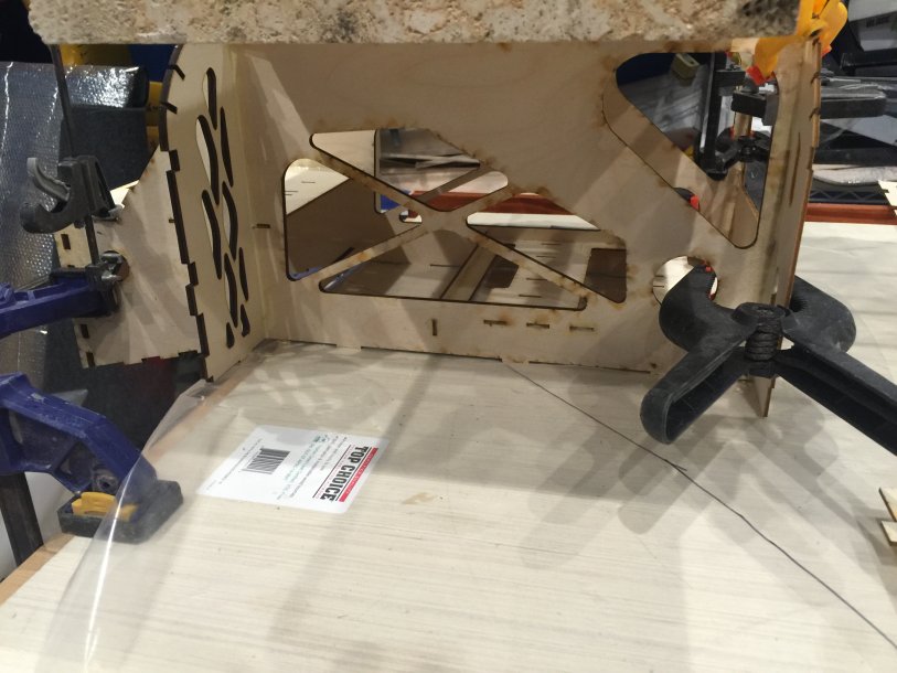

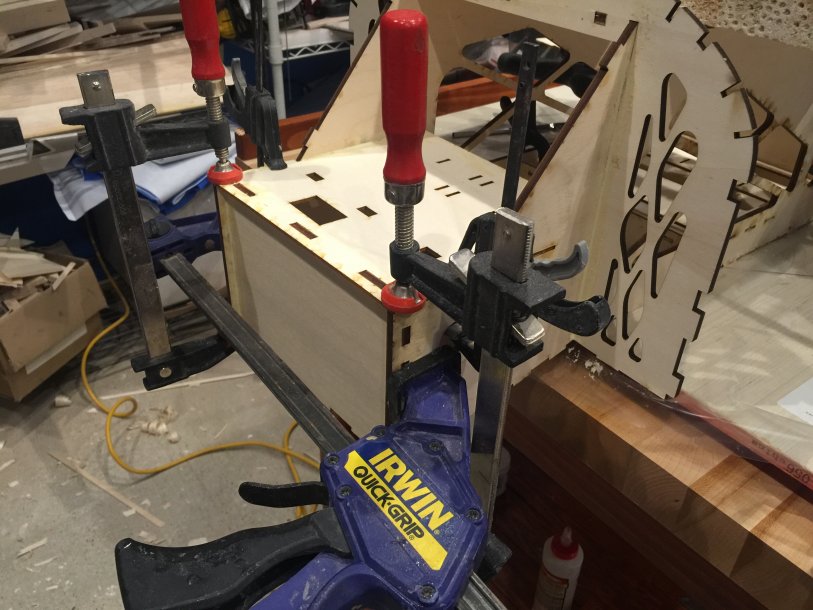

next step, I glue on the left motor box side, and then the gear plate, then glue on F1. Then glue on F2, turn it upside down, and
place your clamps and a weight ...

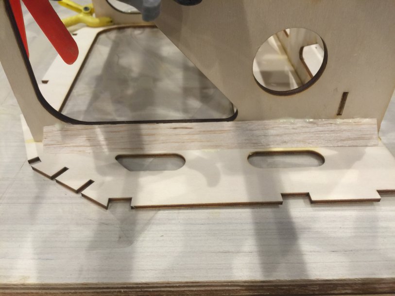

Next step, to glue in the hardwood that joins the gear plate to the inside of the motorbox sides. Once this cures, I will screw in the two aluminum angles, that you drill into from the bottom and are the anchor points for the landing gear.

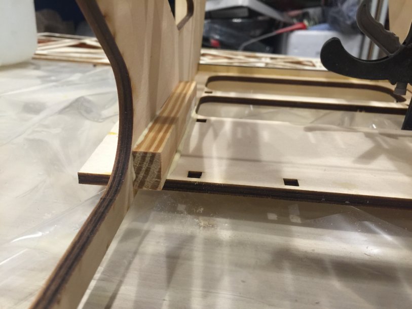

next step, glue on the tri-stock, this will reinforce behind F1 and in the outside of Motor box side, and the other one goes on the front of F2 and again, to outside of MBS.
total build time so far: 1 hour and 20 minutes.
will continue when I return from work.

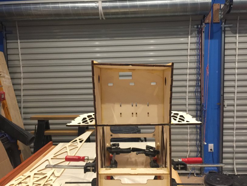

I would like to mention, so far, the motorbox build is identical to the 300 ML manual. I will attempt to point out any deviations or differences and compare to the 300 ML.
