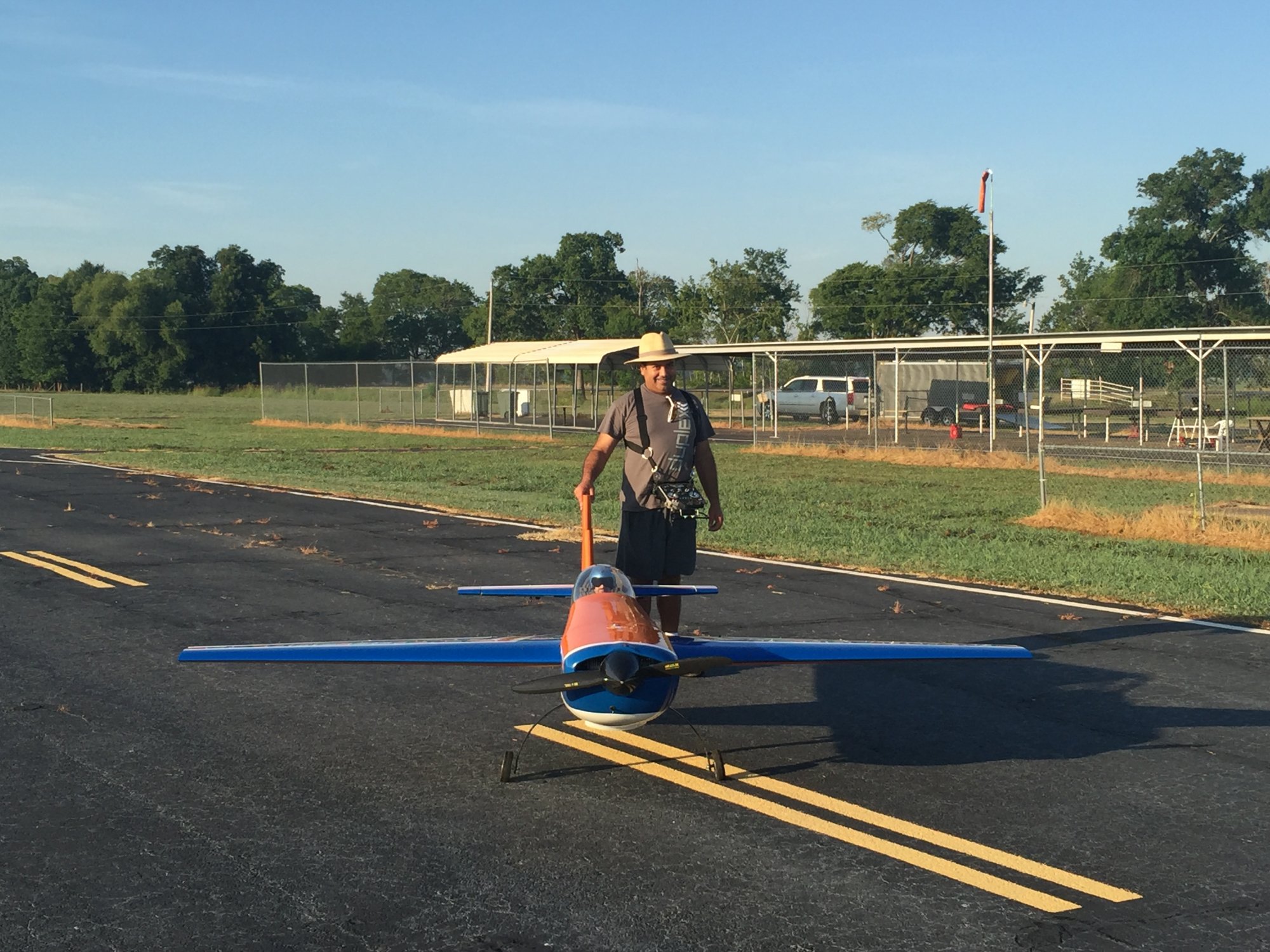

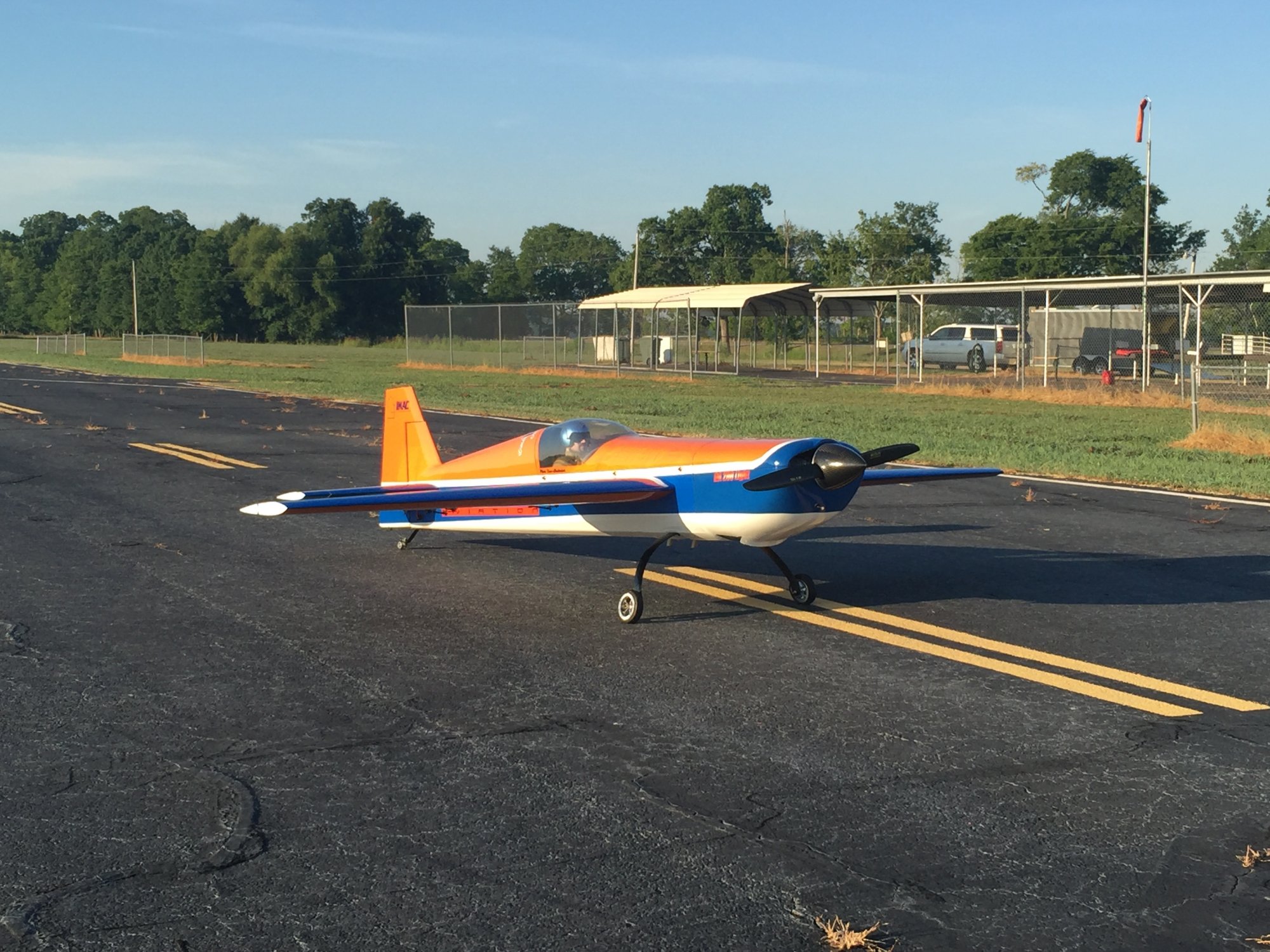

Today's flight report:
Airplane flies very well.
Probably best I have ever flown!
Well, that little issue I was having, where if I cut power down all the way, the nose pitched down, was all due to the down line mix.
this airplane does not need a down line mix.
Once I removed the down line mix, now it is awesome!!
Lessons learned.
She now has 6 flights. Time to burn gas and break that motor in!
