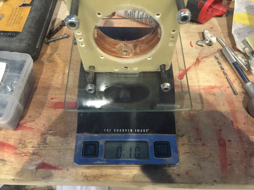

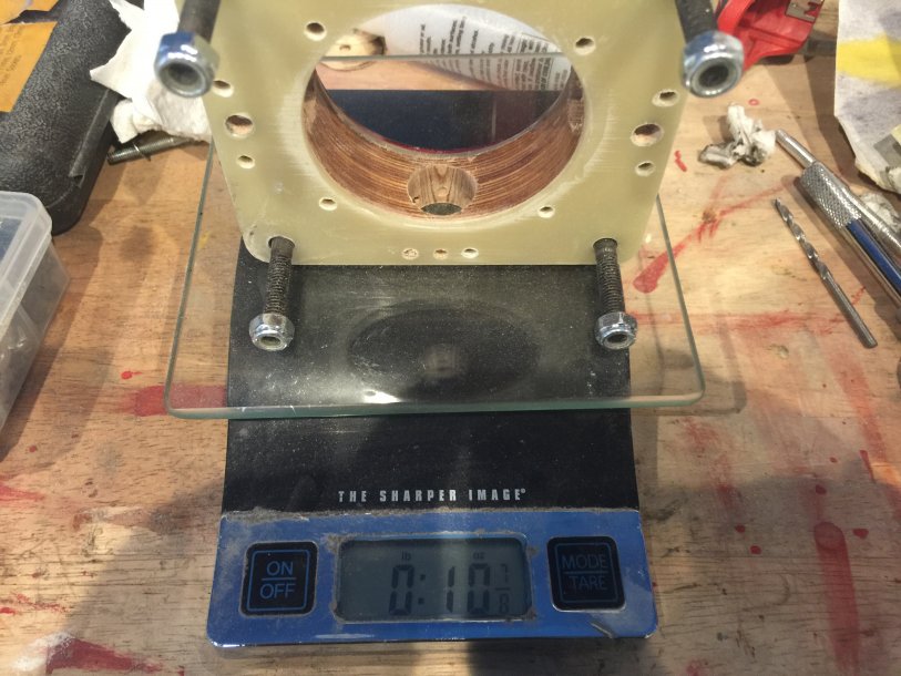

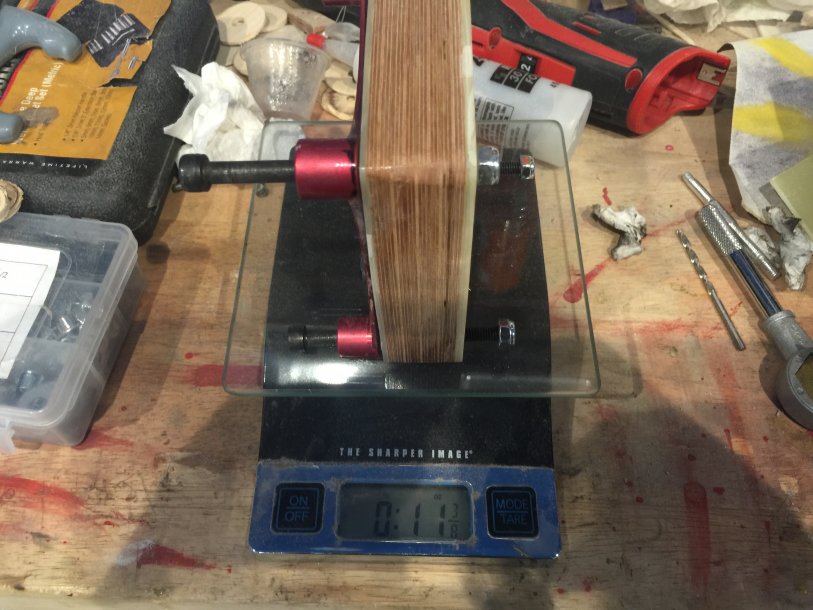

Mine, will have the 200 L, which weighs 9 pounds and 15 ounces, and with two sets of canisters and headers and the mounts, it adds an additional 2 pounds. SO that will be around 12 pounds or so, in that alone. (motor + canister + header). being that I need a motor mount extension, I want to make that as light as possible. Here is the original mount I made...
this one weighs 11 ounces and 3/8.
What I did is cut out holes on the sides of it, and was able to shed over 1 once off....
this is after making 4 holes, one on each side... 10 and 7/8 ounce.
this is after there are now 3 holes on each side, total of 12 holes cut out...
10 ounces even.

I want to add, I have ordered titanium bolts, 6 mm by 75 mm for the motor mount. This will replace the current stainless steel SCHS. BY doing so, the weight reduction will be 1/2 of the original weight. The 4 titanium bolts, + washers + the nuts, was about 110 dollars. I know, sounds crazy, but I would really like to build a model that weighs under 42 pounds. It is my dream!!

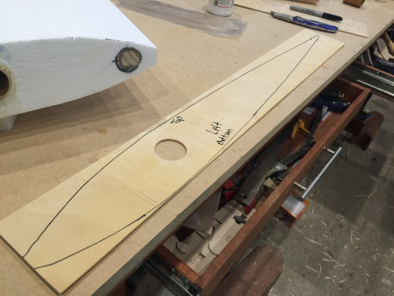

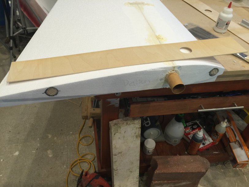

after the phenolic cured, I obtained the plywood root cap, and cut off the excess phenolic.
once I sanded it level with the root cap, then I placed the wing over the root cap, and delineated the border.
Once delineated, then I was able to trim it...
Now, I have attached the root cap to the wing, and waiting for this to cure. Then I will do the other wing, and then maybe, I can sheet one wing tonight.
