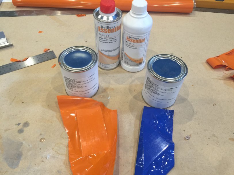

SO far, I am not so happy, i left the paint store feeling like I will not be able to sit down for a few hours. What you see cost me about 160 dollars!
I brought them two samples of the colors, which were already adhered to a block of balsa, as I wanted them, to be able to match it as well as possible.
I have heard, from others, that this system can sometimes not be a good match.
In any event, I am taking a huge risk.
SO, i waited 30 minutes, and left with the paint. That part, was good.
This paint is a 3 part paint, and it dries fast. It is a poly-urethane based paint, and it is mixed at a ratio of 6:1:1
They claim it is very strong and durable. In any event, once I got the paint, and they told me how much I owed them (my mouth dropped), i then stated, "you sure this will match?"
They replied yes!
I told them I will be back!
In any event, If i had gone with Nate, the total cost for me for the paint would be under 60 dollars.

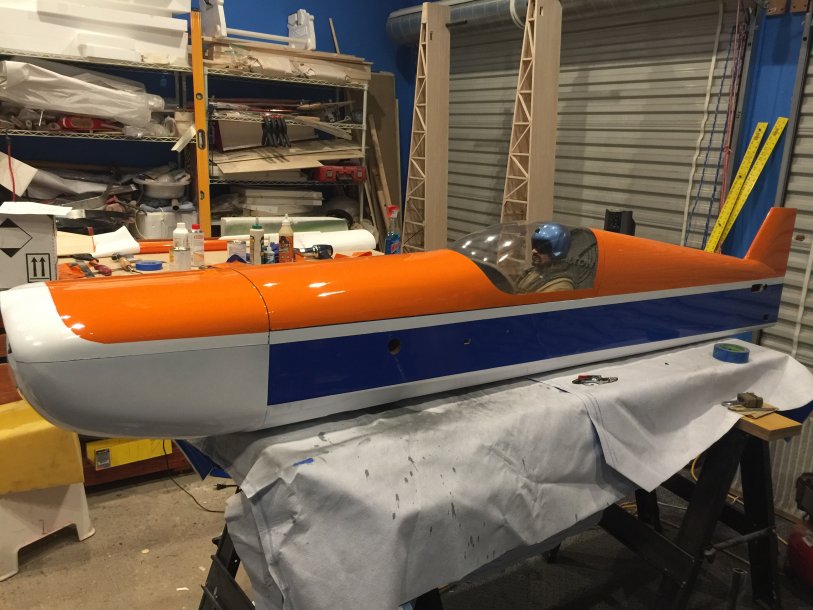

Oh man!! I am stoked! This paint is awesome! Sprays much better than the other paint I have used in the past. Sorry KK.

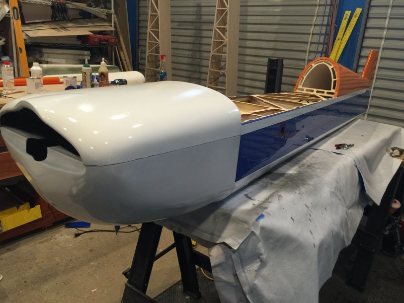

Check this out....
It is called a single stage paint, meaning, mix all 3, and apply two coats, and you are done. The 1st coat is light, and the second one is medium. No buffing or clear coat required. Less likely to run as well. No solvent pops either!
I am sure the outside temp being 90 F helps big time.
The time to touching it and no stick was 45 minutes. AT 30 minutes, i removed the tape.

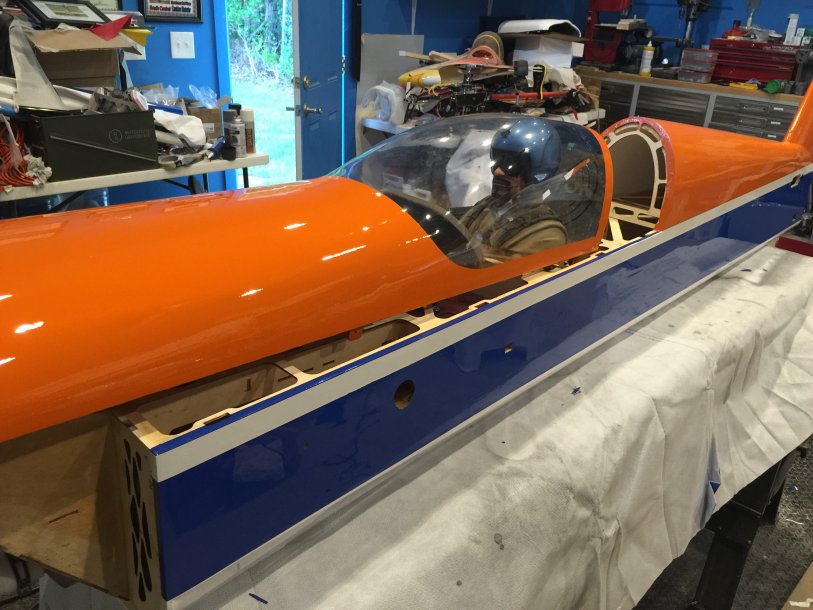

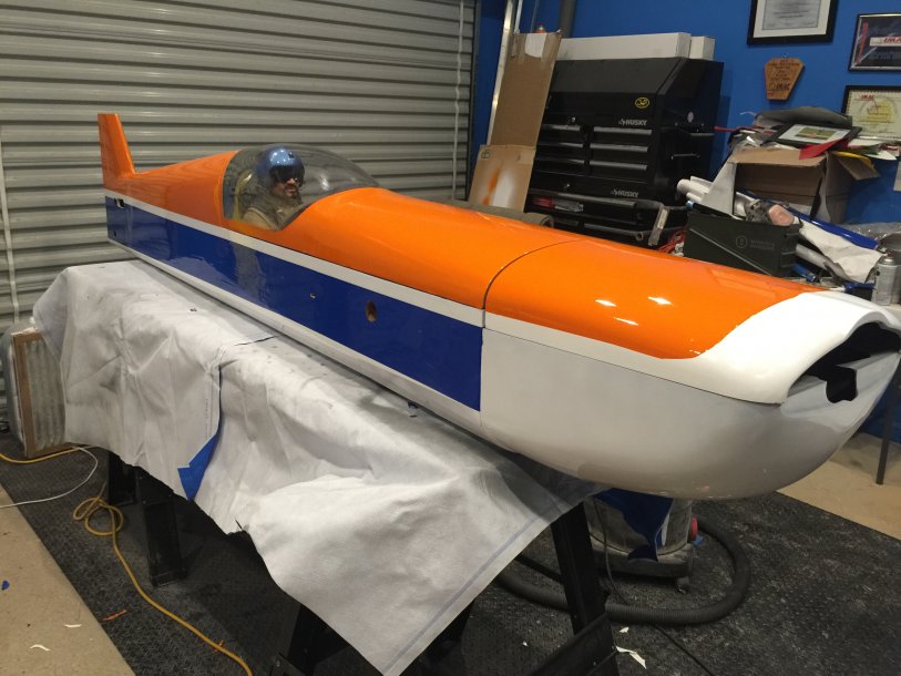

I have already painted the top cowl orange. This was just placed so I can mark out where to cover the white.
The front edge of the top cowl will be blue.
I will finish off the blue tomorrow.
I am also impressed by the Orange matching the Monokote pretty darn good too!

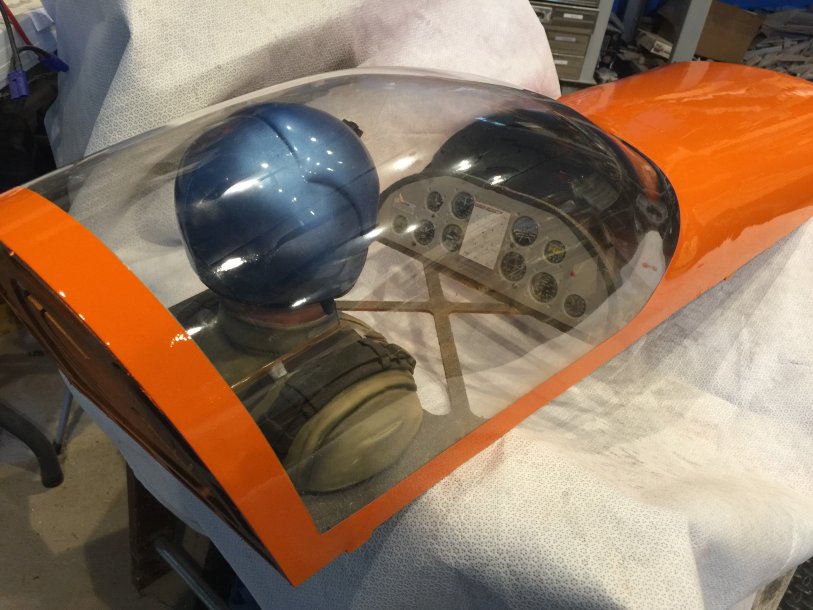

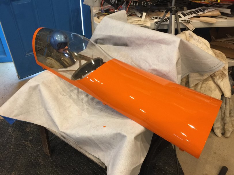

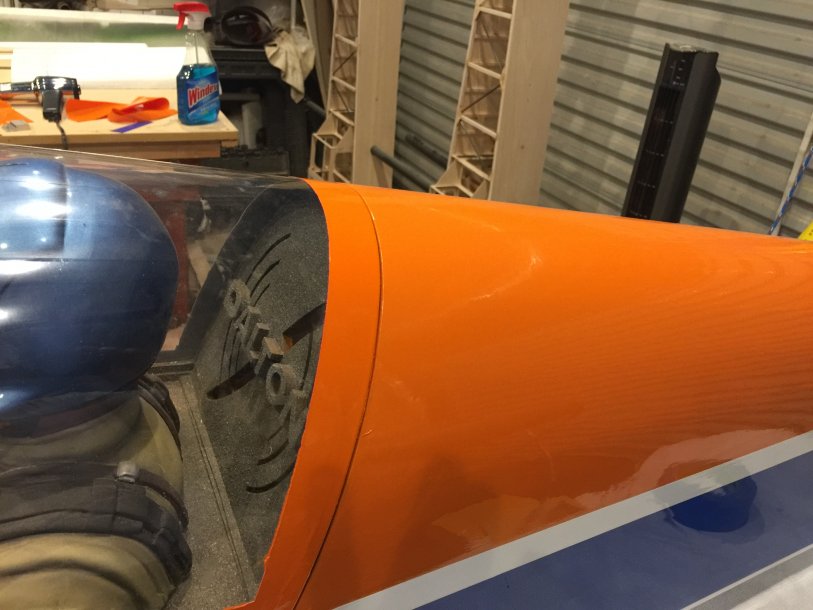

Just went and pulled the tape from the top cowl, after spraying the orange over the white.
Here is the match of the orange paint with the orange Monokote,
I would say it is a near perfect match. These guys did a good job at the old English Auto Paint store.
Tomorrow, I will finish off the blue.
