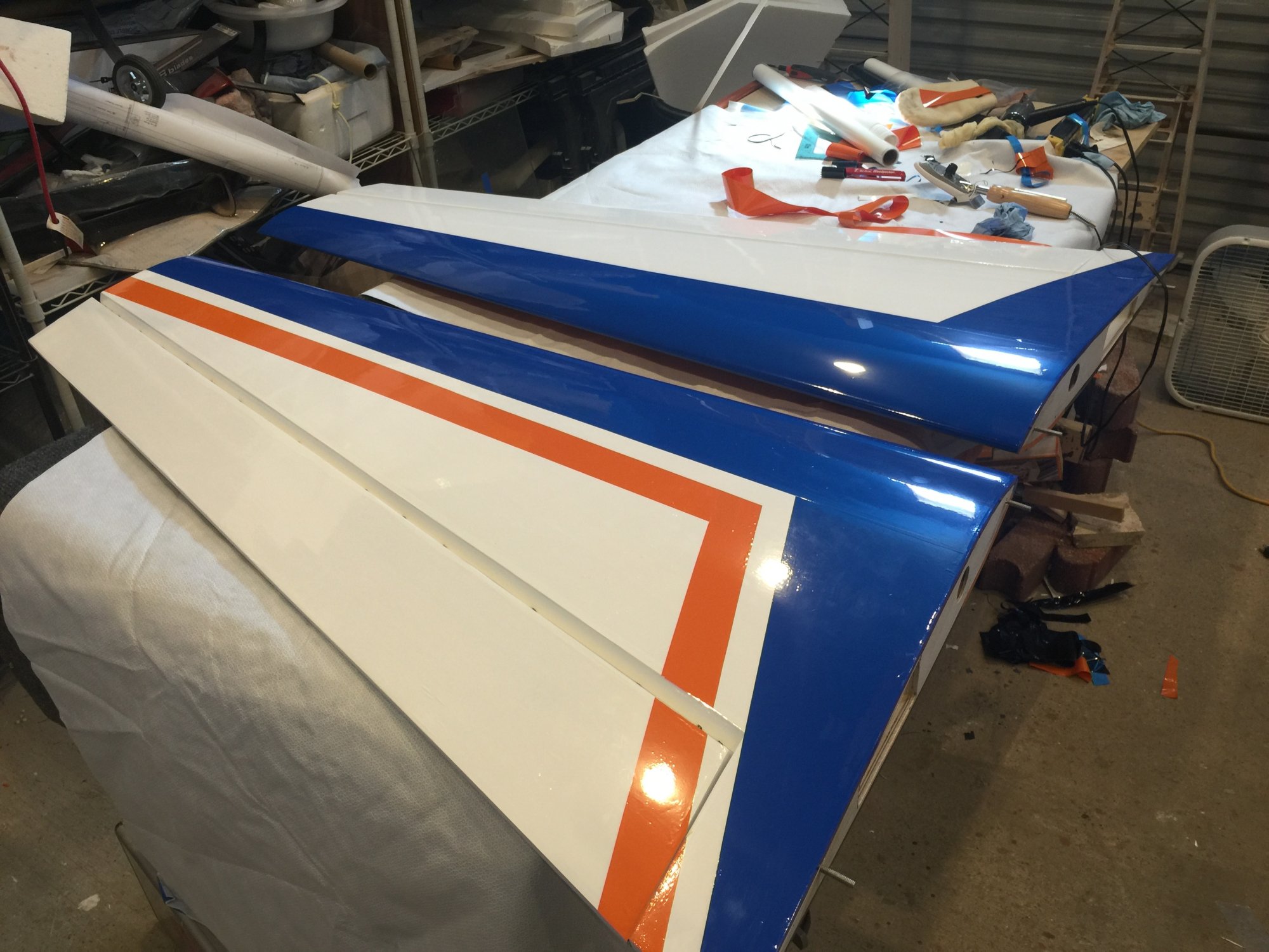

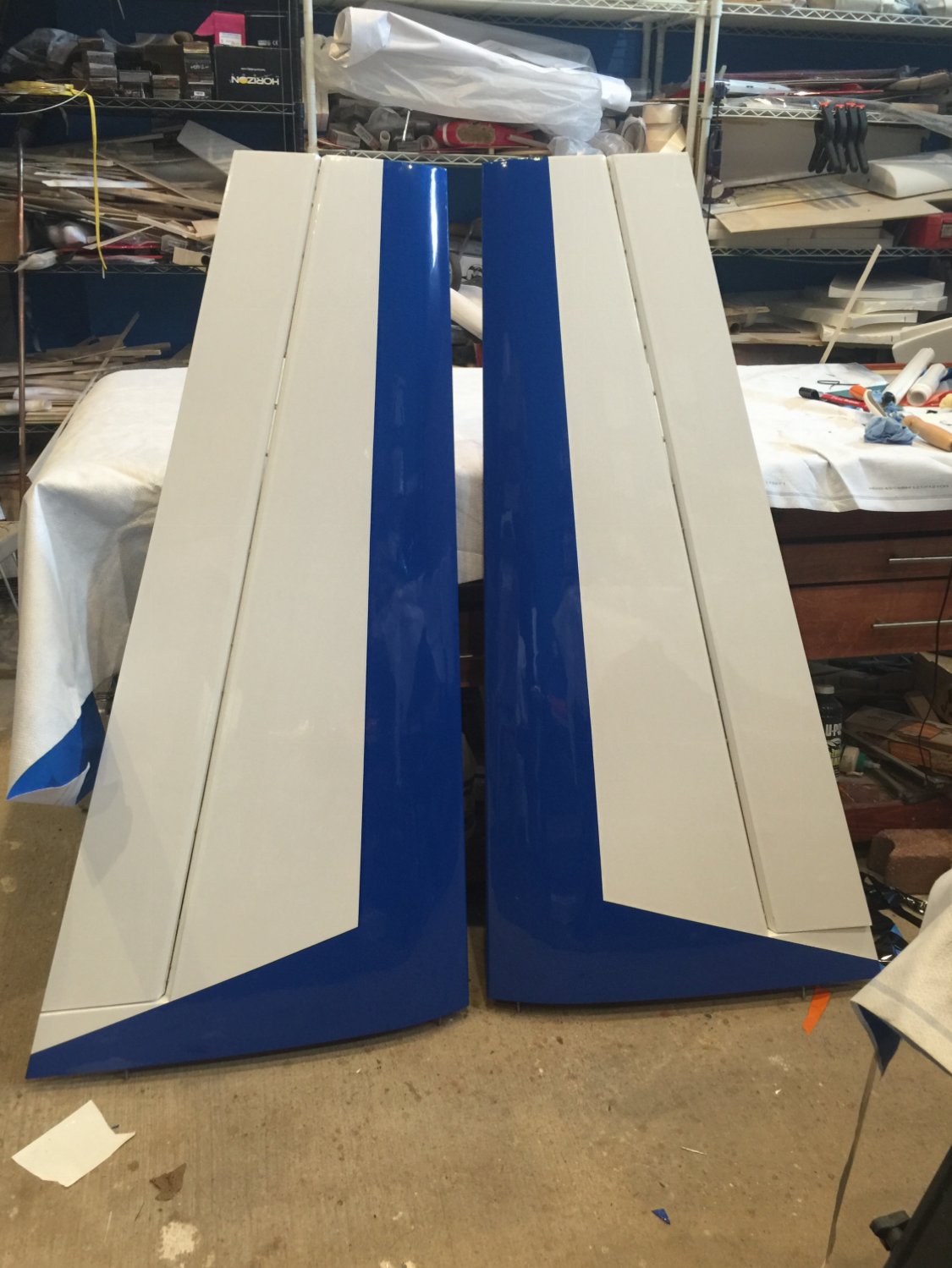

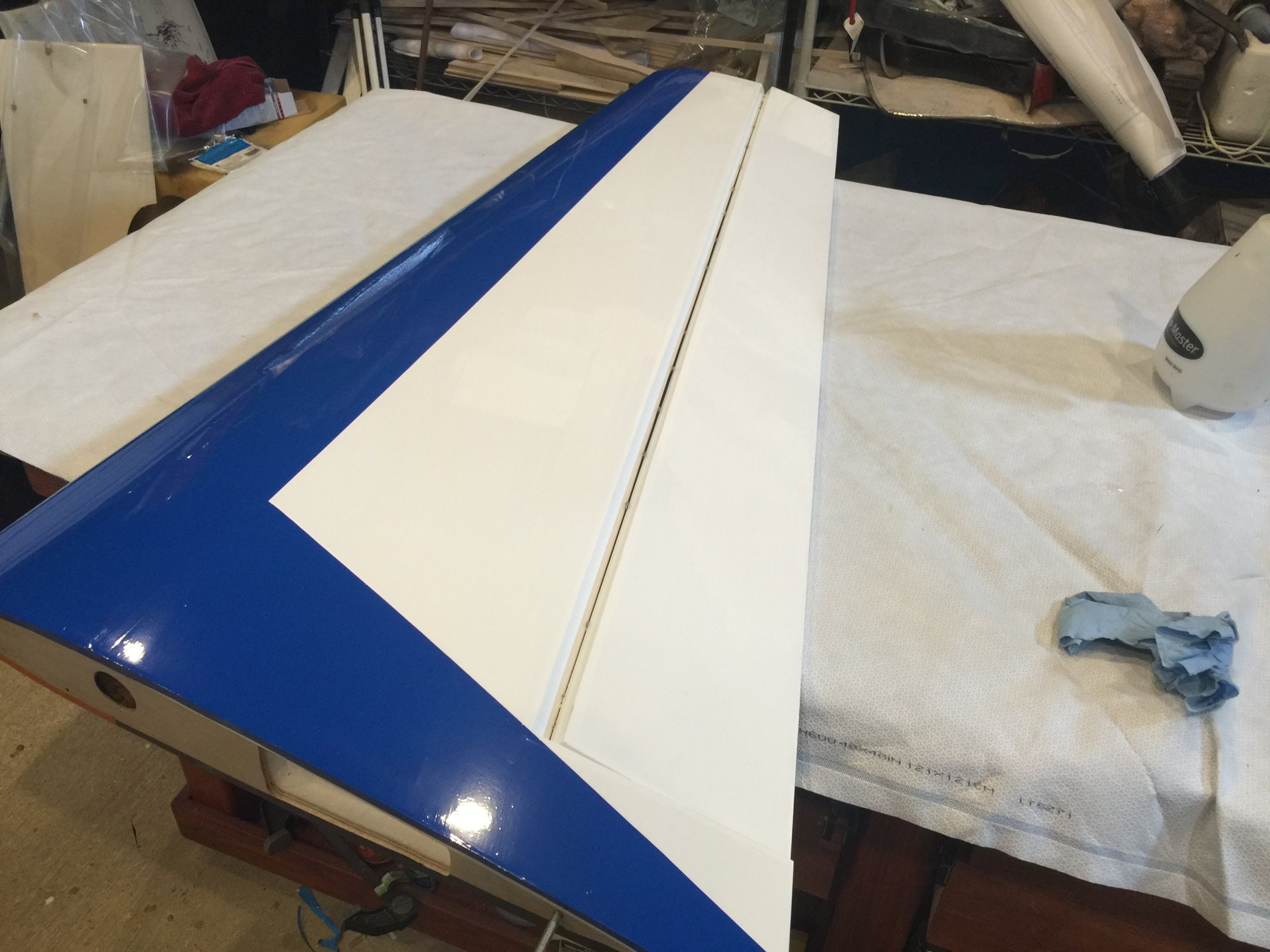

Ok, here are the pictures, what I have done so far. I came back in to get a glass of water and stay hydrated.
With the outside temp in upper 90's. inside the shop, the temp is about 79 degrees F. AC is blowing full power.
I laid down the white first, working from rear to front, then I laid down the blue...
following this, I then floated the other blue piece over ammonia diluted in water, over the white, this is near the root.
This will have a chemical reaction resulting in a bond, without using heat. I had to squeegee all the fluid out between the two layers of monokote.

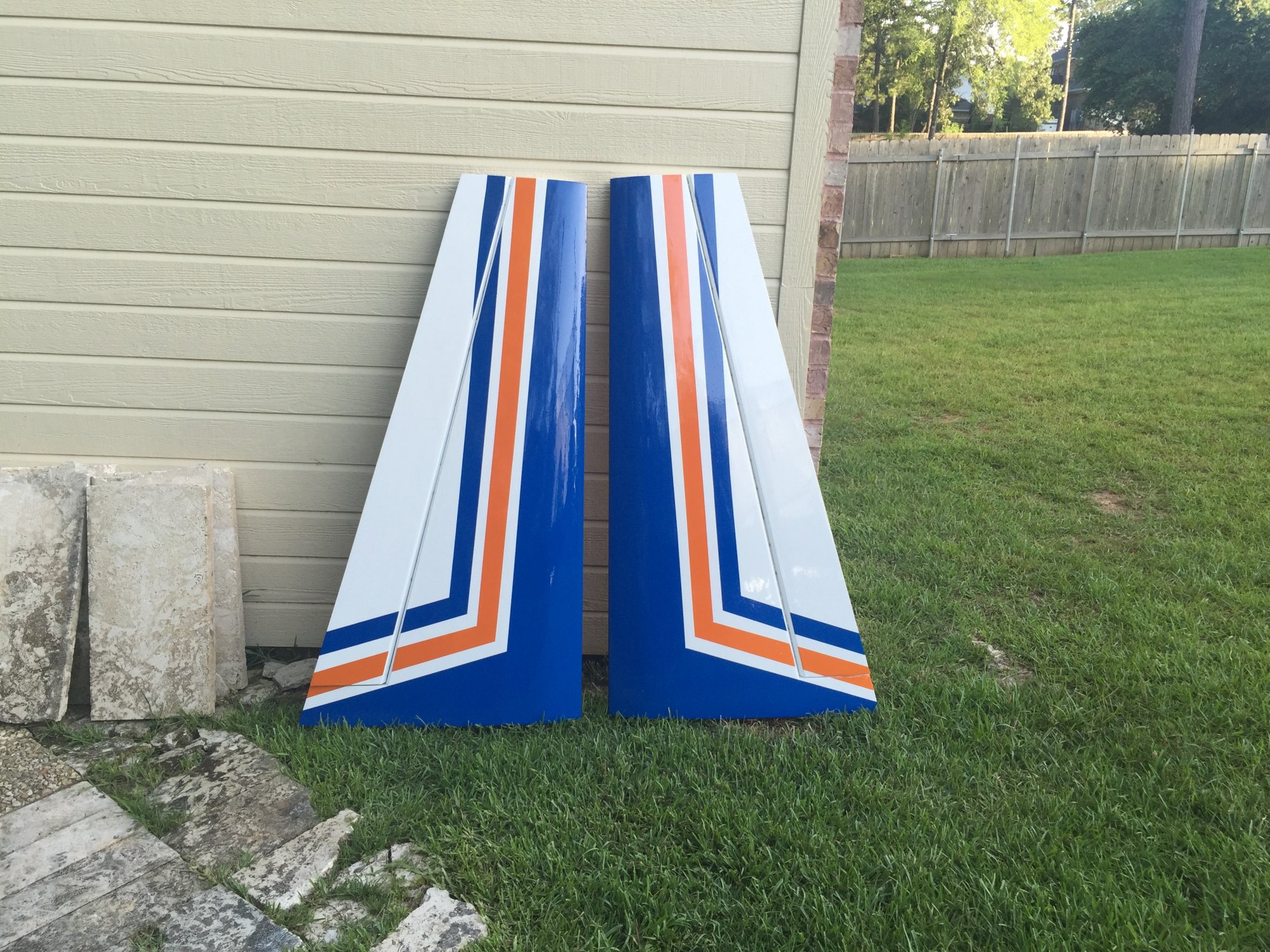

here are both wings....
I started to work on the orange stripe, again, this is floated on over ammonia diluted in water.
In a little while, I will be back to finish them off, then I can install the servos and control horns.....

Su, using the ammonia water, you don't need heat to bond the coating? Very cool.
And glad to hear you are out of the hospital and back to the hobby... Just take it easy in this heat. I hear that blood thinners can zap your energy pretty quickly.
Sent from my XT1080 using Tapatalk
Hi Mike, yes, that is right. I learned this from Tom Wheeler. Only with Monokote, i believe. If you use Ultracote, and you want to lay Ultracote over any other covering, then you need to use soapy water. You can lay Monokote over Monokote or Ultracote, but use ammonia water.
tomorrow, I will zap it with very low heat on the iron.
