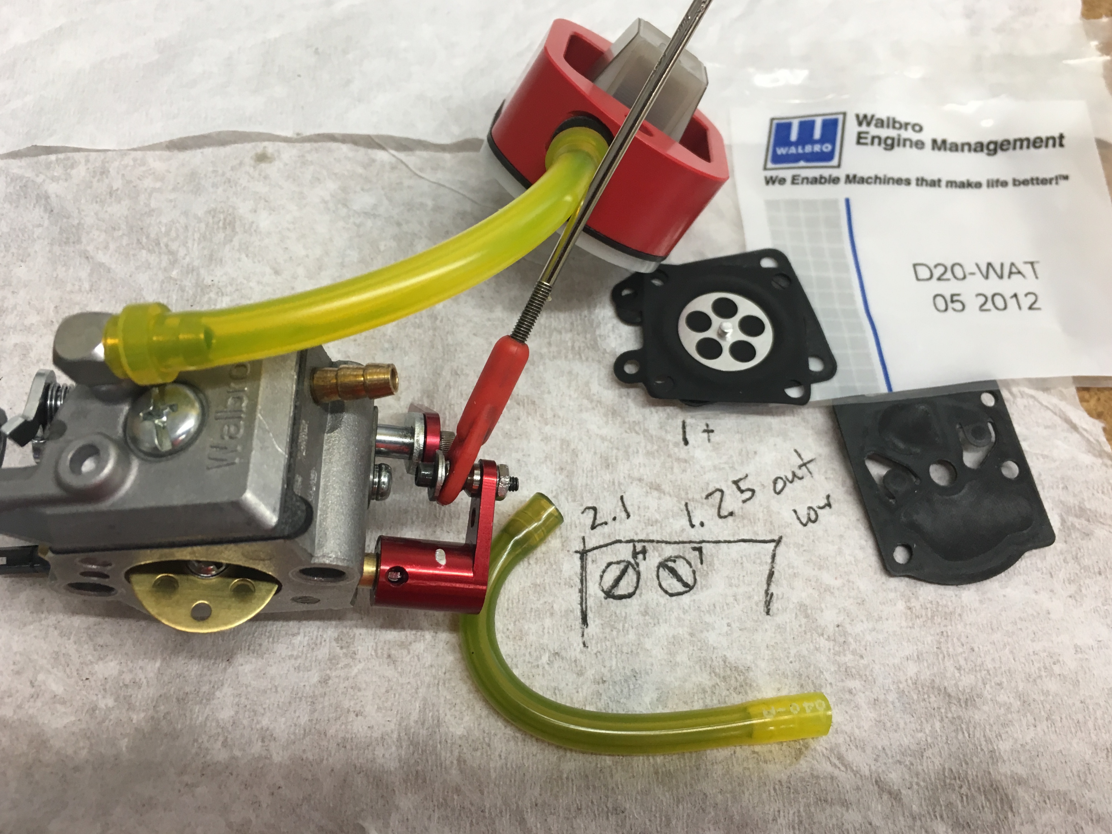

Decided it was time. DA-35. Walbro D20-WAT gasket kit. Cleaned the needles, screen, and plunger. Replaced the pulse line. Saw one of four reeds was floating a little high, so I flipped it around.
Should be good to go!

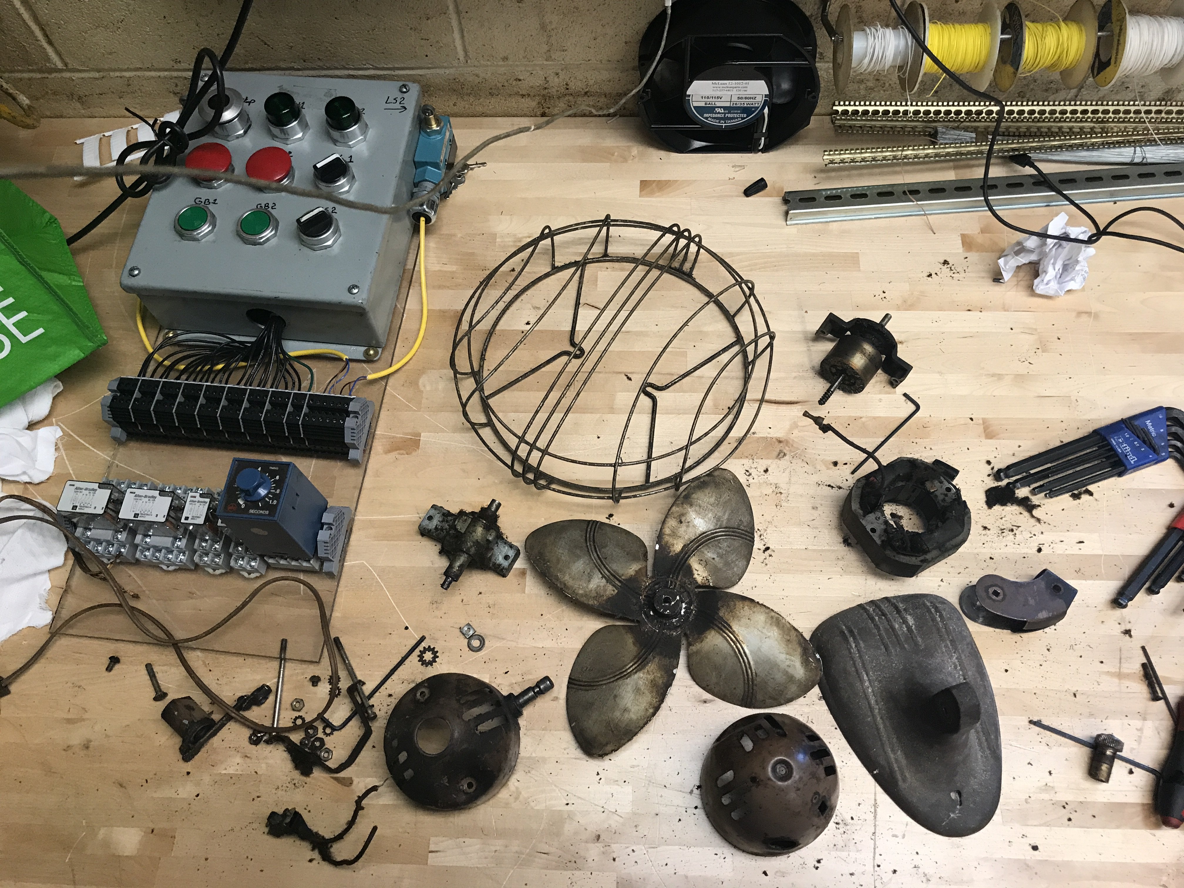

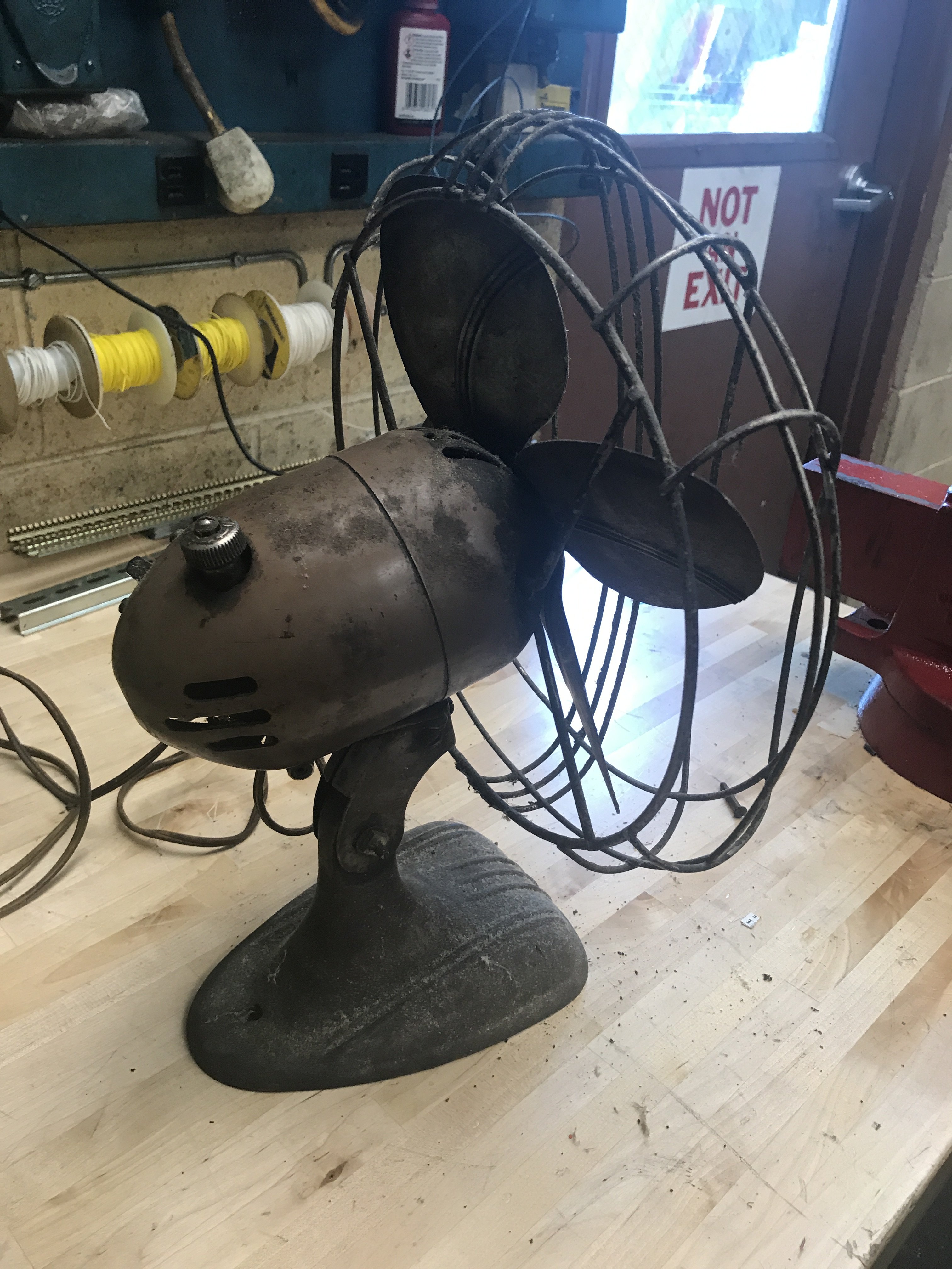

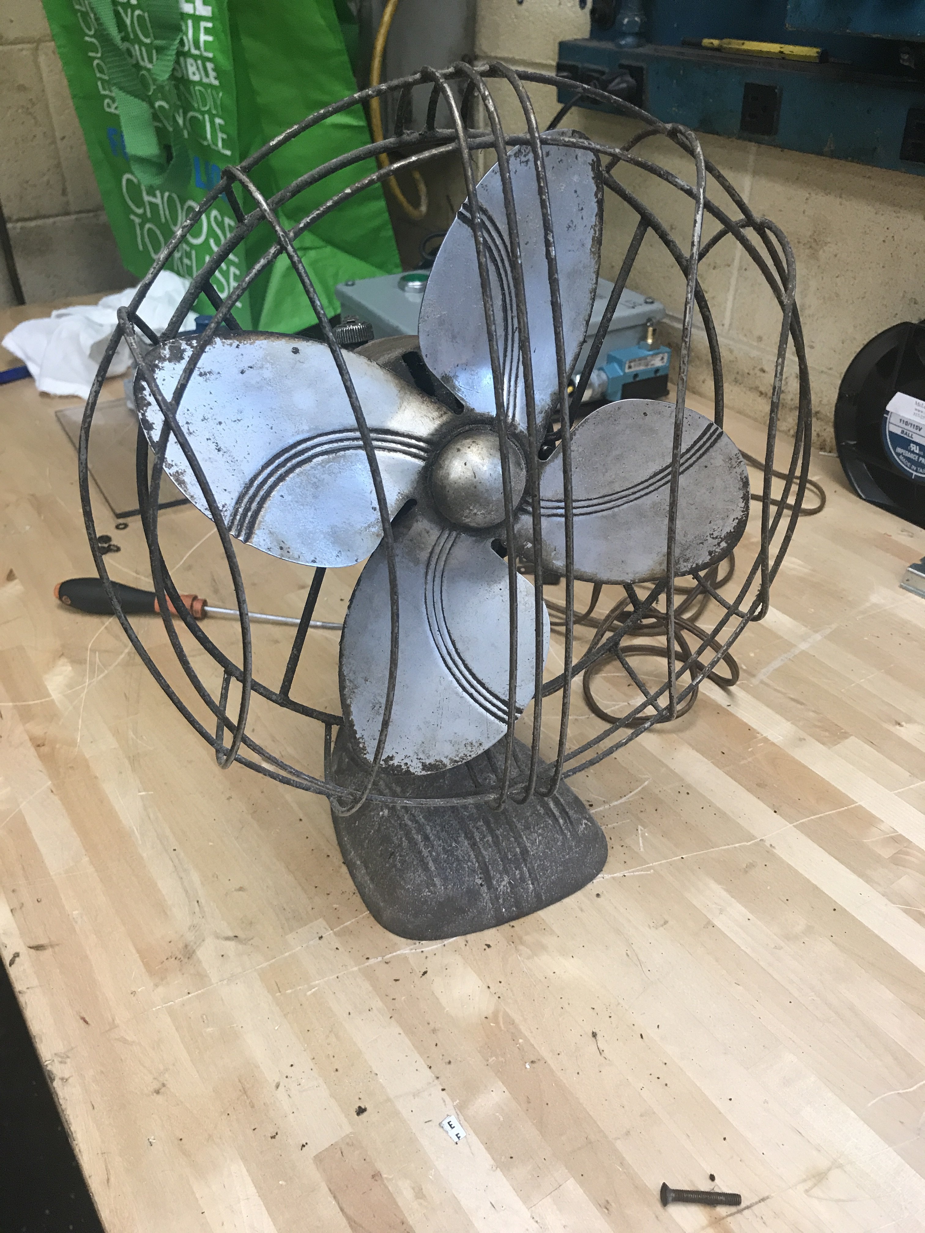

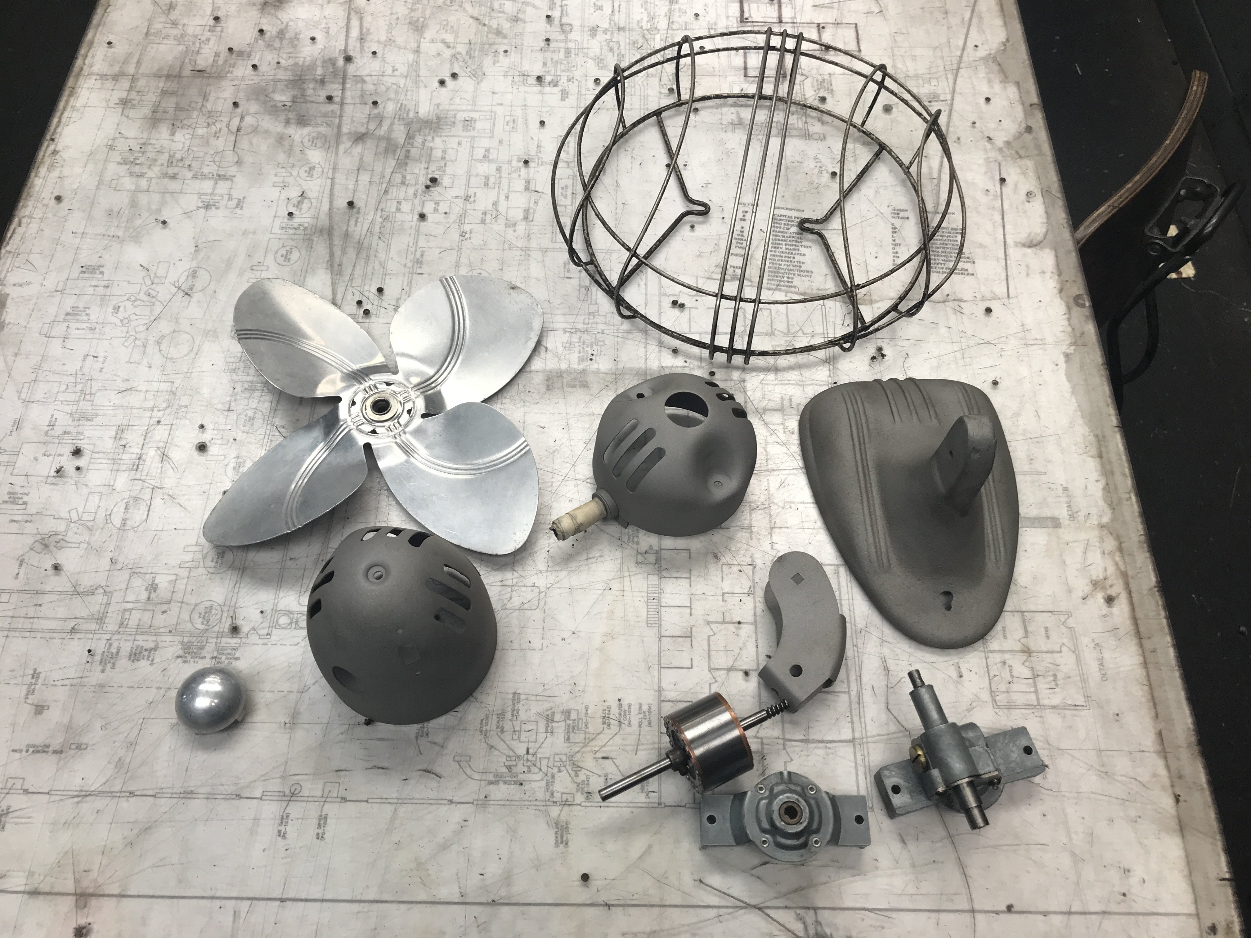

The outer casing parts that where all painted and will get repainted got put in the sandblaster. All internal parts where put in a heated parts washer and some red Scotch brite pads used on stubborn stuff. The fan blade and blade guard are aluminum and I plan to polish them up really nice so I let them soak in parts washer longer and used a plastic bristle brush to scrub with as I didn’t want more scratches that would be harder to polish out. Gaurd still needs more work though.
Plan is to paint it black with white accents.
Thing that annoys me the most is there are no markings at all anywhere on it and I would really like to know who the manufacturer of it was.
