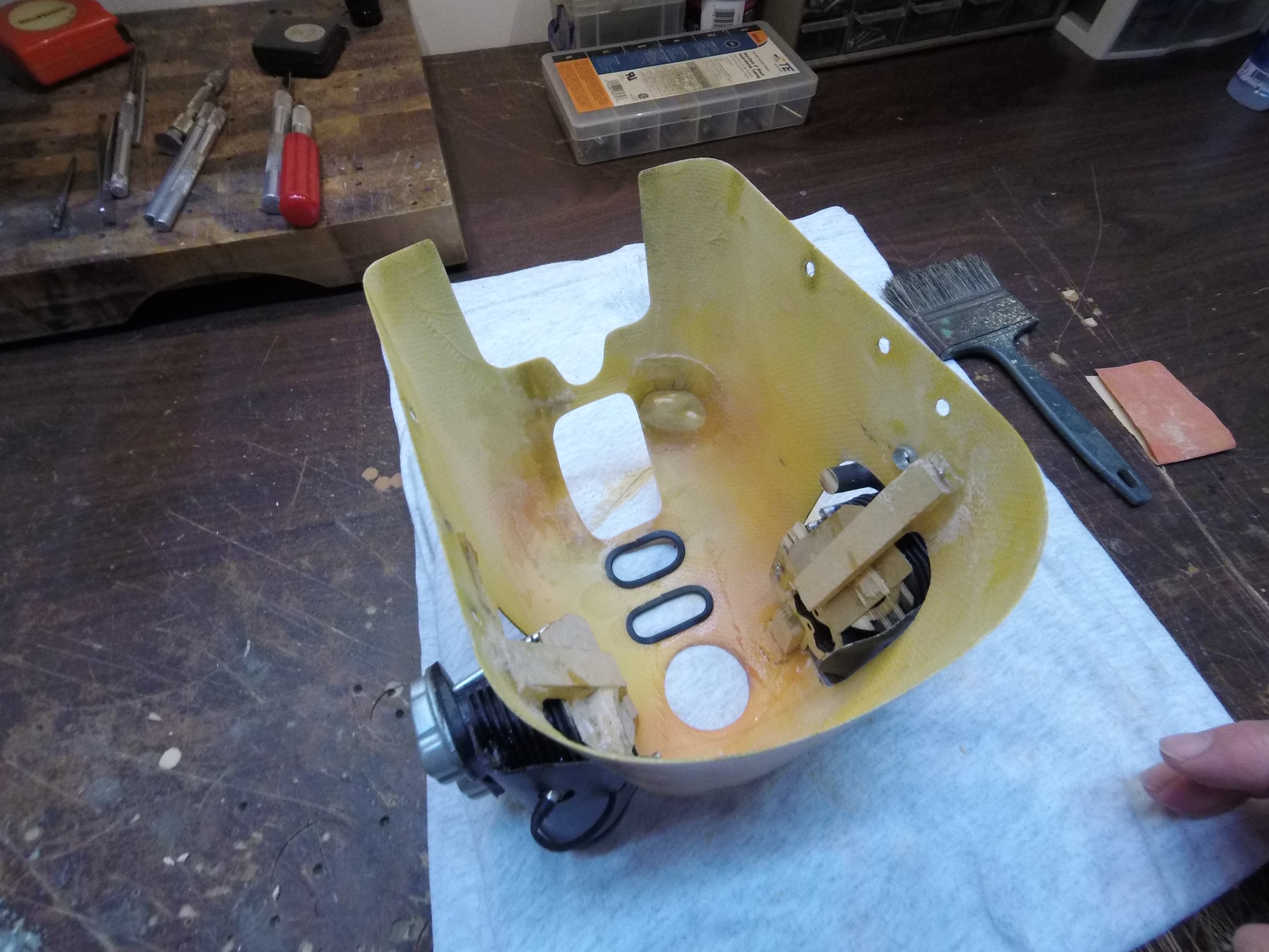

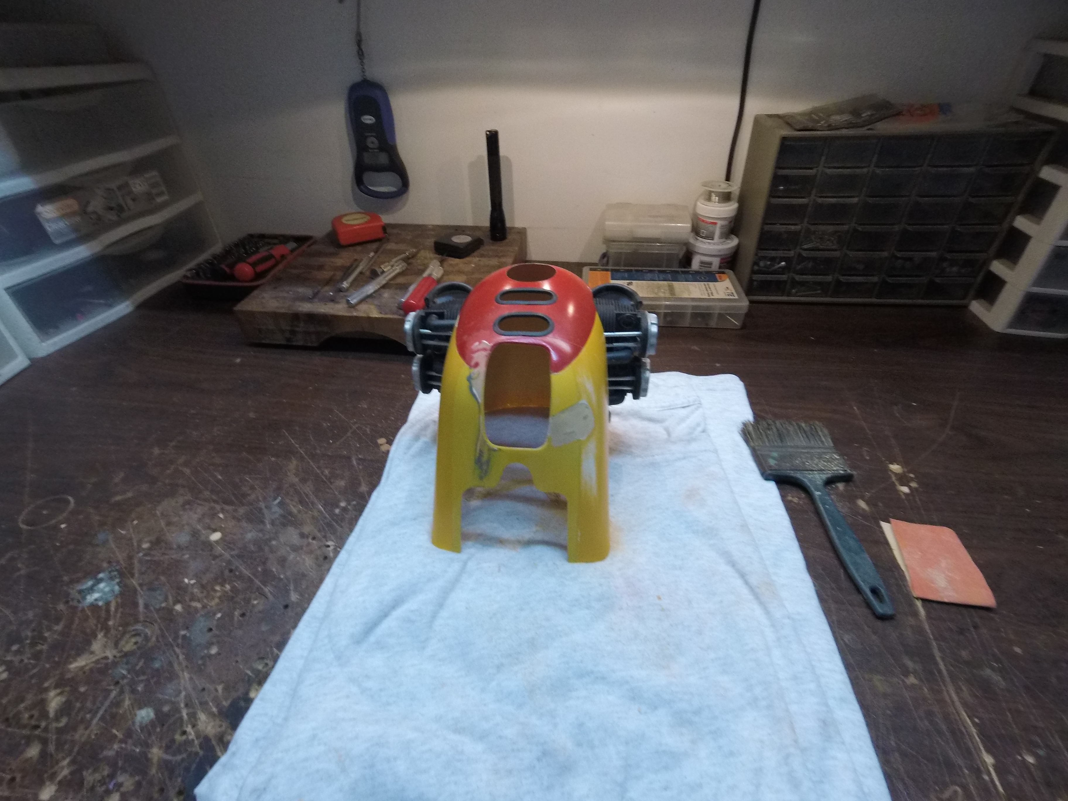

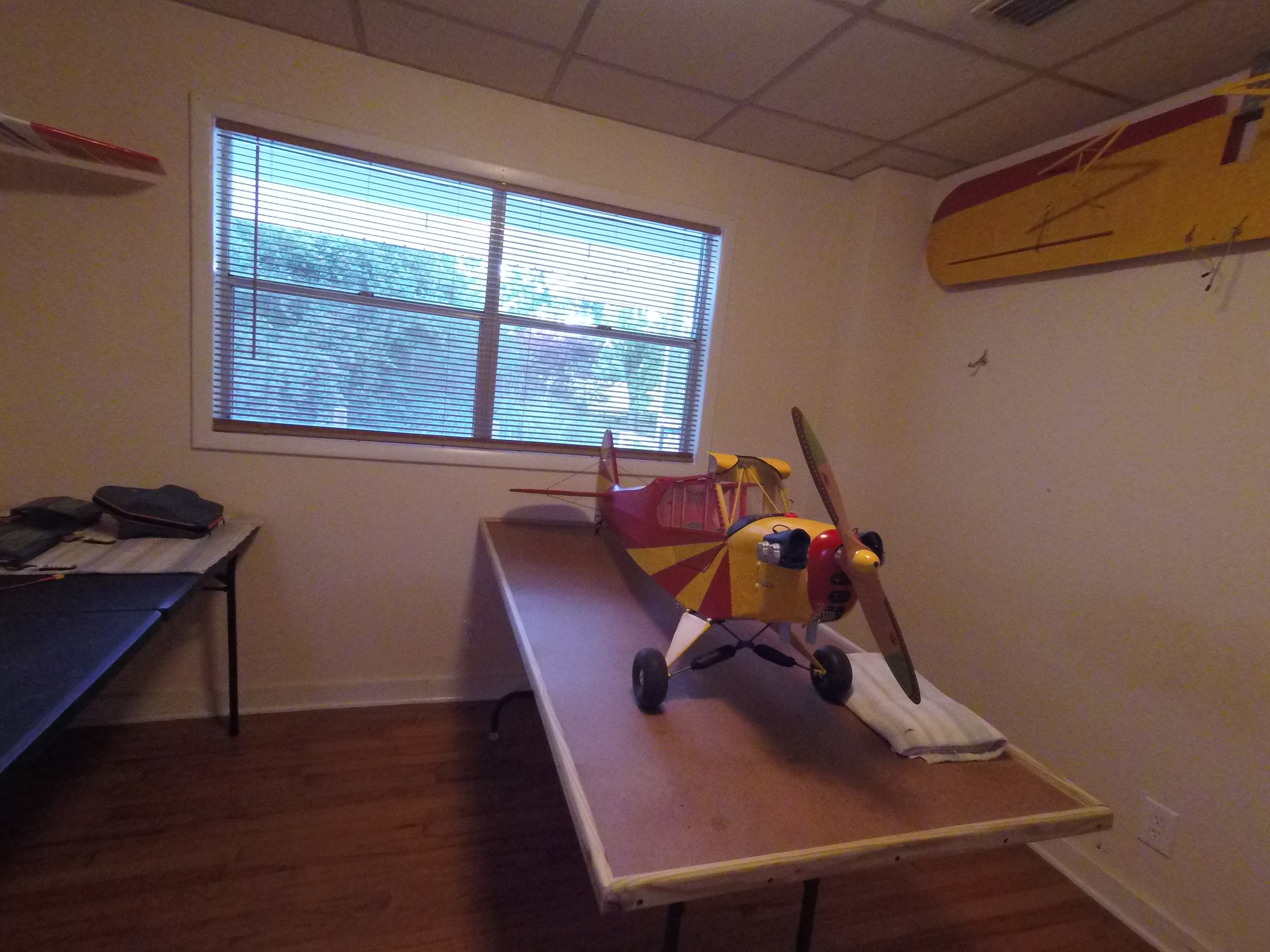

I've been tinkering in the shop lately and finally have the Krill Ultimate ready to do some bodywork on to prep for paint. I also did a bit of maintenance on the Hangar 9 300X. I need to take the stabs off to get it in and out of the house and finally switch to a Multiplex plug and mounted receptacle to speed the process up. It's way easier than a servo extension.

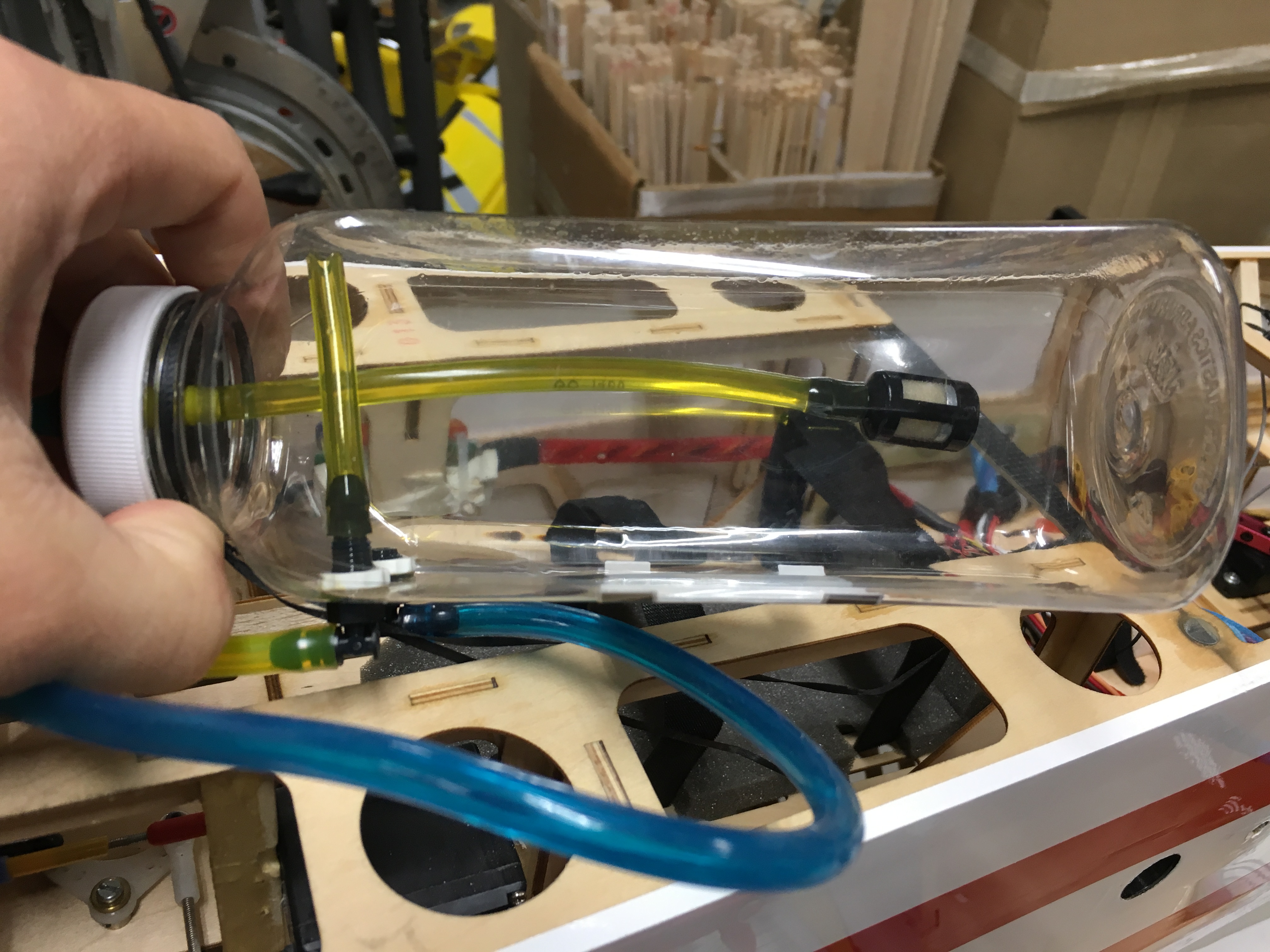

It all makes sense now...... ha ha
No wonder it didn’t like to stay inverted sometimes ha ha ha. Here’s a reminder to switch to Viton!
That will do it!

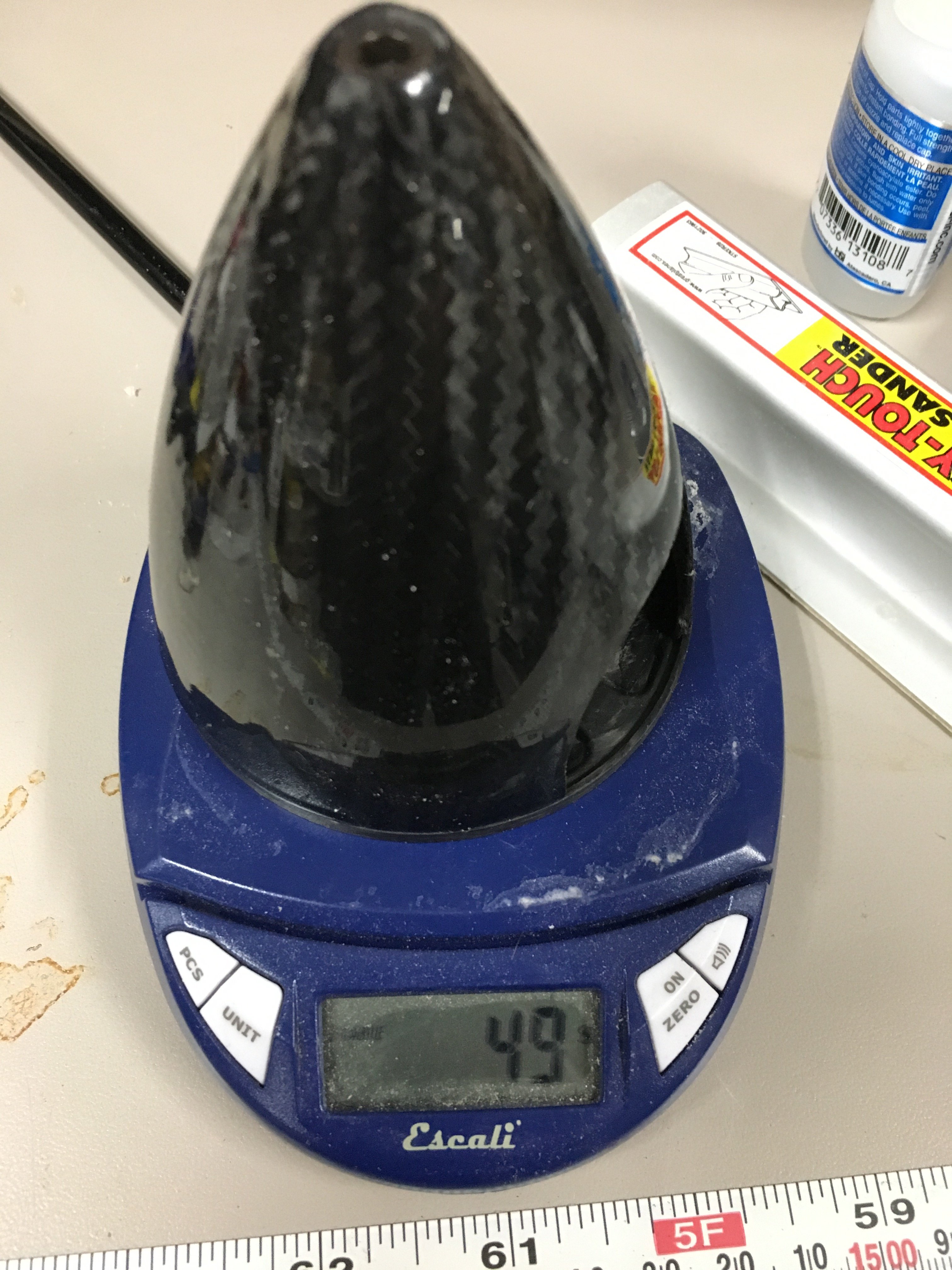

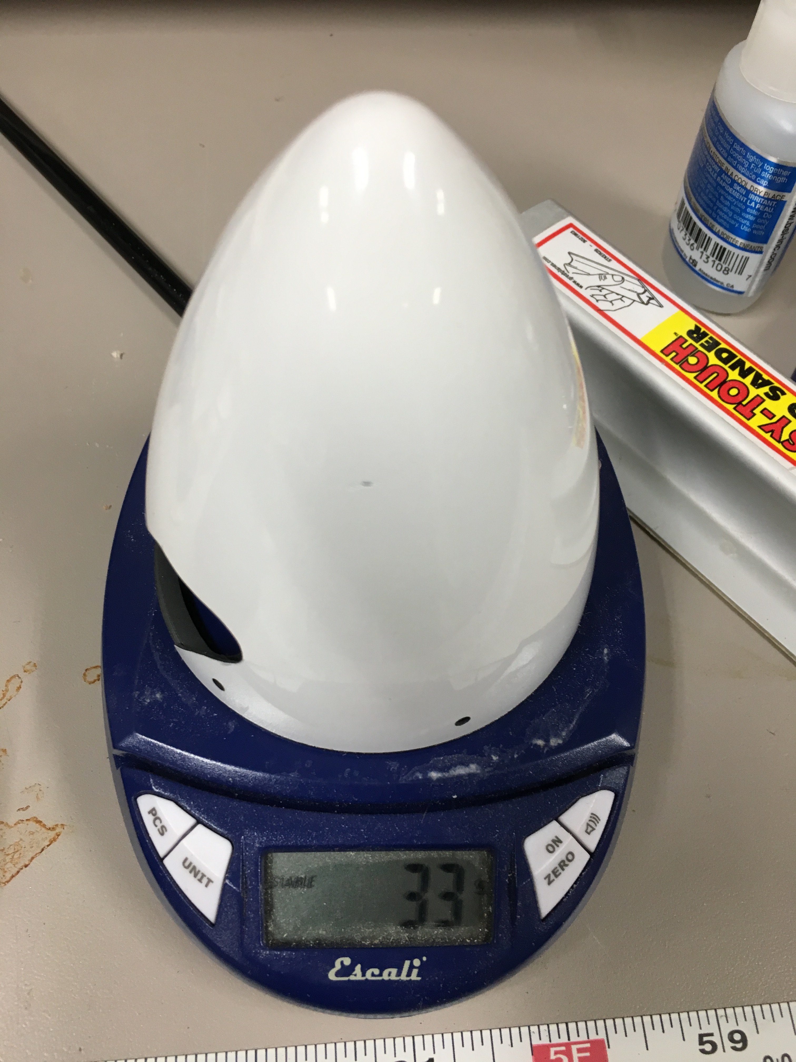

Love it great spinner I have several but you will only do it once put a electric starter to it and it is done for.Got my new falcon spinner in! To my surprise it is 16grams lighter.
Thats over a 25% weight savings. 10grams are the center bolt alone.
Carbon Center bolt spinner 49grams
Falcon spinner 33grams.
We will see how well she holds up. Surprised I had to trim for the falcon prop to fit a falcon spinner.
