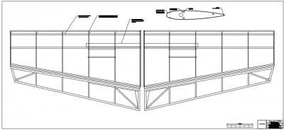

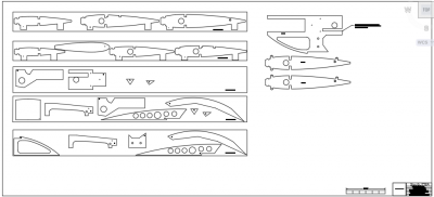

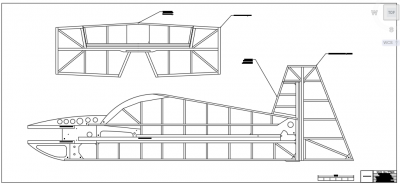

Then there is the 20cc edge profile. Couple are being built currently but not by me.

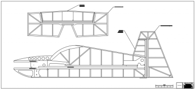

I can send you the plans for the 20cc edge if you would like. The 60” laser is one of my buddies designs. He wanted a profile that would be similar to his 60” EF Laser. He drew it all by hand on paper and once he was done sent me the plans so I could then transfer that to a CAD drawing. It could easily be built as a gasser just would need the fuse beefed up some though. Probably could also benifit from printing the plans at around 107% to bring the span up to about 64”. Also if you wanted it to be removable wing it’s something you would have to adapt yourself as his is drawn as a one piece wing.

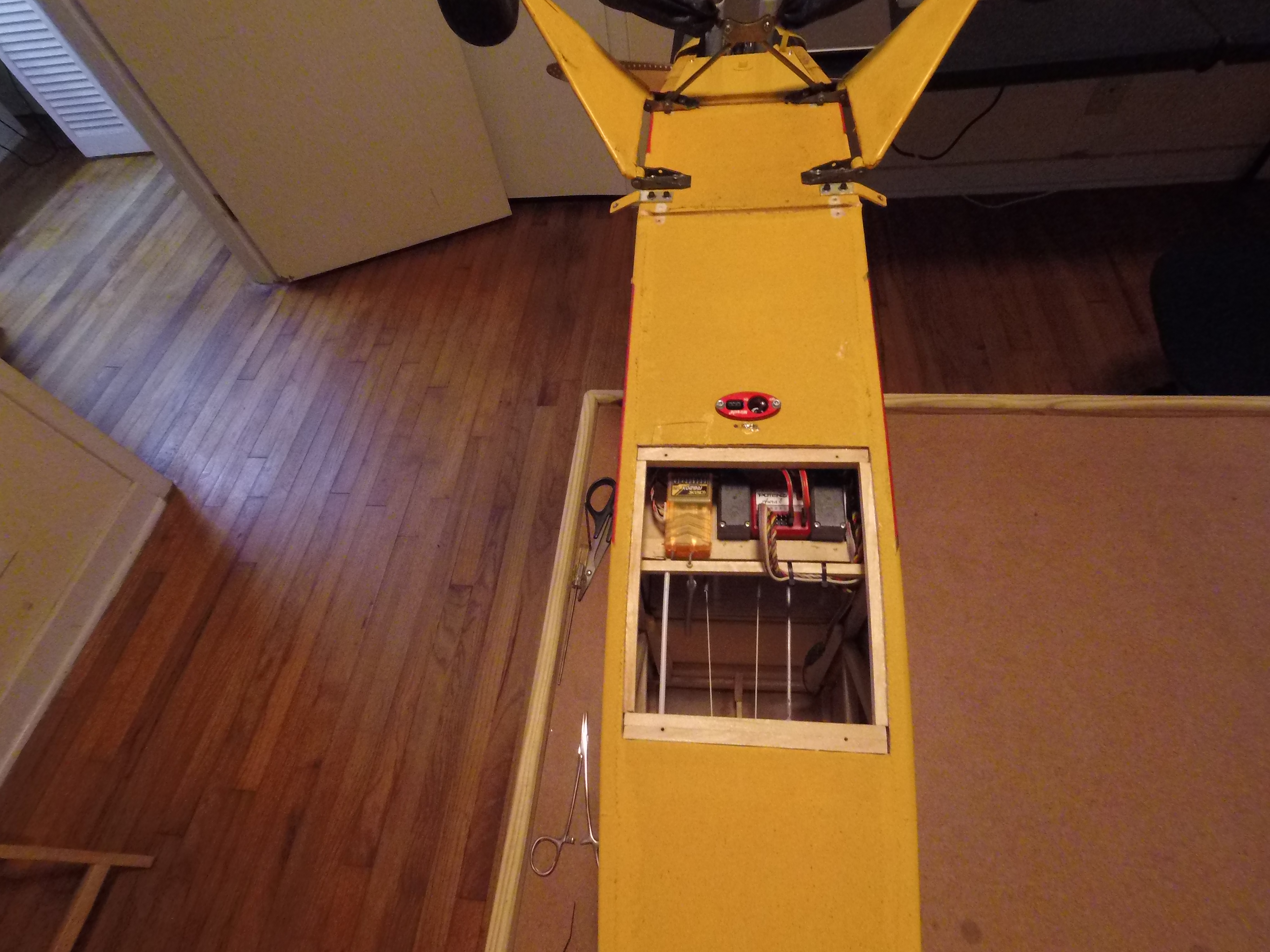

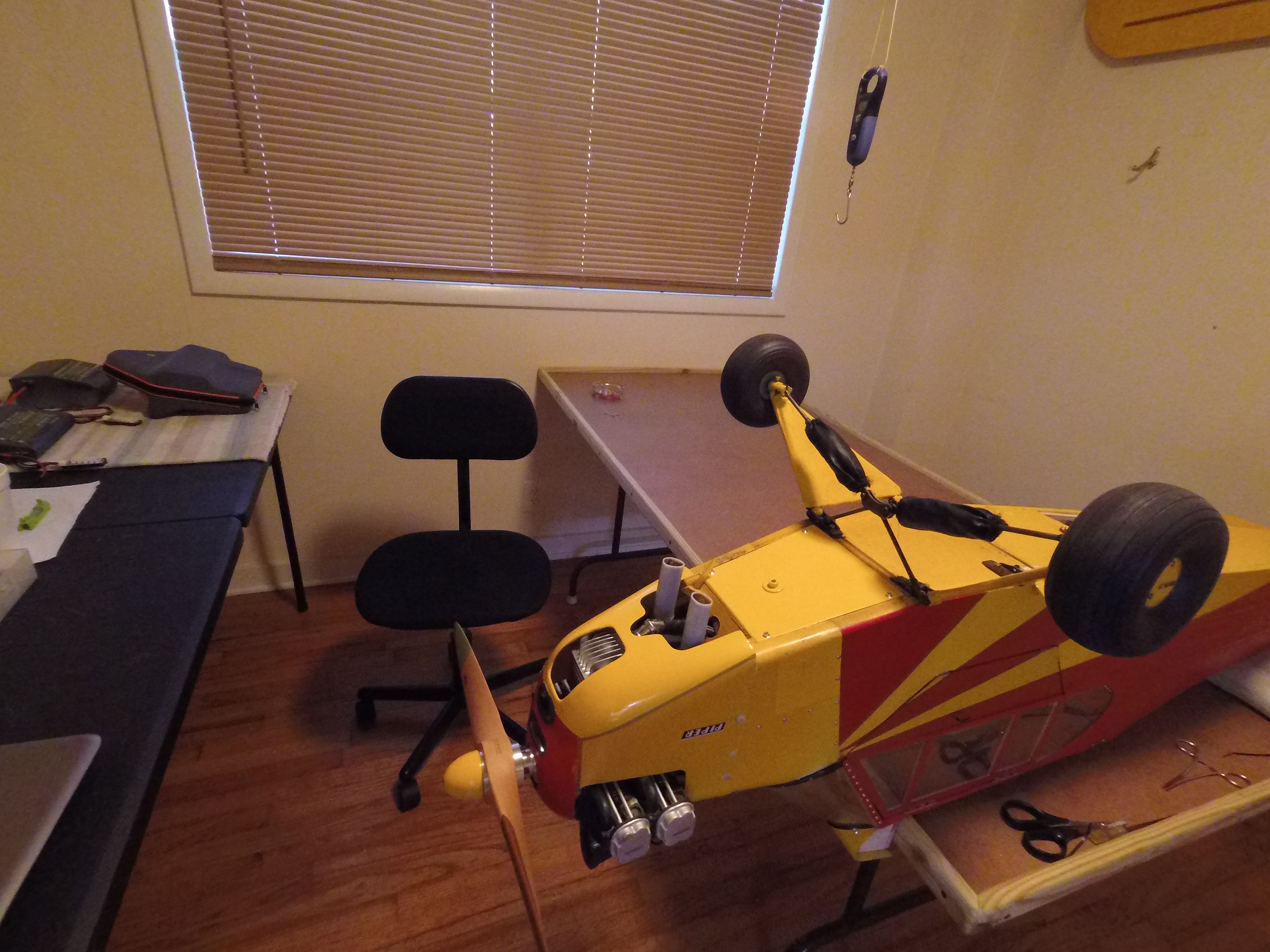

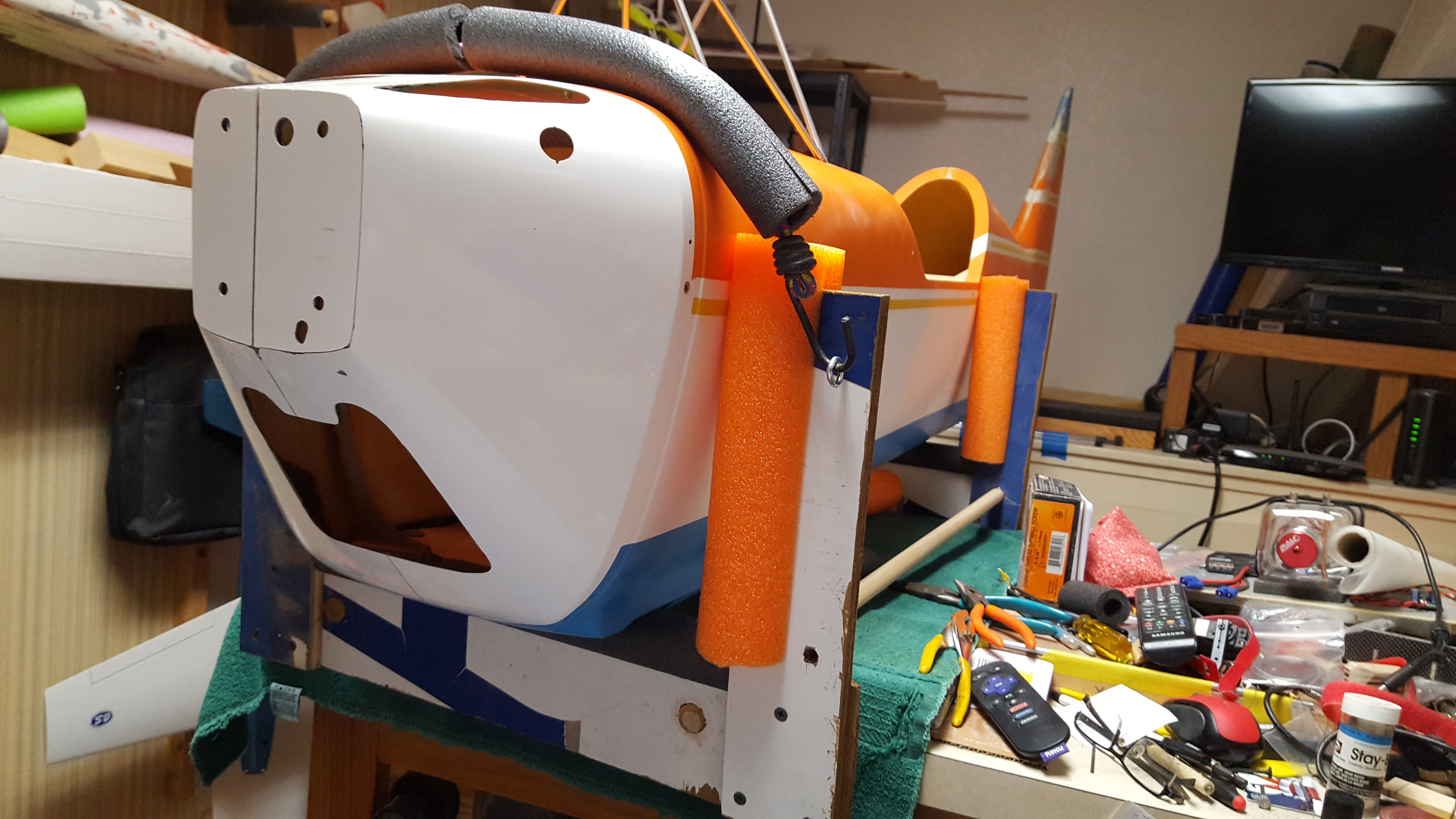

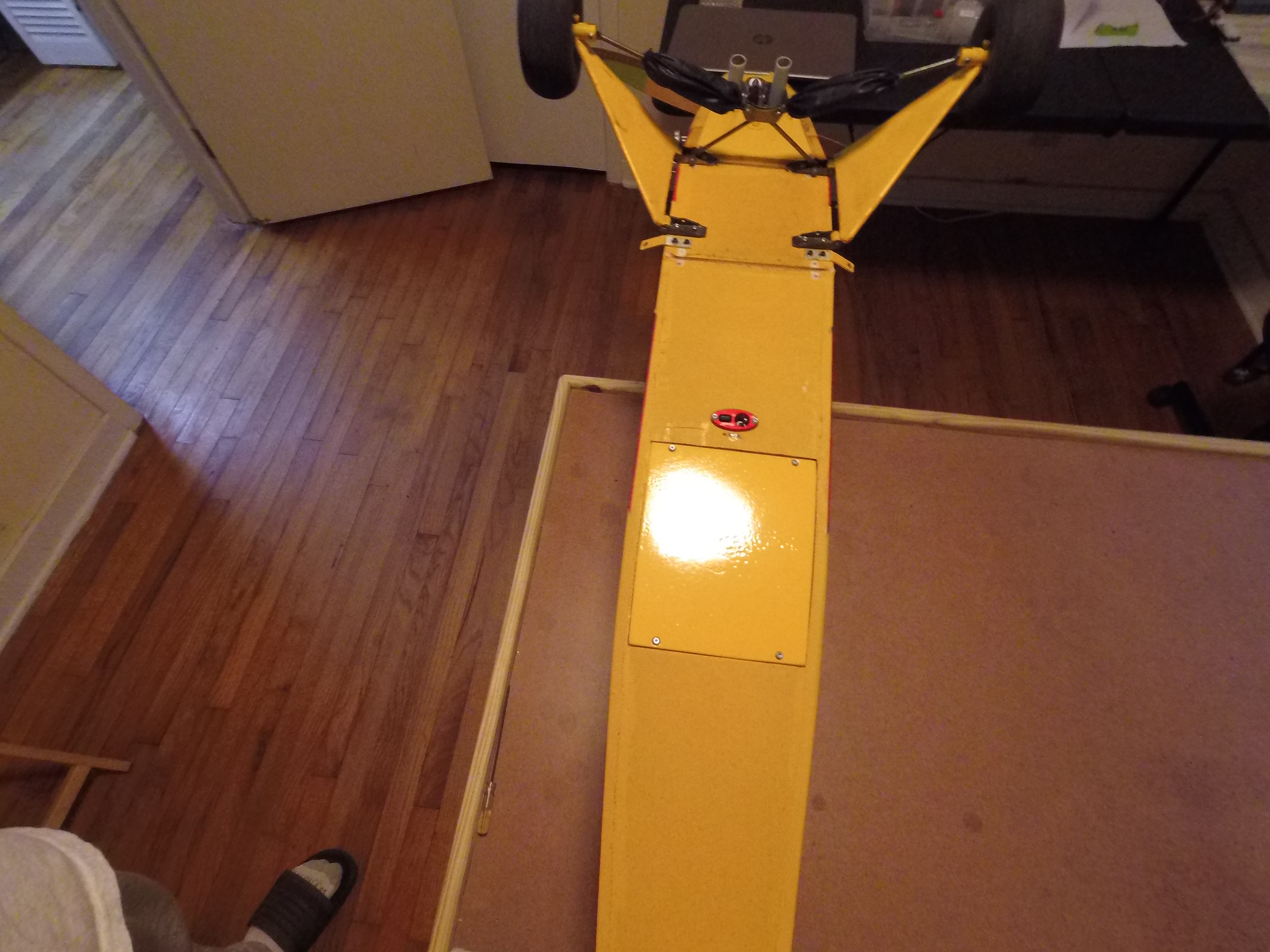

Getting close to finishing this thing. Thinking of using 1/4" copper tubing and fittings to make up the scale exhaust. The Aura 8 went in snug between the tail servos. Got it programmed up and ready to fly :). Got the covers on the bottom painted too.
