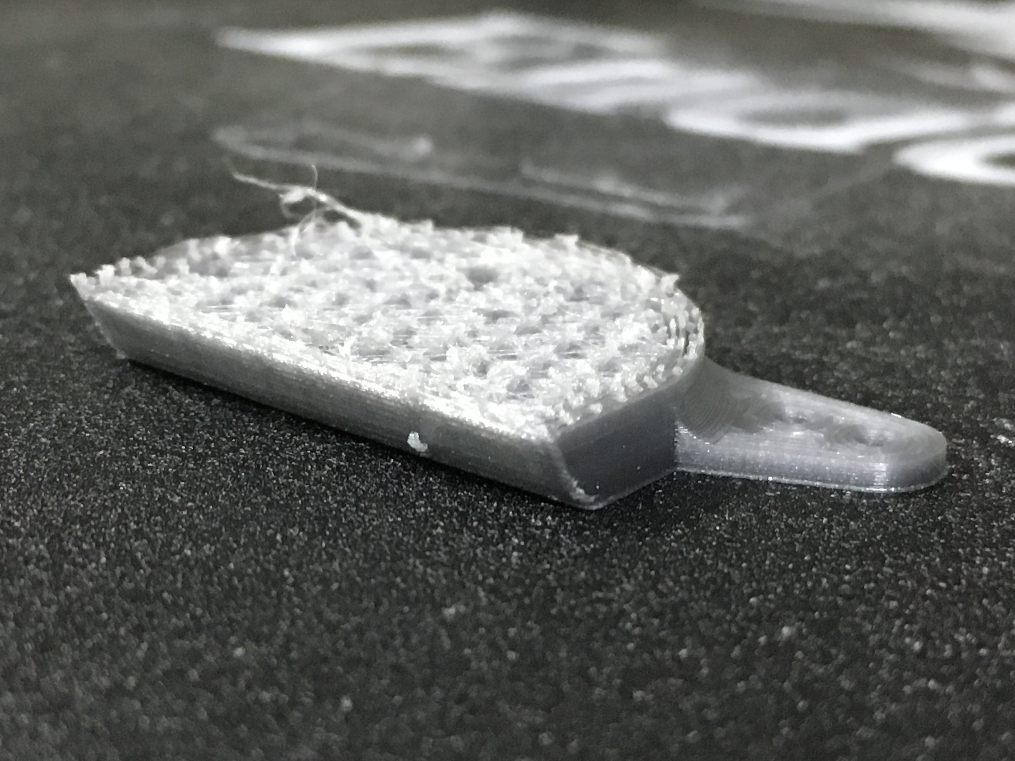

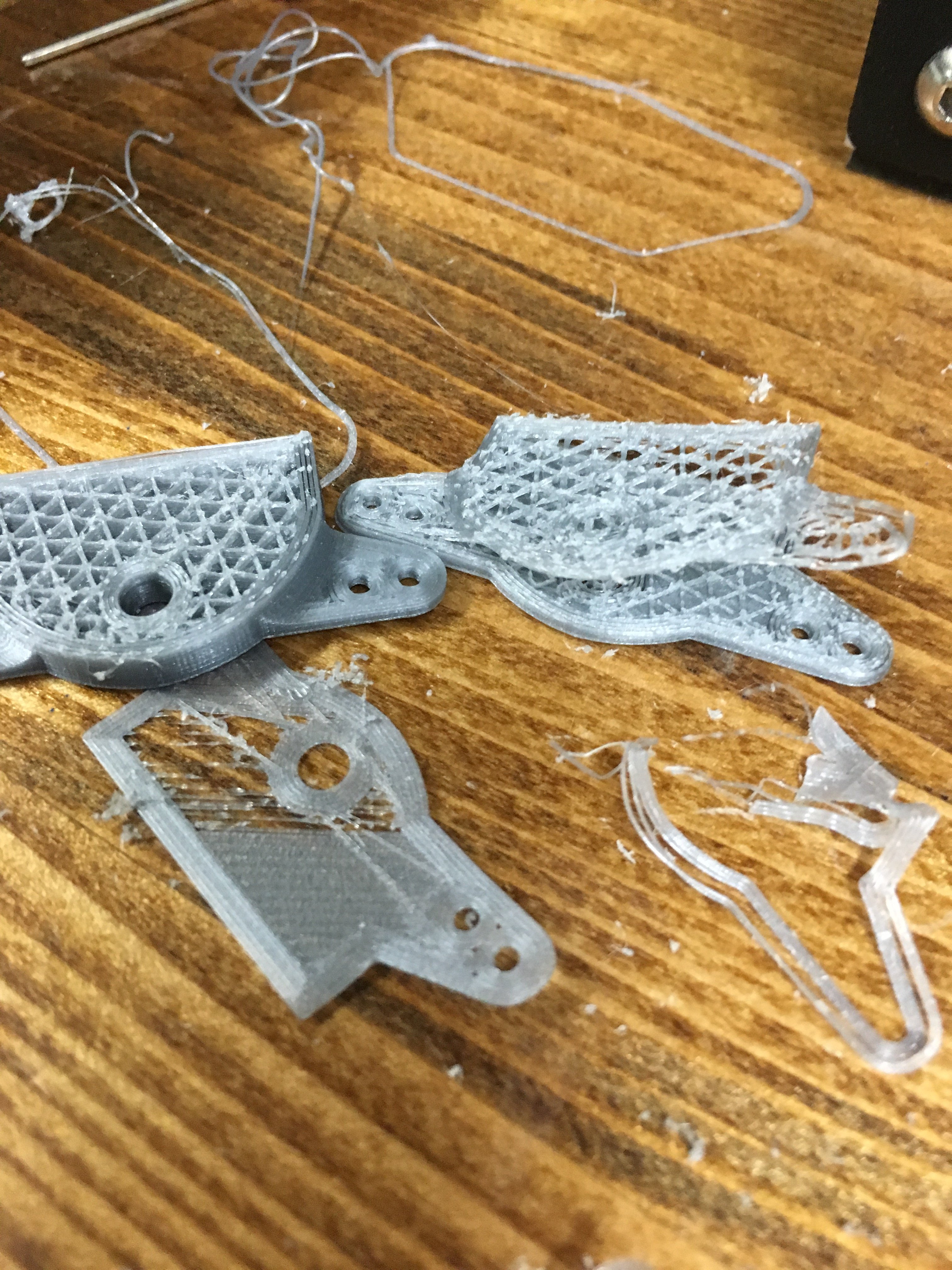

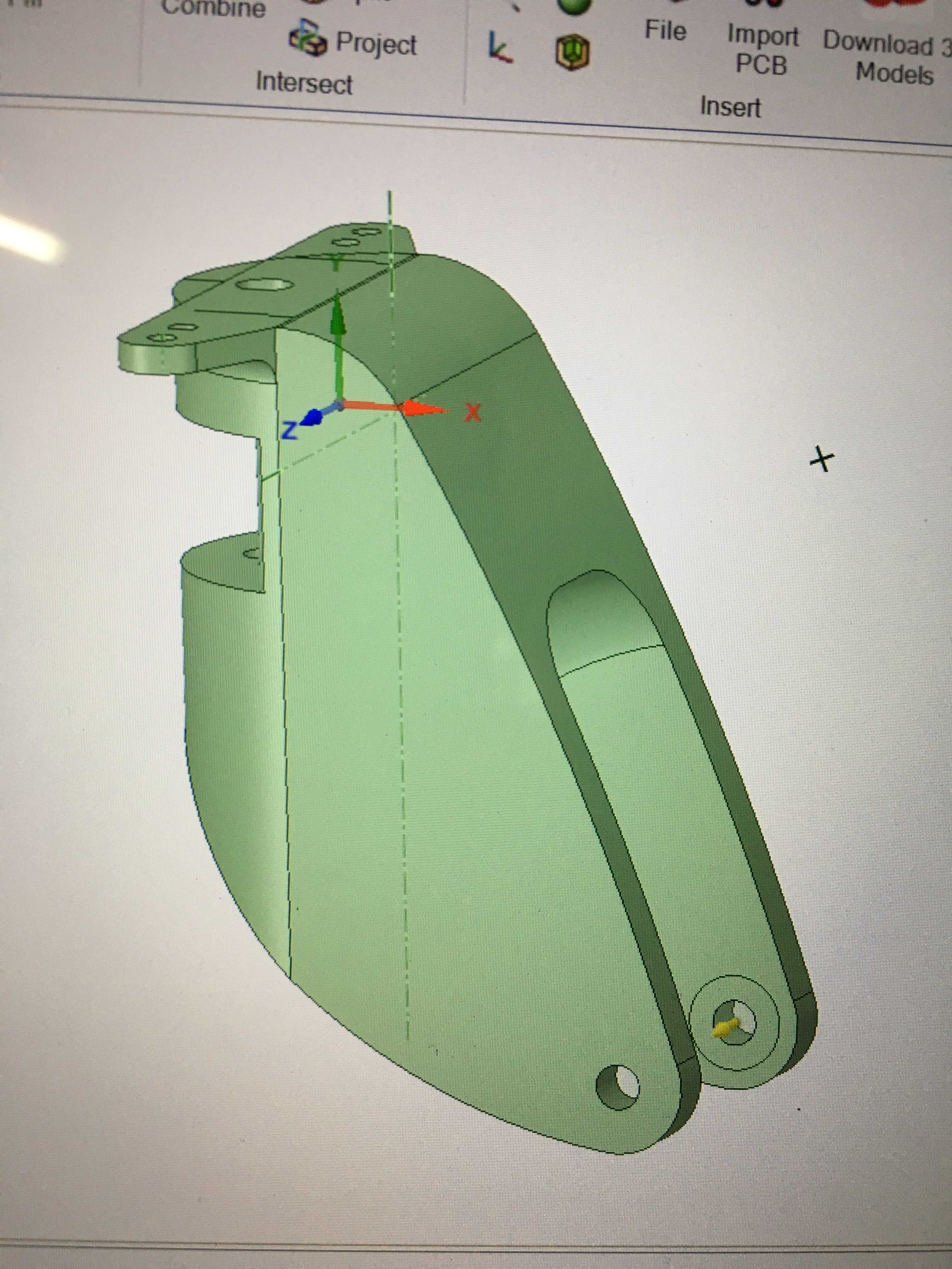

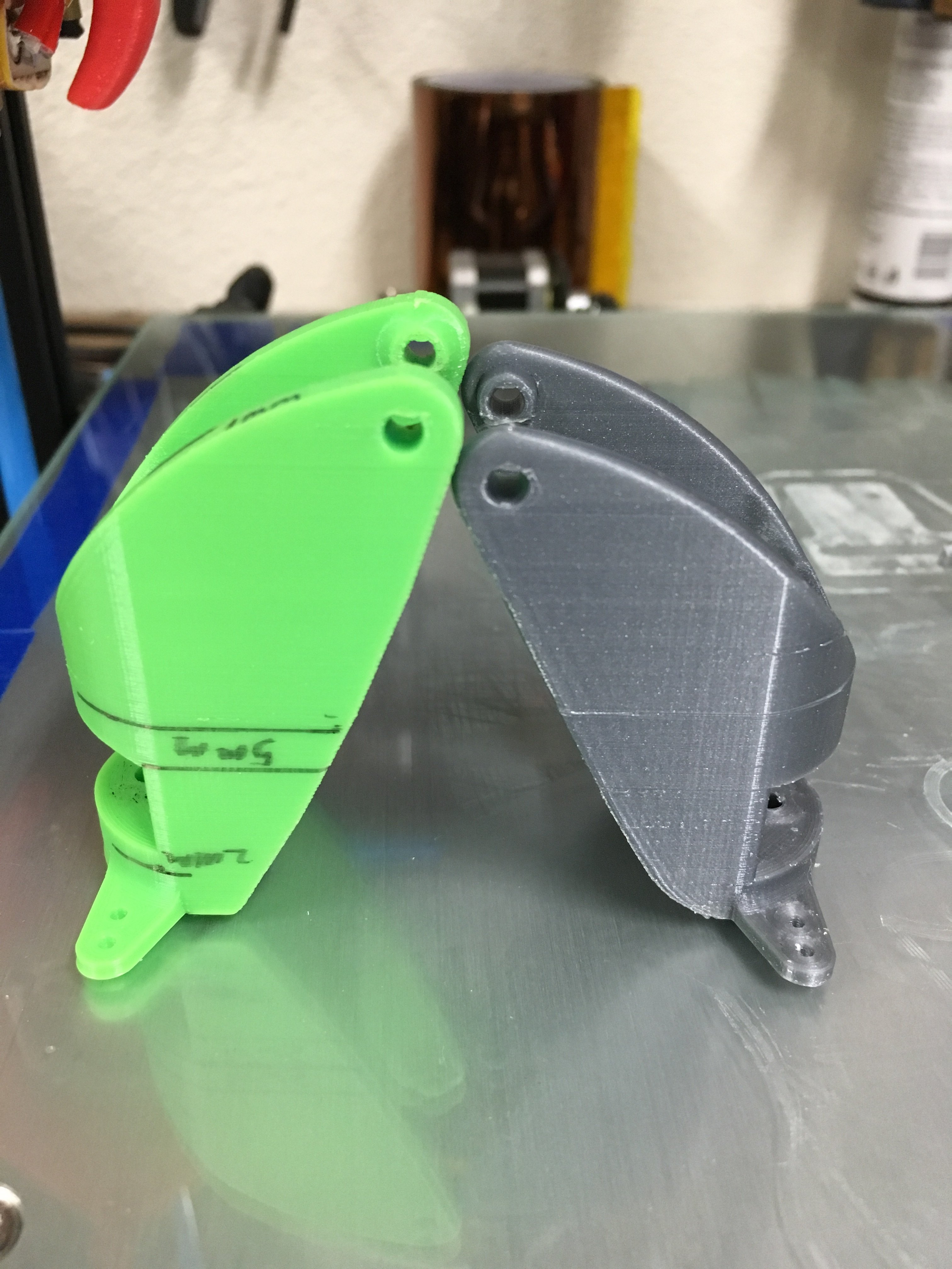

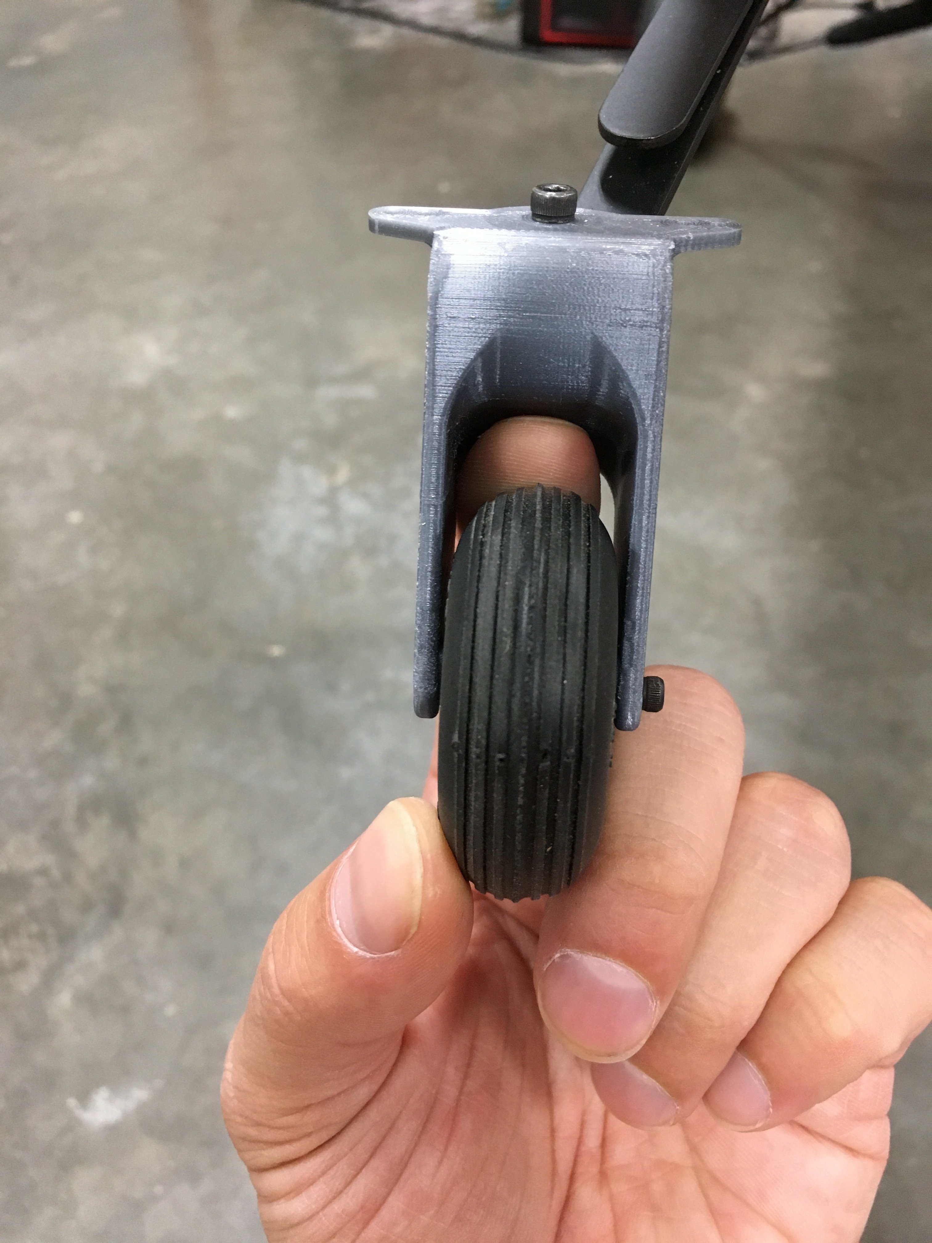

Designed a tail wheel bracket for my 110” timber... couple little things left and then time to print it. OEM is 1.4” wheel, this would be for a 1.75-2” wheel
