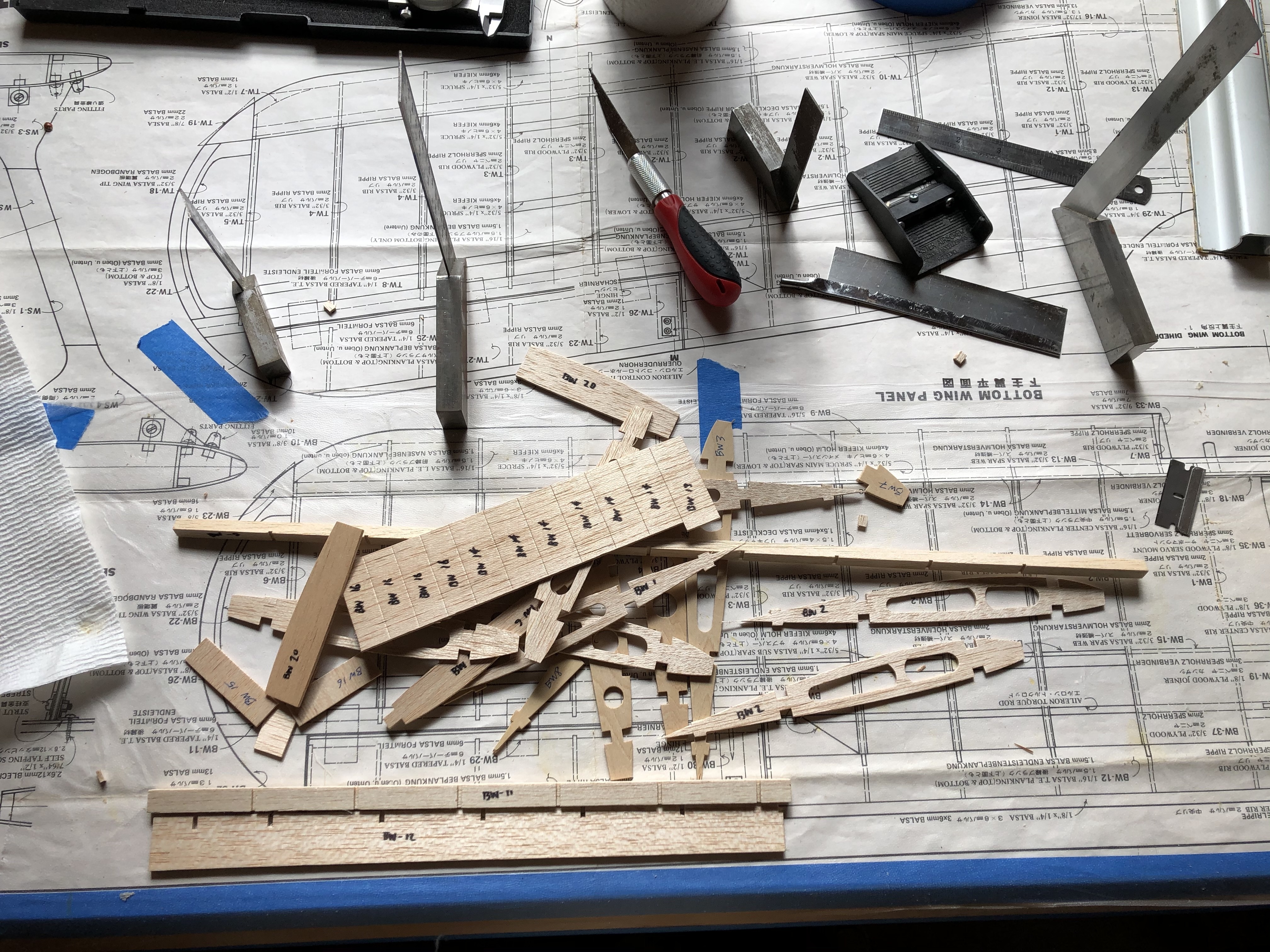

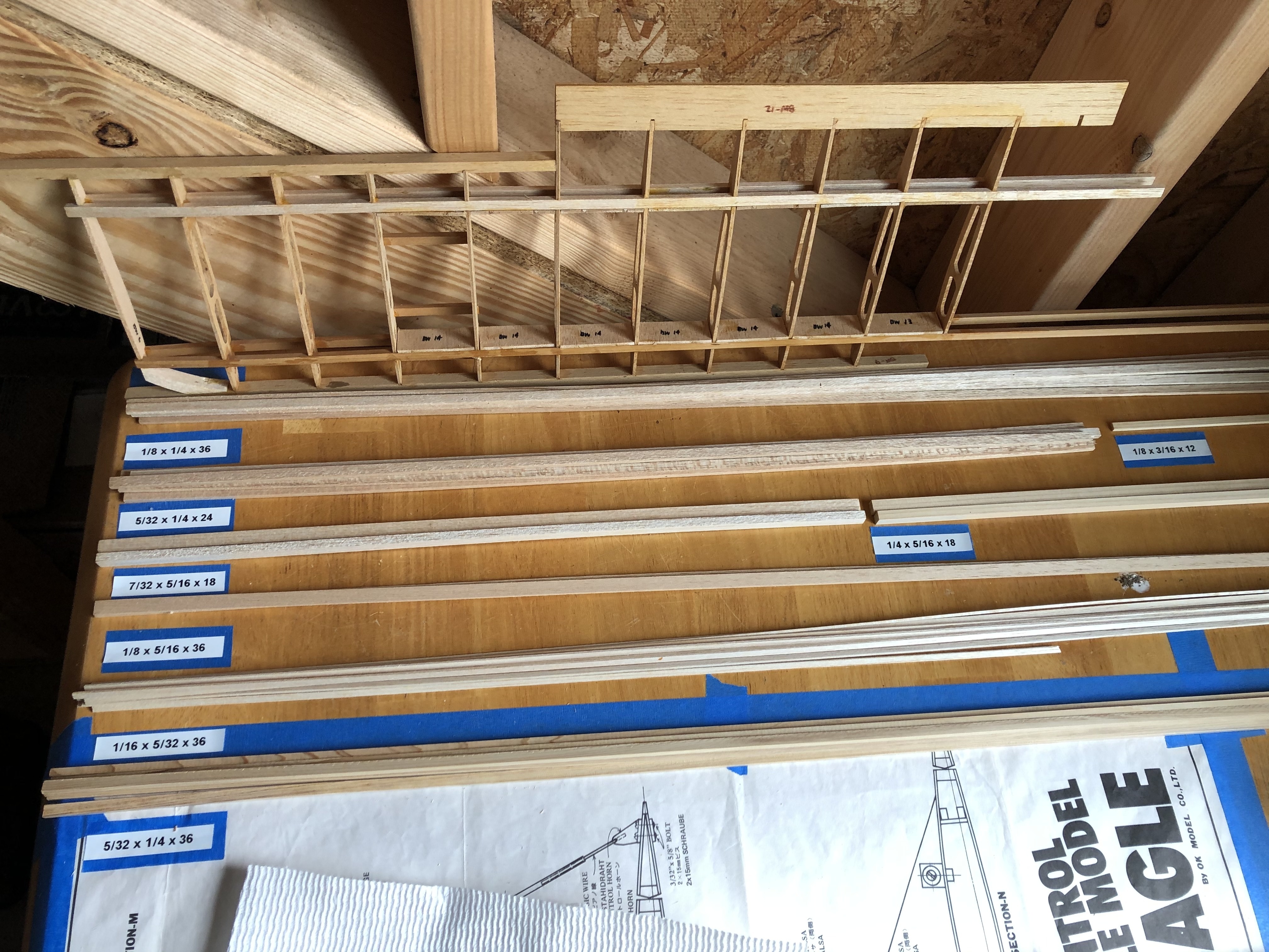

Not giant scale but started gluing pieces together. One of those projects which has been on the shelf for too long.

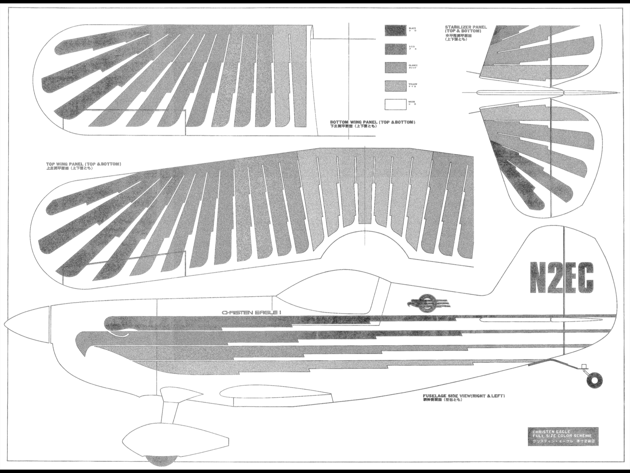

WMcNabb

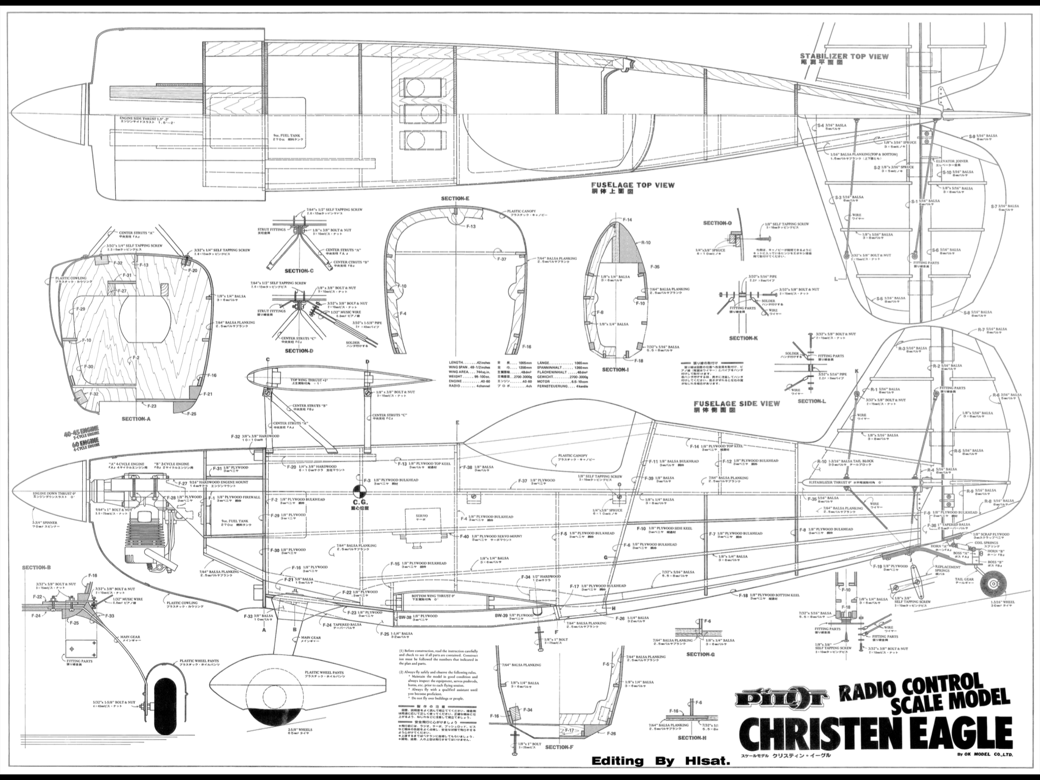

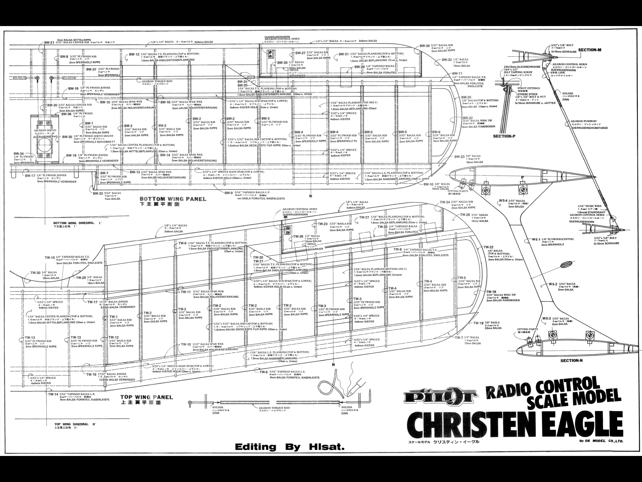

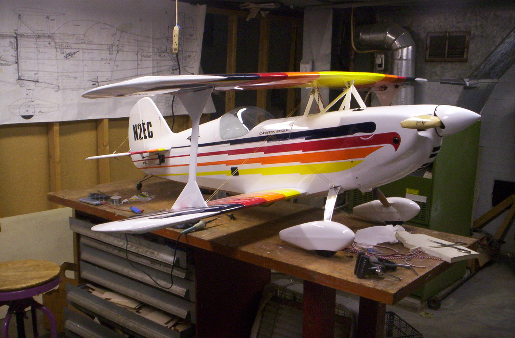

What is it looks interesting.
A Christen Eagle I kit from the Pilot series by OK Models.
Specs:
49 1/2” wingspan, 95-100 oz. weight, .40-.60 size engine
1.26 m wingspan, 2.7-2.8 kg weight, 6.6-9.8 cc engine

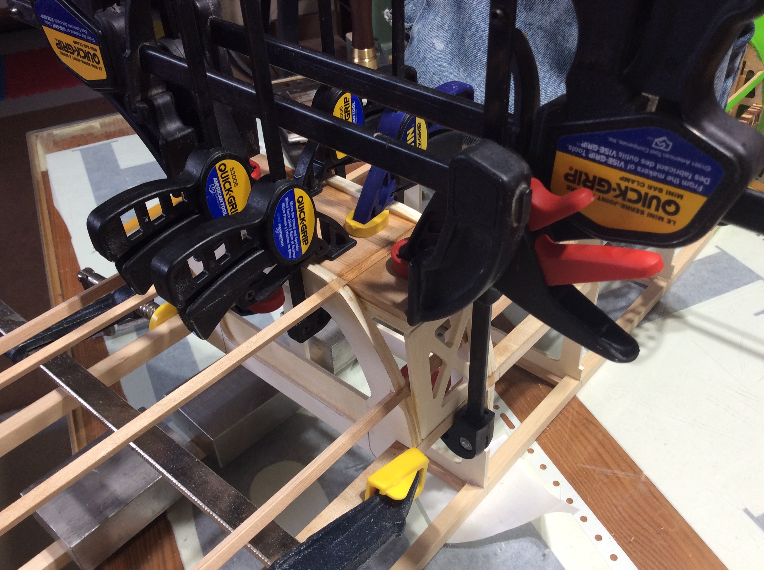

Made the bulkhead head doublers and set them into the fuselage. Then worked the landing gear into the fuselage without cutting any of the stringers. Little bit of cutting and fitting and all fell together. Now just let the epoxy cure on the landing gear and then we can glue in the rest of the bulkheads.
