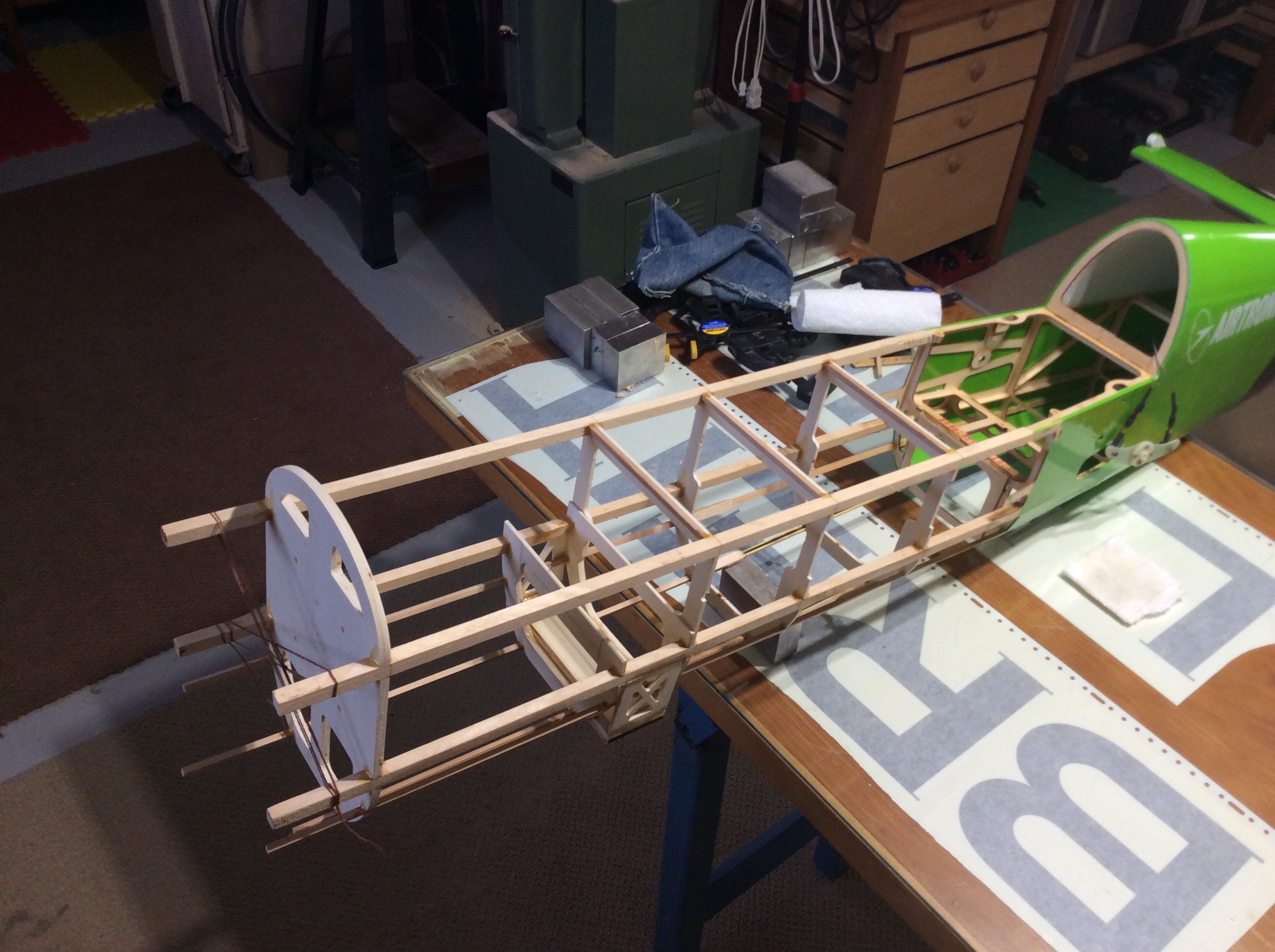

It is starting to look like a plane again, all the bulkheads are in and glued. Now just have wait 6 hours for the epoxy to cure. Little more time and weight but I will feel a hole lot better CA just plays havoc with me.
Plan to do some cross bracing and a few gussets, cleanup and plan the canopy.

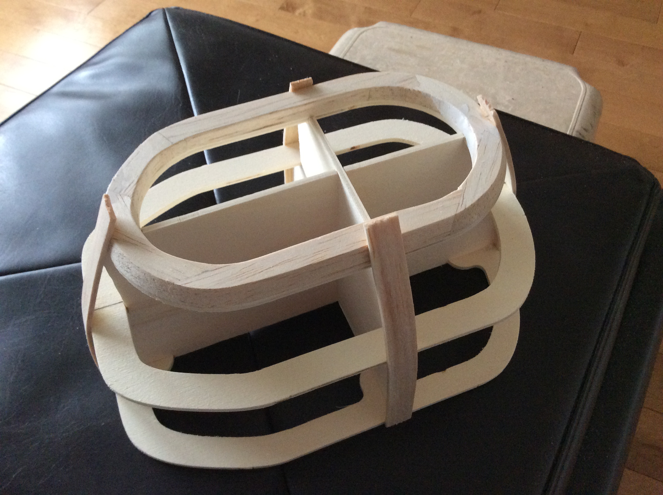

Ok started on the cowl this I believe is going to test me . Made some of the bends a little to tight and curve around the bottom a little to sharp. The next cowl I will keep that in mind when making the drawings. We just keep learning the hard way. Did it this way so that I can cover it with Ultracote. No colour matching????

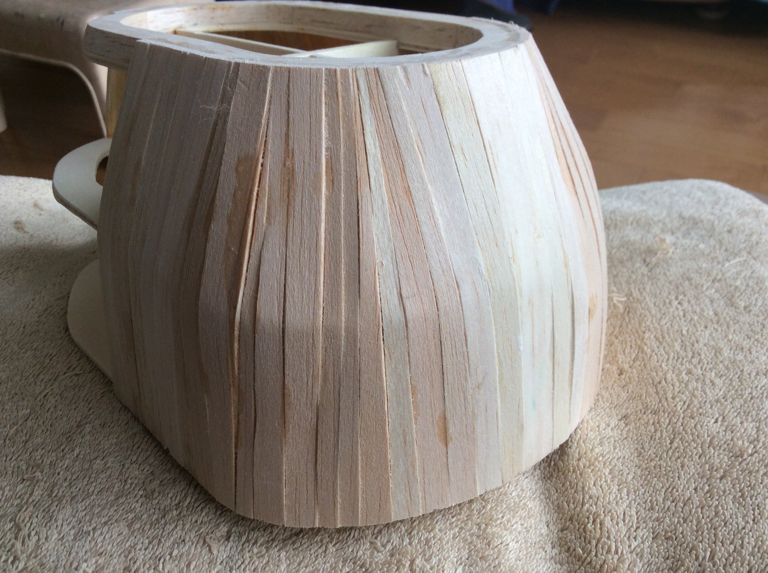

Halfway done look at the picture if anyone has ever done planking and look at this they know this was time consuming and difficult. But some sanding and little body filler and I think it will be a decent cowl.
Learnt one more thing for the next cowl the support rings on the inside need to spaced closer together no more than 3/4 of an inch to get a nice radius. Next time. This cowl should have had three spacers on the inside instead of one.
