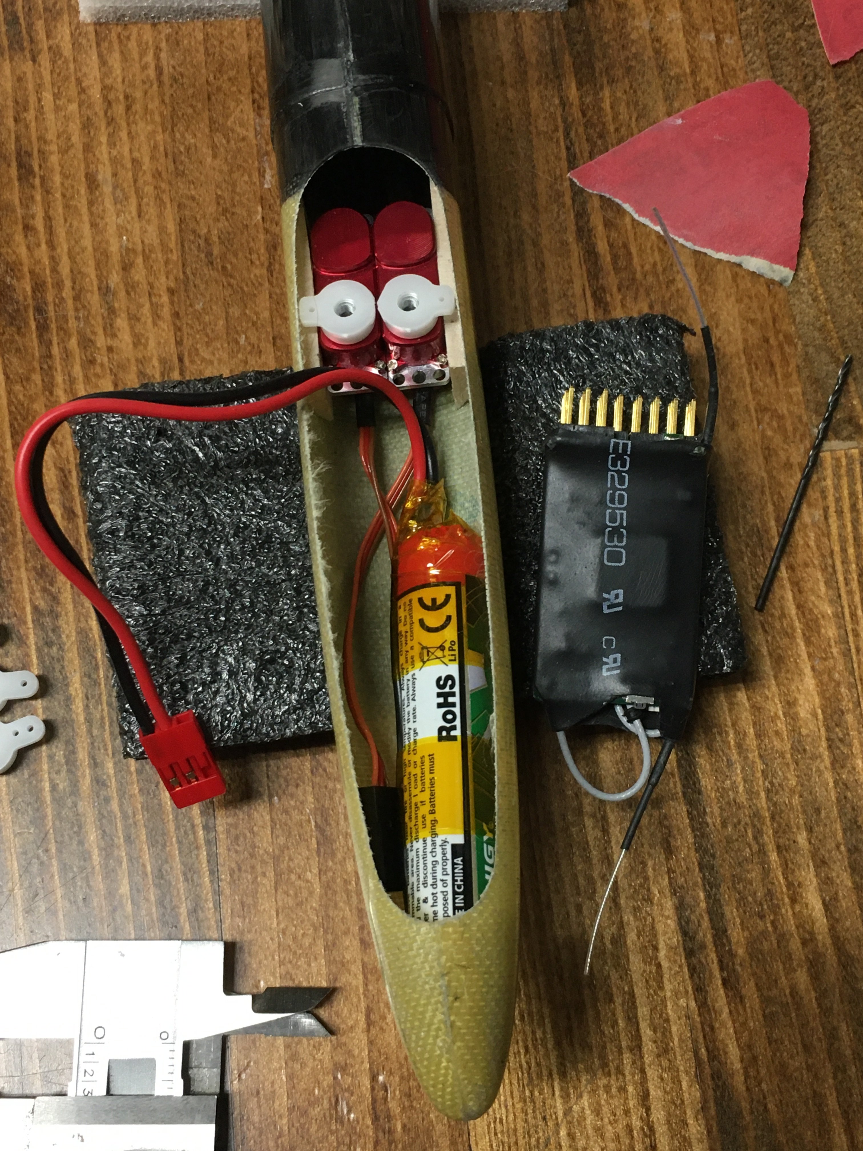

Been scratching my head to try and get the best pod setup for my flitz2. Man every decision was a compromise, so I ended up side by side which allowed a larger 1000mAh 1S battery with the option of a smaller 650 1S and the Rx up front sitting on top of the battery. The compromise is there is minimal servo arm deflection 4.5mm to be exact instead of 6mm. I’ve seen several with a similar setup, just hoping it works out ok. I’m so used to large throws this is a head banger for me. Just no room in the pod!

What happens if you turn the servos at 180 from one another and the arms facing inward.

Stick with the 650 unless you need the 1000 for balance. You can fly a long time off of the 650. Dlg setup is certainly a compromise and the Flitz series in particular has a very tight pod. I just ordered some new KST X08’s to install in mine as the JR’s in the pod are noisy as hell

seems what I’ve been reading is to get to 68-70mm CG people are adding a bit of weight in the nose.
With this setup I can use either battery.
the MKS 75s are quiet as a mouse.
