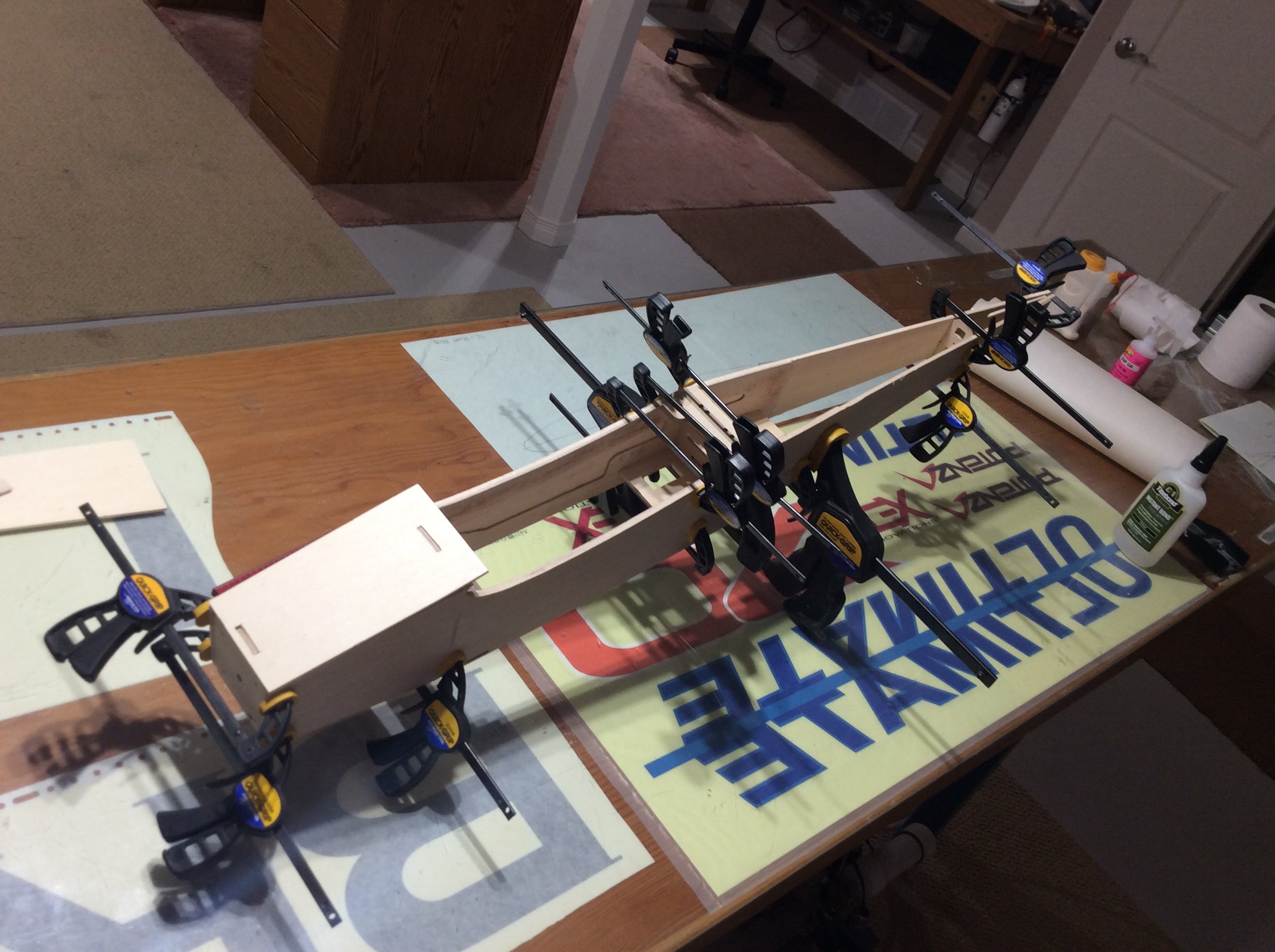

Well I have to say I have learned something new will be using peelply a lot more it really works and the surface is very smooth, no sanding required. I am not a fan of sanding at all. I know I took a picture but does do it justice.

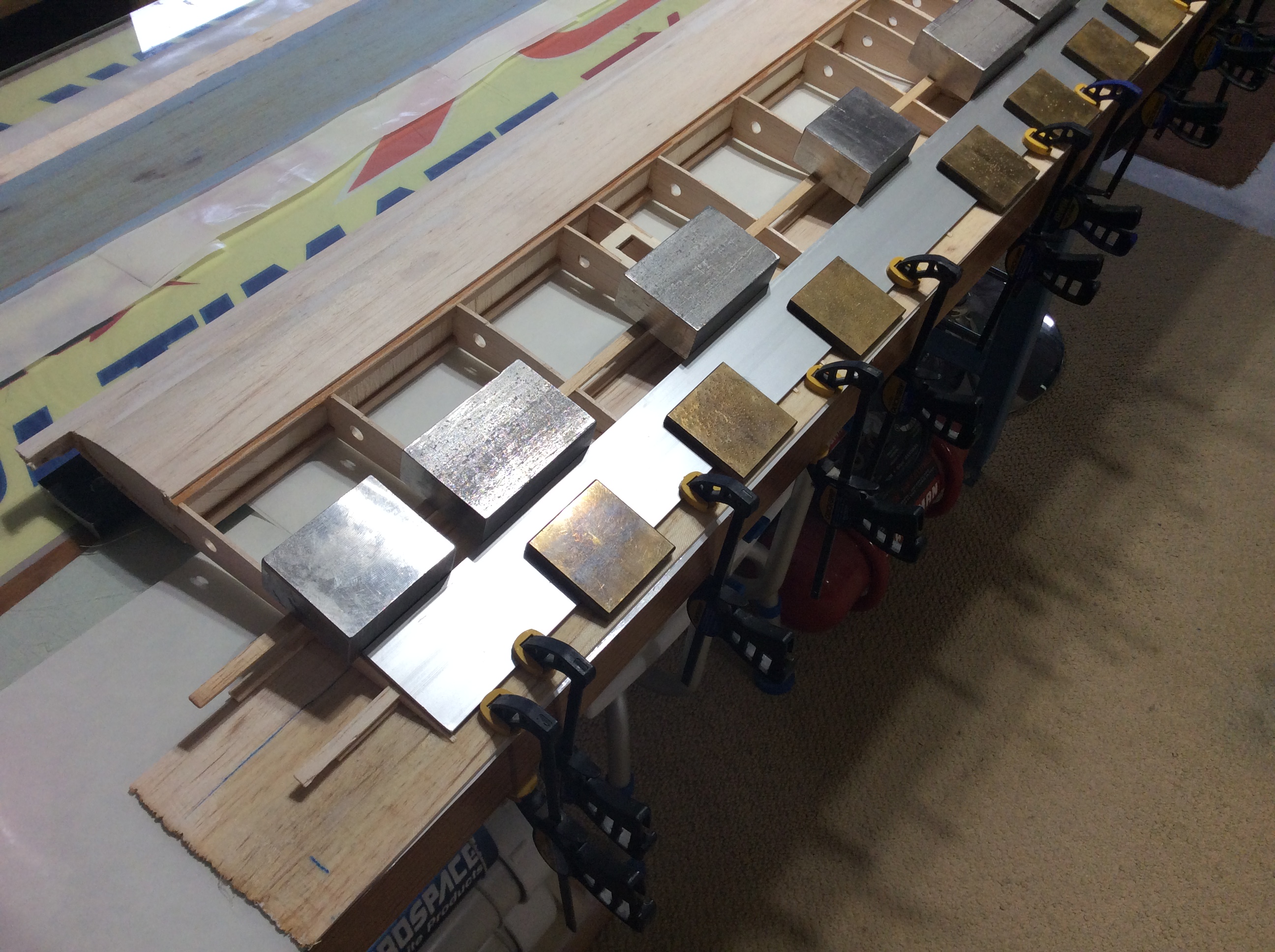

I know you can no see much of the sheeting but I all ways clamp it down on to the table with a bar across it and then weighted down my trailing edge must be straight and level.

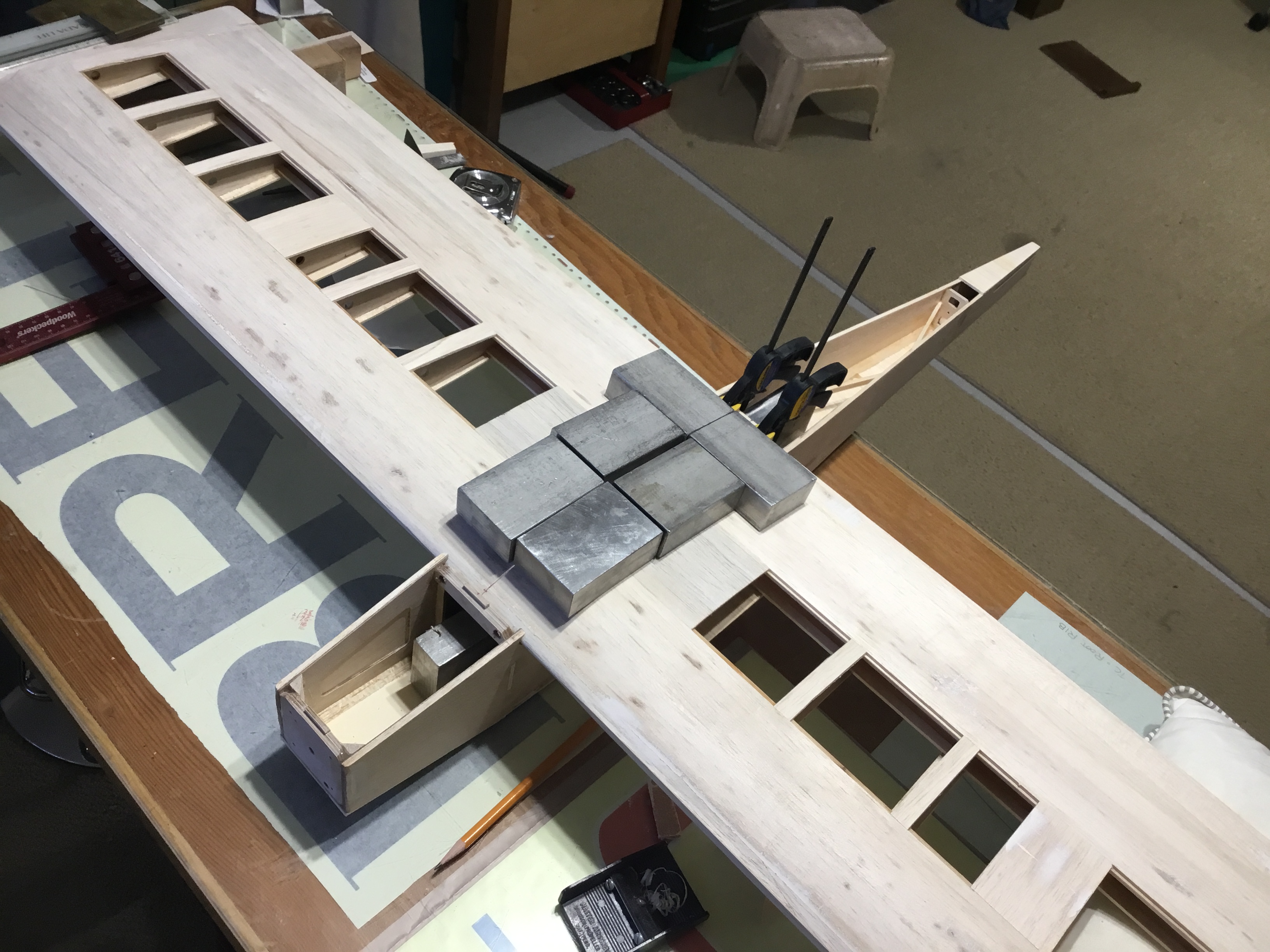

I use to put the Fibreglass on the out side but it was a pain to make smooth and install plastic cover it so this time I decided to put balsa on the inside, hopefully it works out time will tell.
The wing is all most done all the sheeting is done, all that needs to be done is add the wing tips and cut the ailerons off and hinged.
Further note the trailing edge worked out great with a little sanding I have ended up with a 0.40 trailing edge perfectly straight and flat.
