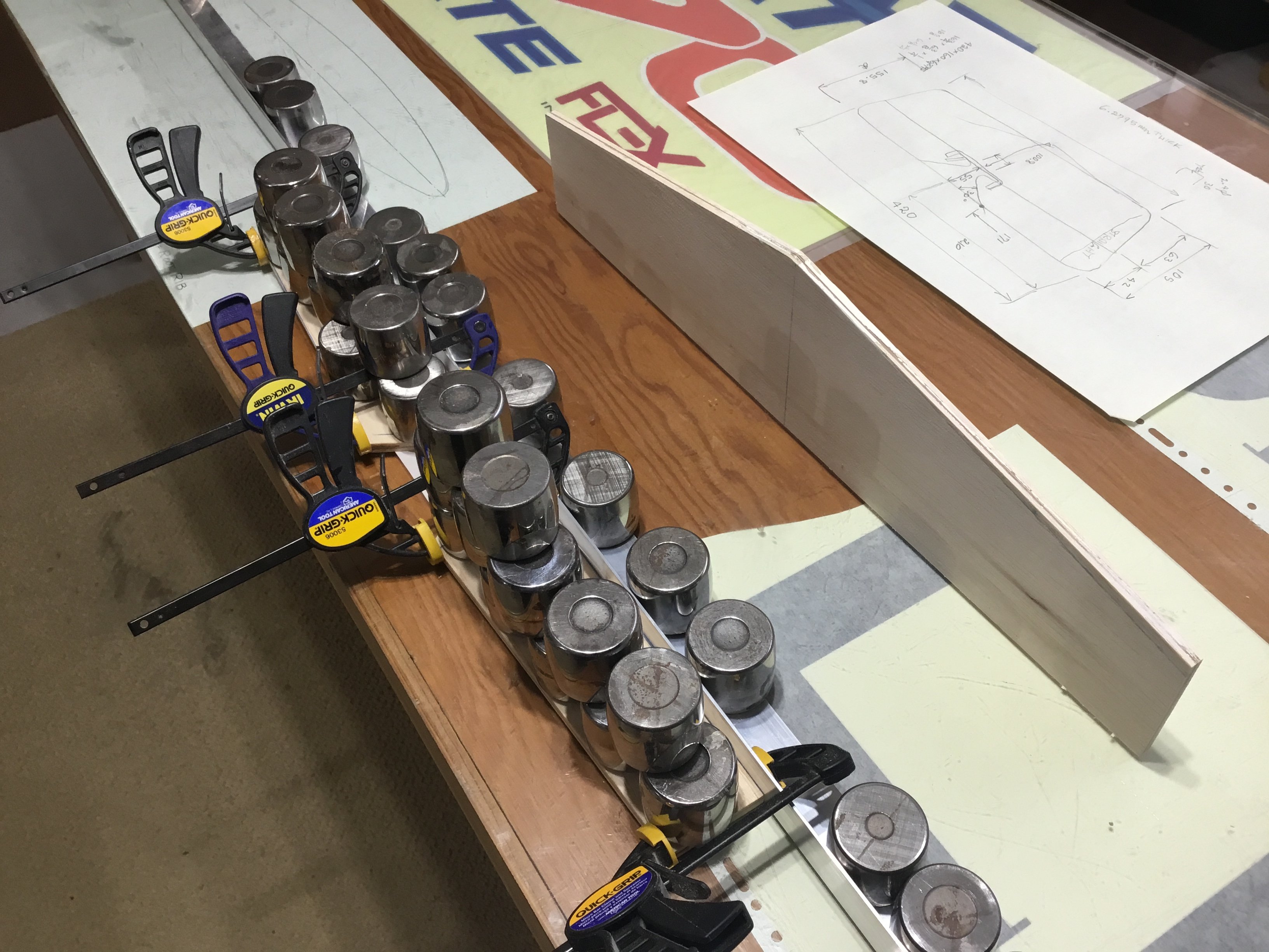

Made a start on the elevator for the fast 46 size sport/racing plane. You can almost not see it but under all the weights is a pair of elevators with a bent piece of piano wire gluing them together. Also added to the elevators and stabilizer is a 1/2 inch strip of 1/32 plywood all the way around the perimeter On Center line.

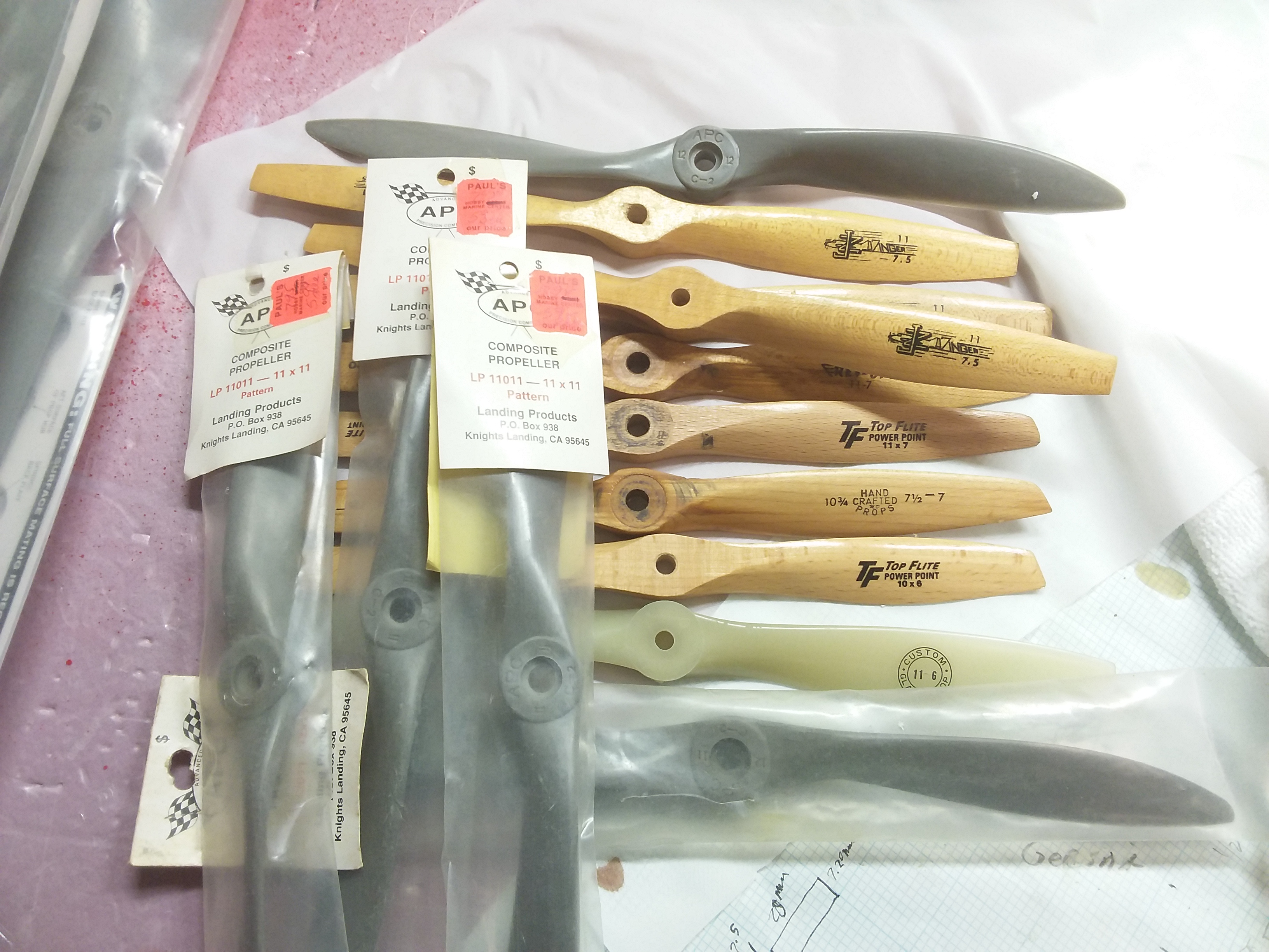

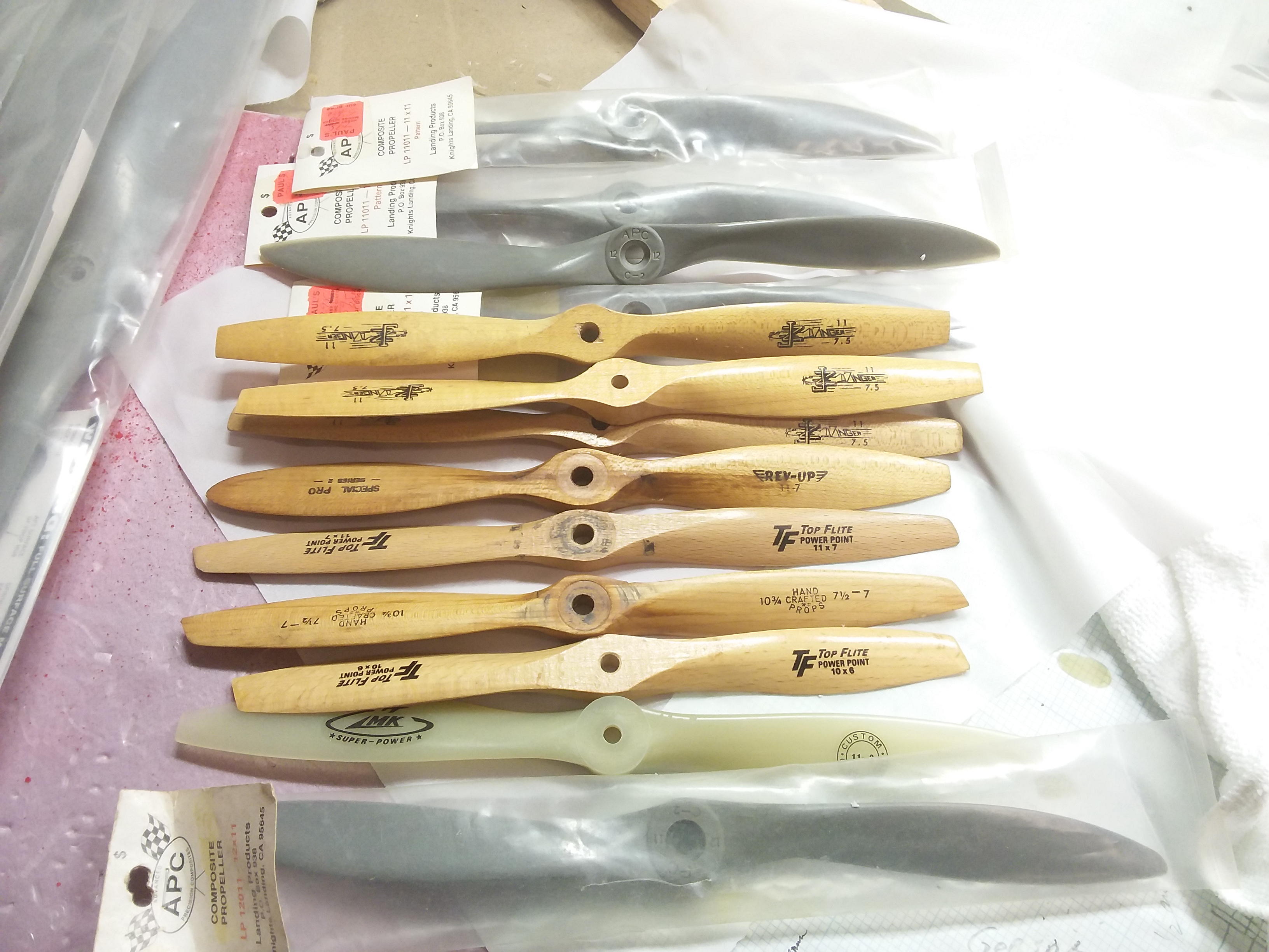

Do not have any props for it just one a 9-5 for break in . Will find out as I learn about the engine and plane setup. New at this size and type of plane.
