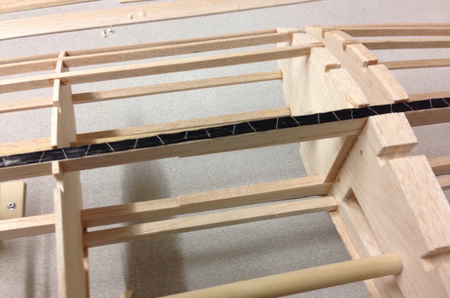

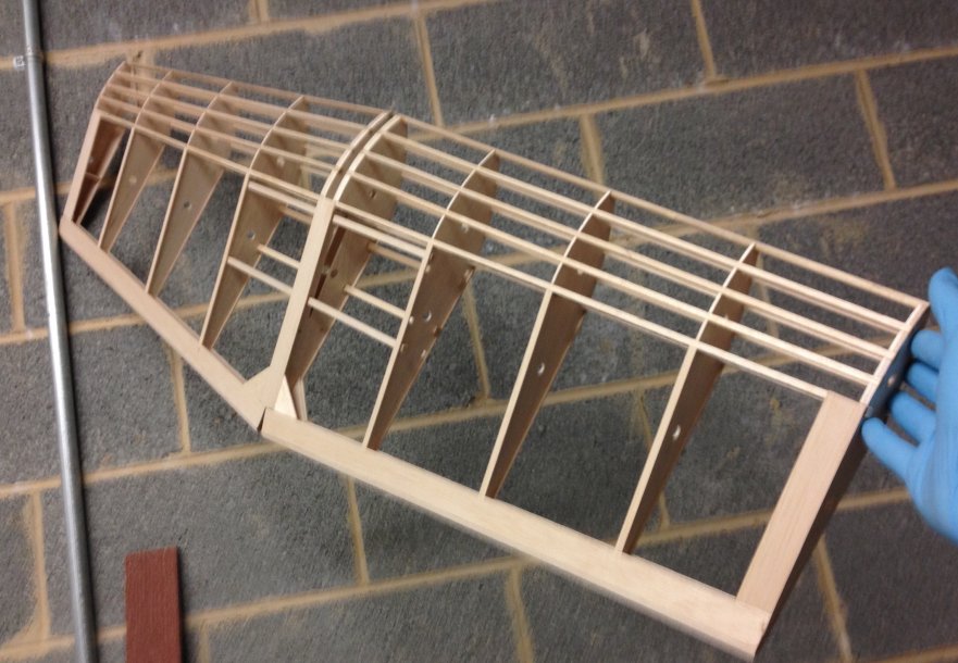

Built a wing this morning. Should be making @pawnshopmike all giggly and happy like a school girl when he sees it.
Interesting thing on this build is the wing construction though. In the first pic you can see where a piece of carbon fiber tow is glued to the main spar of the wing. This makes for an incredibly strong wing and once covering is on it it will have no twist at all in it. Also it was designed to not use shear webbing in the wing. Pretty amazing watching others videos of this plane and how much a use it can take.
