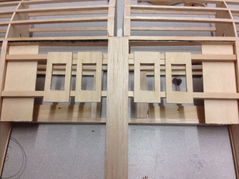

Mike another thing to note on the wild tiger. You see in this picture there are four servo bays in the wing. The outmost holes are for your ailerons and I will have the covering cut and trimmed back on those. The other two are for the rudder and elevator if it ends up tail heavy and needs the weight up front. Bays are also cut in the fuse closer to the tail. I would suggest installing everything in the plane but just tape the tail servos in place before cutting the covering to see how it balances. I will include the push rods and guides needed for the tail surfaces if the servos need to be in the wing.
You Da man Chris. Thanks for the info.:way_to_go:
Thanks. Just wanted you to know before you started wondering why there were 6 servo pockets on the plane. Did I ever email you the link to the designers build thread on the plane? If not I will as this plane has kind of a specific way to go about assembly. Nothing hard but needs to be done in order that's all.
I'm excited for you to get the plane and hear your opinions on it.
