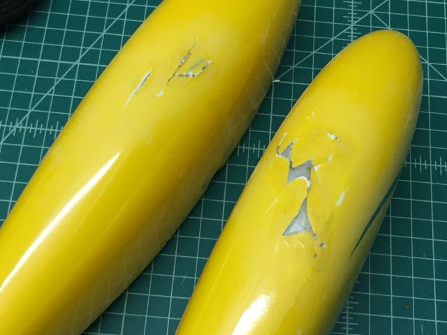

A little fiberglass repair. Had to apply some chewing gum, duct tape and band aids to some wheel pants that got dinged up a bit last weekend. New wheel pants are on order from Herve... these are now the official practice pants... Sounds like a "T" shirt... "You got your practice pants on?" :D
How do you ding up the wheel pants on both right and left sides? I'd rather not talk about the 'incident'... ;)

I'd really like to know. Come on...tell us!:yesss:

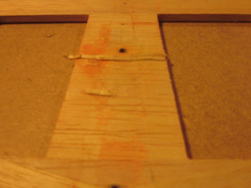

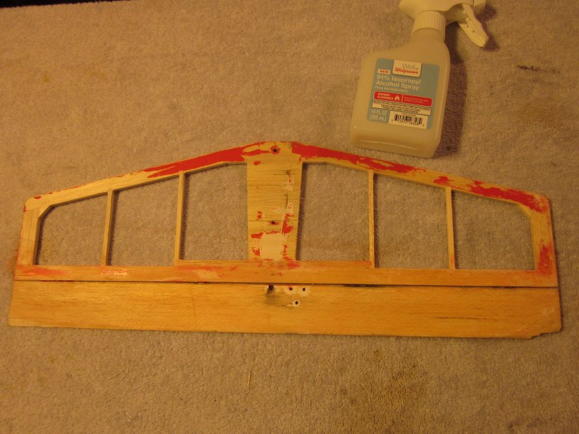

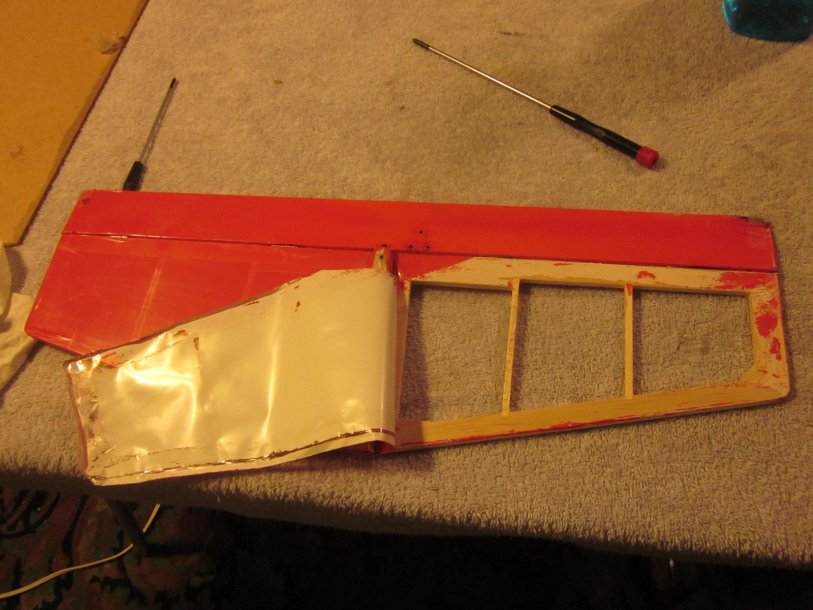

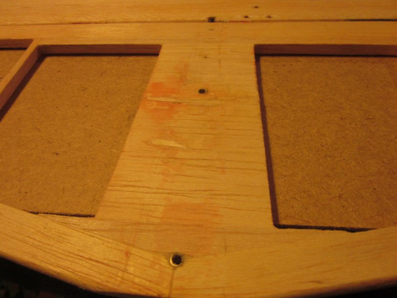

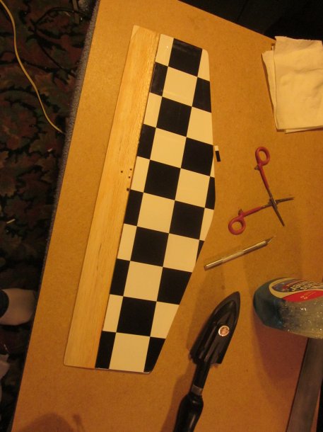

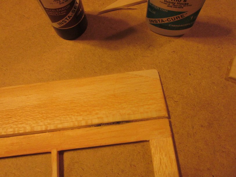

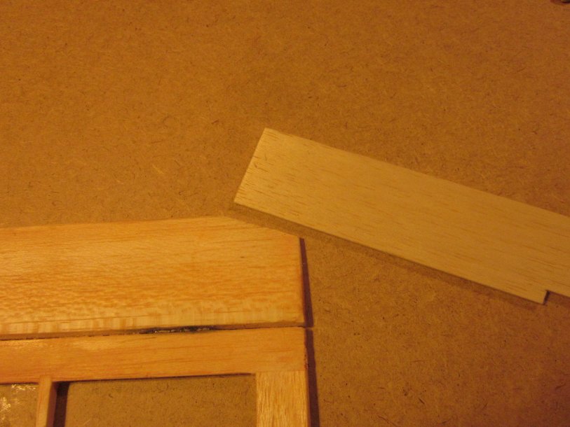

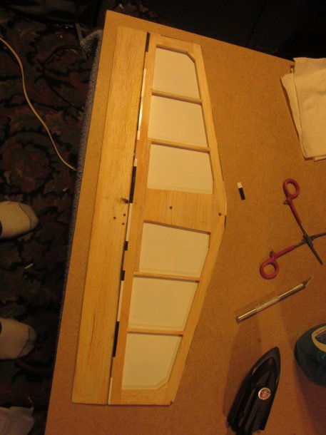

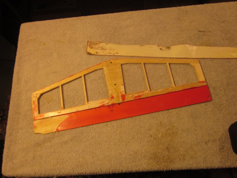

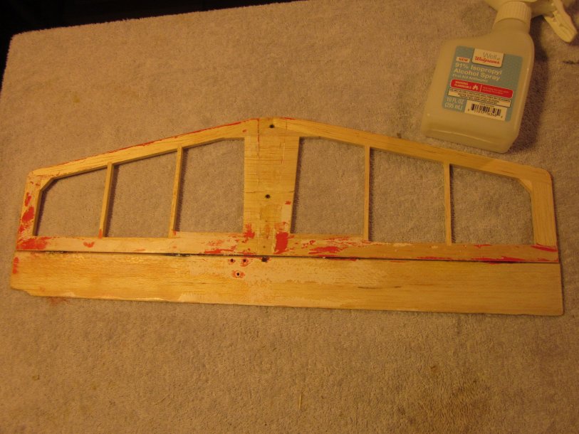

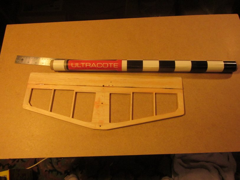

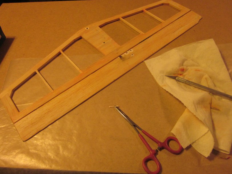

I started recovering the tail feather's on my 100 mph Sky Raider. Went out the other day to fly and all of a sudden the covering on the left side of the horizontal stab came up, and I could see the white on the inside, I fly the Sky Crapper 5 to 15 ft. high

A little embarrassing... 3rd flight on a new PAU extra with a new DA170. I failed to remove the throttle arm idle set screw. Apparently, after each of the three flights it was moving and vibrating further out, preventing me from idling down. It was not apparent until the third flight. When my helper stepped off of the plane, it started moving... and I could not get it to slow down.. it happened pretty quickly, just taxiing around and getting a little bit too fast... I should have just cut the engine, but again, this all happened within a few seconds... it got up enough speed that when it hit this old ant hill it bounded pretty hard... take a large heavy plane, a bounce and wheel pants installed a tad too low and whammo... pretty easy to ding up both wheel pants at the same time... so, couple of lessons... remember to pull that stinking throttle arm set screw off and pay close attention to the wheel pants installation !! :)

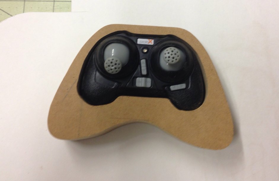

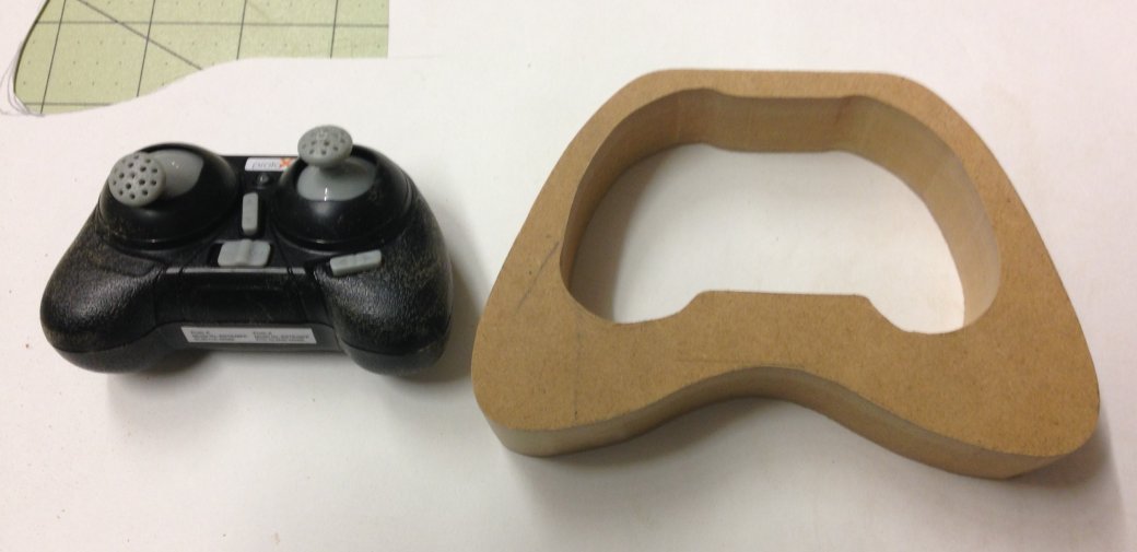

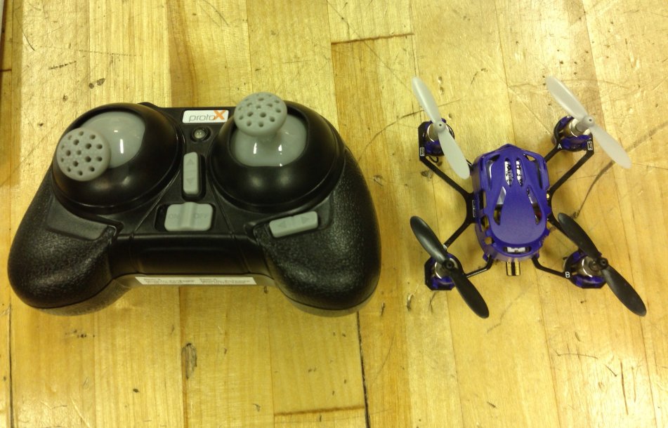

So I picked up a new toy yesterday. Estes Proto X. Fun little quad to fly but I saw some problems all with the controller. First I don't have big hands but I don't have small hands either and this thing is just to small to hold comfortably especially when I'm a stick pincher not thumb flyer. Second the sticks are so short that the smallest stick movent results in drastic movement of the quad.

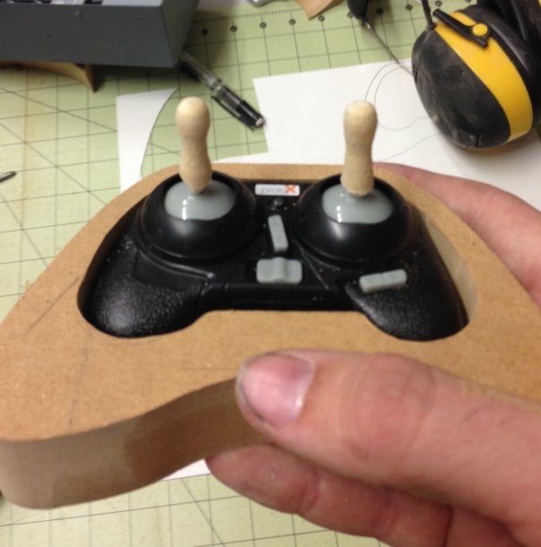

So I had this scrap piece of 1" thick MDF in the shop so I basically made a new controller around the old one. It's now about the size of a XBOX360 controller and feels just about perect to me. Also pulled the little knobs off and extended the joysticks a bit. Easier to hold and the longer sticks in effect act as mechanical expo.
Now to make a nice carrying case for it all but first off to put the first coat of clear on all the sanding blocks that need to be shipped out.

Crafty little devil aren't ya?:way_to_go:

Well that just sucks. Man, I've done worse. Glad it was only your pants that need some attention. Any worse and it could have been your shorts.:lol2:
