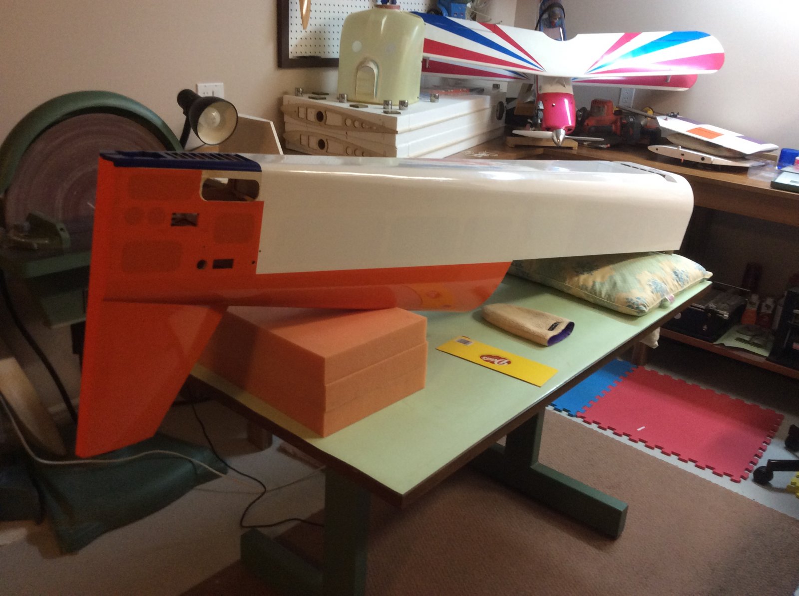

IMG_1420.JPG Started covering my ViperSt got most of the fuselage done just have to put the striping on the fuselage to try to make it look good.

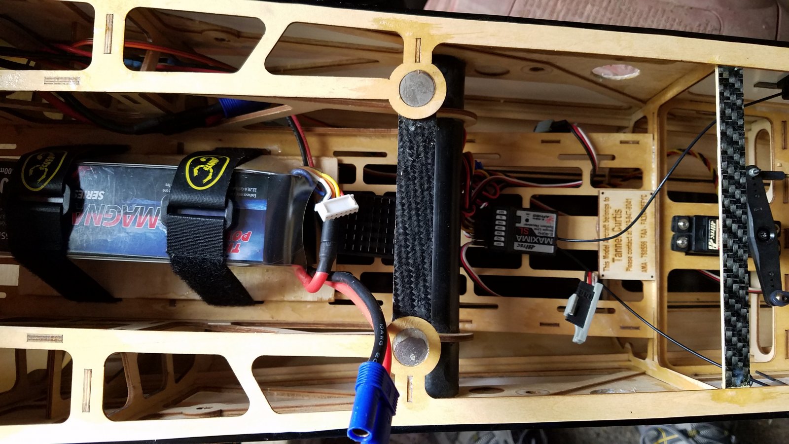

Did some much needed work to the Aerobeez 70" Slick. First up was installing a new plywood battery tray out of 1/8" ply. The factory tray gave way where the straps run through it after probably close to 300 flights. Just cut up a new tray the size of my batteries, epoxied it in place, and stuck some velcro ontop. She's not going anywhere. Also fitted one of my new plywood name badges inside :)
Looked over the rest of the airplane while I had it on the bench, nothing I can see out of place but the rudder cables were a little loose.

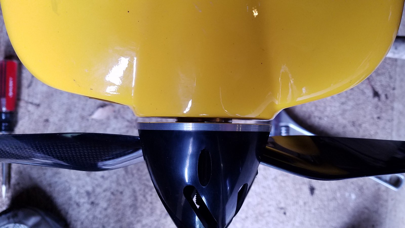

Next up I decided to get rid of the hideous 1/4" gap between the rear of the spinner and the front of the cowl by trimming the dowel standoffs a little more than 1/8". I also added some shims on the bottom mounts to bring the motor back to level- was able to determine that the downthrust was causing some of my trim and coupling issues so I adjusted it back out. I have yet to test fly the airplane to see if this was really my problem....
Lastly I replaced the rubber grommets on the cowl bolts with bonded washers. She's all ready for another 300+ hard flights!!!

I am with you just do not like seeing a big gap between the cowl and spinner. And when I do I just cannot stop looking at it and saying I need to fix that.
