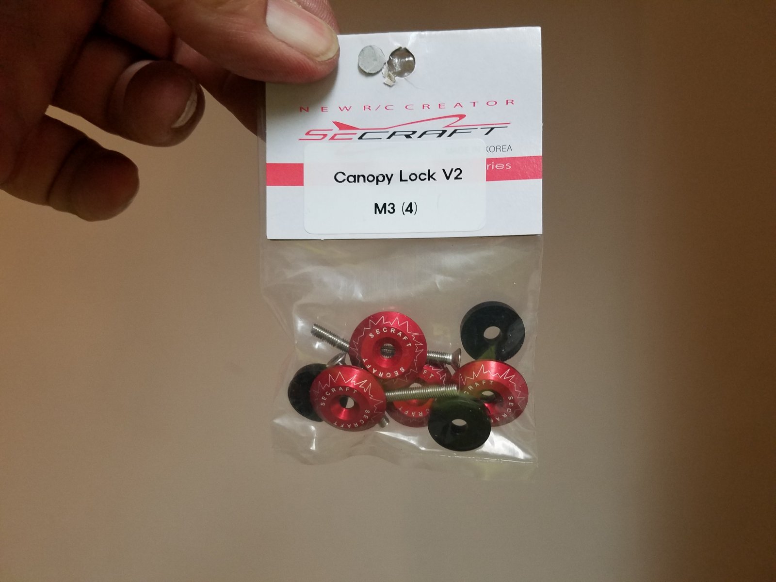

Secraft canopy locks for the Edge.

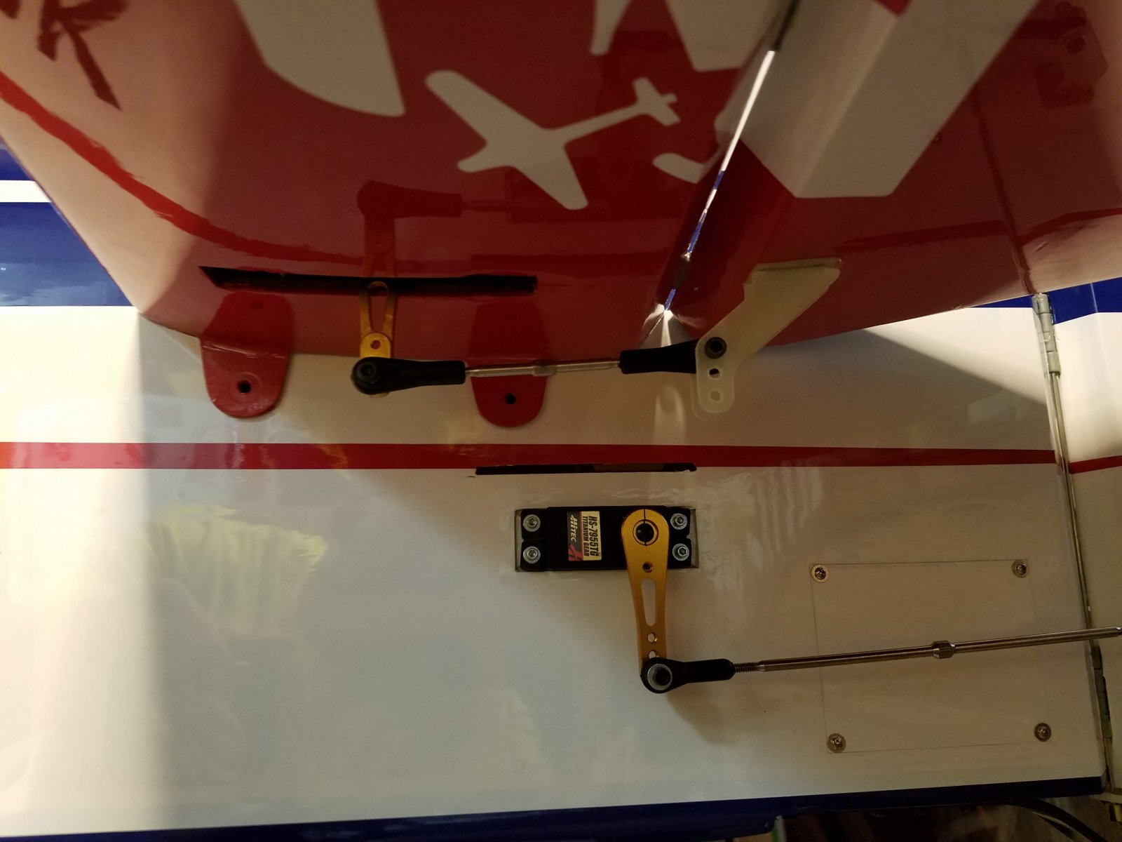

I was only able to get the servo arms on the elevators and rudder installed and dialed in. Another plus of having a previous 100cc Pilot Edge programmed in your radio. Basically bolt and go.
Very minor tuning was necessary to get them dialed in. As we all know, no two servos are identical. Also, since the first Edge sported Hitec HS 7954's and this one 7955's there was a slight variation. But once final max throw and final tuning is complete it should be better than the first Edge.

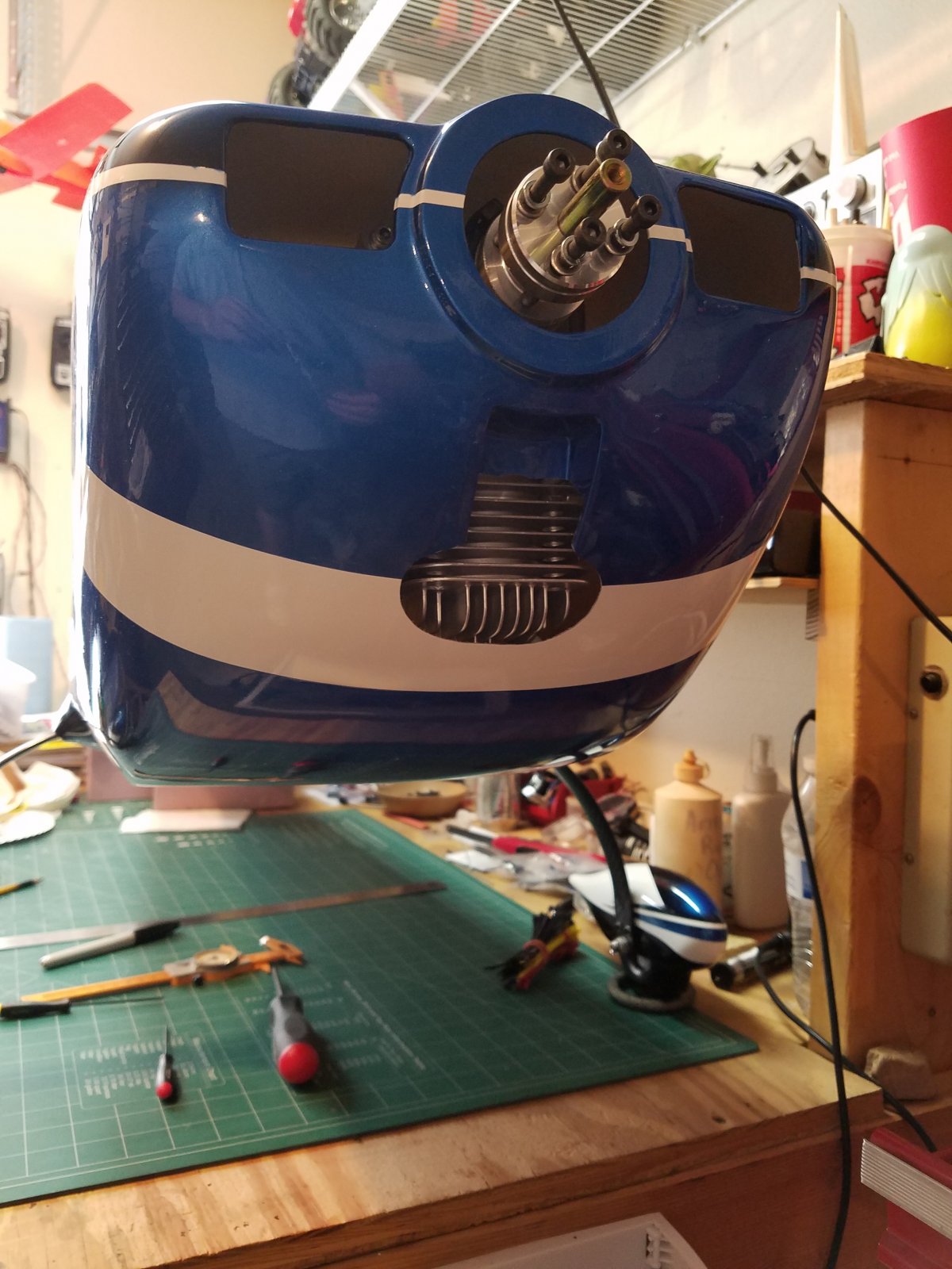

View attachment 95269 View attachment 95270
Nice P&W R985! I've replaced several of those engines on the DHC-2 and quite a few jugs. Remember to index that 90deg to the right so the eagle is at the bottom :In_love:
