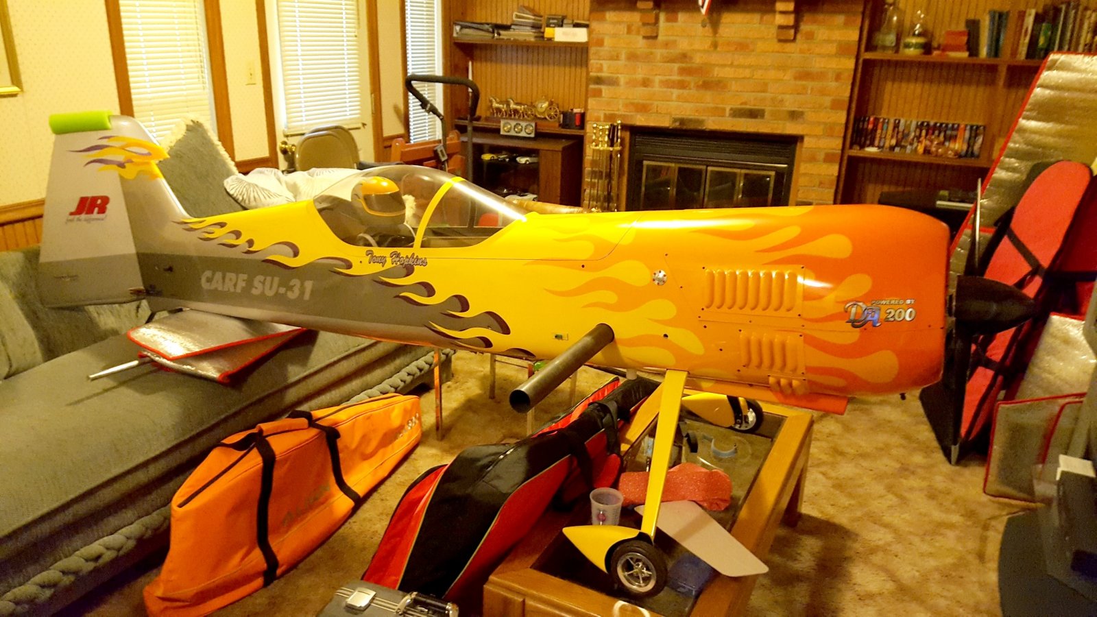

It's here! And somehow we managed to get it through the door, but it fought us mightily.

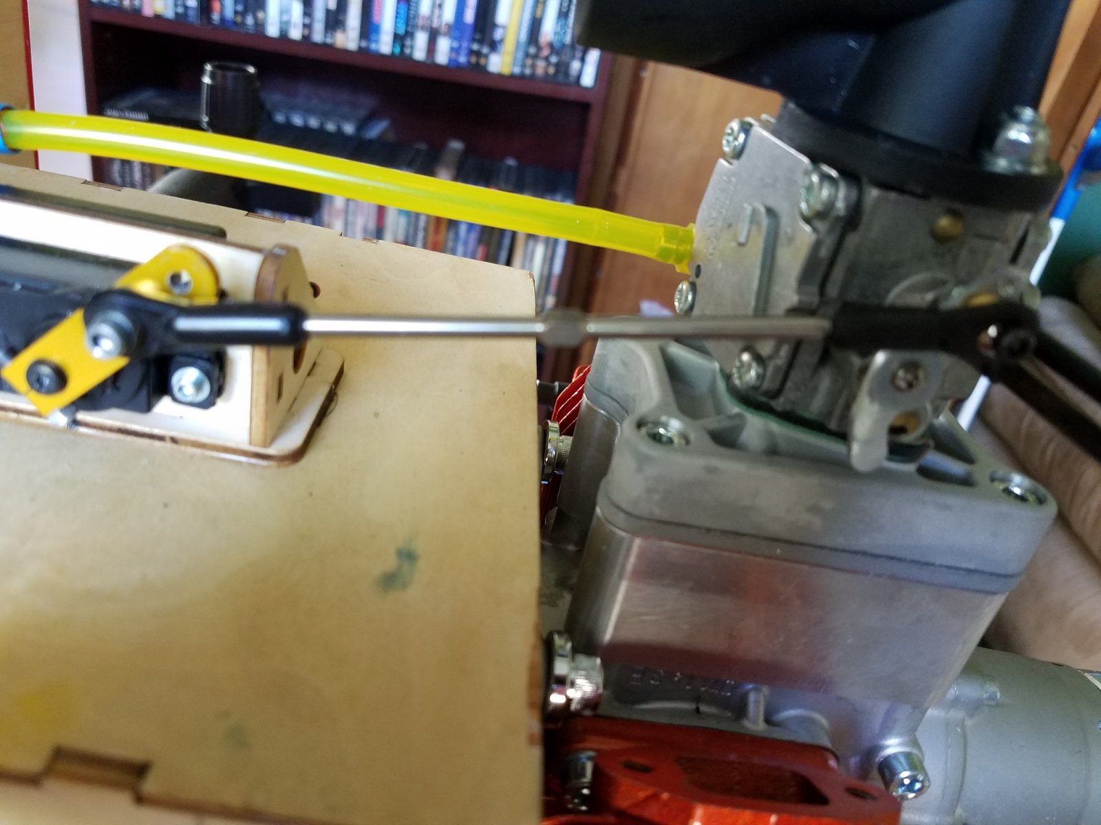

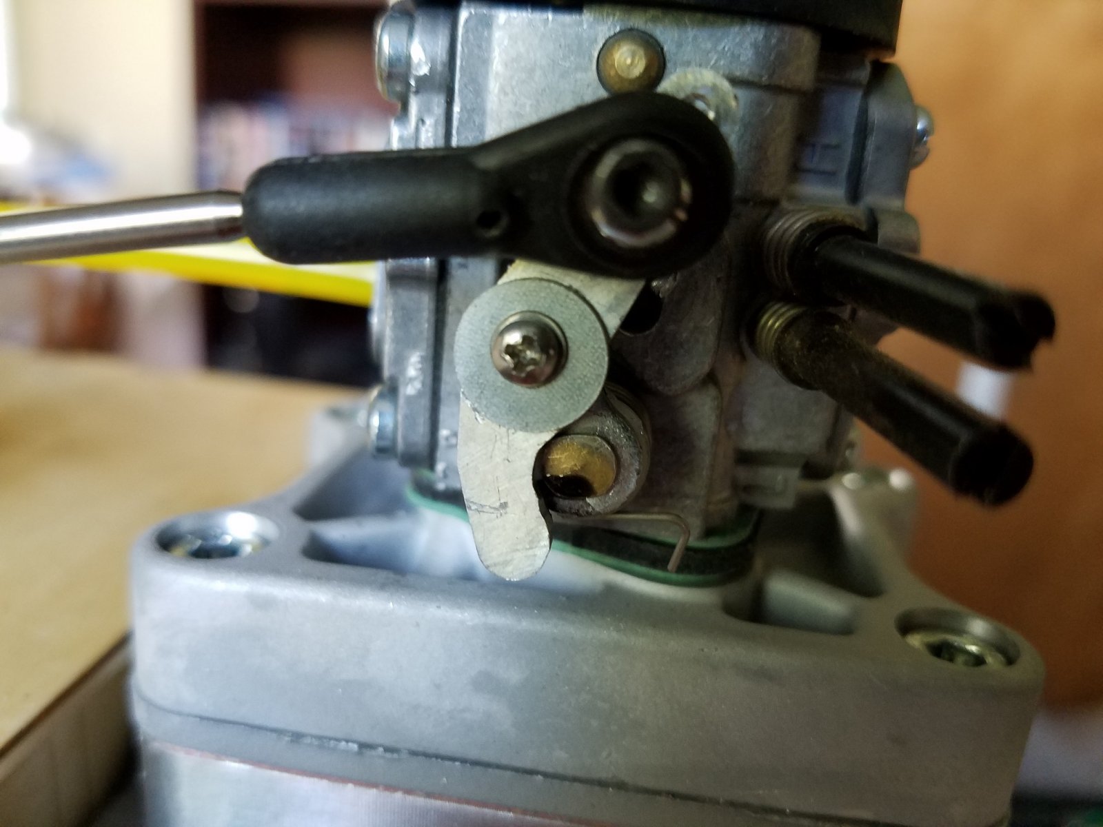

I was quite shocked on my way to the field this morning when I pulled up behind Tony and he had the SU31 with him. Unfortunately he didn't get to fly it. We had a ton of trouble getting it to run. Four of us will have sore shoulders in the morning. It turns out the throttle servo went south. It has a metal gear 400 ounce JR 8711 on the throttle which should be about bullet proof on a throttle, but it seems to have a gear train problem.
We had finally got it started when I had the throttle at about half. But, the second I would throttle back it would quit. It ran perfectly from a little less than half through wide open, but would just quit under that. Then I heard something odd. When you worked the throttle under half you could hear the servo motor spinning free. Over half it sounded normal. So I guess that adds another upgrade to the list.
