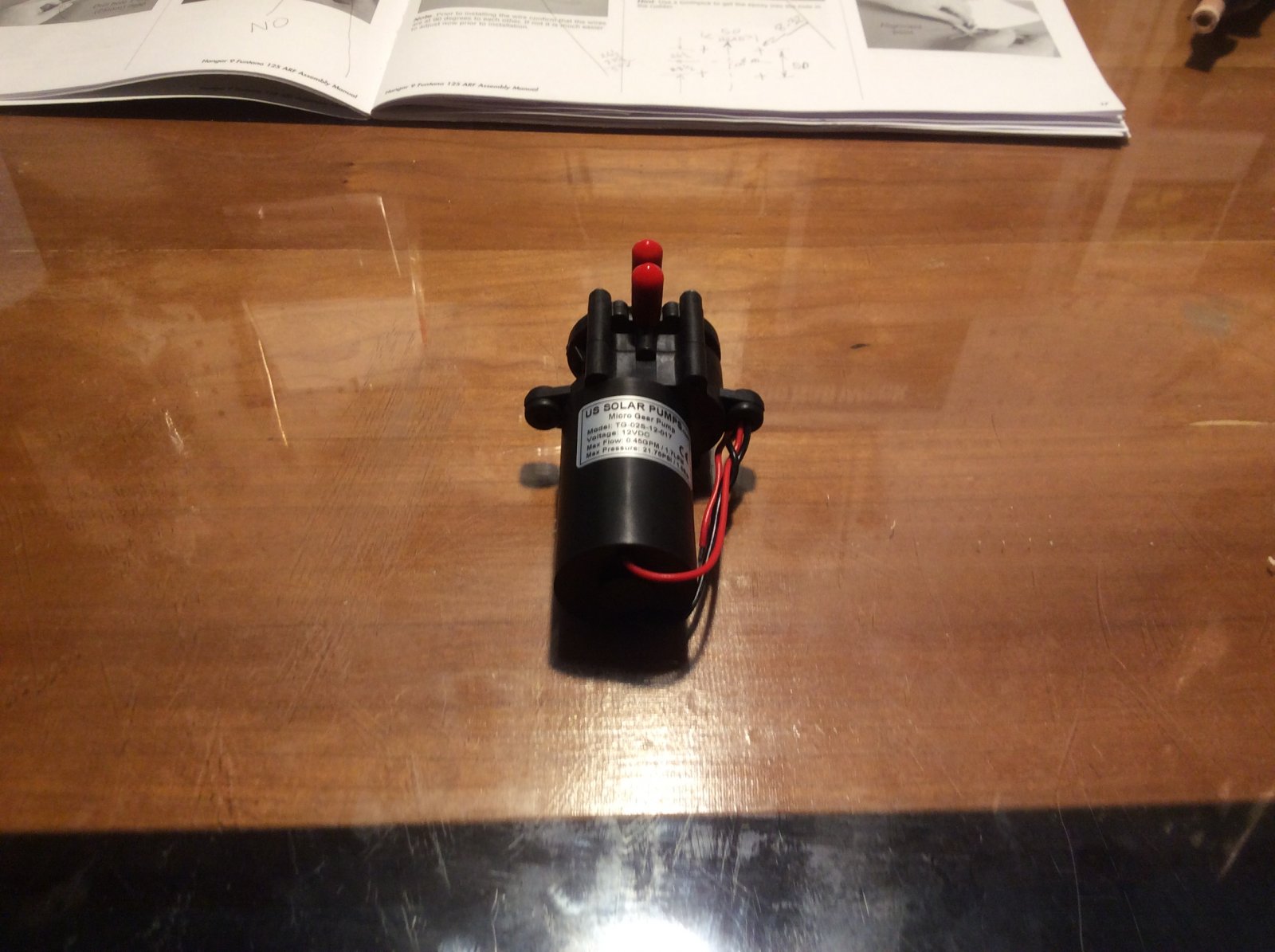

Just received this little gas pump from Amazon. Looks good. Now I have to build a box complete with switch and batteries to fit with or on my jerrycans. Gather all the parts first and then figure out how to do it.
1/2 a gallon a minute at 12 volts and runs in both directions.

I would test it for gas use before doing much, the mfg does not list it for fuel, only list food industry type apps.
Got the info from the People on GSN and have been using it successfully, so I thought I would give it a try.
Thanks for the heads up anyway. I will be careful when connecting it up. The motor is well shielded and comes with a complete rubber boot in closing the motor.

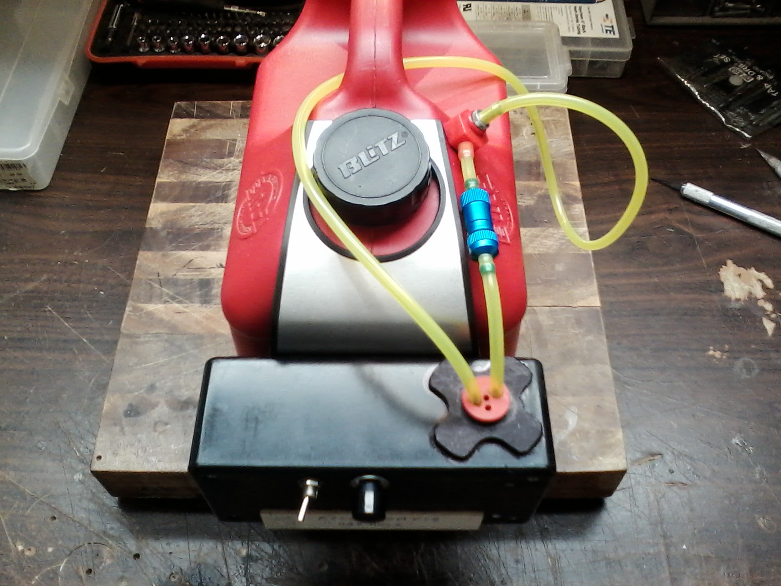

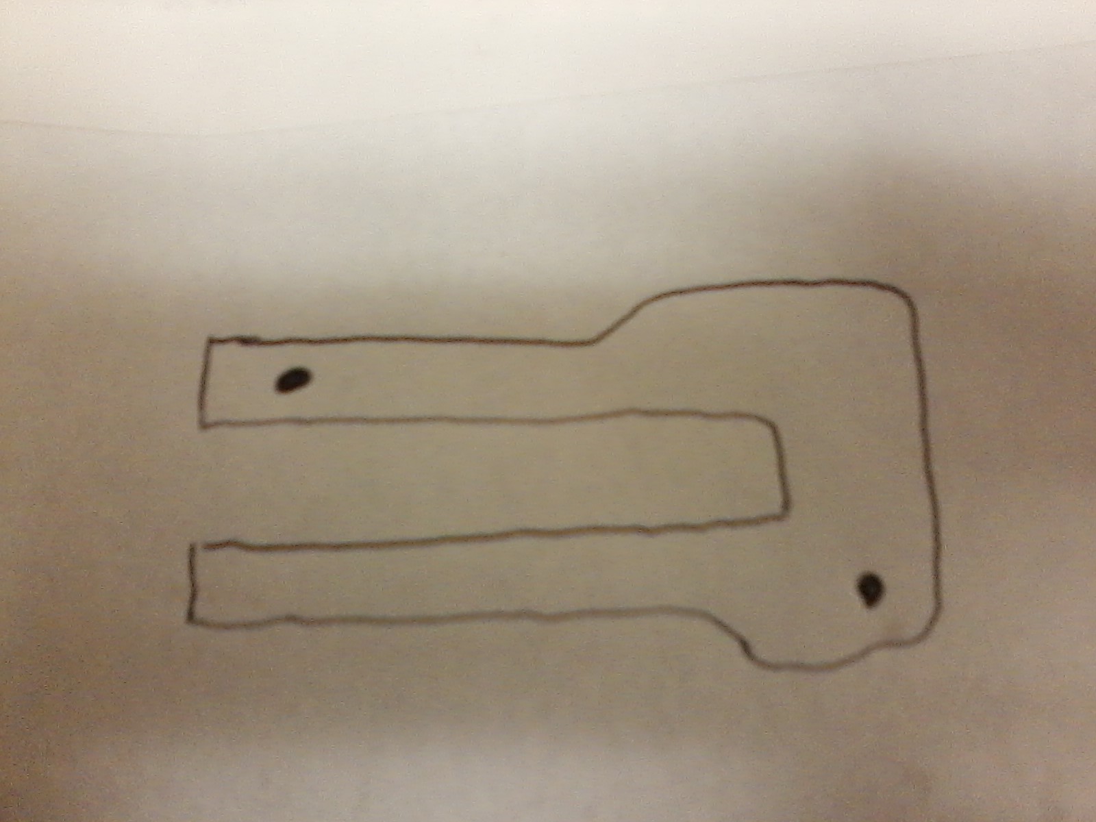

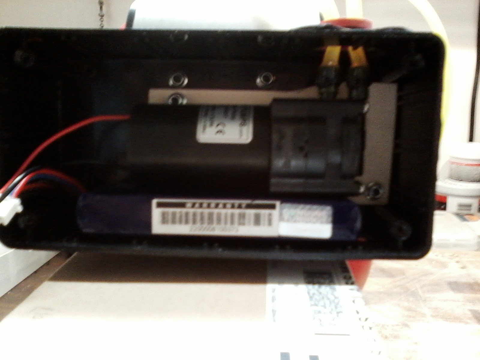

I used a 6"L x3"H x 2"D plastic project box, Micro 3amp DPDT toggle (for reversing) and a momentary push on switch. All parts can be had at Radio Shack if one is still open in your area. I fabricated 2 laminations of 1/16th light ply to make a mount adaptor. I used baking soda and thin ca to mount the pump "cradle fashion" to the adaptor and then bolted it to the inside of the plastic box using two 3mm lock nuts and hex cap screws. Here is a rough drawing of the adaptor. I had to remove the grommet mounts from the pump body. I imagine you could find a "slim" 3S pack to fit but I just used a 2S that I had on hand and it fit snugly in and works fine @ 12oz minute. I did do a pump time test to see how well it pumped on a 2S. It is also very quiet which is a plus. Last pump I built was noisy as hell.
