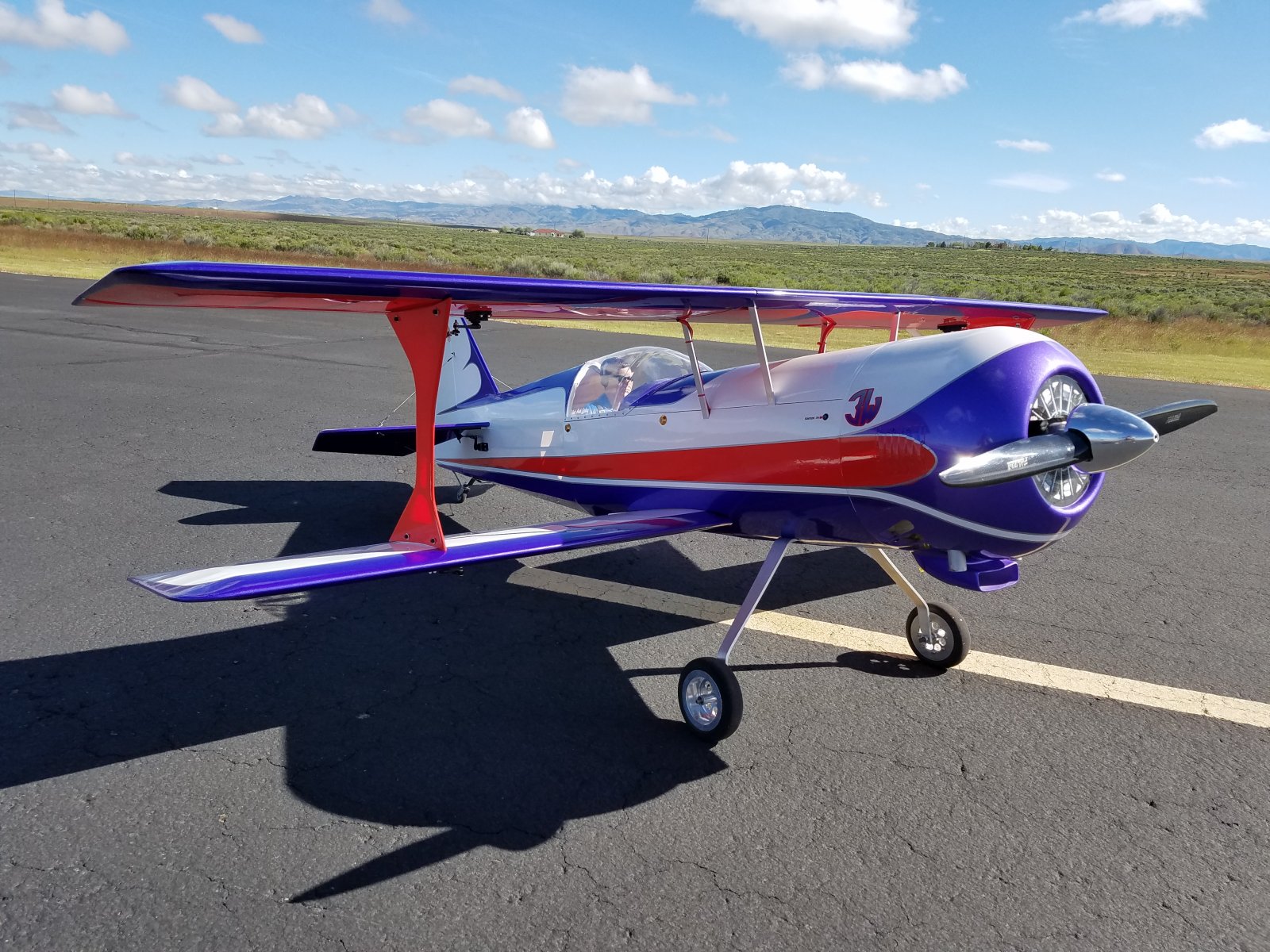

He promptly refunded the cost of the White paint, in which I went to..(believe it or not), to our local Home Depot...matched the color of white I needed and purchased a can. I think it cost me like 4 bucks with tax. It turned out really nice. But I had to be "really" careful when I clear coated the red and the purple. The white already had a clear base mixed in it. The clear required with Wings West paint will eat any other paint. I had to mask off the white completely. Once the red and purple was cleared, I removed all the masking paper. So far both the red and purple as well as the white have held up really well. No blemishes and no problems with the paint.

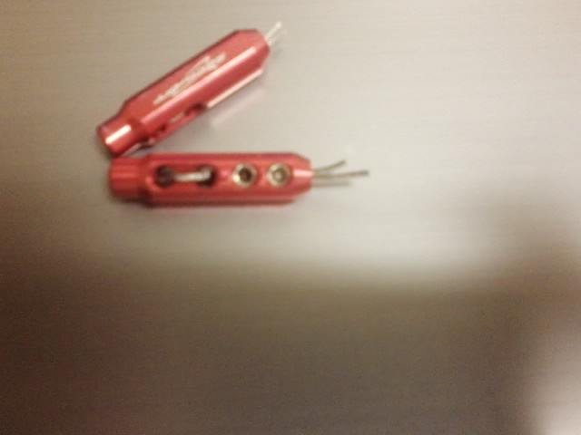

Get you some Seacraft tensioners. Go real nice on that real nice ARS.
See what ya mean. Not a "necessary" item. They do make setting up the pull pull with a centered rudder servo a bit more easy and give better protection from a broken cable at the "load point" by making two load points. One at the dual set screw keepers and one where the cable wraps back through. I have had "standard" ball link tensioners actually cut through the cable.
