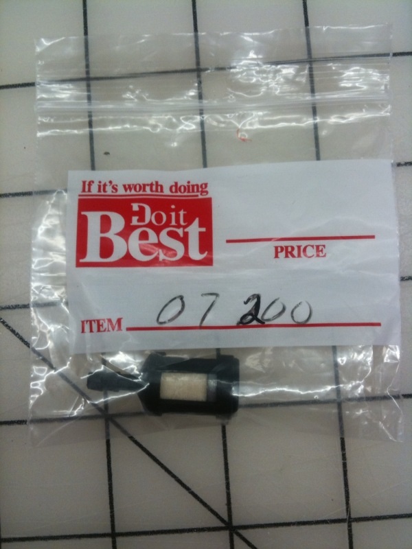

Let me know if you can't find them. I'll mail you some.
I found a ten pack on amazon for $3.00!!! Type in "ZAMA fuel filter" and it pops up in a few styles. ZAMA is owned by STIHL and was used in Homelite products as well I found out. There are a lot of china knock offs... everywhere. STIHL is made in the USA.
ZF-1 is for 1/8" line there is an original with one barb, newer version with two barbs I believe. designed for 30cc and under I think.
ZF-2 is for 3/16" line
ZF-3 is for 1/8" line and 30cc and larger
ZF-4 is for 3/16" line 30cc and Larger
ZF-4 is for 1/4" line 30cc and Larger
I am going to get some ZF-1's and ZF-3's and compare. That was some fun research!

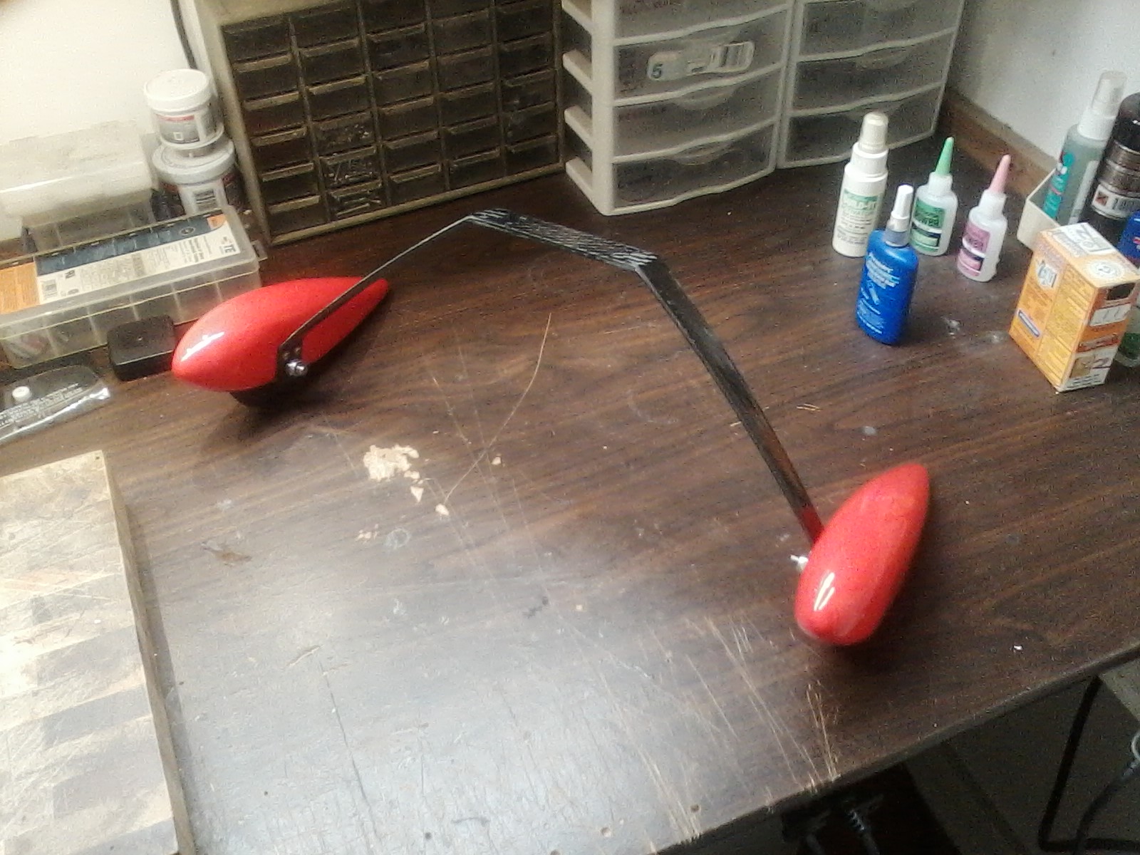

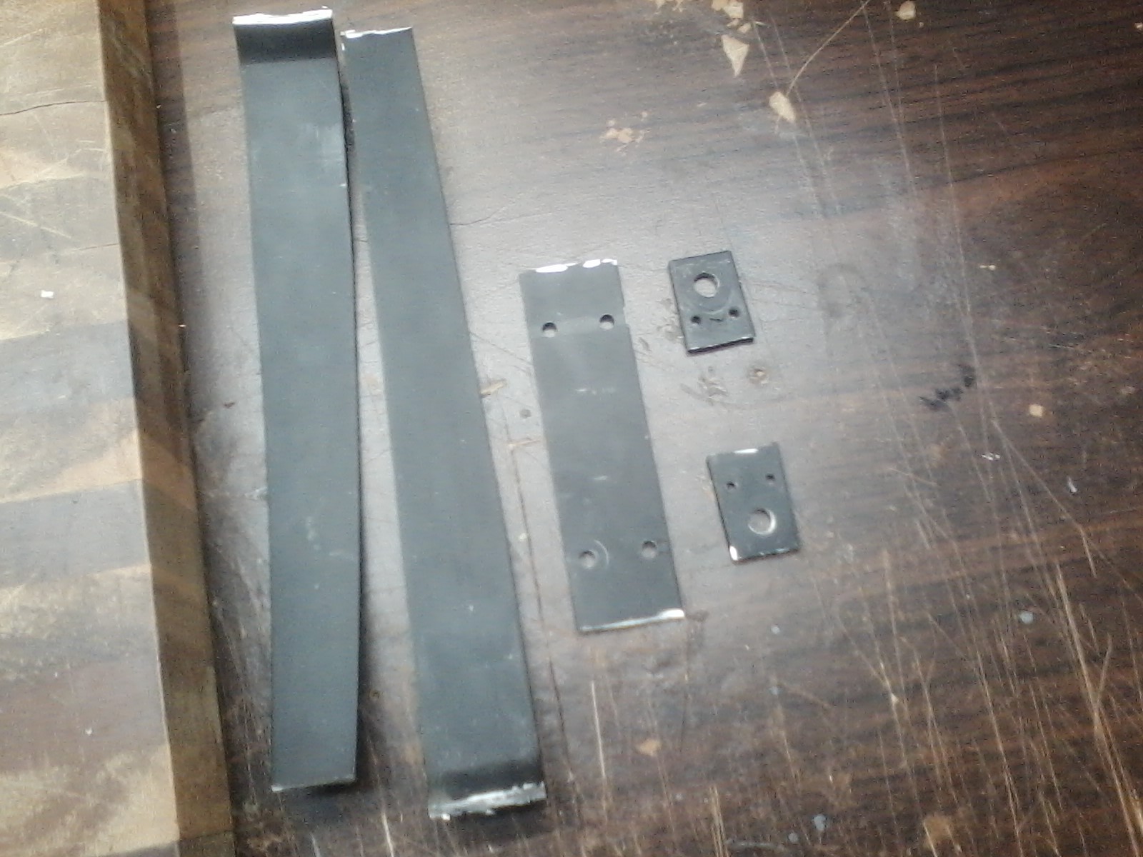

Got a carbon fiber landing gear "bored" for pants/wheels and fuse attach. Installed the pants and wheels. Going on my buddies Edge. The stock aluminum gear was pretty flimsy so I guess he wont mind that I destroyed it making templates :D.
