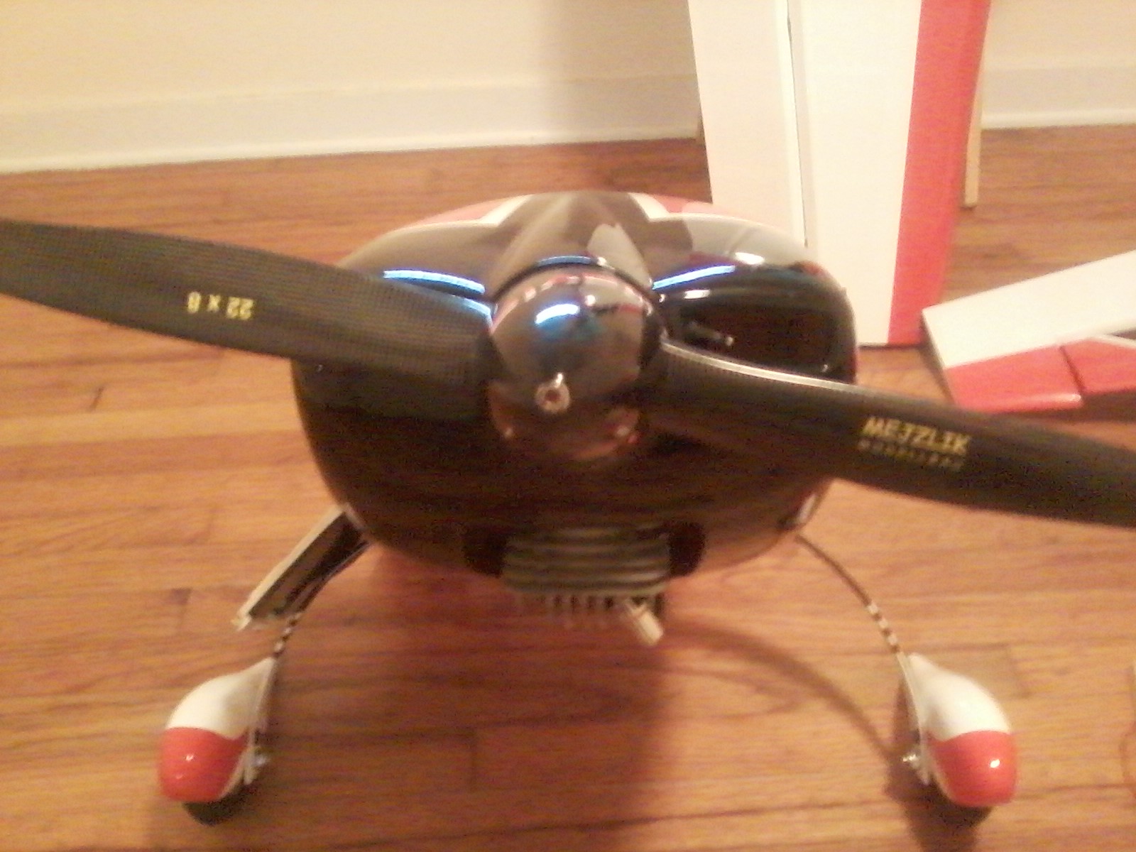

I started working on the cowl today... still no mufflers yet though. So that part will have to wait. But I cut a preliminary air exit hole and made the baffles.

Today, I came home to a beautiful box from FedEx that had the new correct mufflers :). So today, I installed those and cut the holes in the cowl. I also moved the ignition to the bottom side of the plate to put it inside the fuselage instead of setting on top of the motor box. That really does make it look much cleaner.
