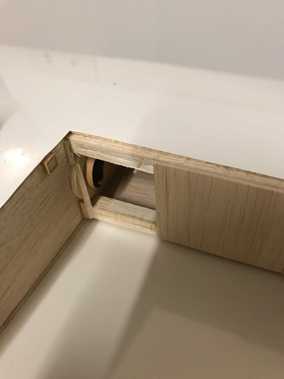

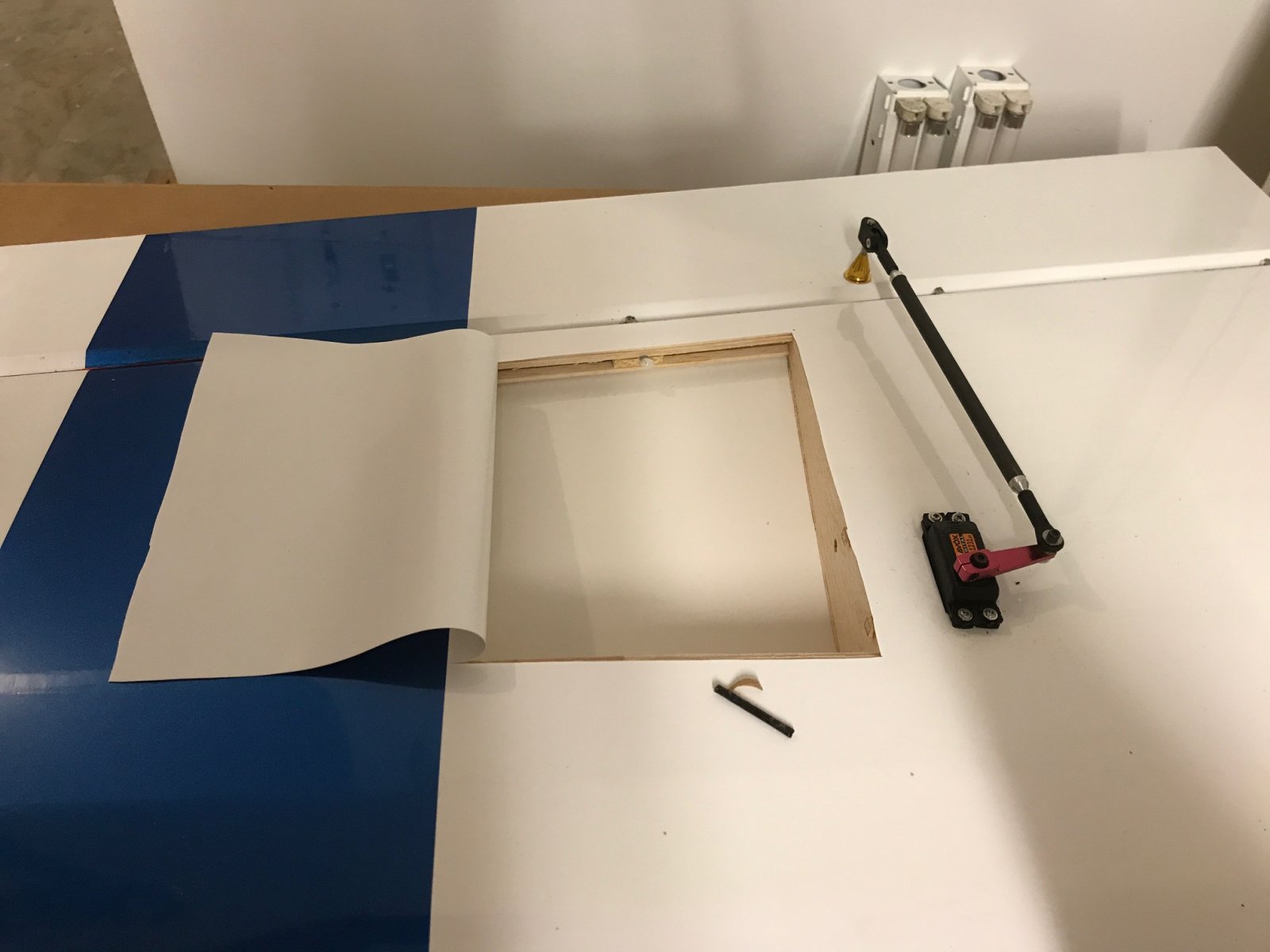

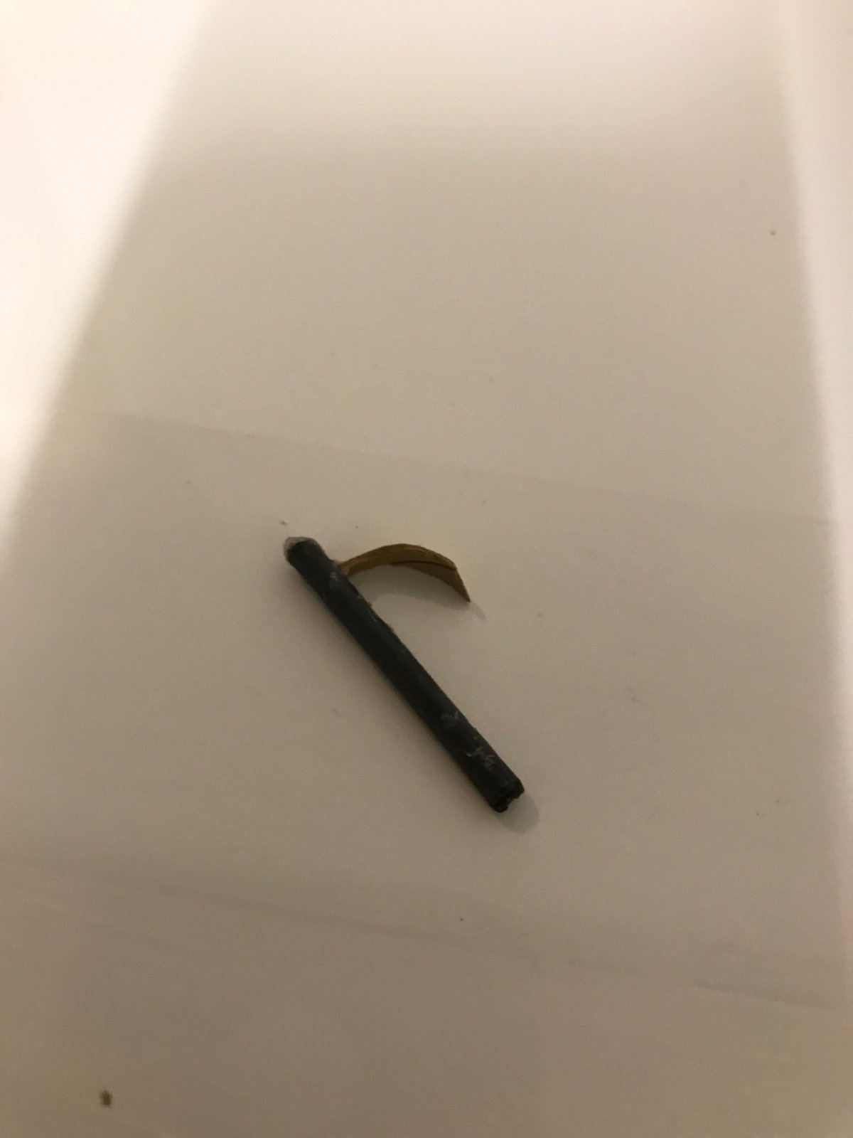

heard something rattling in the wing of my 55cc profile. Found this which is the pin at the end of the wing tube phenolic to keep it from going to far into the wing.
covering is cut back. It was hard to cut into a pristine covering job.
Some of the sheer web removed to get to the end of the phenolic. Didn't take any pics of the repairs but basically I glued the pin back in then glued in some bracing around it to keep it from coming loose again.
Overall I'm happy with it but it still sucks to have to cut into a good wing.

Have to agree with you cutting into a new wing is not fun, but sometimes you just have to do it. The only thing is is the other side ok. Nice fix.

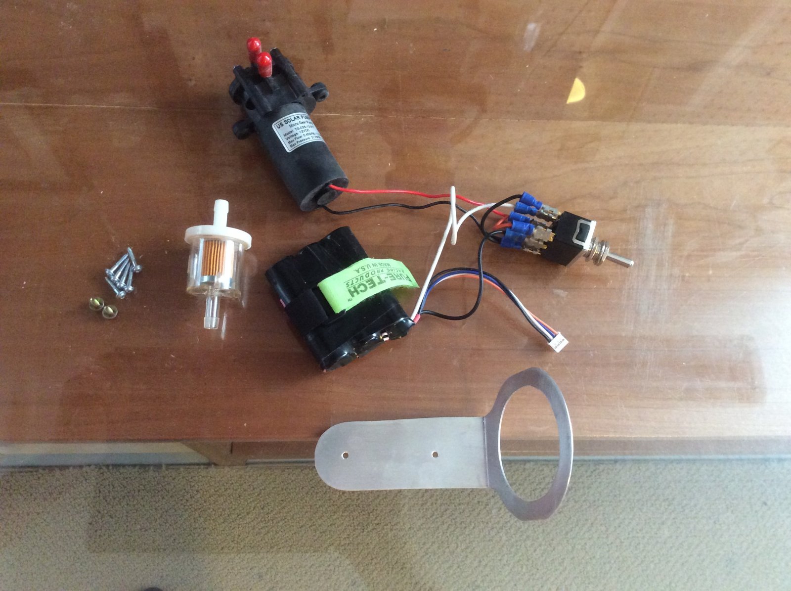

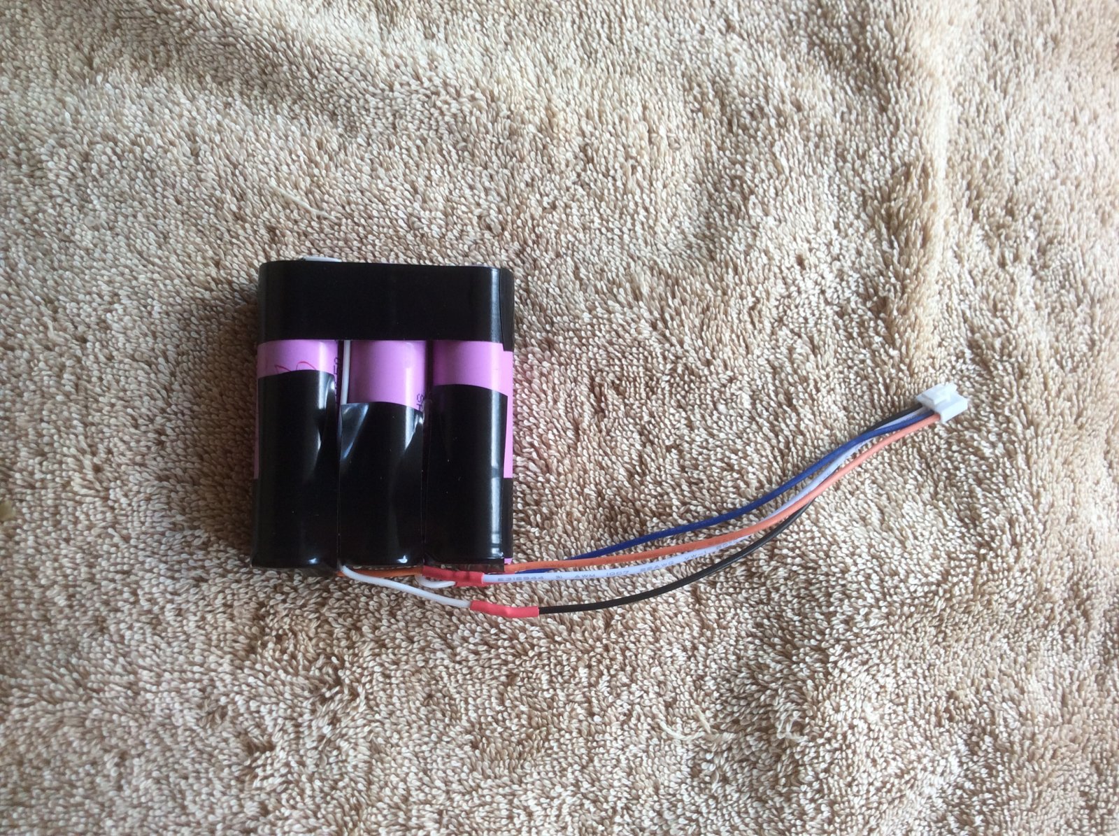

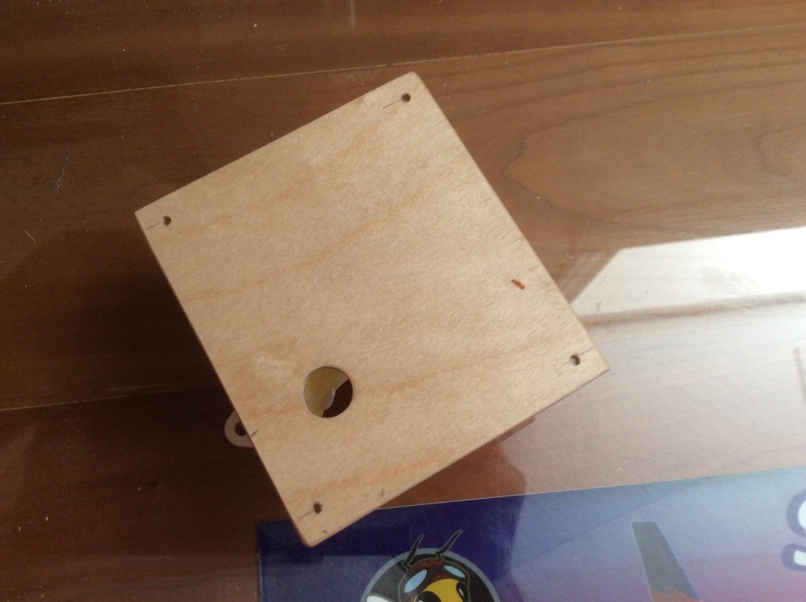

Well the gas pump is almost done just have to wait for the urethane to dry. The electrical is all done and battery checked out ok. Can you believe I was sitting down ready to wire up the switch, motor and battery and I could not remember how connect a DP/DS six pin switch, I had to get out the multimeter and figure it out again but it is done and working. When all is dry it will be assembled and ready for use hopefully it works for a while. Just have to get the connections for the tank and fuel line and then assemble it to the jerrycan.
