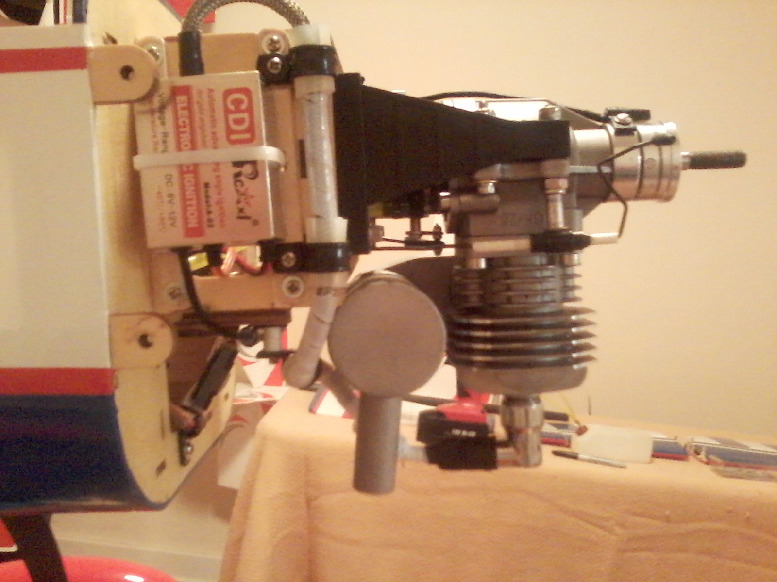

Actually "metal off metal" would be more accurate. Loose or "oversized" plug caps can cause "Arching" and result in RFI. Also keep in mind that the higher the input voltage the higher the voltage to the spark plug.
Examples..
Input- 6VDC = 12 to 14KV. That's potentially 14,000 volts to plug.
Input- 8VDC = 16 to 20KV. That's potentially 20,000 volts to plug and greater potential for "arching" in the plug cap from a loose fit.
True. I did see fretting on the plug cap, I'll have to look closer for arching. I tightened the spring, goes on with more effort. I do want to believe that the looser cap could have made my radio loose connection briefly two-three separate times, and why my first flight was flawless.. hmmm

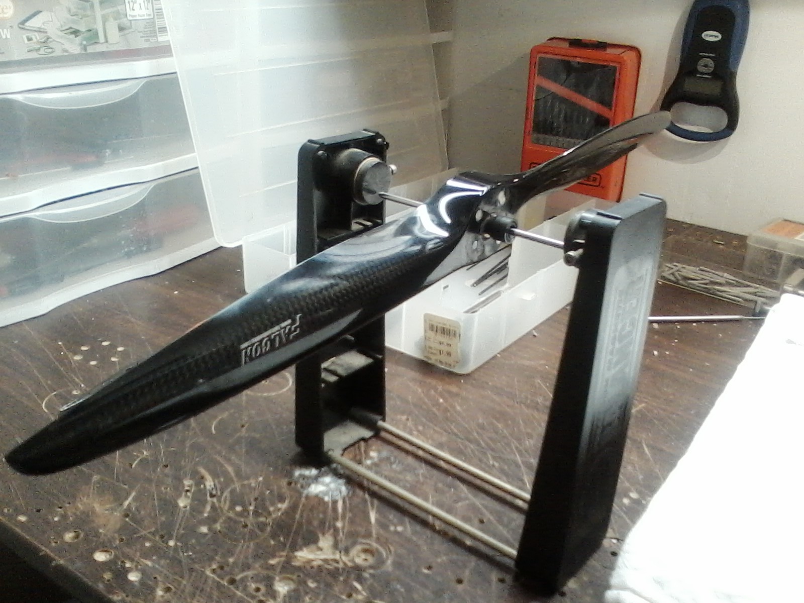

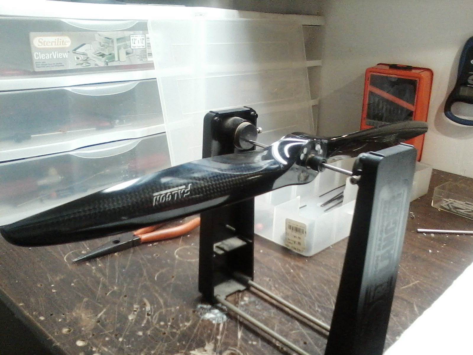

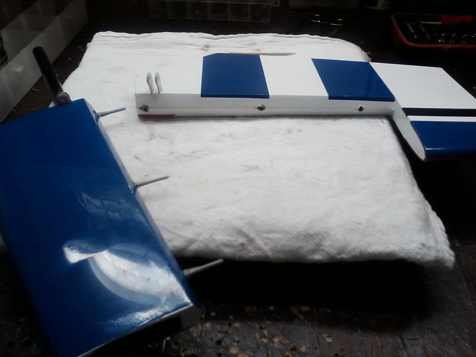

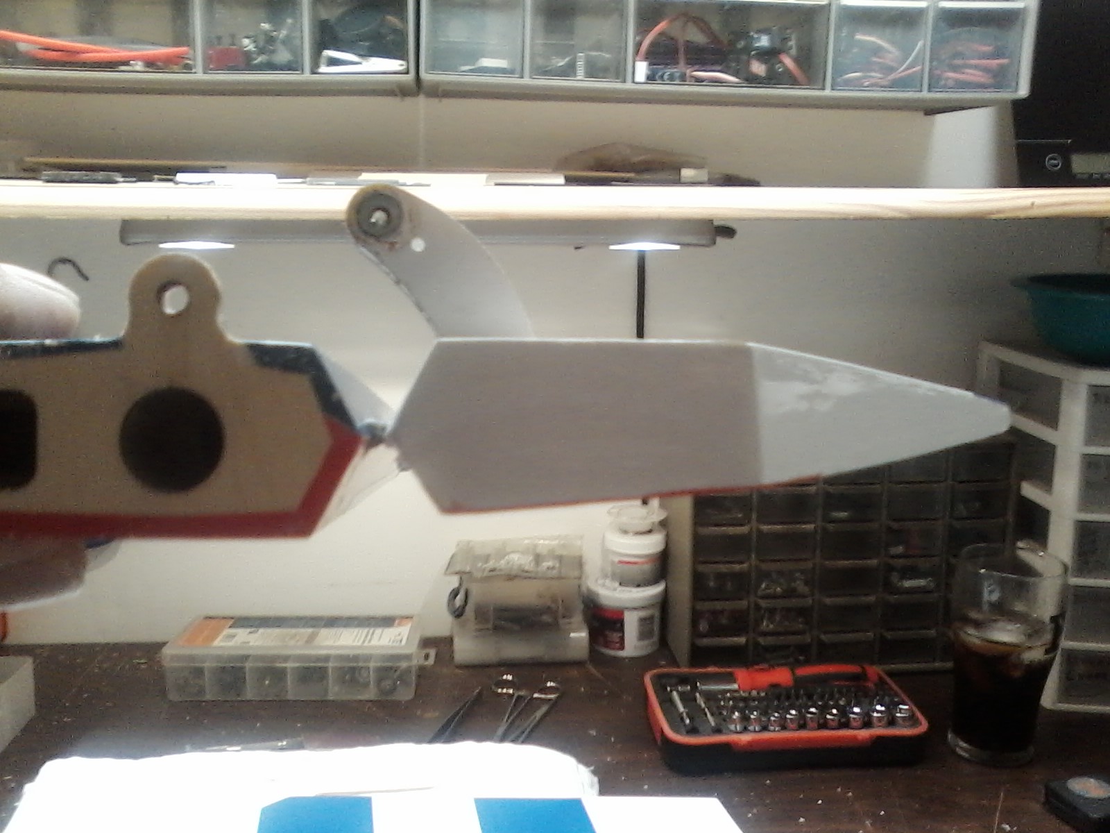

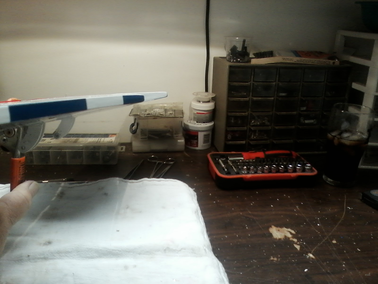

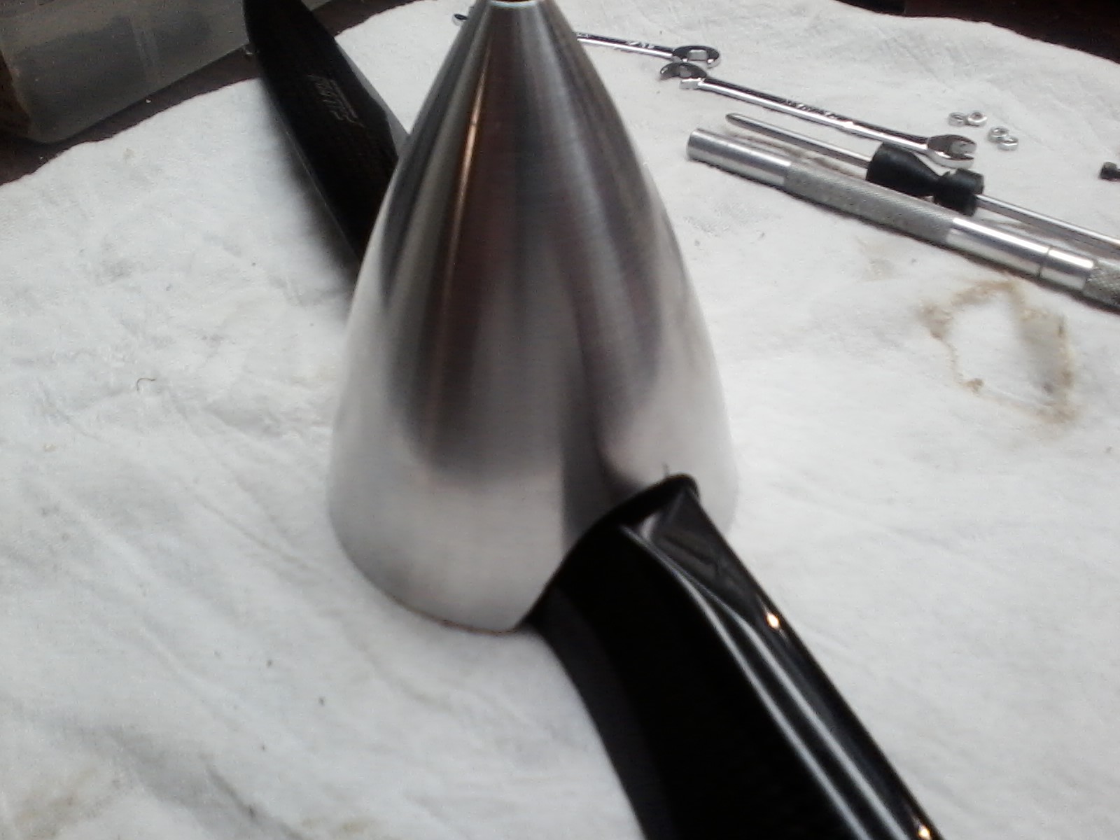

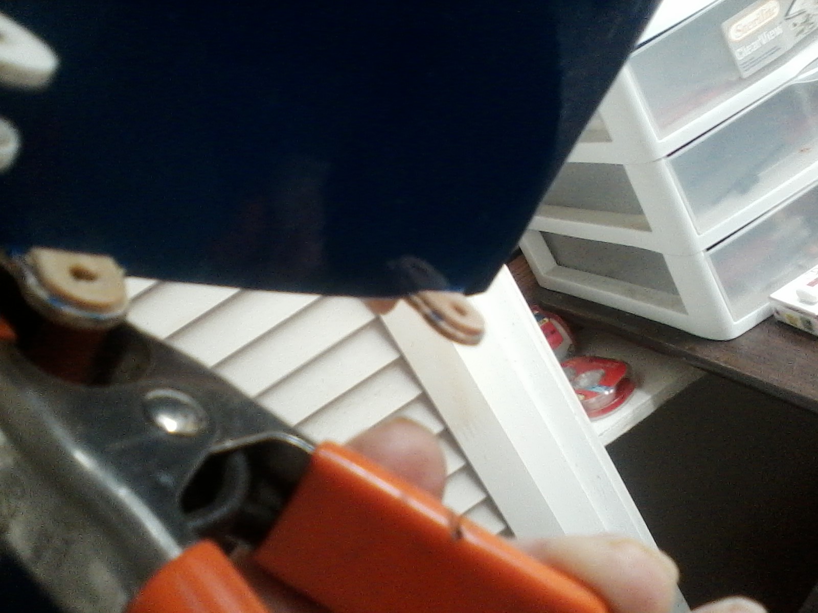

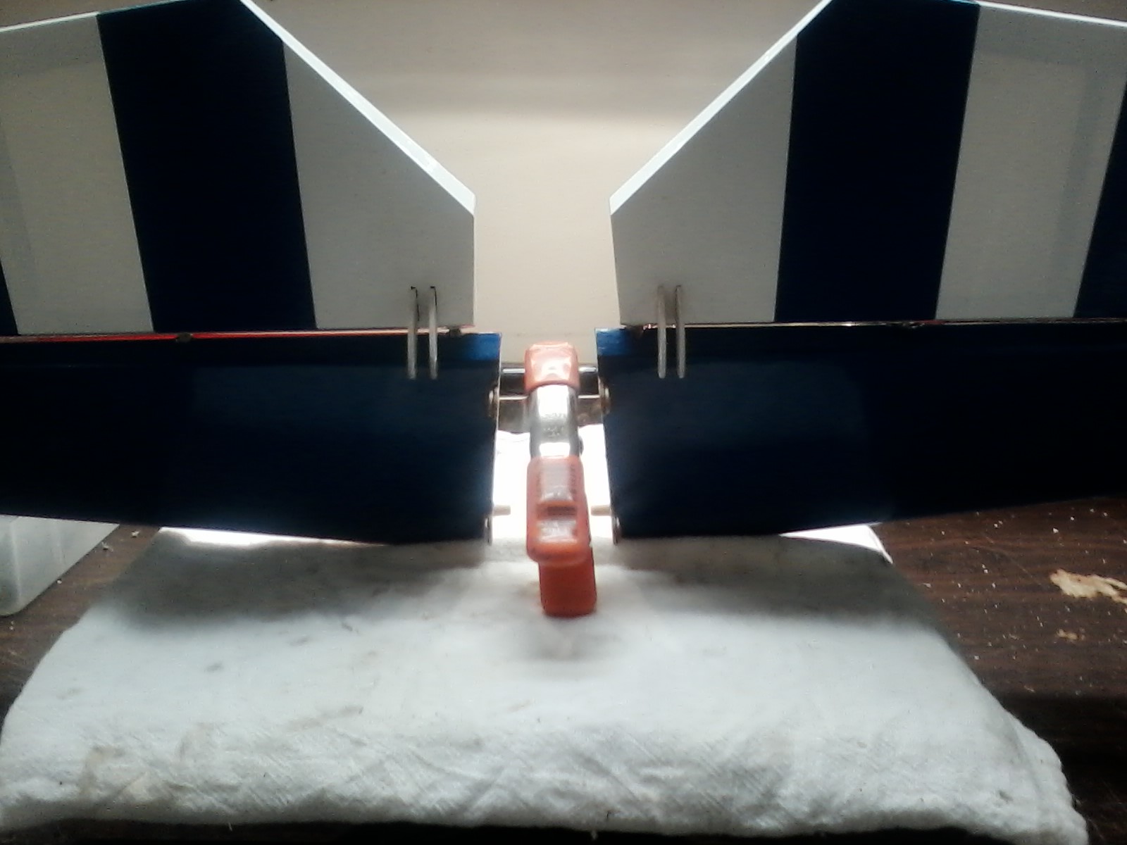

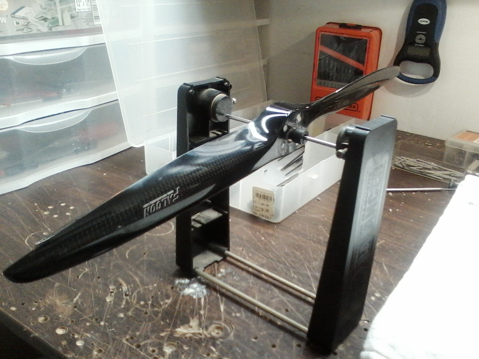

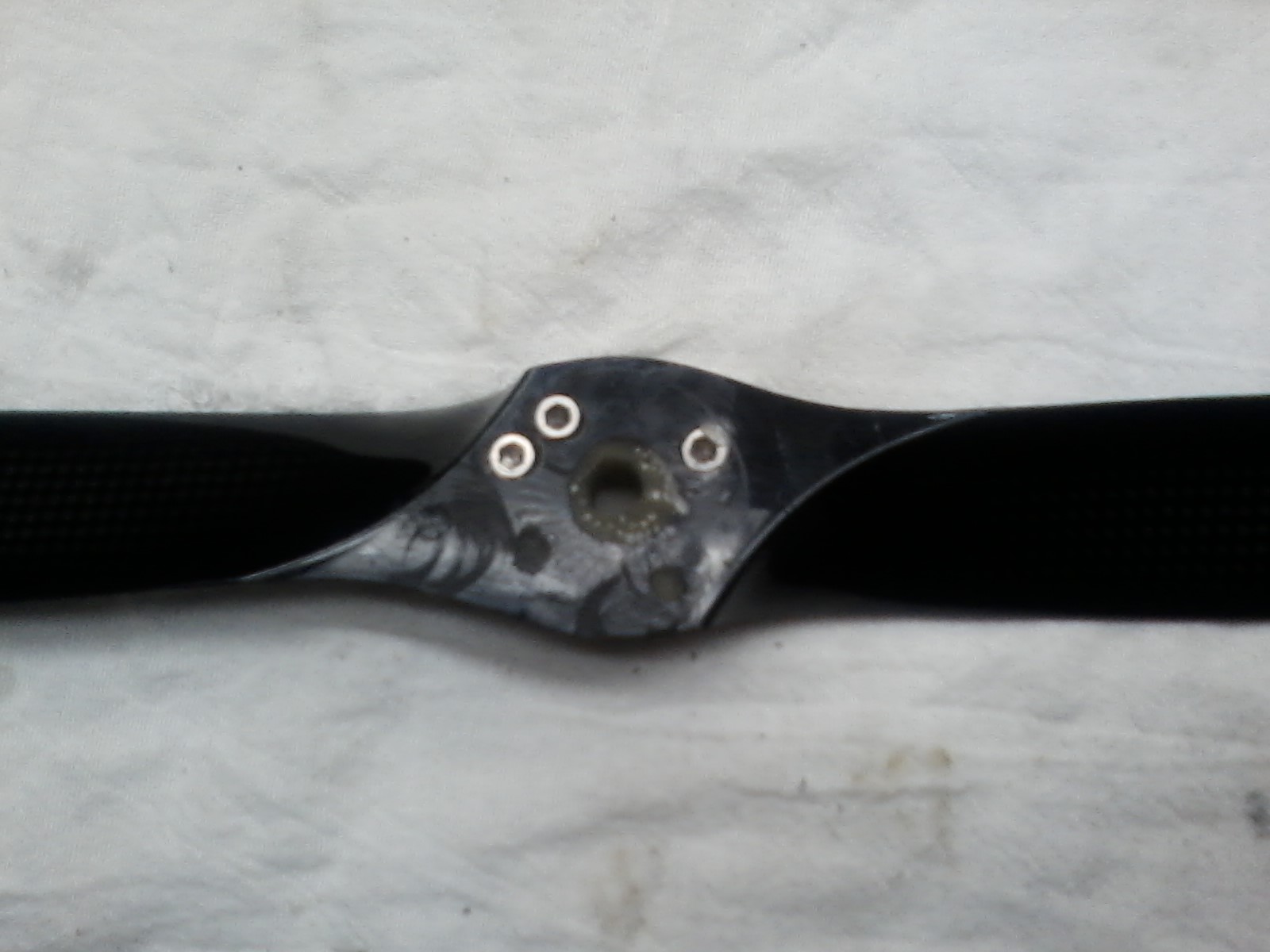

so I plugged all the holes and found true center and got it to balance perfectly.
