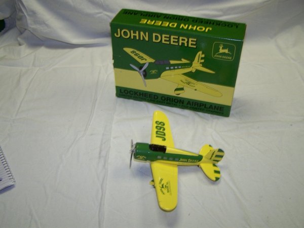

That's what I like about you Kelly. You always find the silver lining!Now I got to build a plow to go behind it. Wear a green ball cap and spit tobacco!.....
