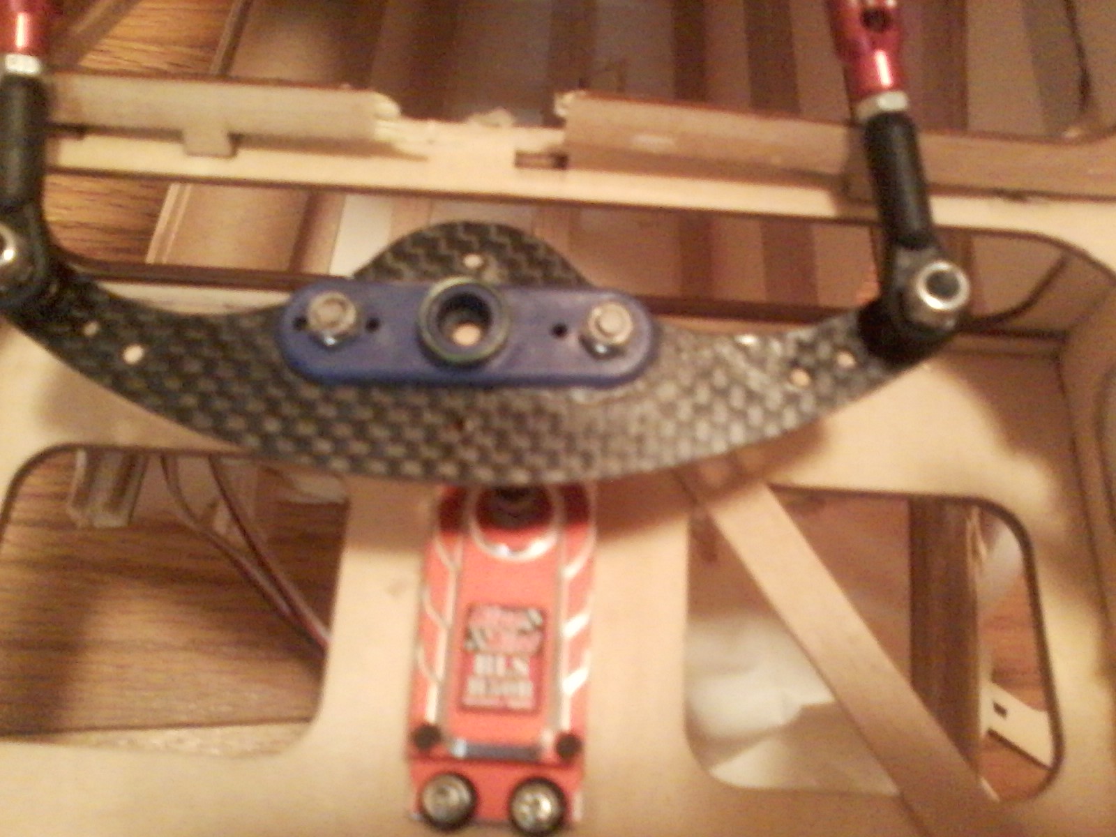

@Snoopy1 500ozin should be plenty. And MKS servos are a great servo. But......Servo torque values are with a 1" from center measurement. I am going to try a rudder servo tray that will put more output torque of the servo to the rudder itself. I find when using long (3 to 4 inch) rudder pull pull arms on powerful servos it makes the rudder stick more sensitive around center, more likely to strip the inside horn spline if using weaker material arms even some soft aluminum. And loads the electrical system excessively IMO.
Trying this once I get it to the door....Minimal weight penalty because it is mostly CF but the tiller post is machined aluminum and ball raced.
