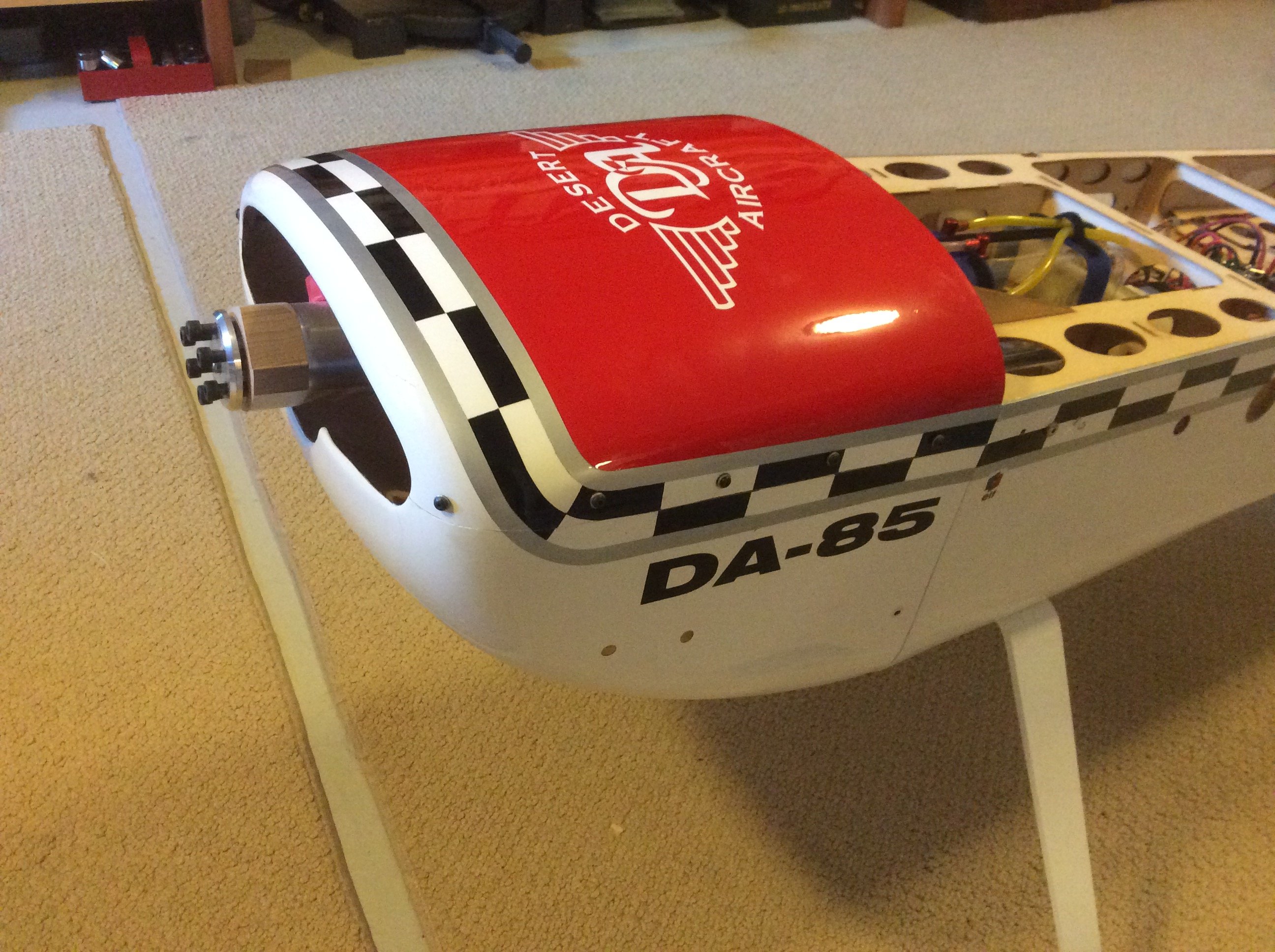

Very nicely done. I am going to remember this and refer back to it. I "MAY" attempt a very large 330 cowl surgery to separate two halves that make a single whole. LOLOk the cowl is on and fits nicely. Got the holes drilled and been able to keep the gap to a minimum. Now I can start to cut the holes for the exhaust and maybe some clearance holes for the spark plug caps. Will see how that all goes then work on the air ducts to the engine.

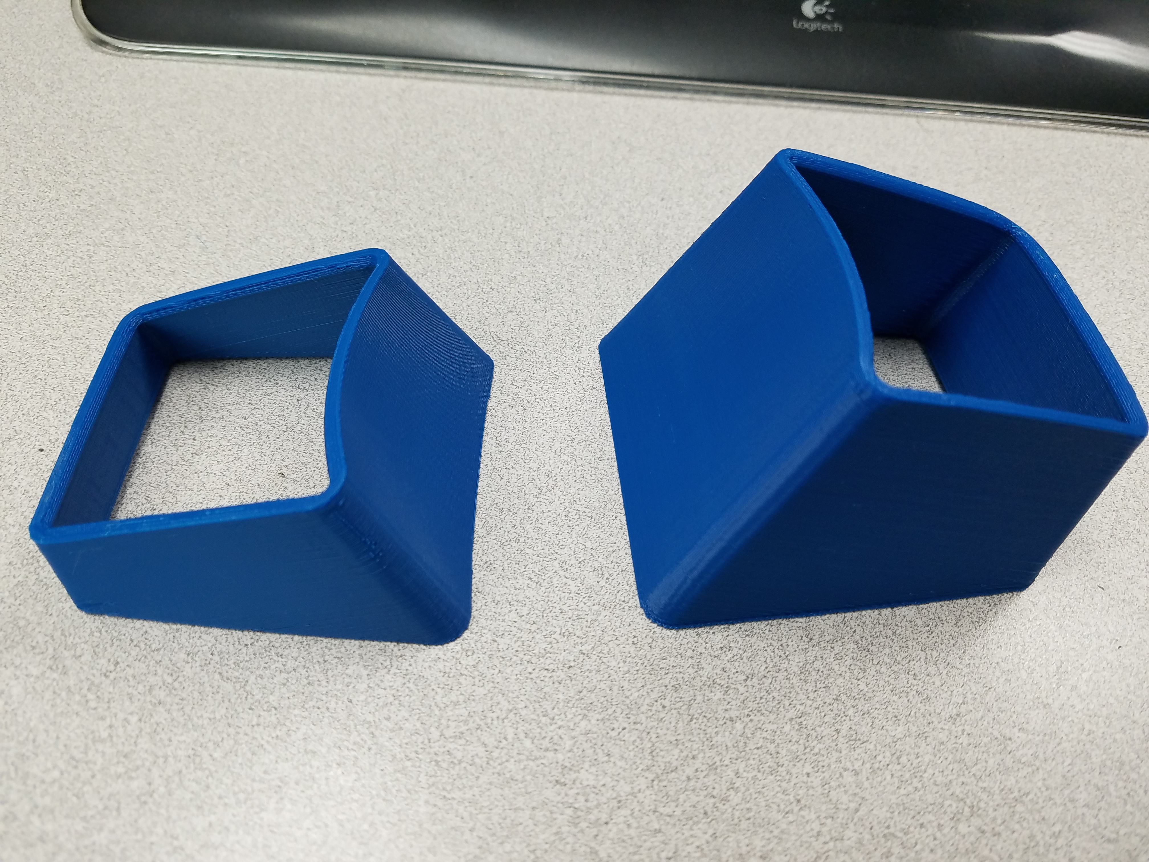

I used separate small squares on mine I was going to make round ones, but decided squares were fine.
By the way gents, is there a specific saw to use for this procedure? I see there are a variety of sizes out there. I purchased some just before the Pitts build. But am thinking I may want a fresh brand new unused one for the 330 cowl should I choose to cut it in two.Ok the cowl is on and fits nicely. Got the holes drilled and been able to keep the gap to a minimum. Now I can start to cut the holes for the exhaust and maybe some clearance holes for the spark plug caps. Will see how that all goes then work on the air ducts to the engine.
Thank you. This all makes perfect sense now. And duh!! I just remembered something. I don't have to worry about ruining a painted cowl because the 330 cowl is going to get repainted anyway. As long as I don't mess it up and cut crooked or something like that. I think I am going to give it a shot.I had two Zona saws I tried to count the teeth but I belive the one that worked the best was one with about 40 teeth per inch. It may sound wrong but I had a new one and and older one the older one worked better and seamed not to grab as much and slide a little easier just my observation. But down the sides the new one worked better. Cross the top and corner the older one. The only thing I can say is hold the saw at the smallest angle possible. Try to have as many teeth in contact as possible.
I'm pretty sure mine is the Fine Kerf Zona saw. If I remember I'll check tomorrow since I store it in the package.Thank you. This all makes perfect sense now. And duh!! I just remembered something. I don't have to worry about ruining a painted cowl because the 330 cowl is going to get repainted anyway. As long as I don't mess it up and cut crooked or something like that. I think I am going to give it a shot.
