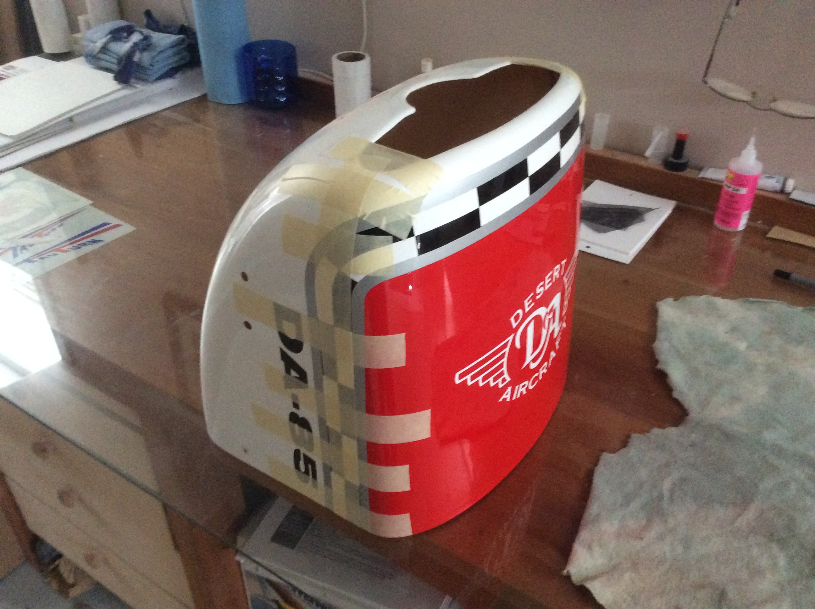

You had better hold off for about another 3 hours at least just taped the two halves together and add the 1 inch of Fiberglas tape to the inside. Now it just waiting for a few hours to pass and hopefully I can separate the two. Waiting in angst, which we luck.

I see were you masked it inside :sneaky:......:yesss:.
Up to this point it has been going as planned but now it just a matter of time before I can try to split the halves from one another. I must say of all the steps to get to this point the hardest has been taping the two halves together. To get the two edges to lineup and taped together with no gapes took some doing.

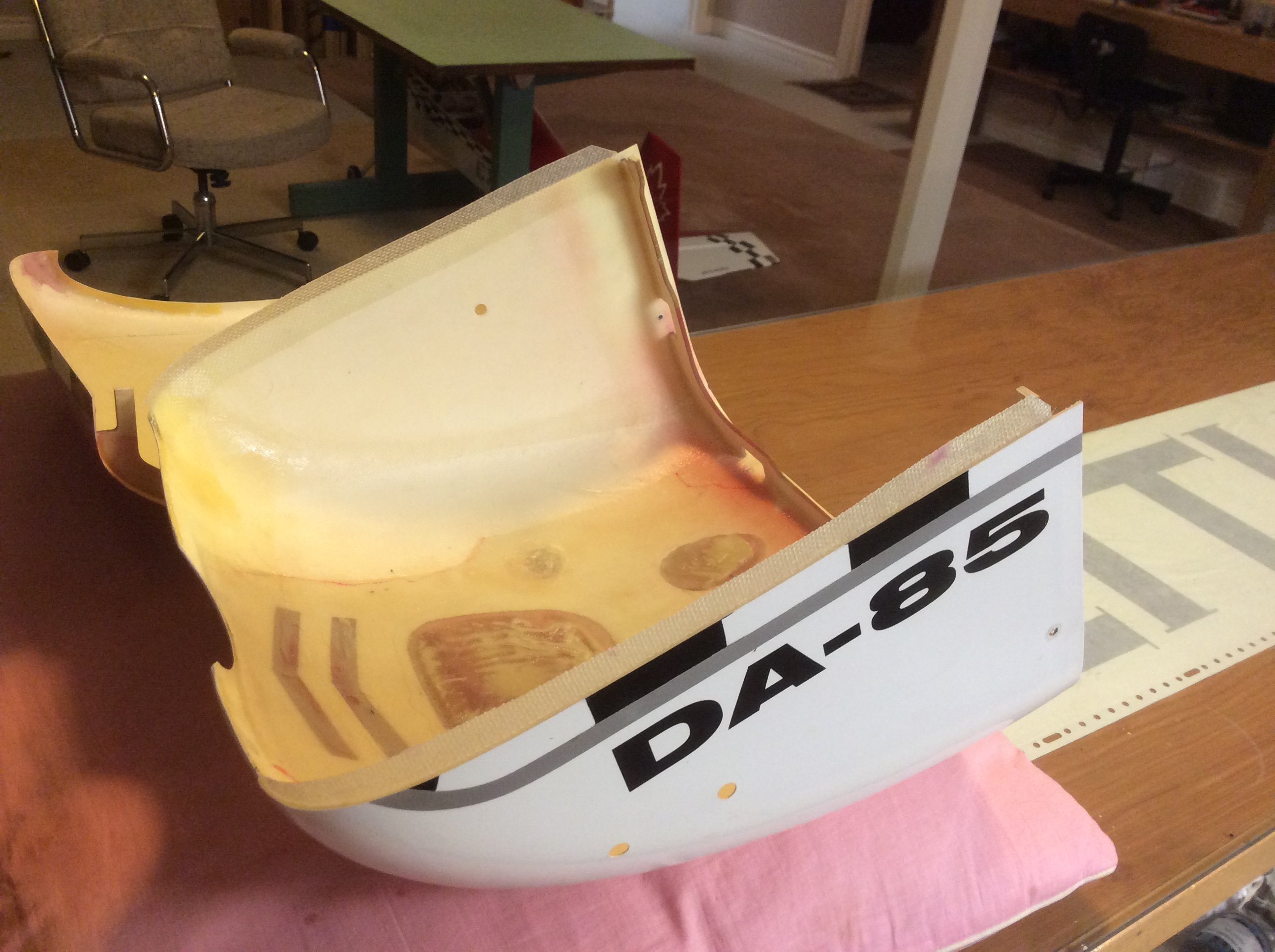

Well it can apart it was not that easy had to do some prying and sliding a small 6 inch steel ruler in between but it came apart and looks pretty good. I will definitely do this again instead of trying to work with a one piece cowl.
