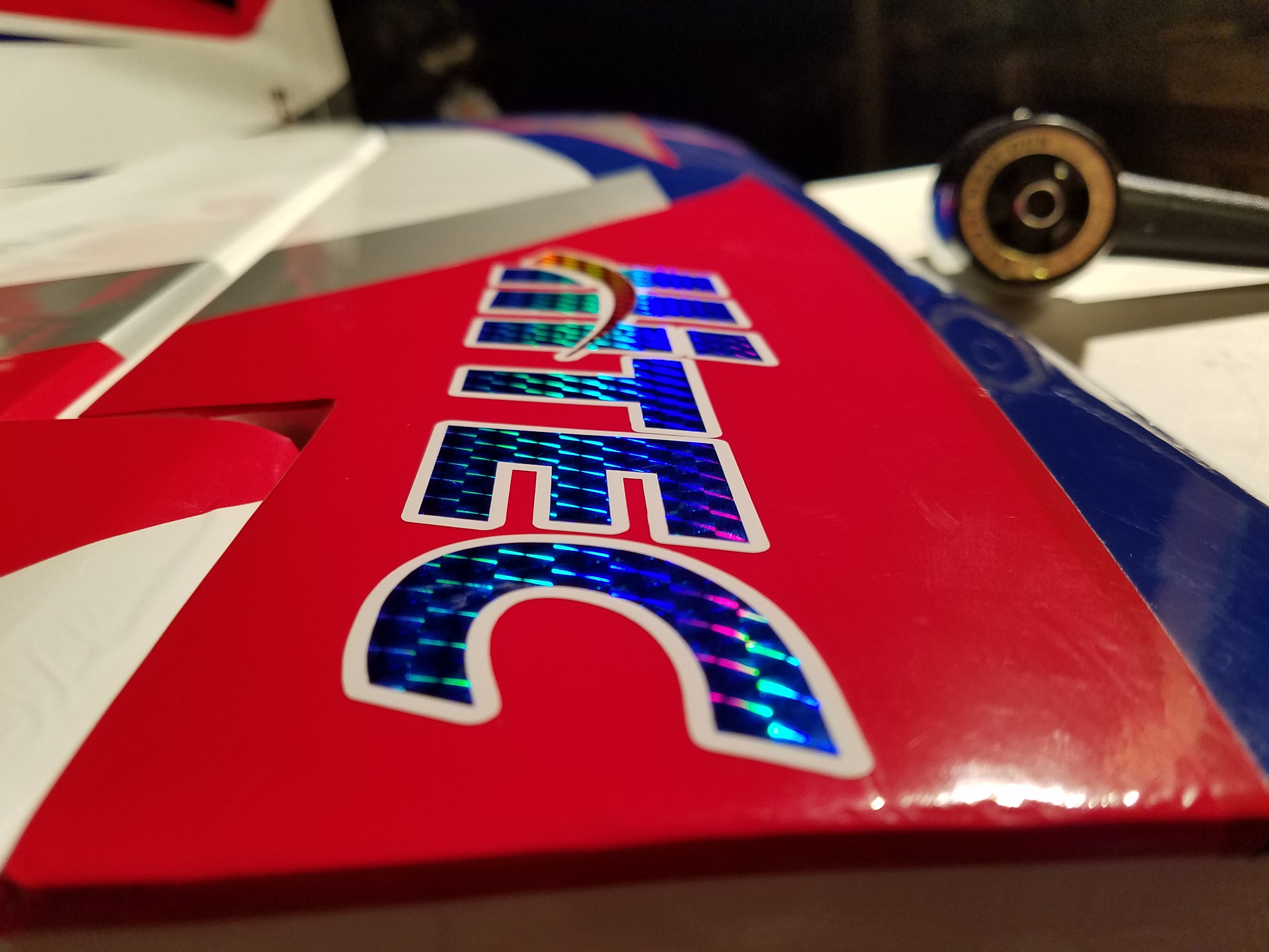

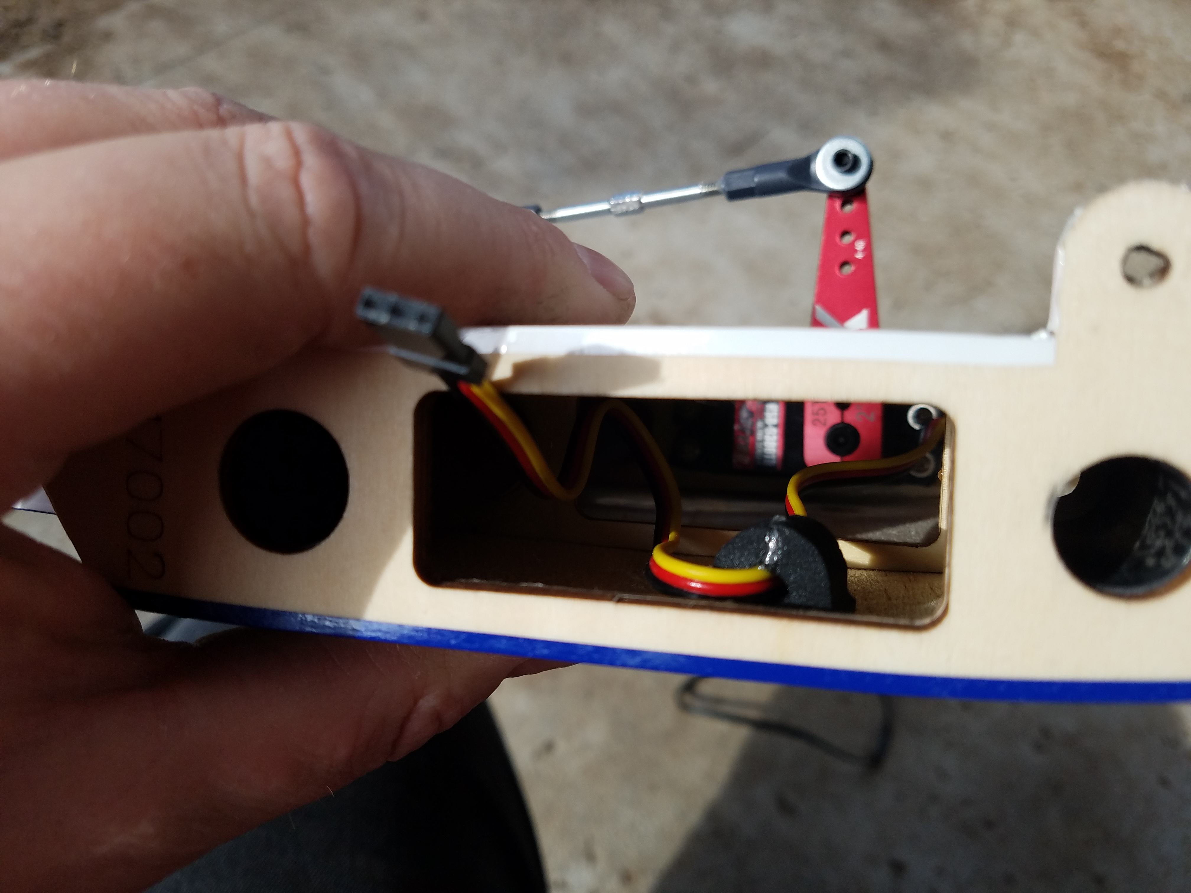

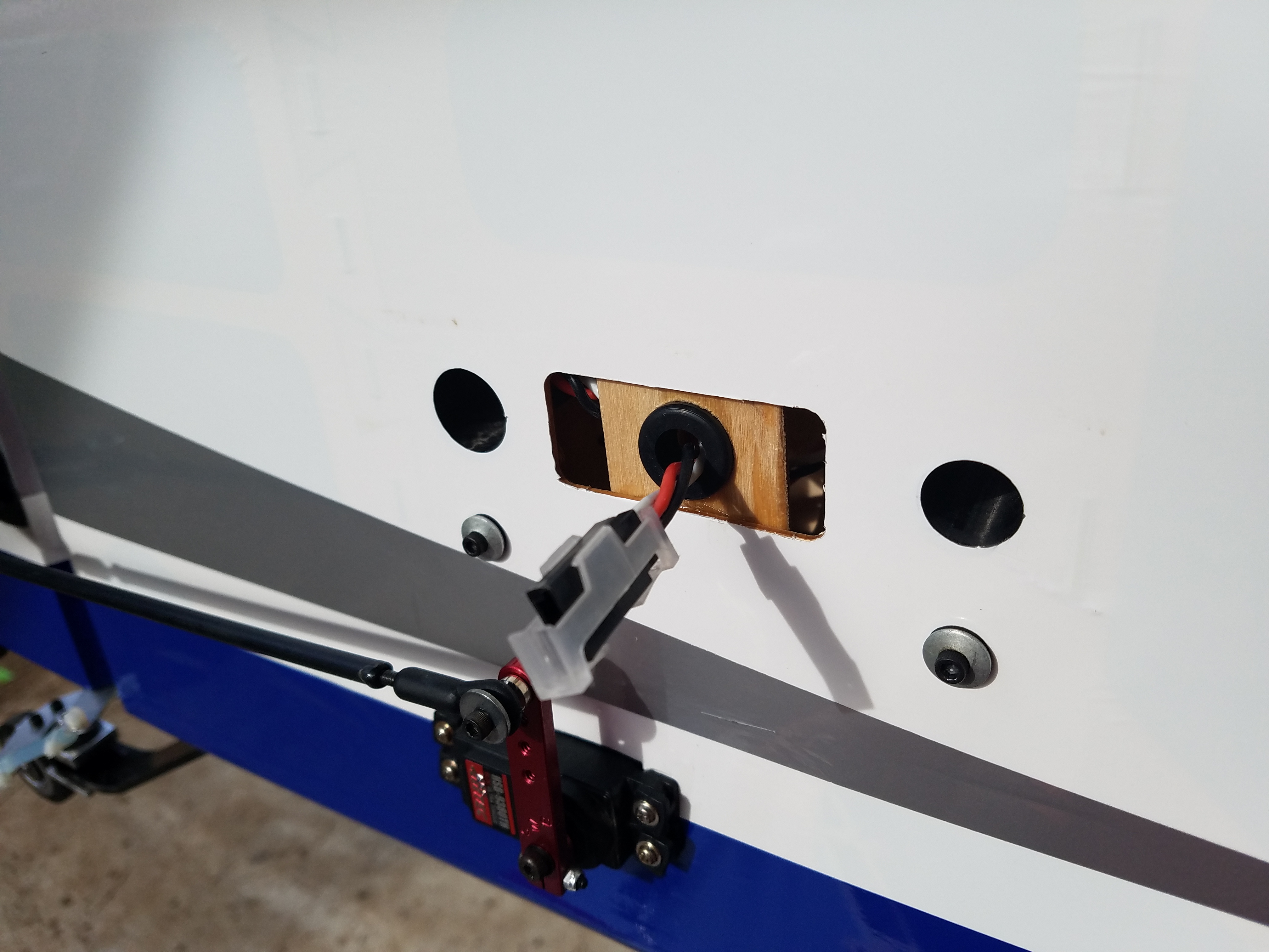

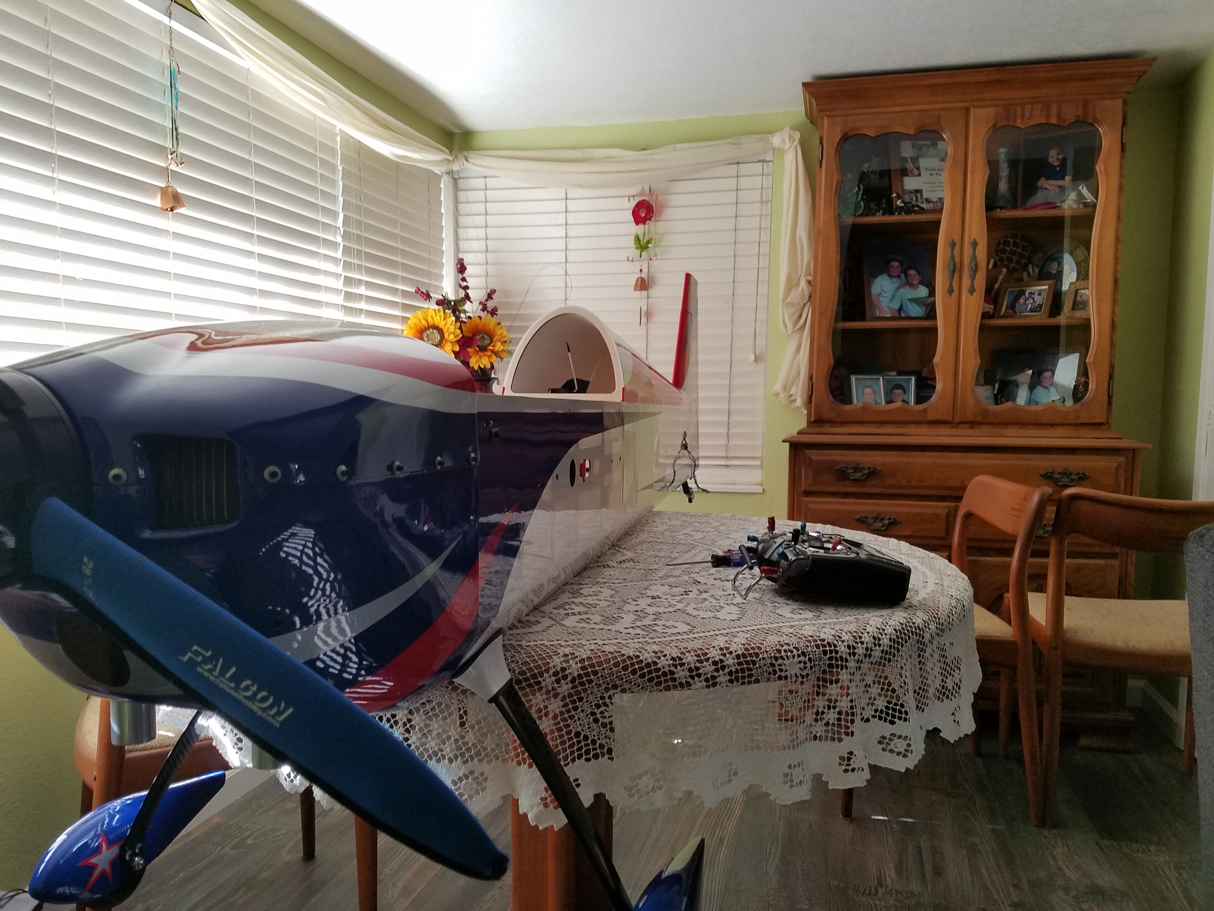

Did a culmination of work to the AJ Laser over the weekend and today. Got to work programming the X24 with its awesome AutoMatch function, did some work with my awesome new holographic decals from B&E Graphix, worked on tidying up the elevator connector situation, and finally wrapped it up with some work to my throttle linkage. Managed to get my throttle EPAs at 125 on both sides, I'd say that's pretty dang even :oblong:

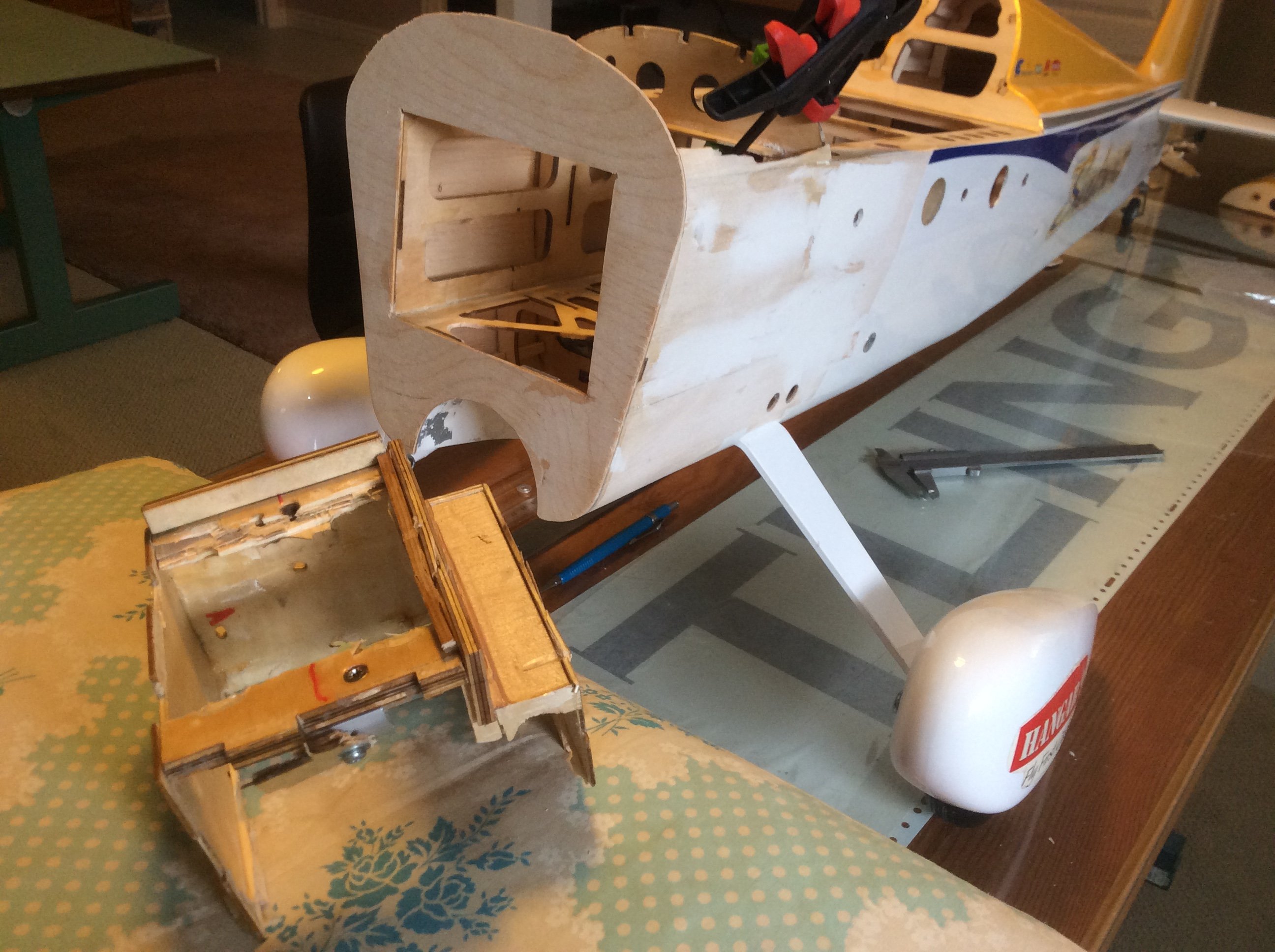

Ok found an old plane My old Sundowner from a few years back it is a F1 35cc size . Did not even get one full flight out of it stalled the plane about 4 minuets into the flight. Was trying to do a touch and go just to get the feel of the plane we’ll cut the throttle back just while I was making the final turn to the runway and sure enough I tip stalled it before I realized what had happened it was over with. Not happy about that the plane was put awake for a while. So now I have decided to fix it and try again. It was completely smashed up to and including the landing gear and had to redone the wing tube location in the fuselage. Fixed the fuselage as you see in the picture. Now I need to come up with a new engine box and connect it the fuselage so the motor spacing is as it was. Can no longer get a cowl for the plane so I will have to come up with something and or make a cowl time will tell.

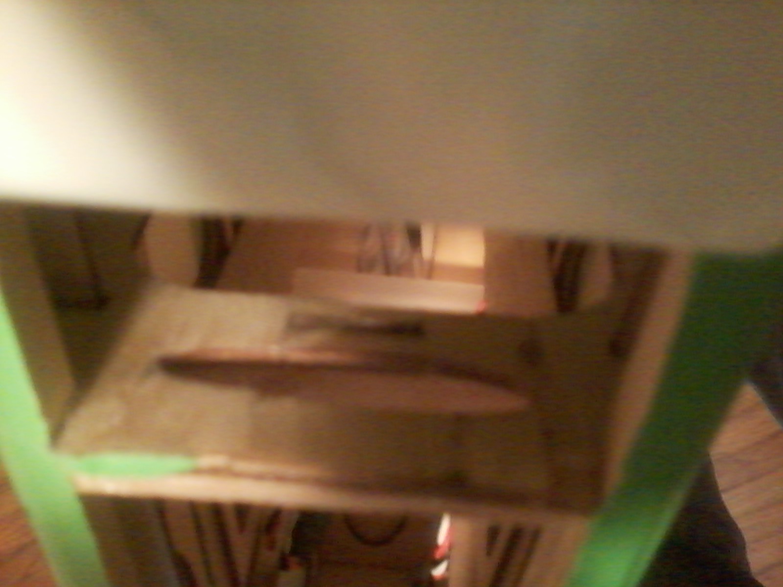

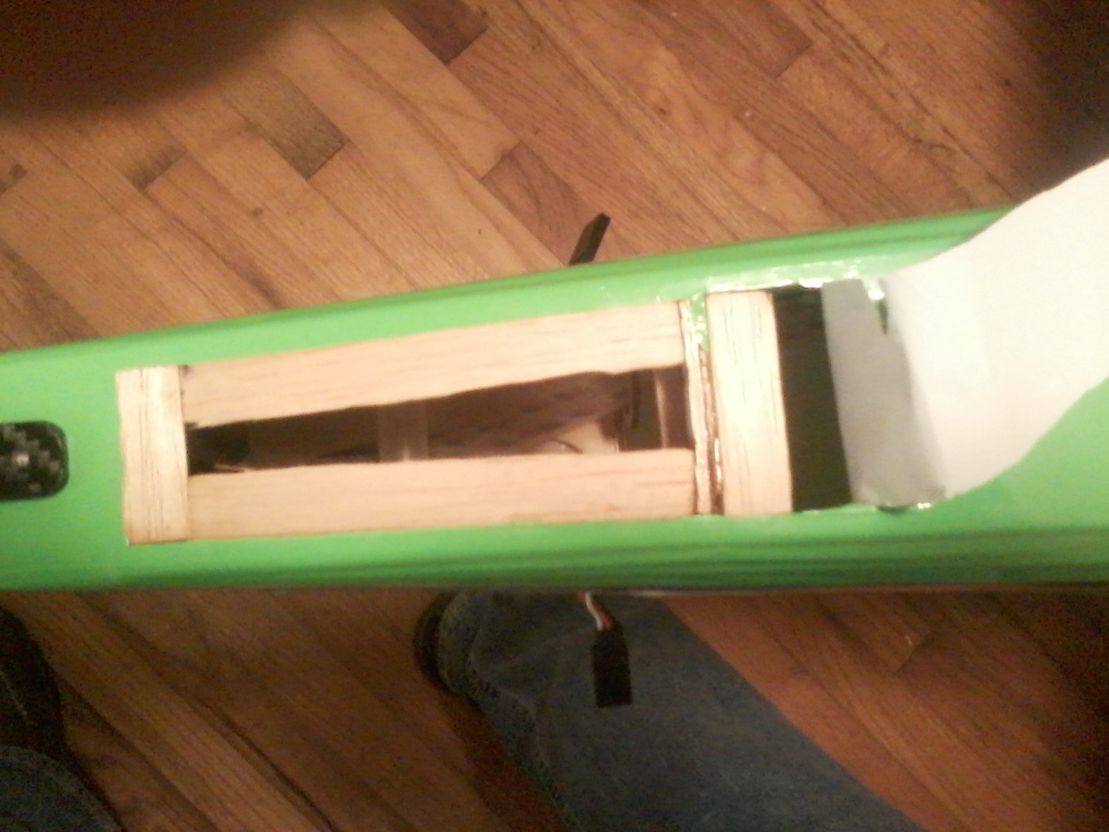

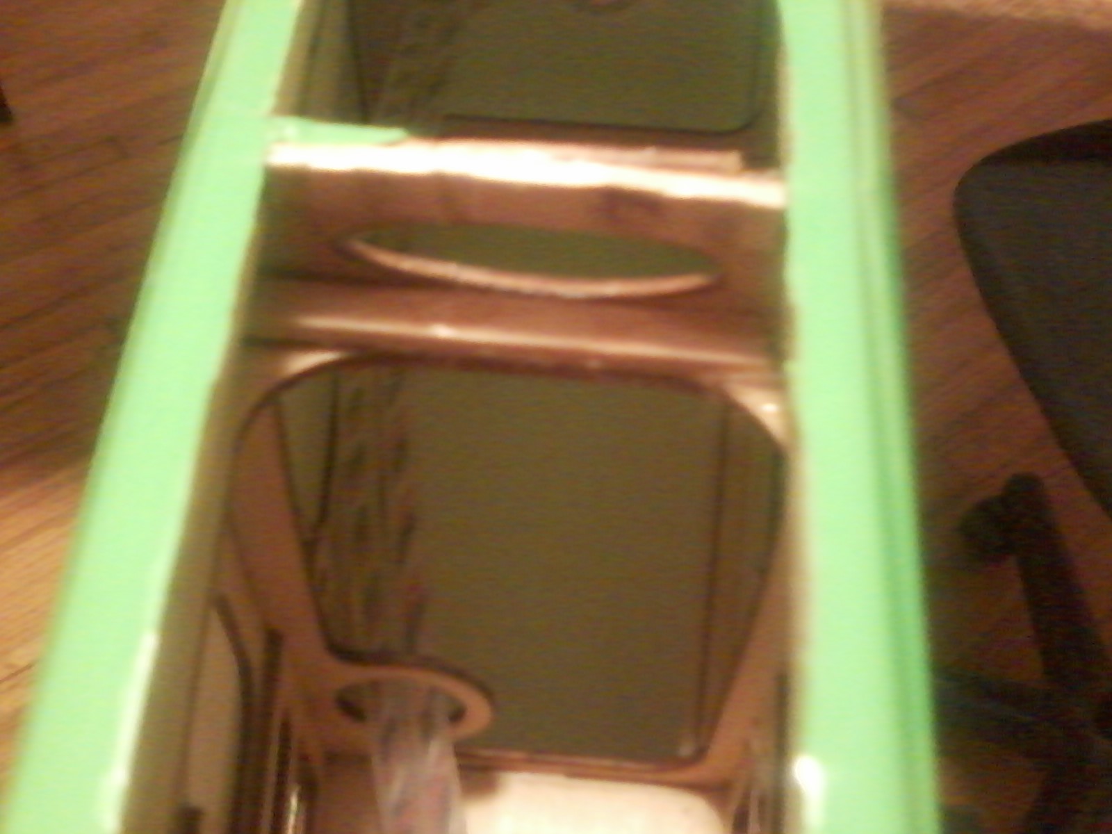

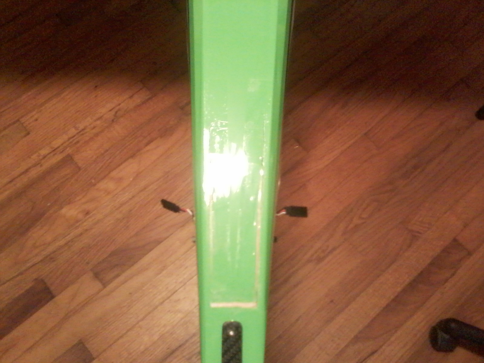

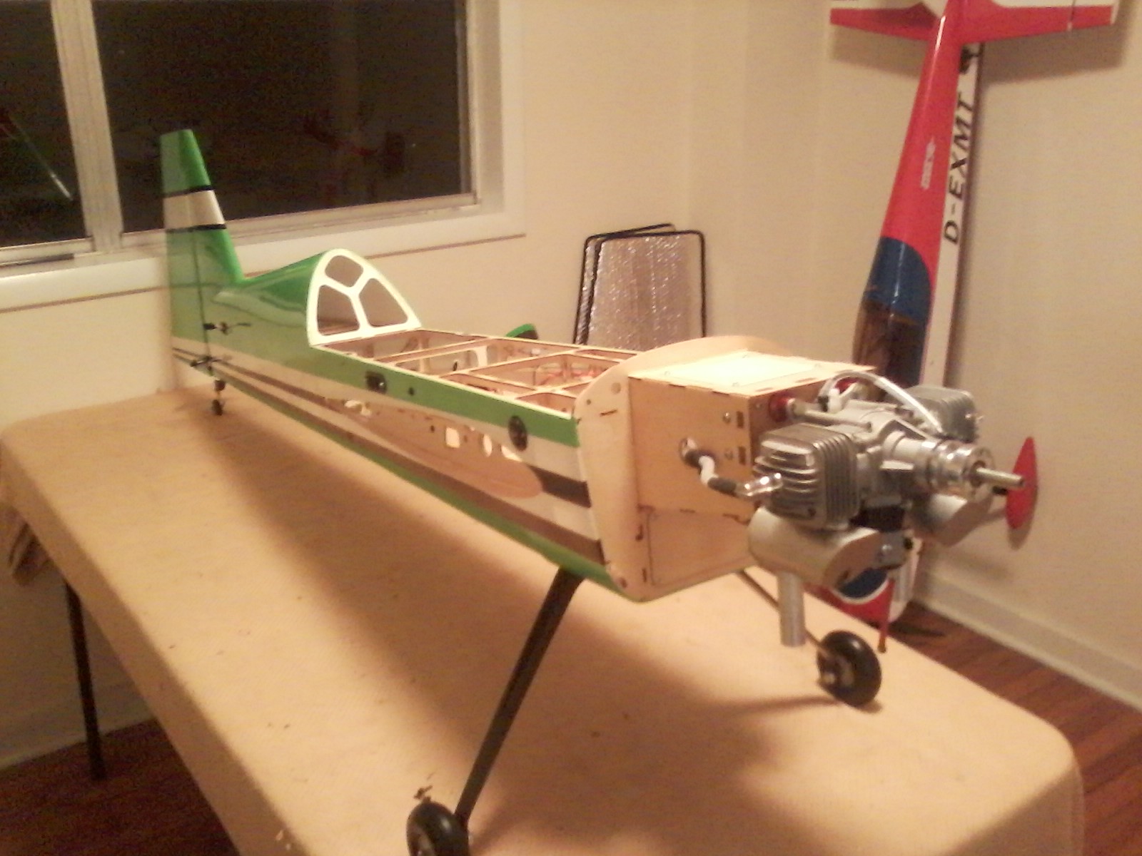

Bout got my buddies MXSR wrapped up. Had to repair some shipping damage inside the fuse. The last former before the rudder fin had been crushed. Did not have any florescent green covering so I just peeled it back and made a surface to iron it down to. Sealed up the seams with scotch tape. Hey....It's on the bottom anyway :rolleyes:.
