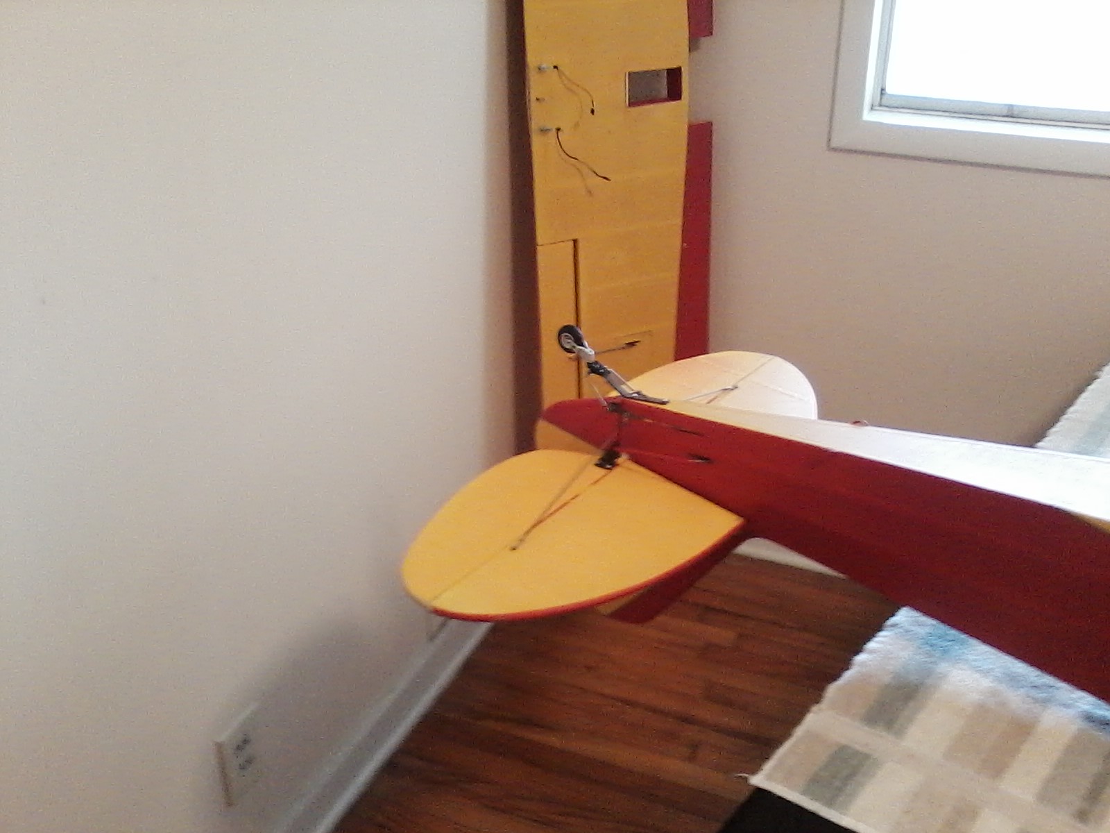

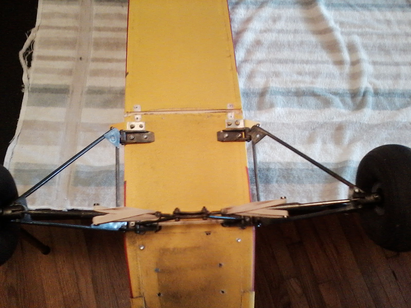

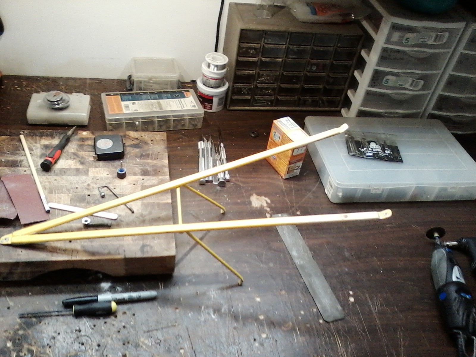

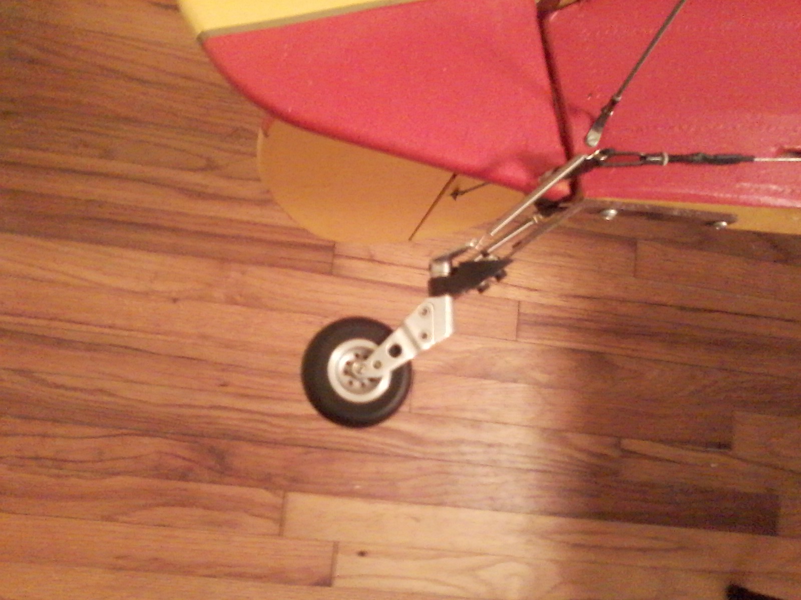

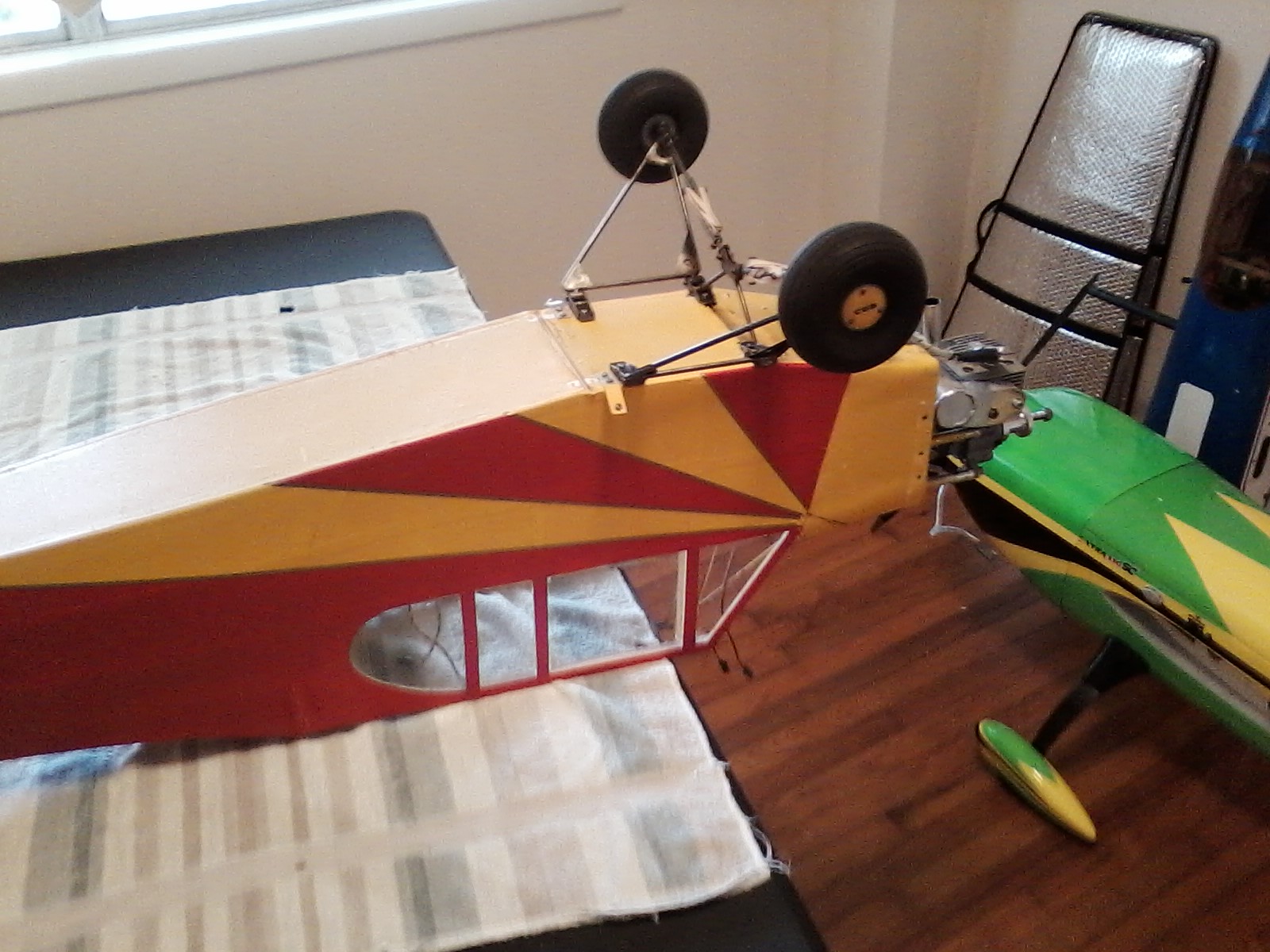

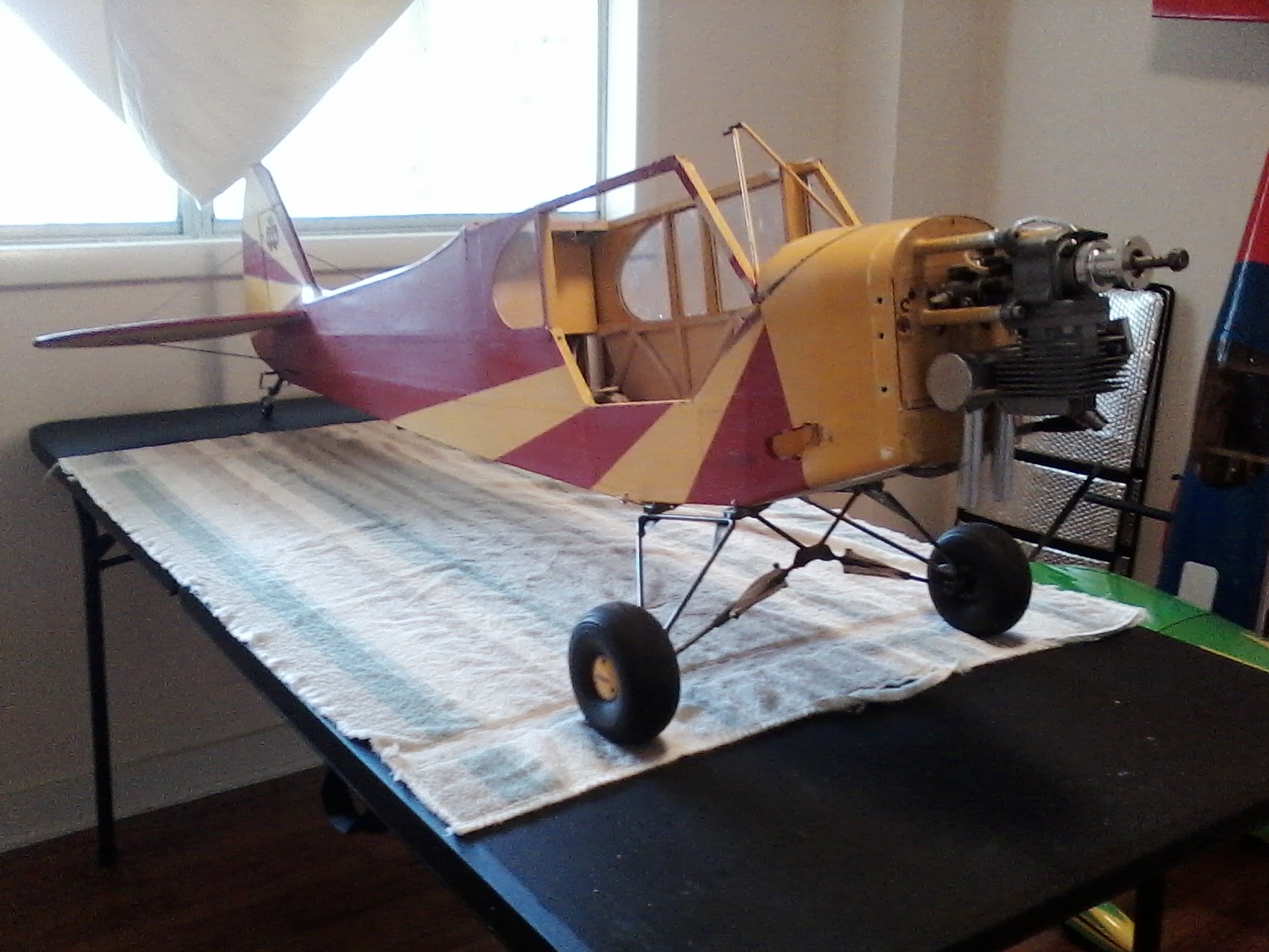

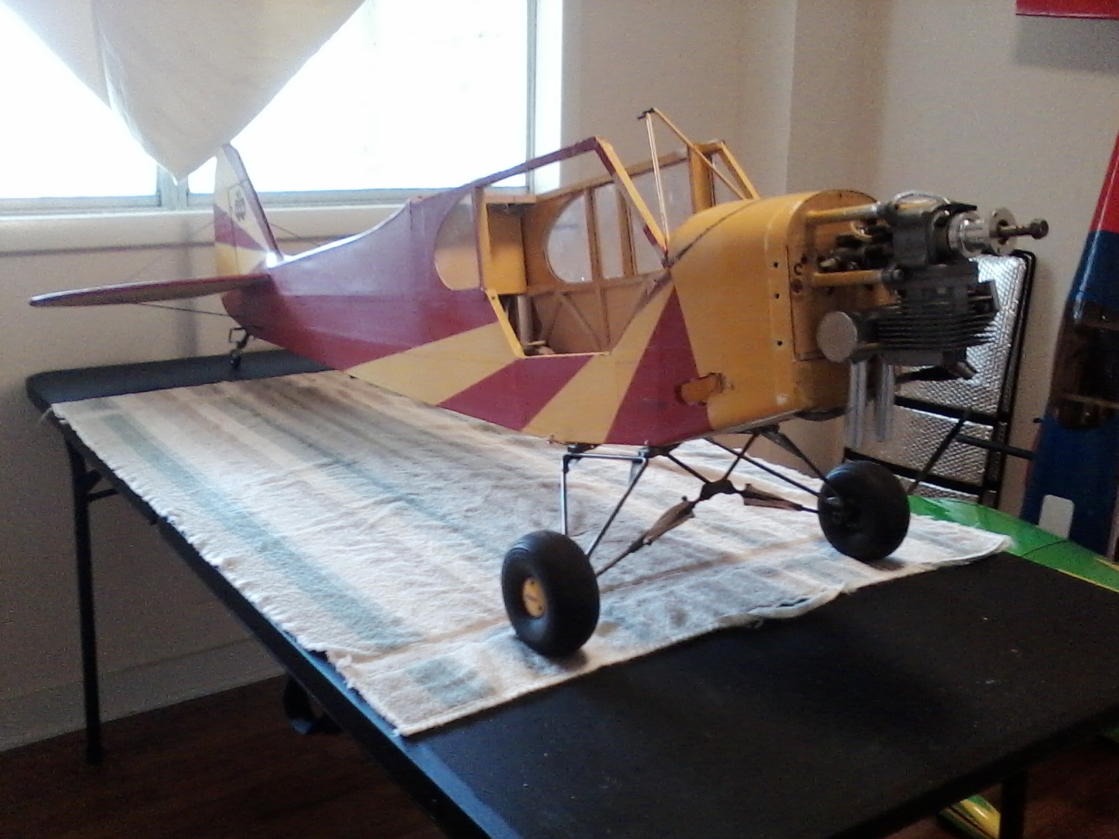

Got some undercarriage work done on the cub. Could not find a Maule style tailwheel :( (had 4 of em several years ago) for it so I just threw something together that looks somewhat scale. The CMP functional LG was a perfect fit :).

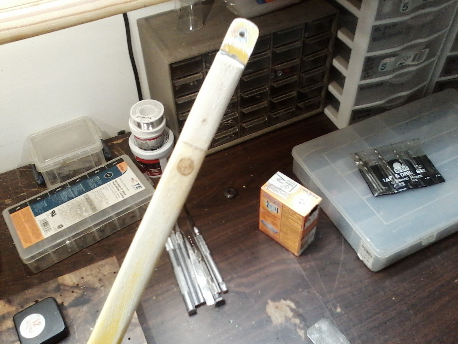

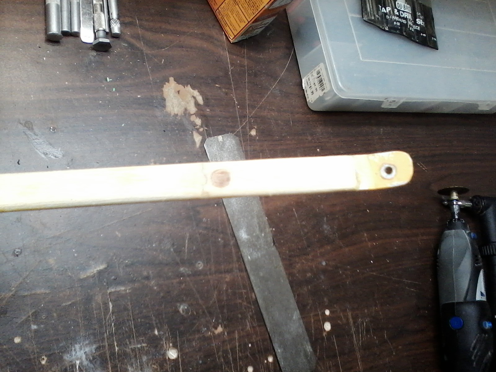

Also repaired the cracked / broken wing struts. Still need to dowel in the metal to the wood on both struts. Need to get a 3/16" dowel for "pining" them in. Used a 1/4"dowl for the broken wood part of the strut.

Too cool Kelly..... good for you. Bet ya gonna fly it huh? LOL

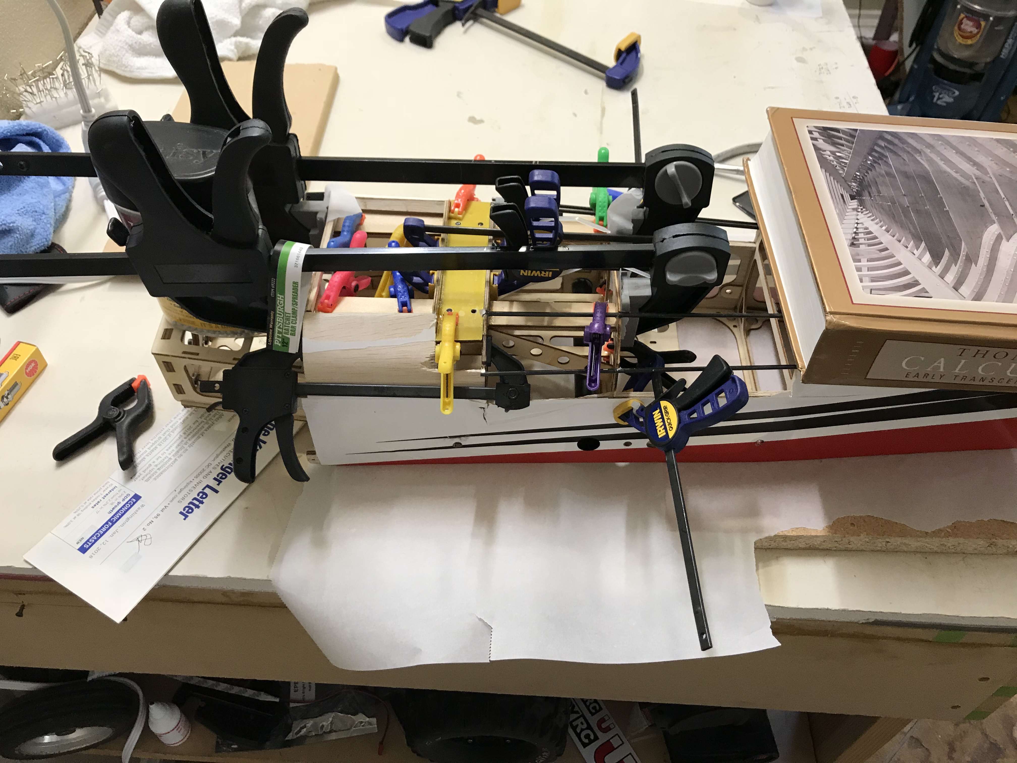

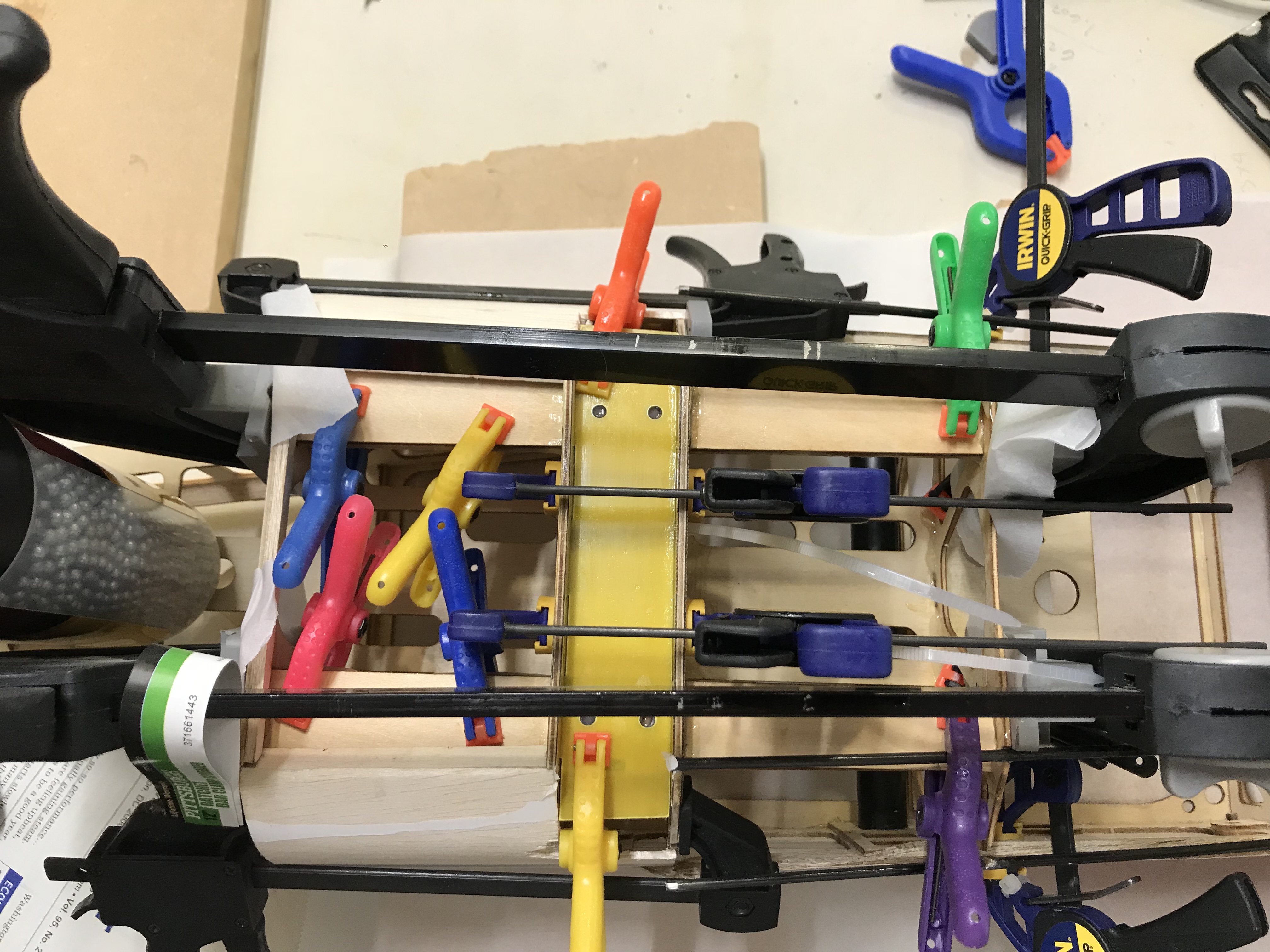

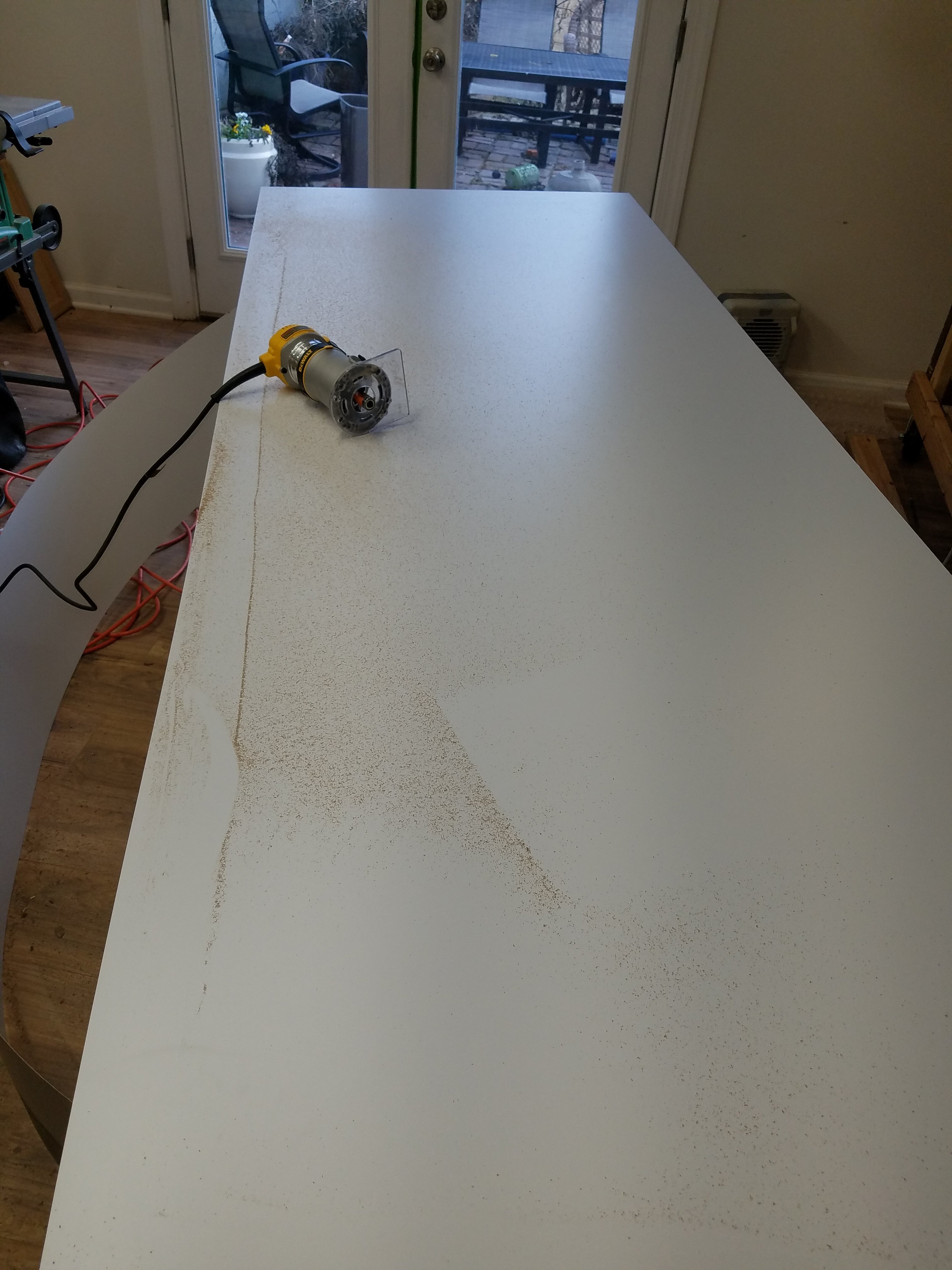

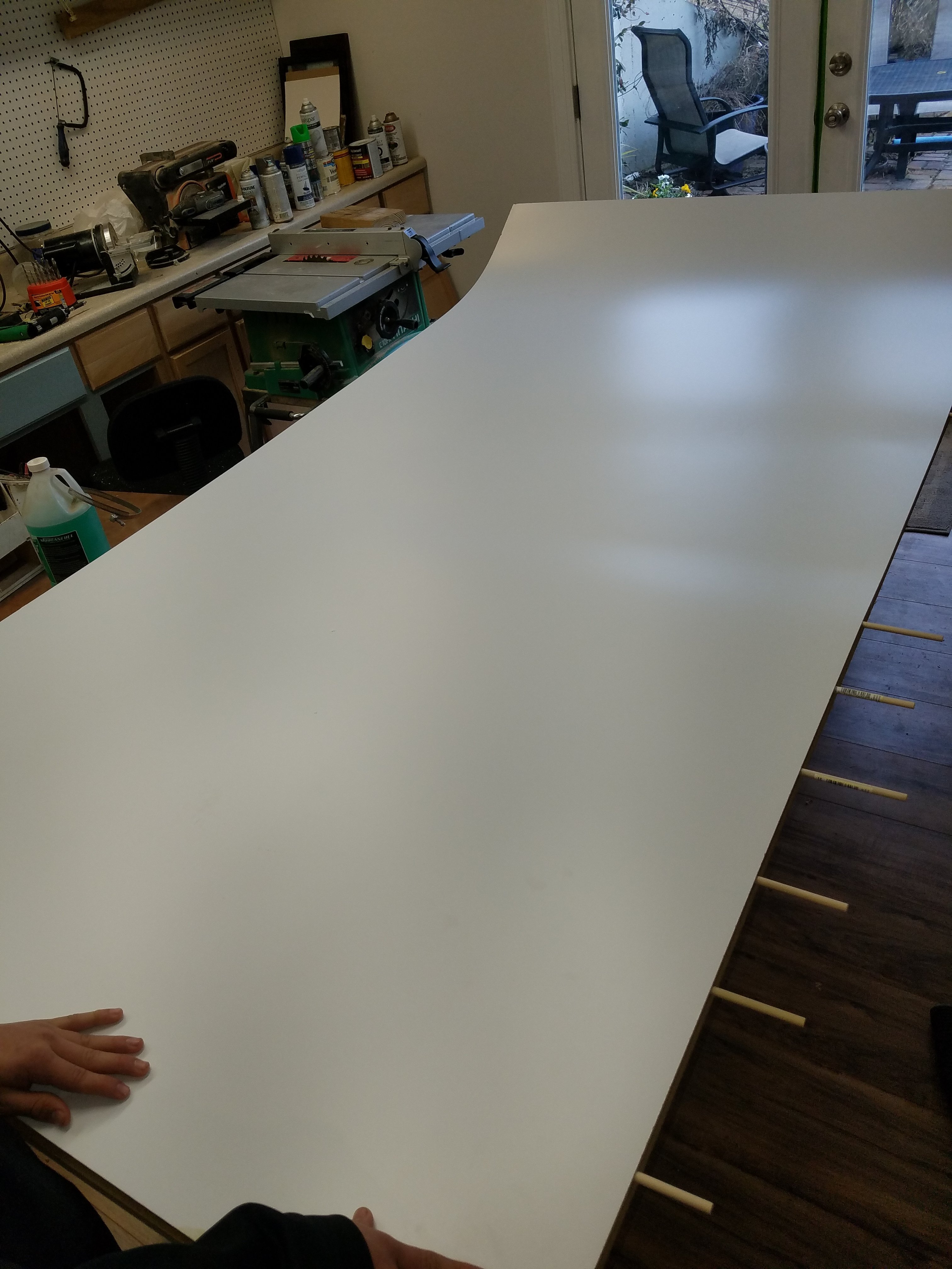

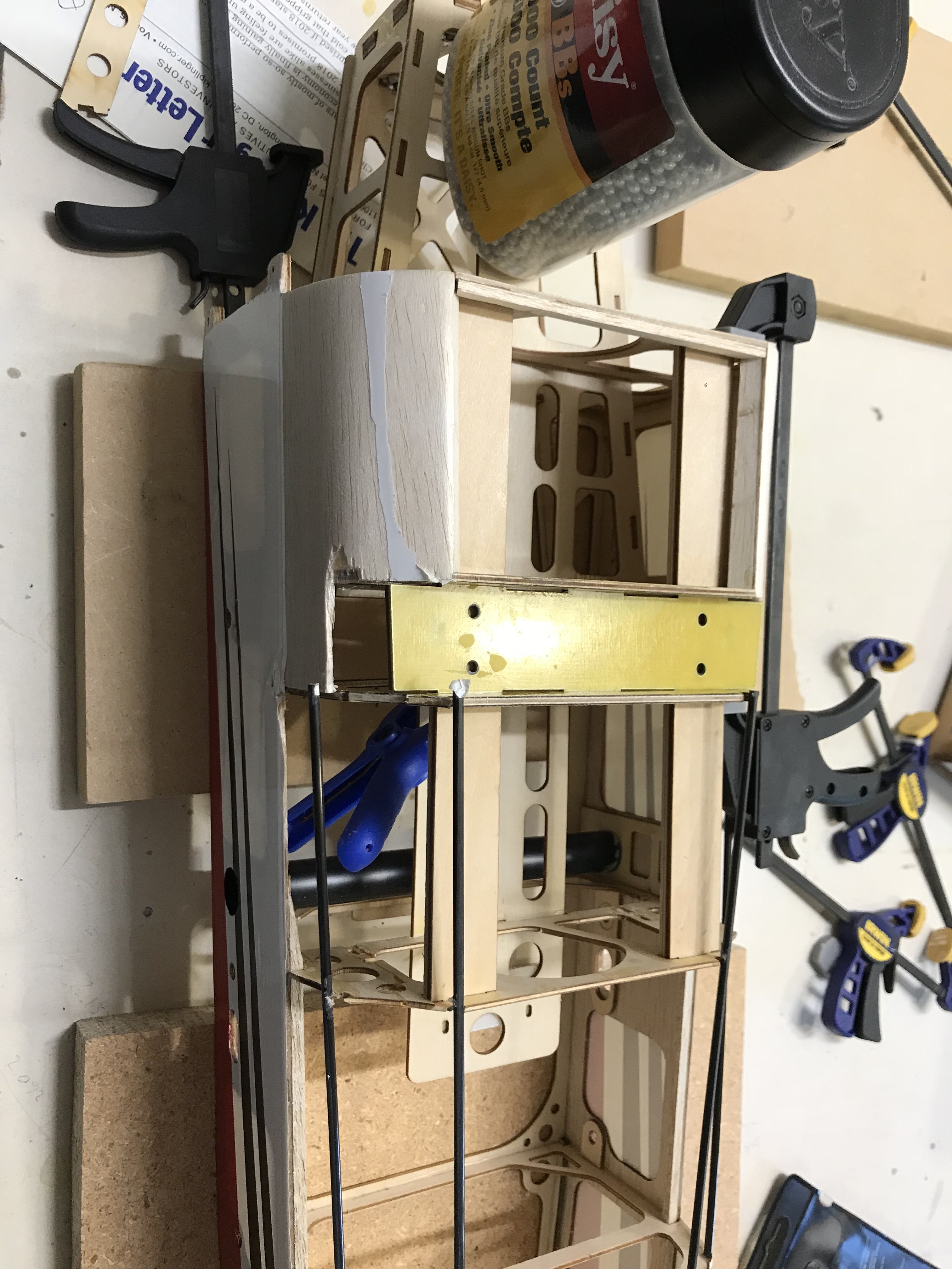

Repairing the landing gear plate in the EF 60” extra. Plenty of clamp porn for those that enjoy it....haha.
First pic is to check to make sure all the parts fit up. Also used a flat table to use the canopy line to ensure the fuse is square. The other two pics are all about the “business” :attaboy:.
