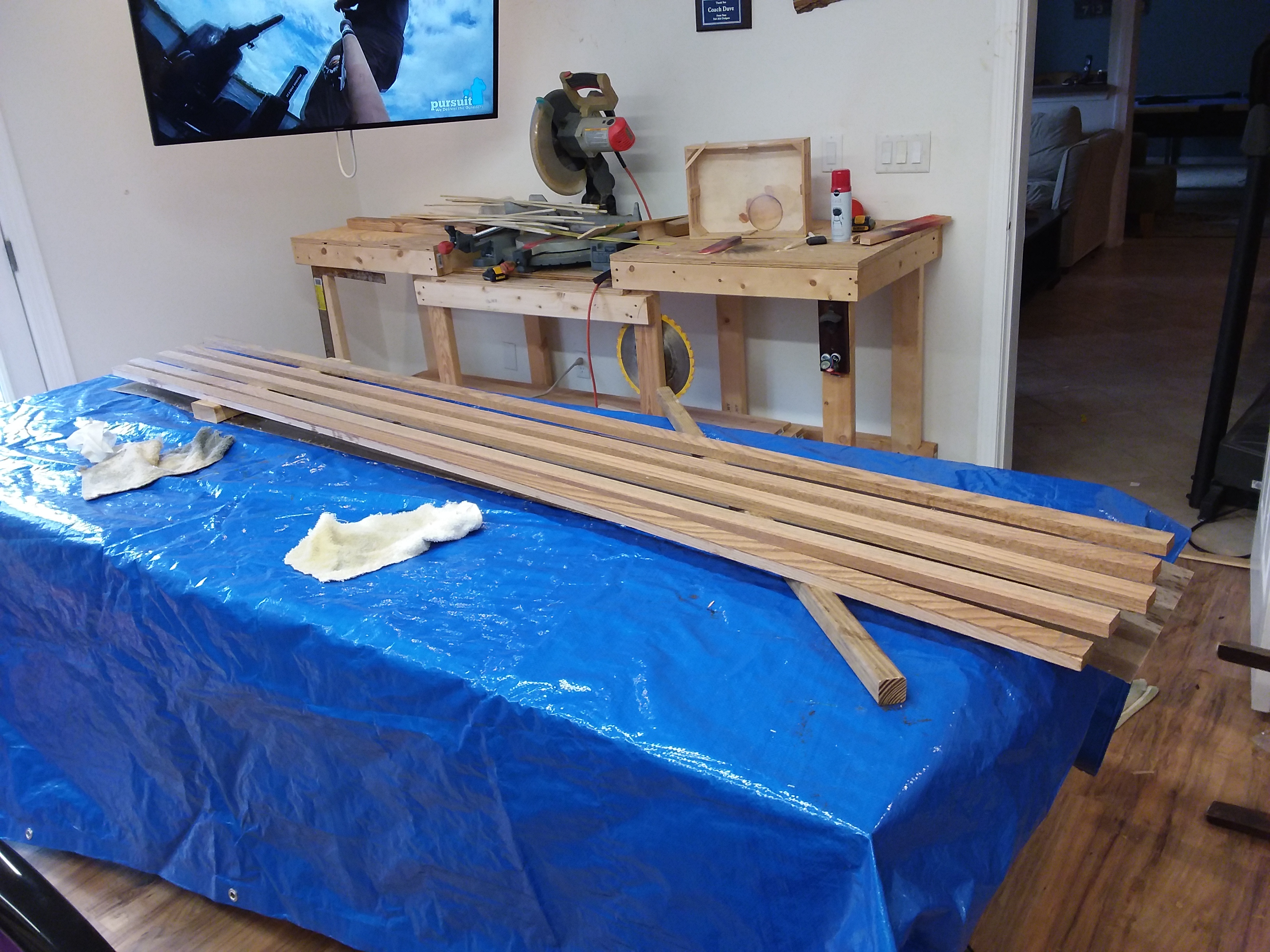

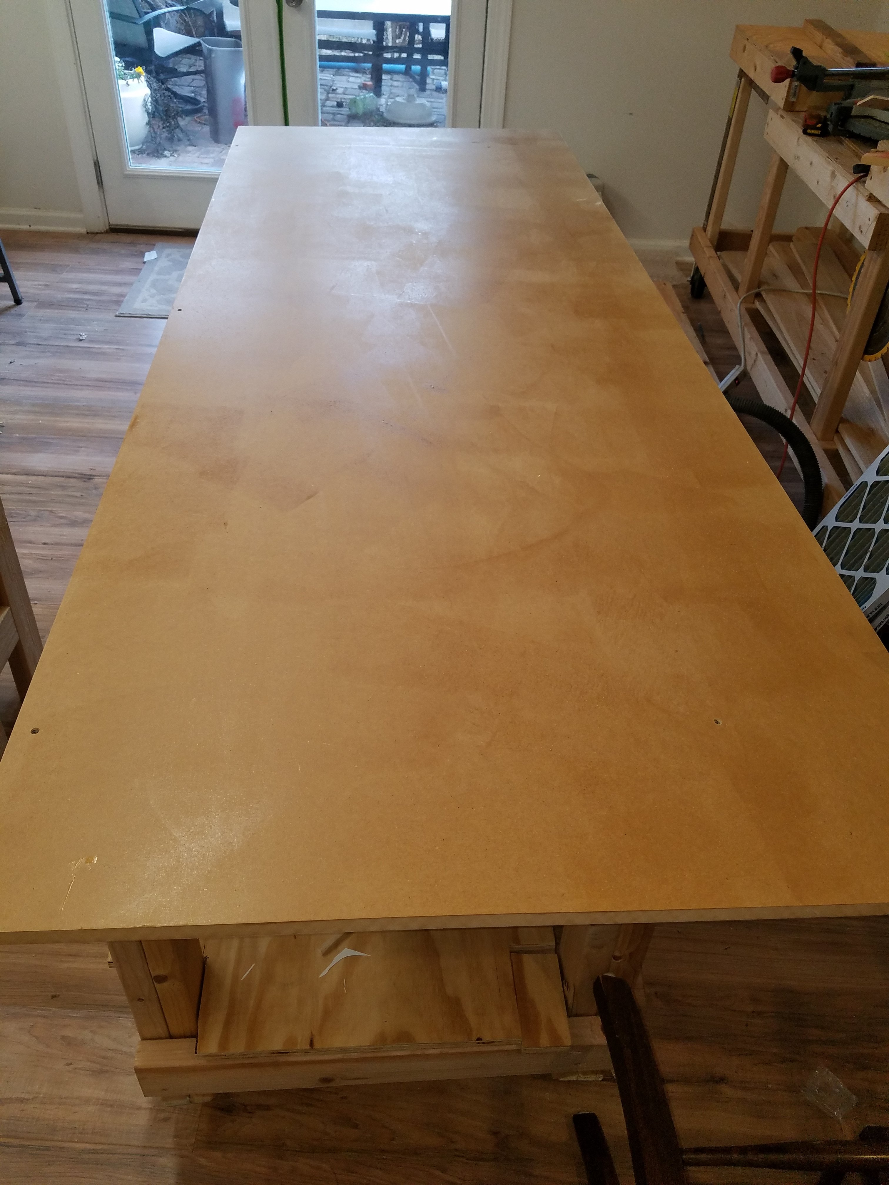

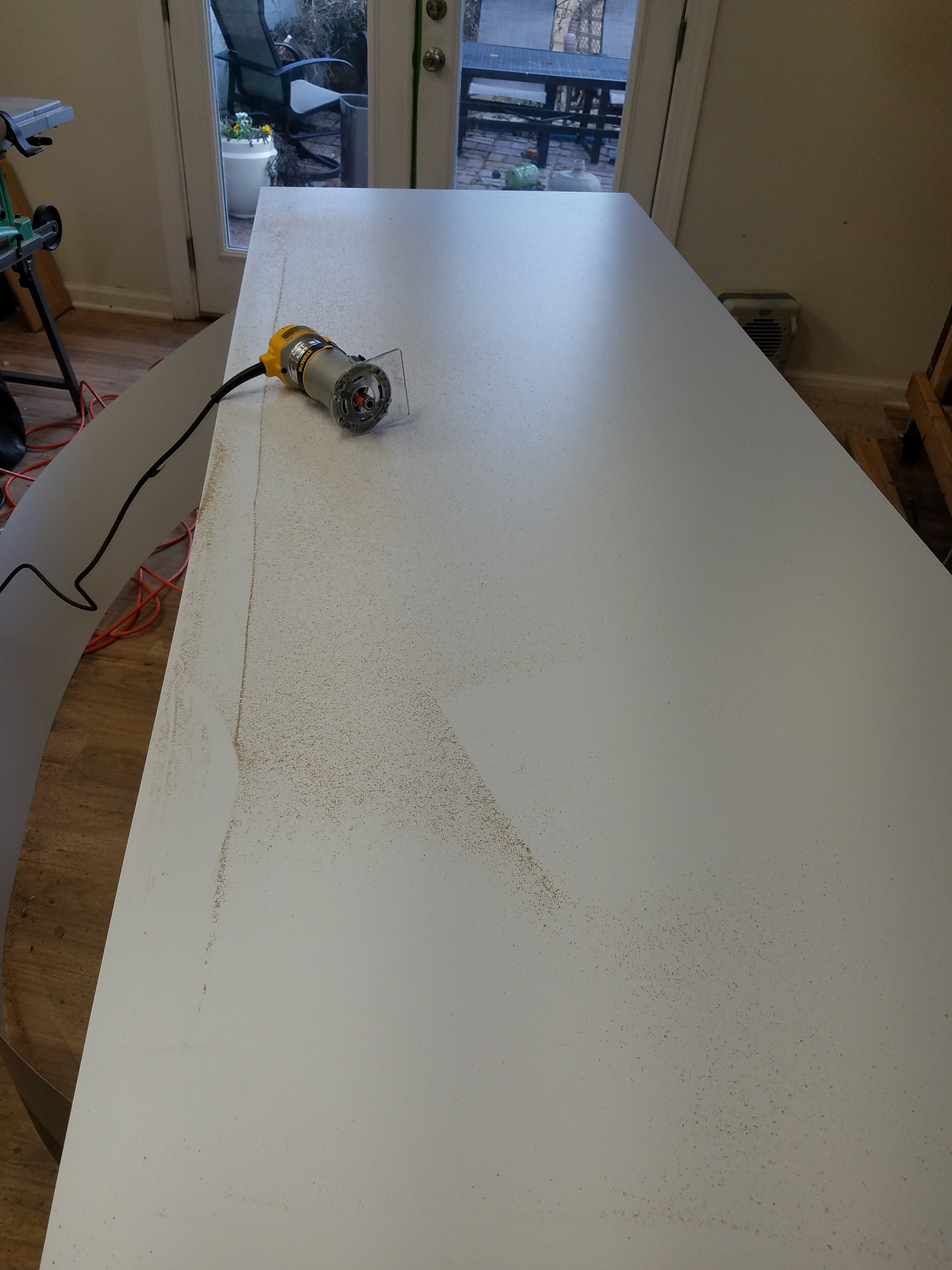

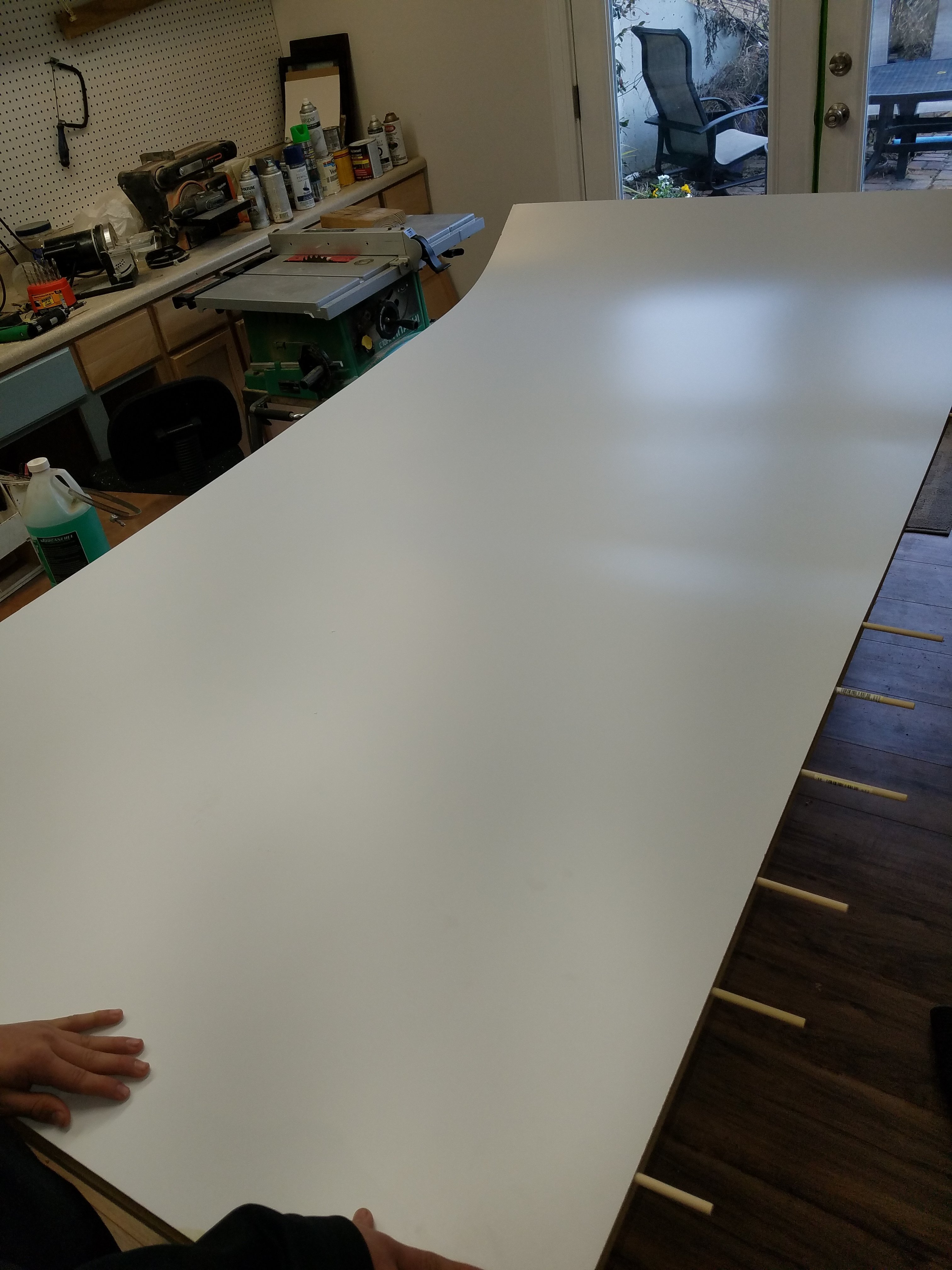

Going to wrap my new laminated work table with stained and varnished oak.

If you are building a laminated workbench be careful I have done a couple and believe me it is very difficult to do. The trick is to keep them flat and true over the years, and that proved to be very difficult. The last one I built was 30 inch wide and 90 inches long and it was the third and last one. Worked out to be the best but still would not stay flat enough to build wings on. Just to let you know what my last attempt was. It was made up of oak, maple and white ash. And was cut into 6 by 2 inch ( it was actually 6 1/2 by 2 3/8) strips 90 inches long. It was then glued on the vertical so the table was 6 inches deep. Then every 12 inches a 1 inch hole drilled across the table and 8 threaded tie rods were installed and bolted together. And a cap strip glued all the way around. Then left to dry for several months, plained flat and true. Then sealed on all sides and set on a floating base. Looked like a million bucks also the cost and you could not lift it but it started to move around after a number of years.
