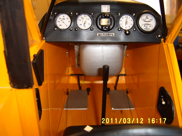

They should hold fine. Will see when it flies if the time spent pays off. Must have spent 8 hours or so just working on the door and window. I use two magnets per location. There are four total on the door and two in the window. And they are very strong magnets. Cobalt I believe. I also put on a new hinge system for the window and installed it so it affords resistance and stays put in any position. The trick was to get it so there is no "spring back" from the hinges being folded over when closed. Having to do all this so it "mimics" a real Cub on the inside too. I don't know how well it will turn out but this picture is my "template" to follow. My color and sheen will be a satin red and flat black. The foot plates and pedals on mine will be a tad back because of ignition and engine servos. There will also be a false bulk head that will have the end of a scale looking gas tank attached covering the end of the engines gas tank.

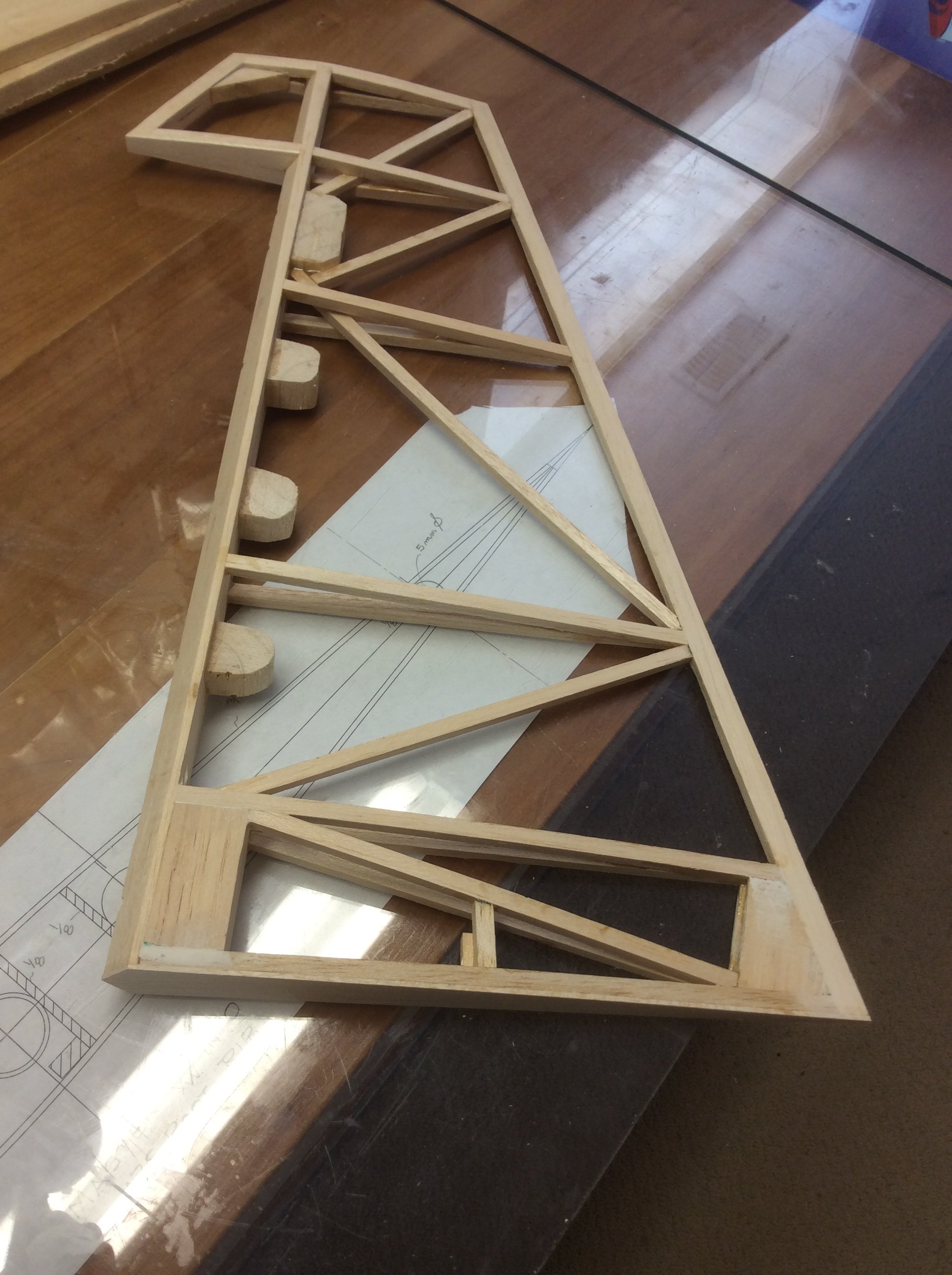

Got a start on the rudder this morning. Kind of stuck need the wing tube and the stabilizer tube complete with sleeves on the hunt but in the meantime I got a start on the rudder.

Well the rudder is built, sanded and drilled just needs to be covered. The weight of the rudder is 1.87 oz that’s not bad for a rudder that is over 20 inch tall. Now I will build the elevators.
Got the wing tube ordered complete with a sleeve from GraphTec in California, they did not have 3/8 tube or sleeves did find a 3/8 tube but still on the hunt for a 3/8 ID sleeve.
