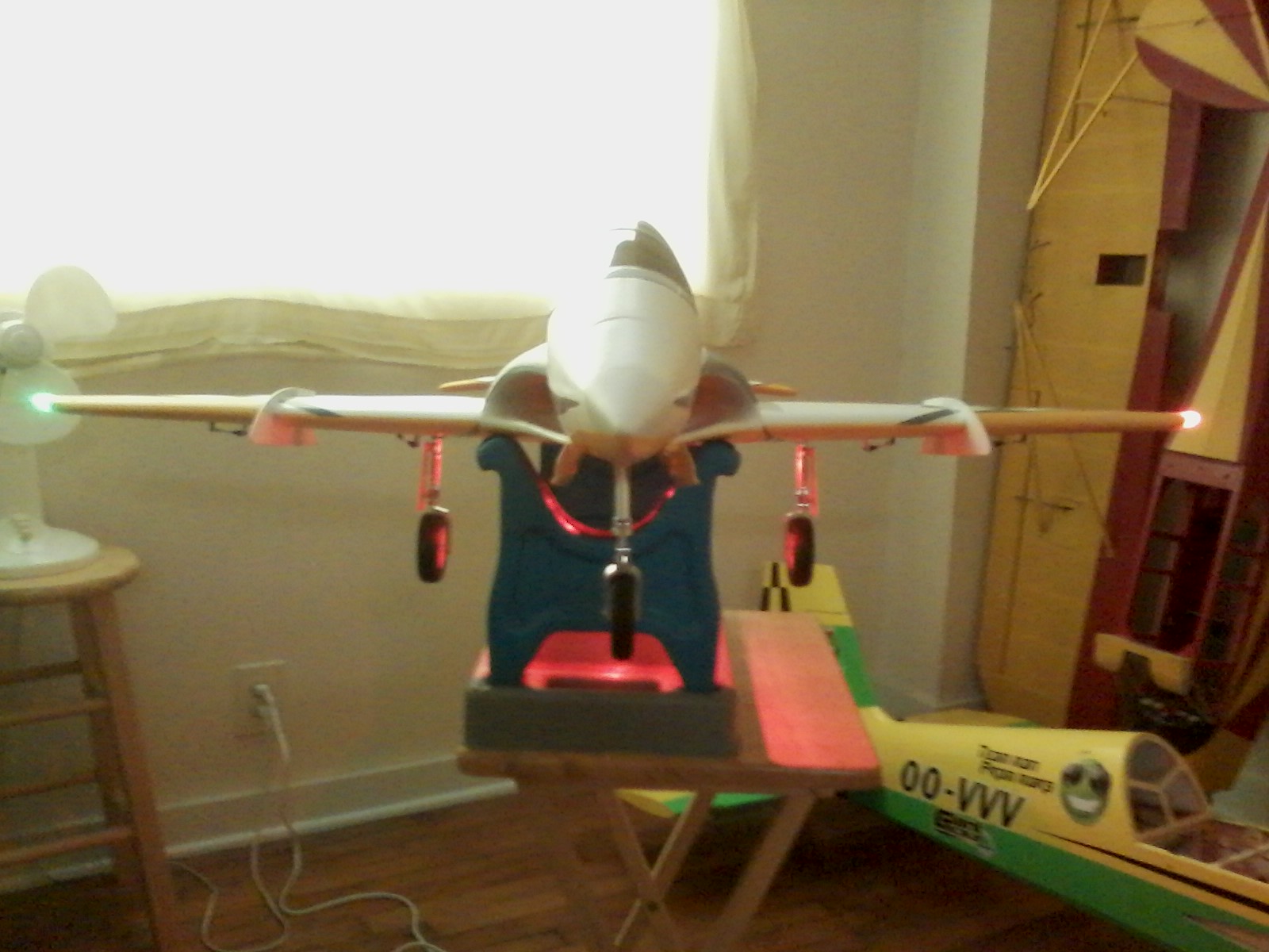

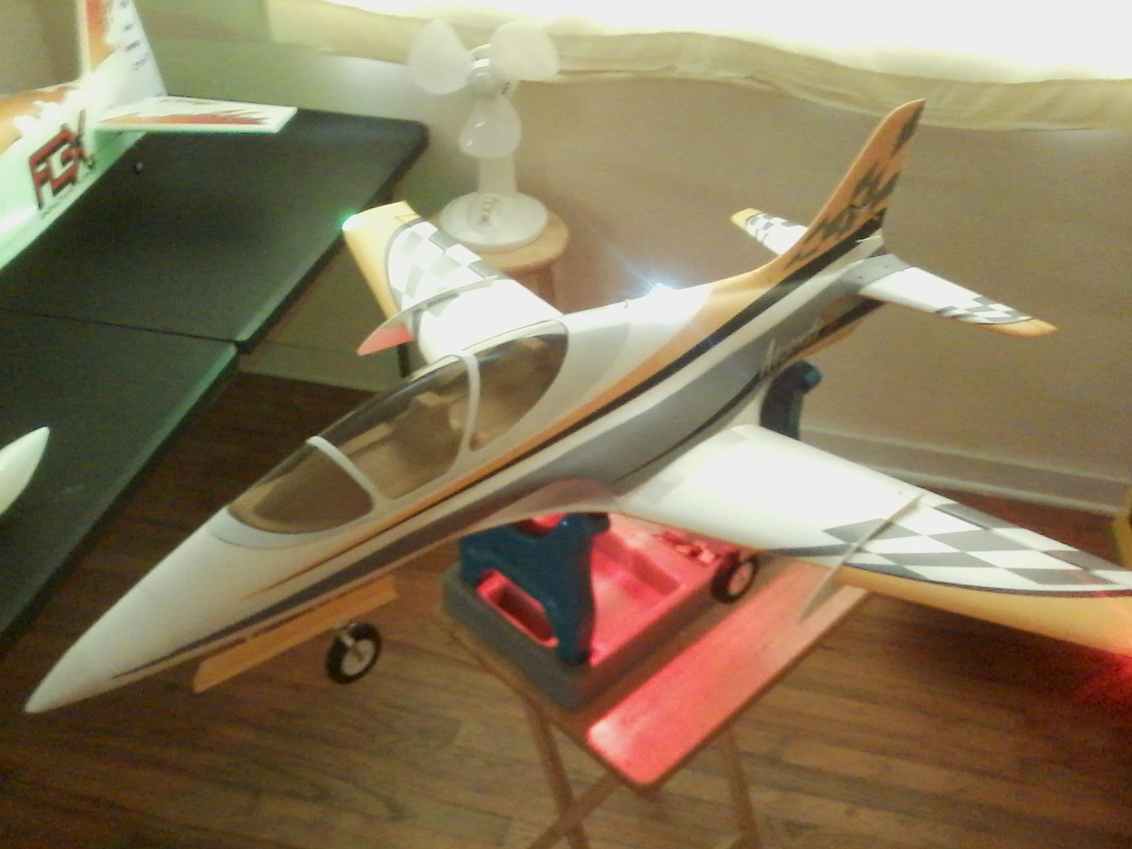

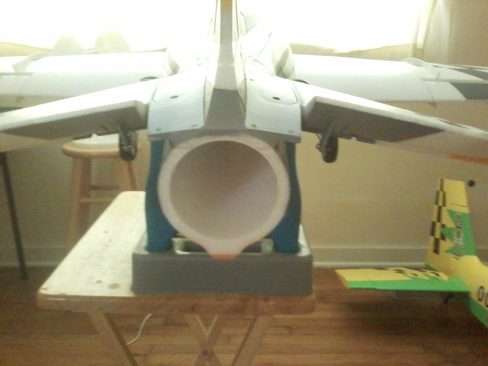

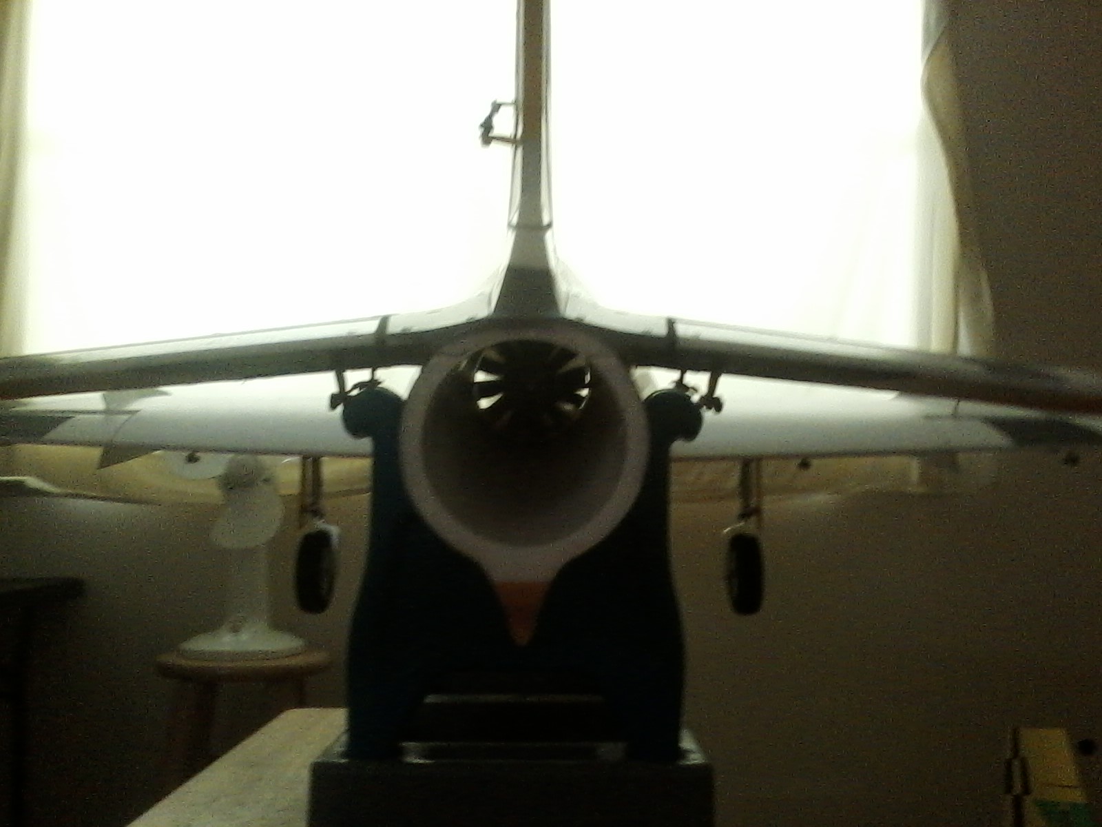

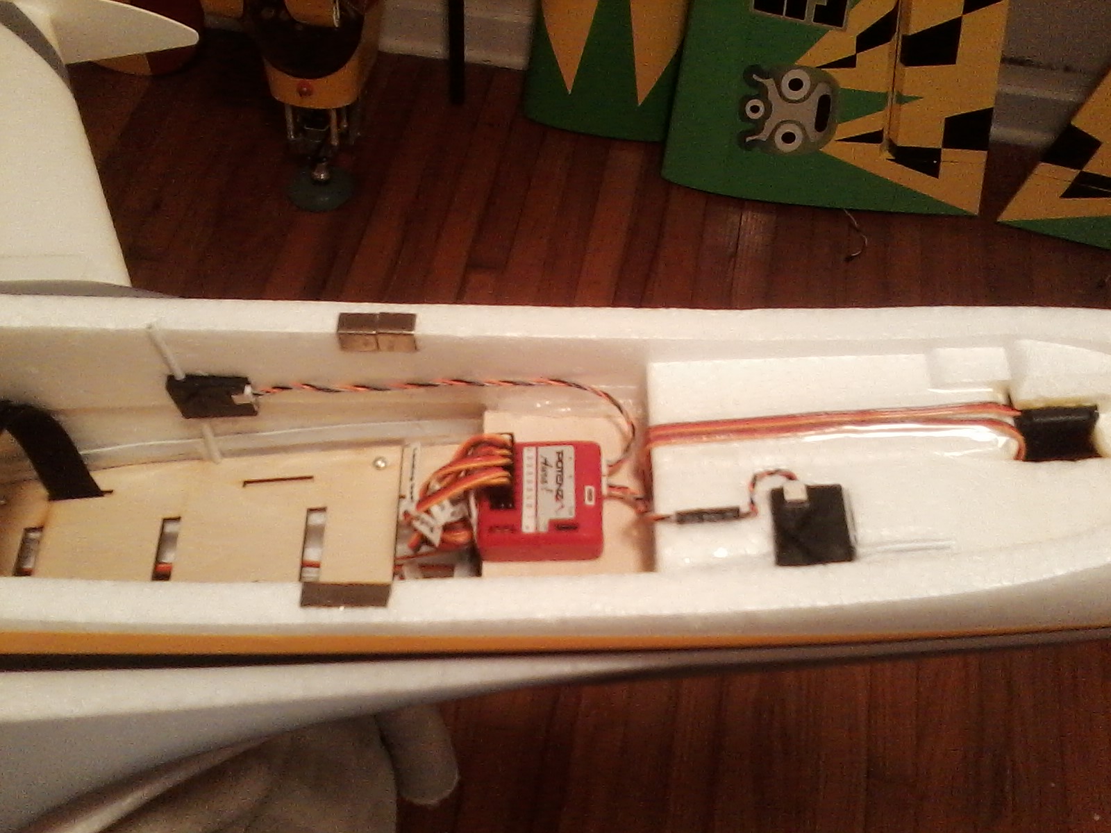

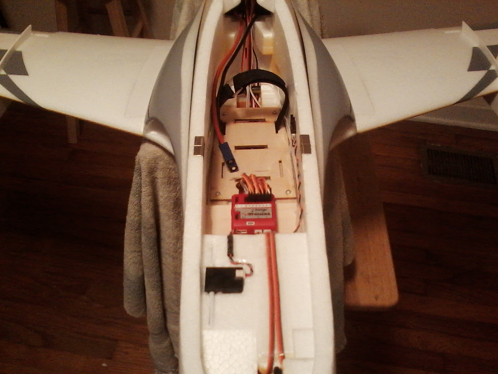

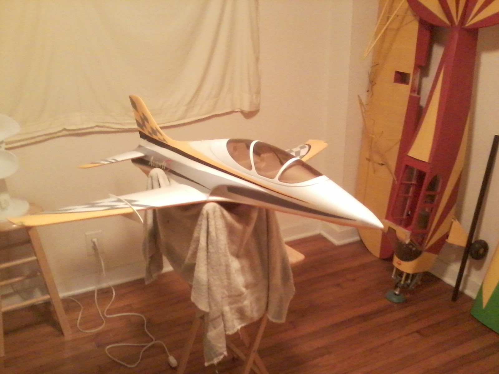

Getting close to having it flight ready. Just waiting on my bat's to show up.
View attachment 103970 View attachment 103971 View attachment 103972

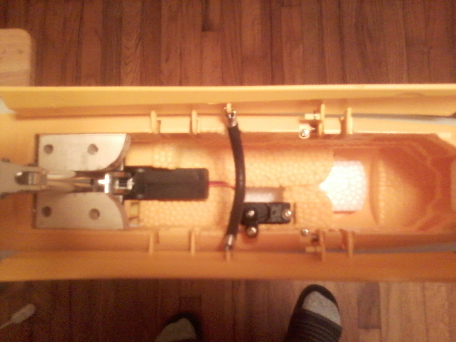

A little extra reinforcement on the gear is not a bad idea. If I have any complaints about a Freewing jet it's that they sometimes scrimp a little on the glue for the retract mounts.Saw some neat mod ideas about the front landing gear so I followed suit. No 3D printerjust old fart hands and some wood.
I also put some shrink wrap around the bay door spring to help hold its shape and avoid metal on metal.
If it's not a triple digit heat index day late tomorrow afternoon it will get MAIDEN . Buddy of mine flies a FlexJet and got some new 5200 40c packs. I get to break in a couple for him.

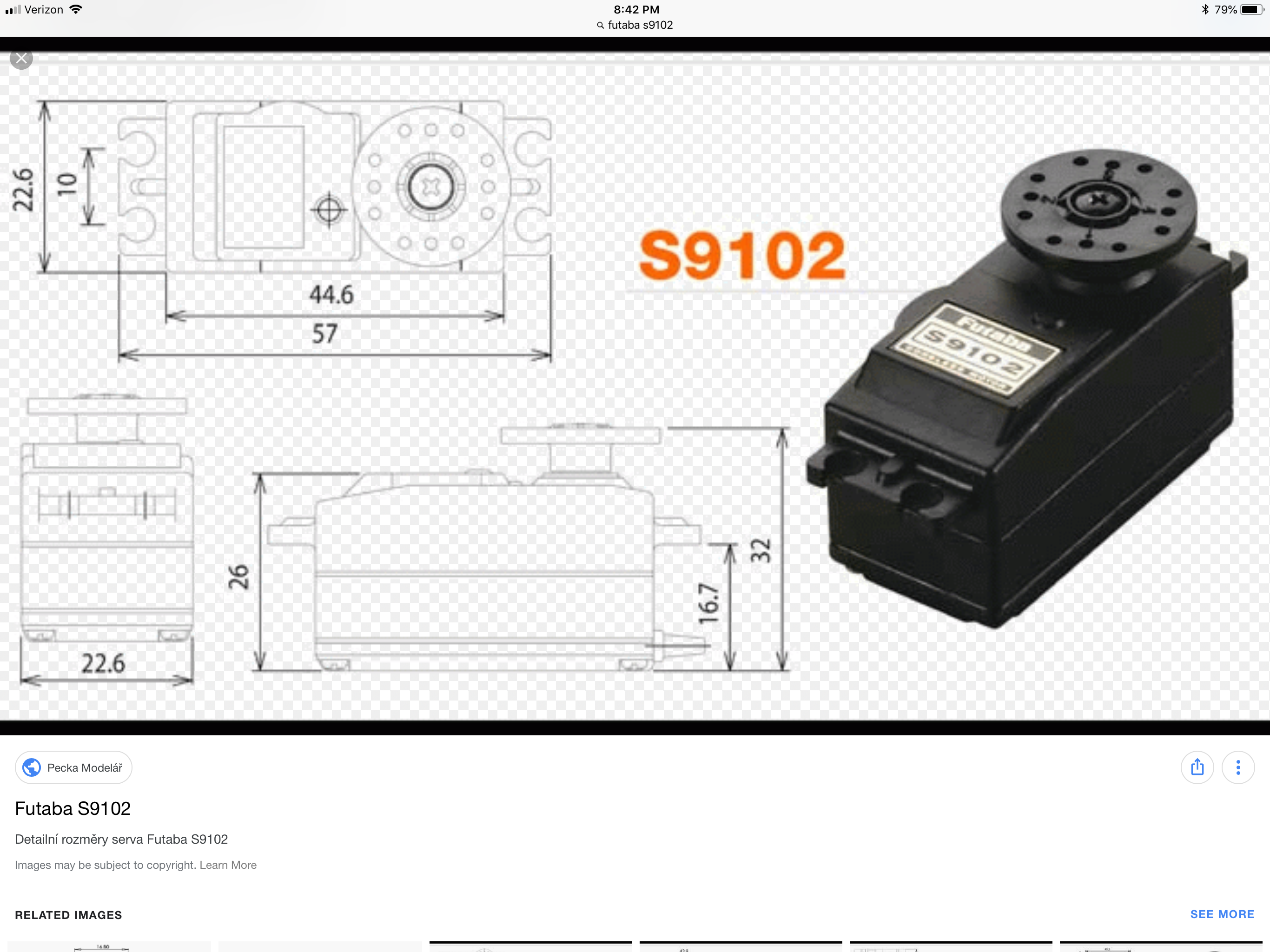

Finally picked up a 2m pattern plane. Price was right. Should scratch the itch I have. Piedmont Focus with a YS FZ140. Has some really old Futaba servos that are not to exceed 4.8v except for wing servos. Those are S9102. Does anyone know if the 9102 would be good for 6.6 volts? Plan to put it on a BEC and regulate the voltage to 6.6.
The tank is MK and has a funky stopper that also wraps around the outside of the tank lip. Anyone know a source for those? Or would I be better off to pick up a new dubro tank and use an aluminum stopper hardware upgrade to handle the high tank pressure?
