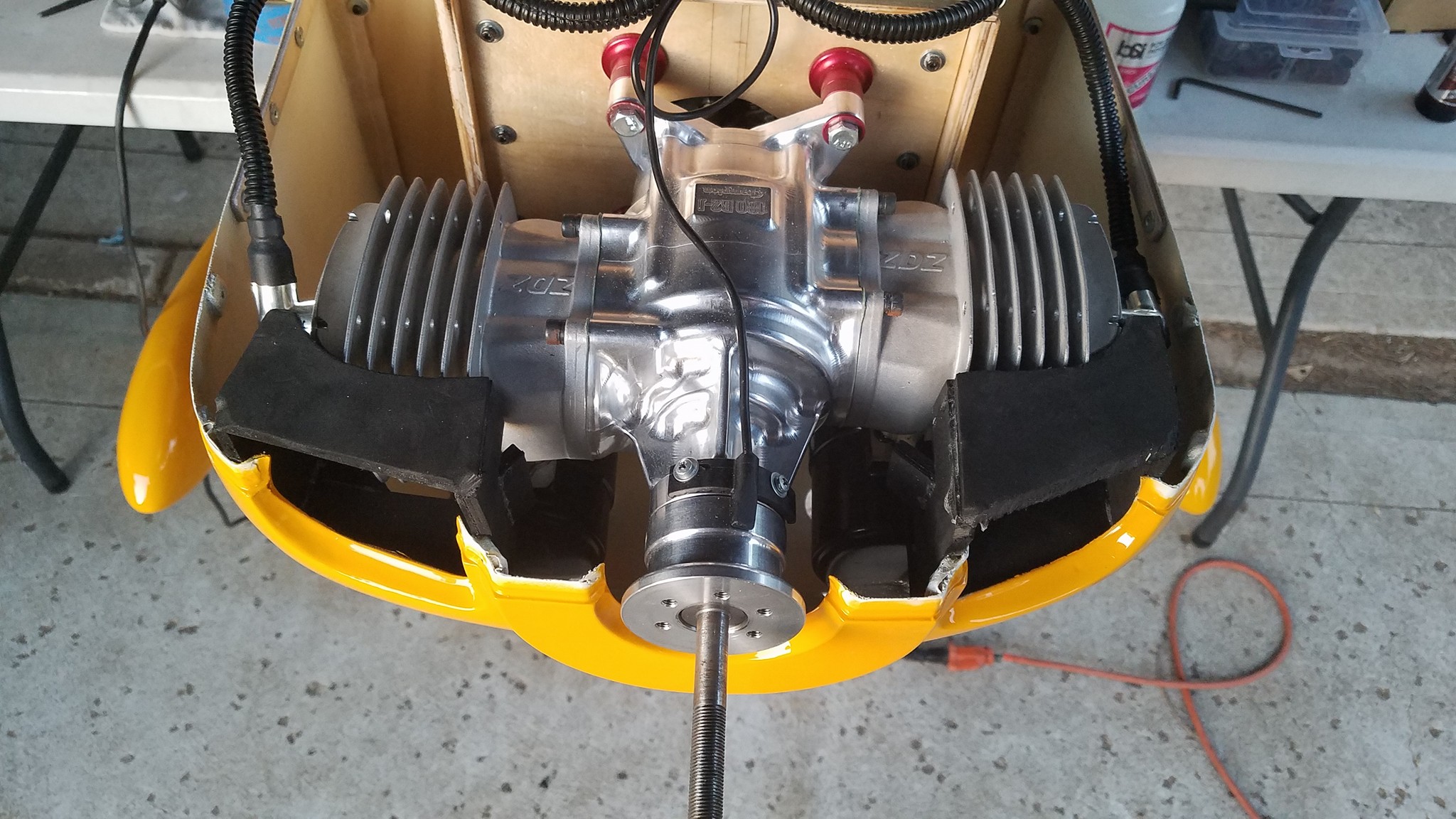

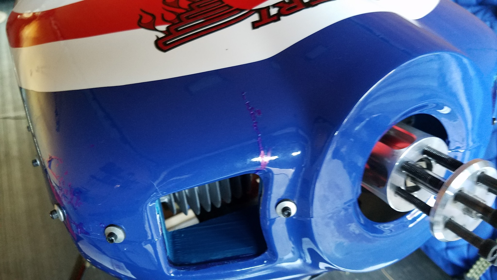

Baffling is extremely important, with it you are forcing more cooling air over the cylinder heads in flight than they will ever be exposed to running wide open on the ground, even just the bare engine itself. I have all of my engines baffled, and as shown, chainsaws and leaf blowers, weedeaters even have cooling fans with ducting to force the air over the cylinder heads to keep them cool as a piña colada :) Another factor to consider is gas engines retain more heat due to more material thickness. My baffling usually has case vents to help vent some air to the case.

I think we all agreethat baffling inside a cowl is important, lots to learn from each other. I’ve picked up the foam air inlet baffling tip somewhere down the line a few years back which helps direct air TO the cylinder inlet and not tightly AROUND the cylinder. Take a looksee at a full scale baffling system. The air is forced to go around tightly against the cylinders usually by sheet aluminum clamped close or held down against the fins with a spring.
You loose a lot of airflow around the cylinder (path of least resistance) then when you have baffling tight up against the cylinder.
Directing the air is great, but not ideal...that air path needs to be tight against the cylinder. Being a full scale aeroplane tech, I’ve played with baffling a lot, and seen some cool stuff over the years (look up plenum baffling) but I have very slim experience on 2cycle gas.
Point being that baffling can be pretty extensive, but there are so many factors to consider and I’d rather like to hear people say they are baffling the inlet air to the cylinder instead of engine baffling unless it’s directing air tight around the actual cyl sides and the rear to the extreme where within the engine box is sealed only letting air get to the cylinder walls/fins. Think compressibility. But like I said, that’s a four stroker with a oil lubrication system. So my knowledge is relevant to that. They need cooling air folks! Lol which goes back to square one ha ha
