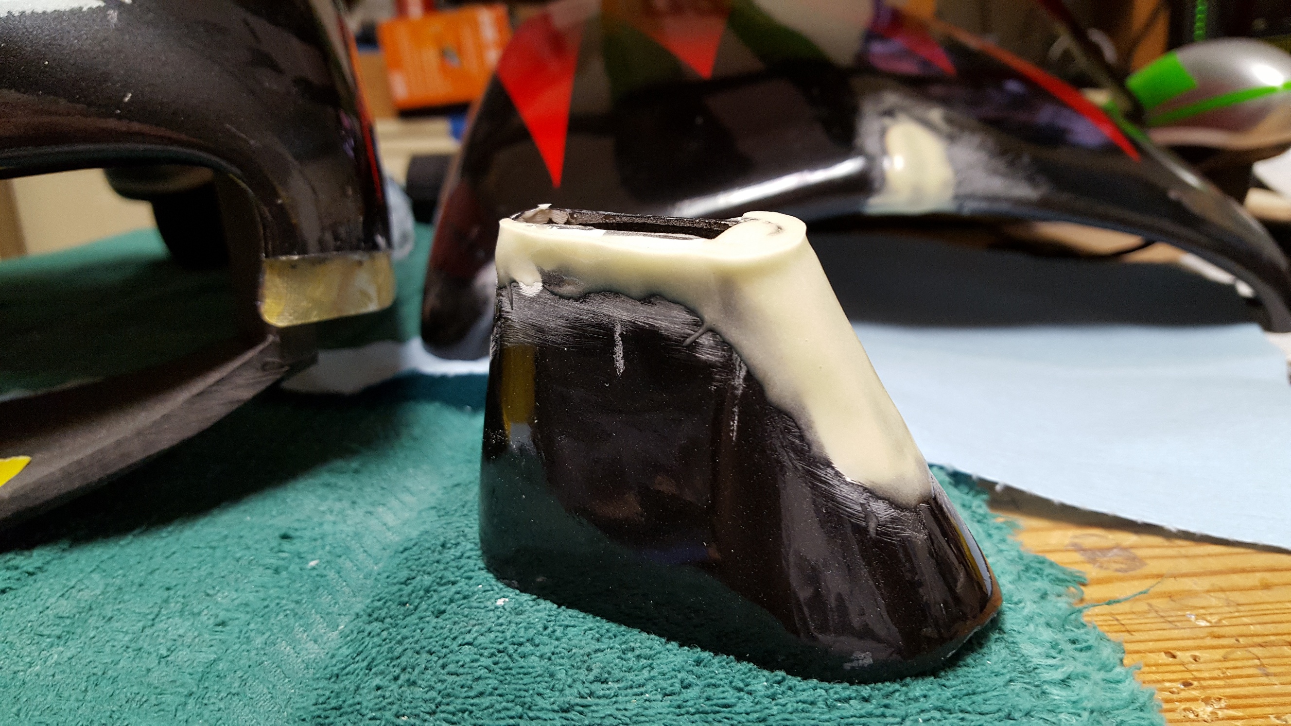

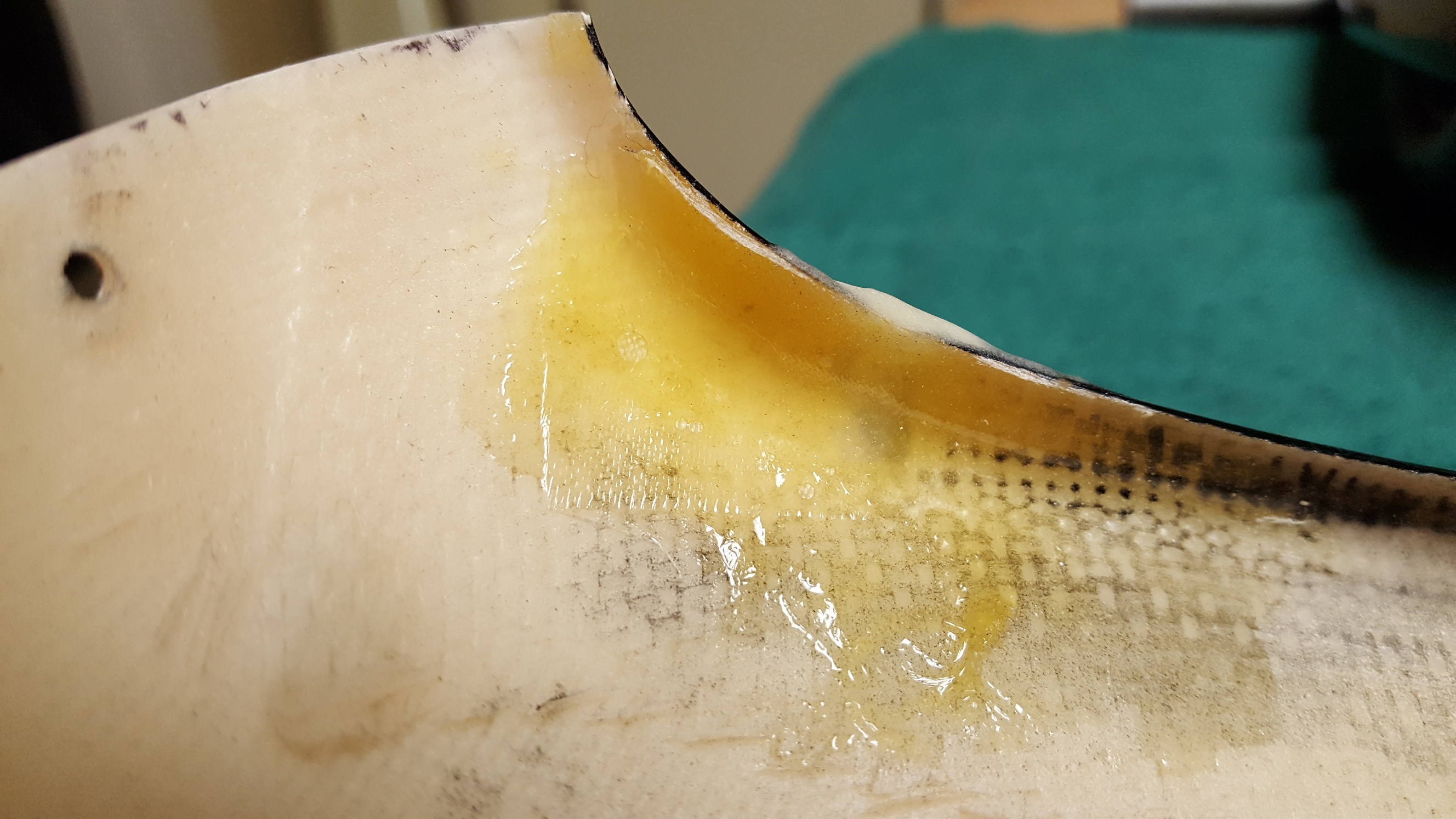

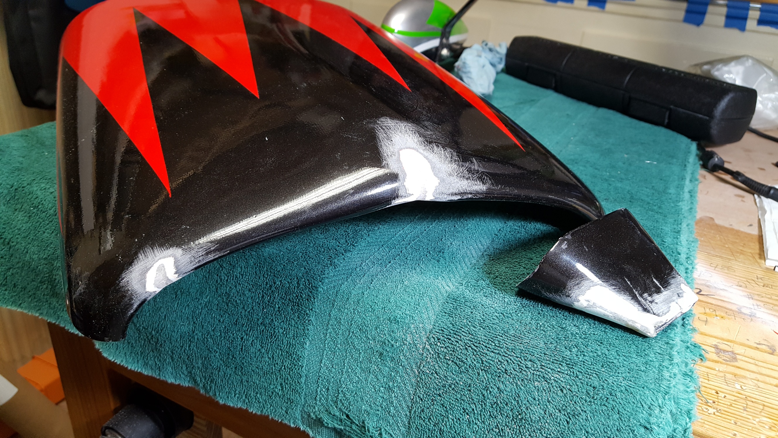

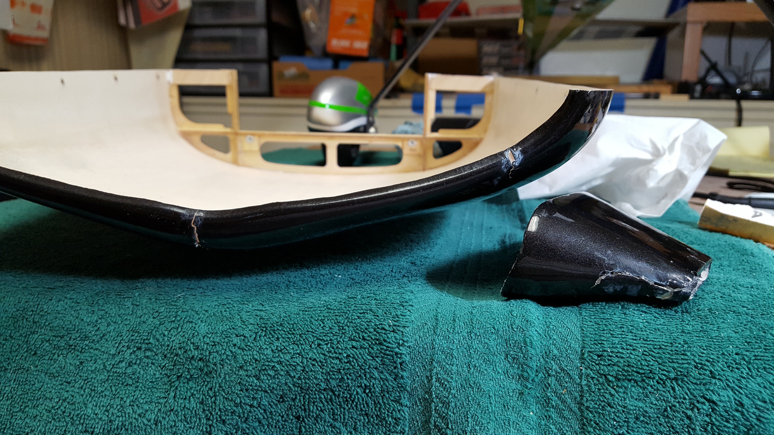

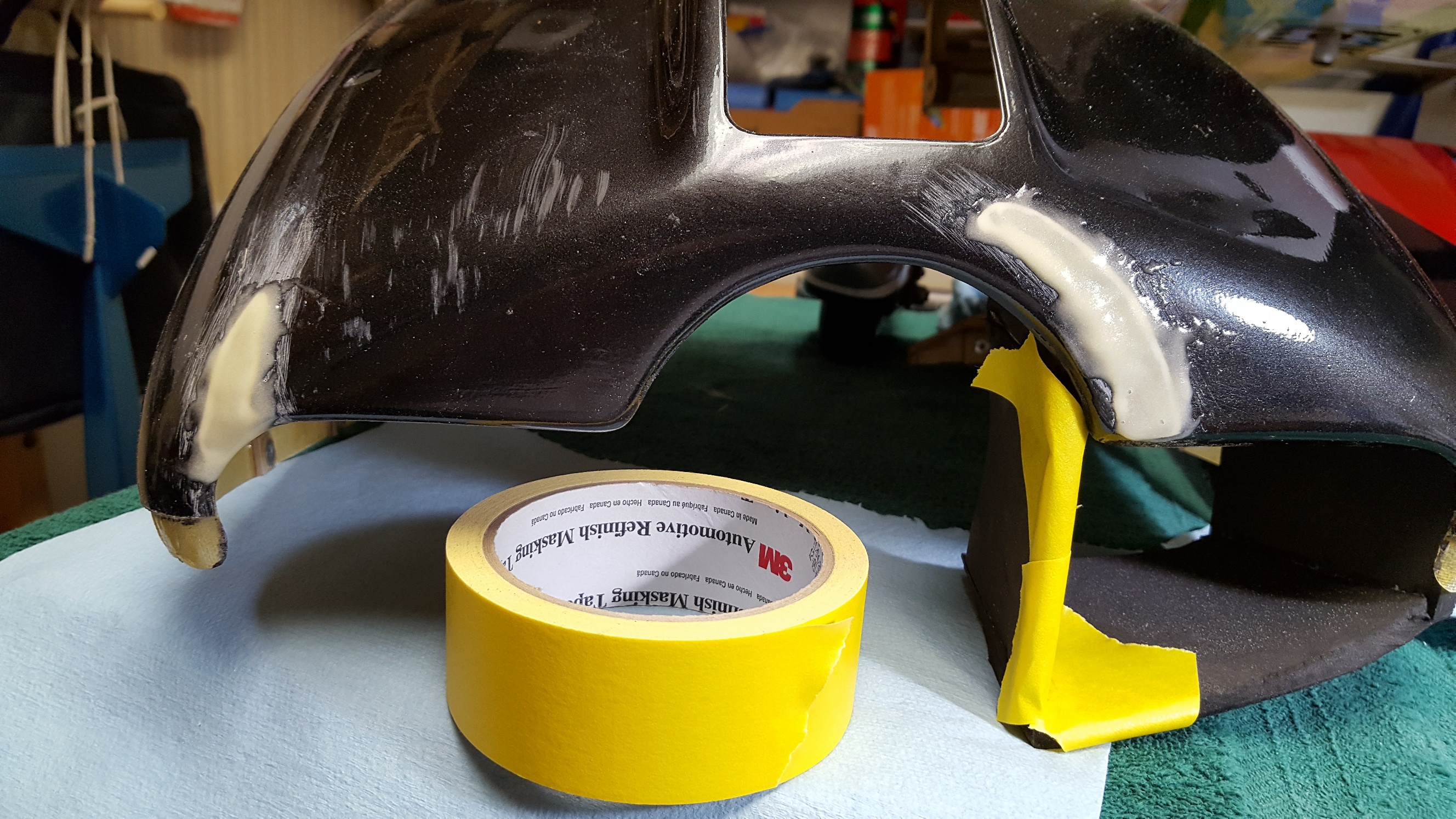

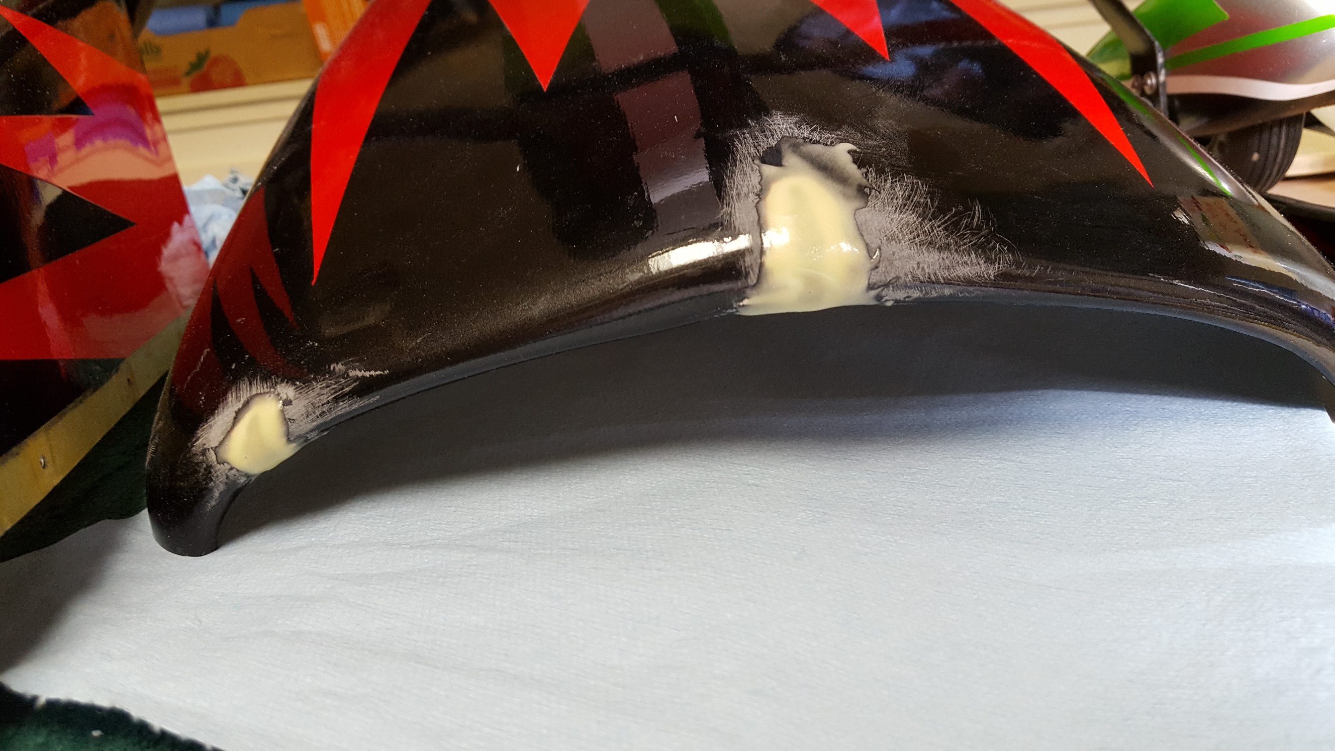

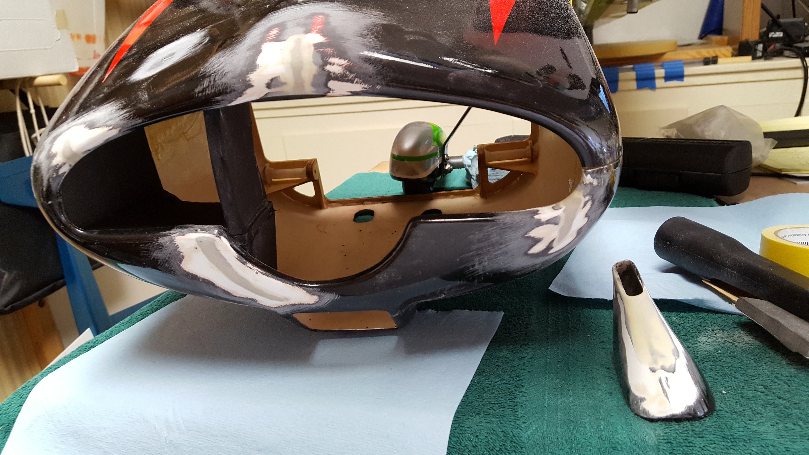

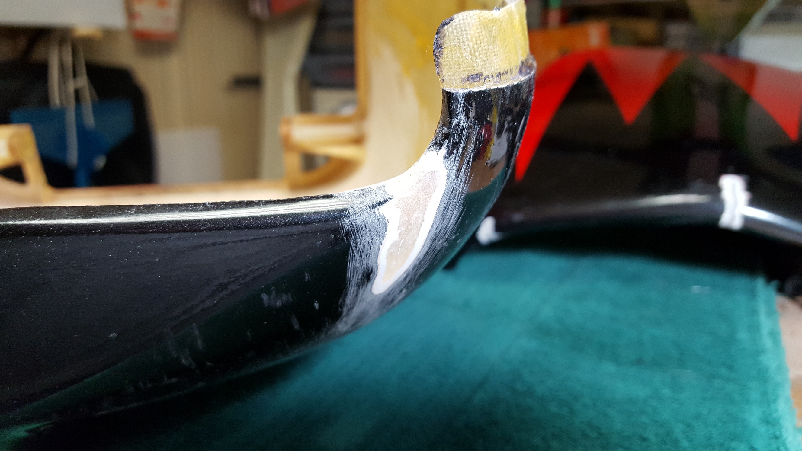

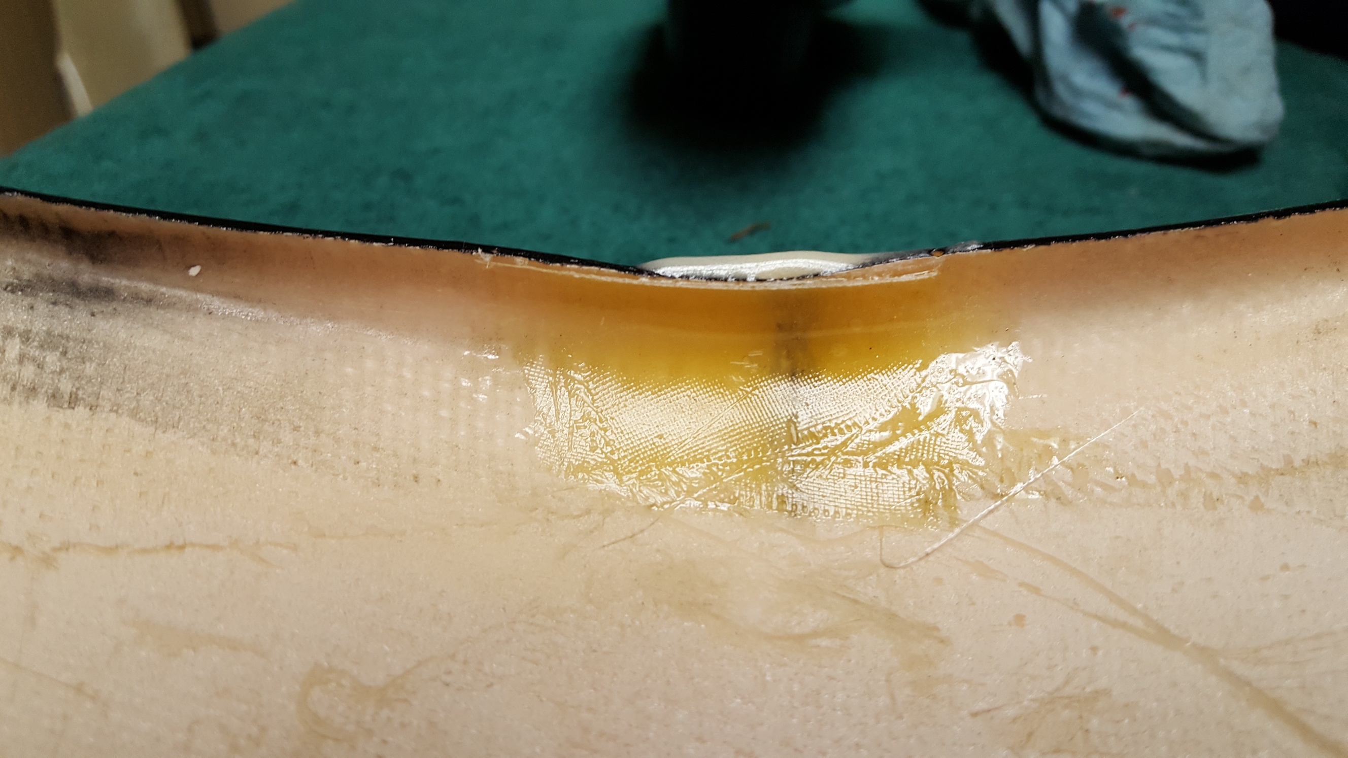

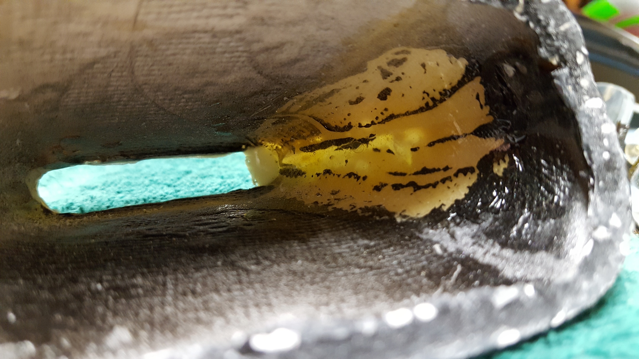

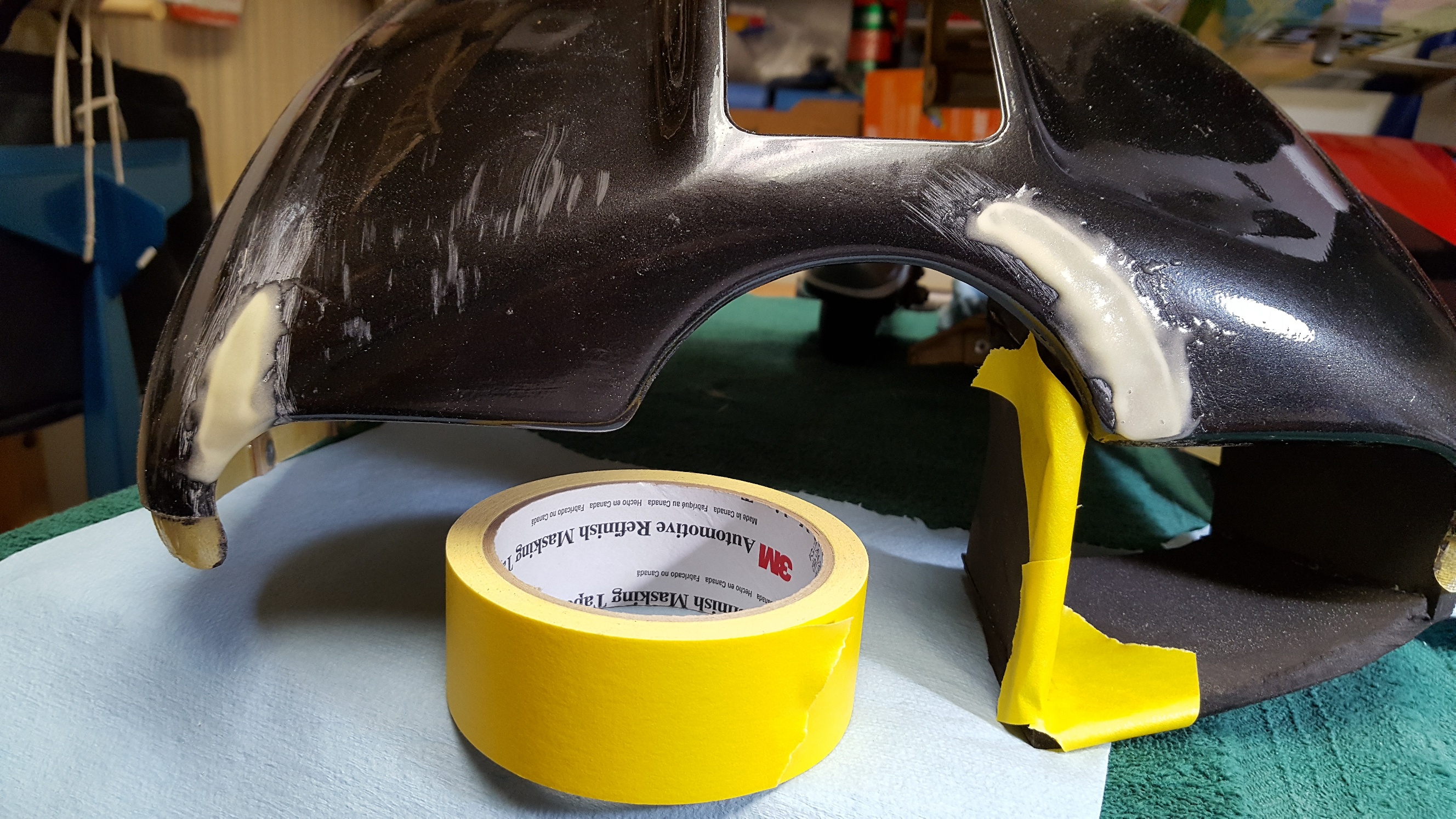

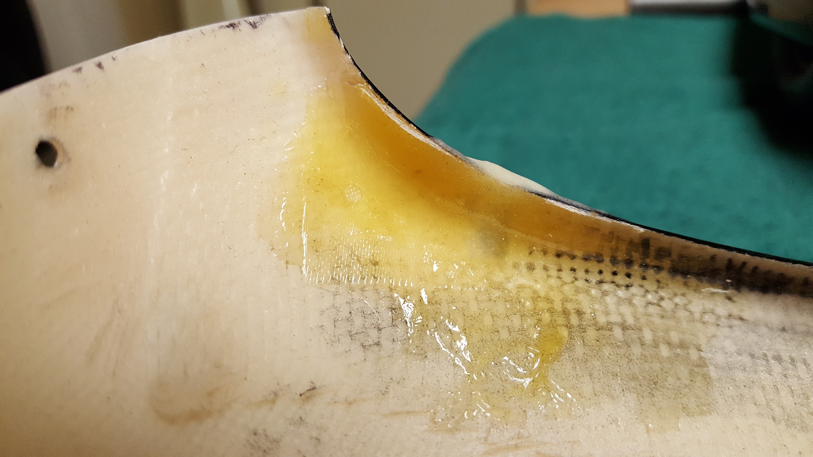

I've been doing some repair work on the cowl and cuff for my 35% Extra 300. I started by aligning all the cracks and using some thick CA and accelerator to glue them together. After that I used some glass cloth and resin to reinforce the back side of all the cracks. All I had was 1.5 ounce cloth, so there are several layers on each spot. I let the resin cure overnight, then trimmed off all the excess and then took a sanding drum to the outside of each crack to V it out a bit, followed by hand sanding them with some 150 to smooth it all out. I mixed some 30 minute epoxy with milled fiberglass to make a filler and filled everything. It's not the easiest sanding stuff in the world, but it's strong, doesn't get brittle, and it works great. I let that harden overnight and blocked it with 80 grit and then 150.
I meant to take them to work with me today and finish the bodywork and prime them, by I forgot.
View attachment 104383 View attachment 104384 View attachment 104385 View attachment 104386 View attachment 104387 View attachment 104388 View attachment 104389 View attachment 104390 View attachment 104391 View attachment 104392
Wow you really did do some damage to that cowl. I always find it difficult to repair cowls and as you said tough to sand and you are always waiting around for the epoxy to cure. . Plus when you are done it needs to be repainted again which in your case is not a big deal. Looking good that landing gear cuff needed quite some build up.
