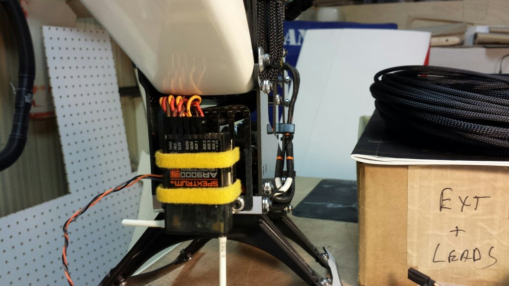

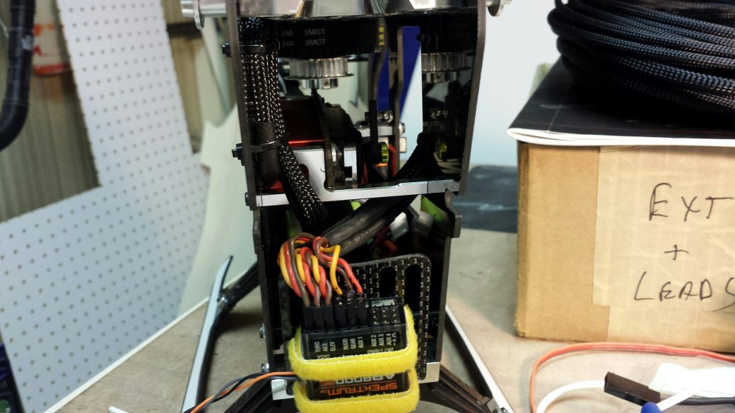

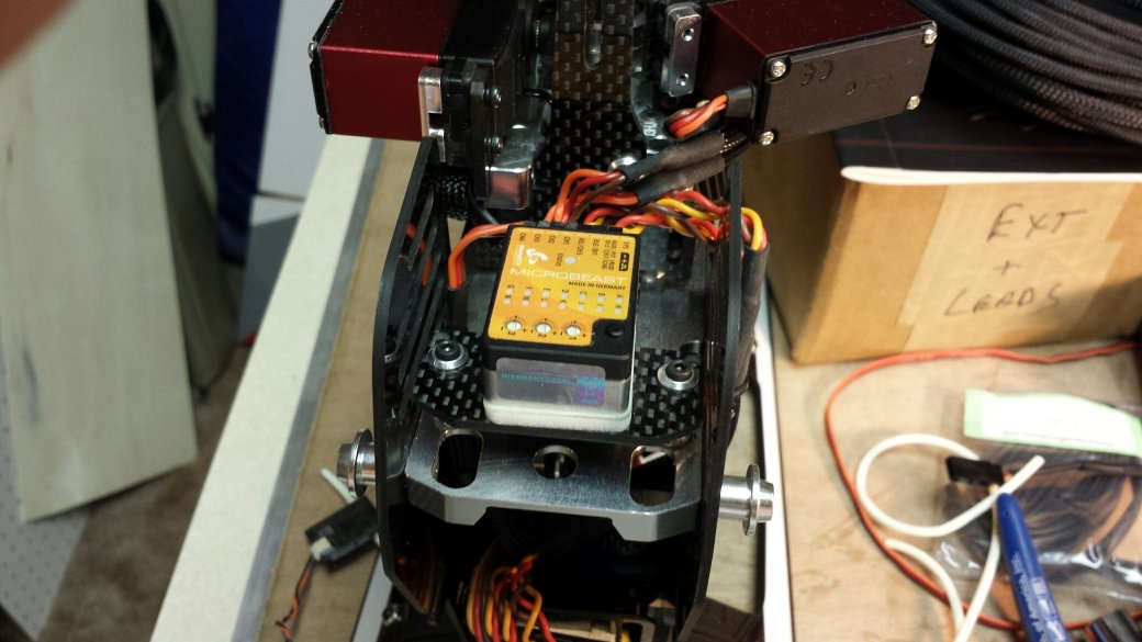

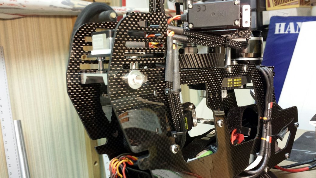

Today I received the male to male leads I've been waiting for to get the receiver in my Goblin 570. One of them I had to split the three wires into separate plugs for a signal wire. I wrapped them all with snake skin and routed them the best I could.
They have a spot to mount a receiver on the back of the frame under the tail boom. The problem is they really don't give you much room to squeeze the wiring between the bracket and the boom, not to mention you need to make sure there is room for the tail belt and the rudder pushrod. I ended up taking a little off the bottom of the bracket to lower it and get a little more gap for the wires. I also sanded the top of the bracket nice and smooth and round to keep the wires from chaffing.
I still need to make a power lead from the battery to the receiver and a few other things, but it's getting there.

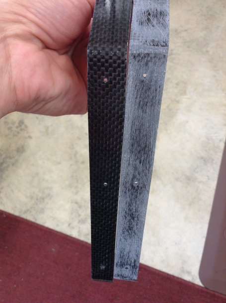

Got a little done on my Edge landing gear mod. Got the two halves of the gear epoxied together. I scuffed the gel coat on the inner half first to help the epoxy stick. Then I applied 30 minute epoxy to both halves and screwed and clamped them together.

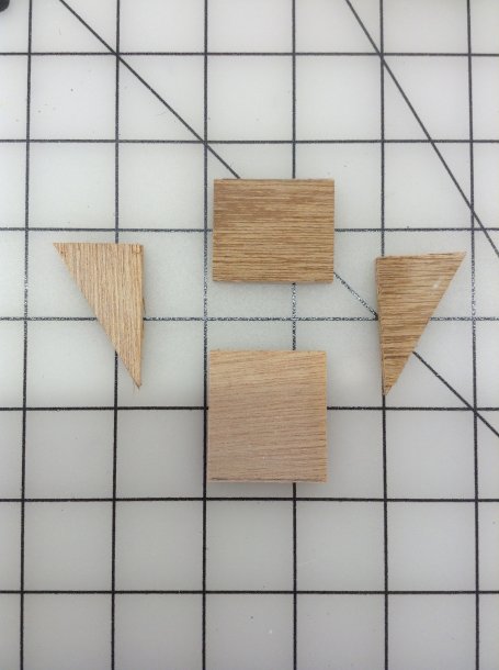

Next I cut out a new landing gear block out of 1/4" ply. Then I epoxied it together and also pinned the joints with 1 mm carbon rod. This block will be glued and screwed to the front of the original block. This will allow me to shift the new landing gear forward about 3/4". Hopefully that will fix the nose over problem. I forgot to get a pic of the assembled block. But I will tomorrow.
