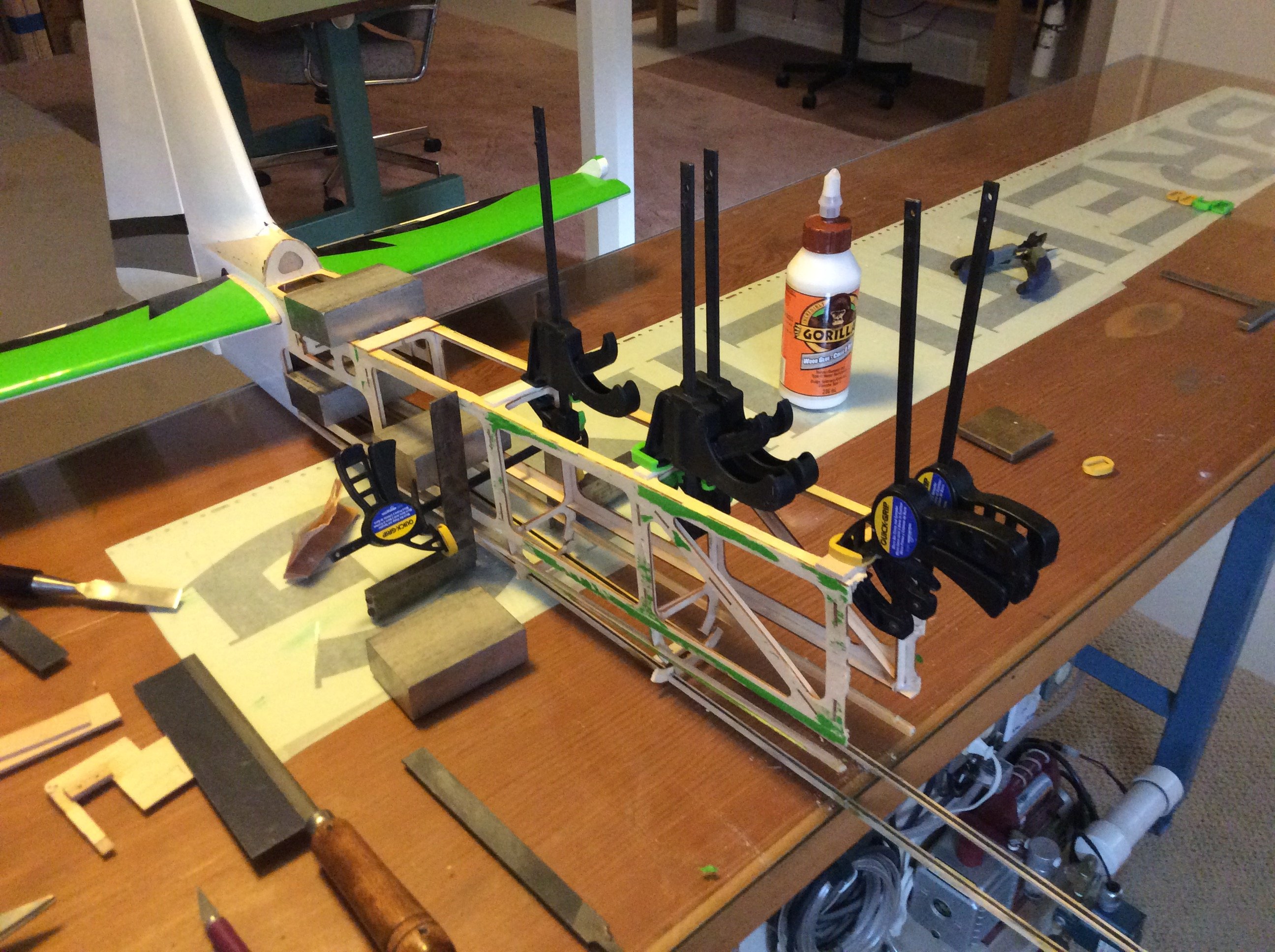

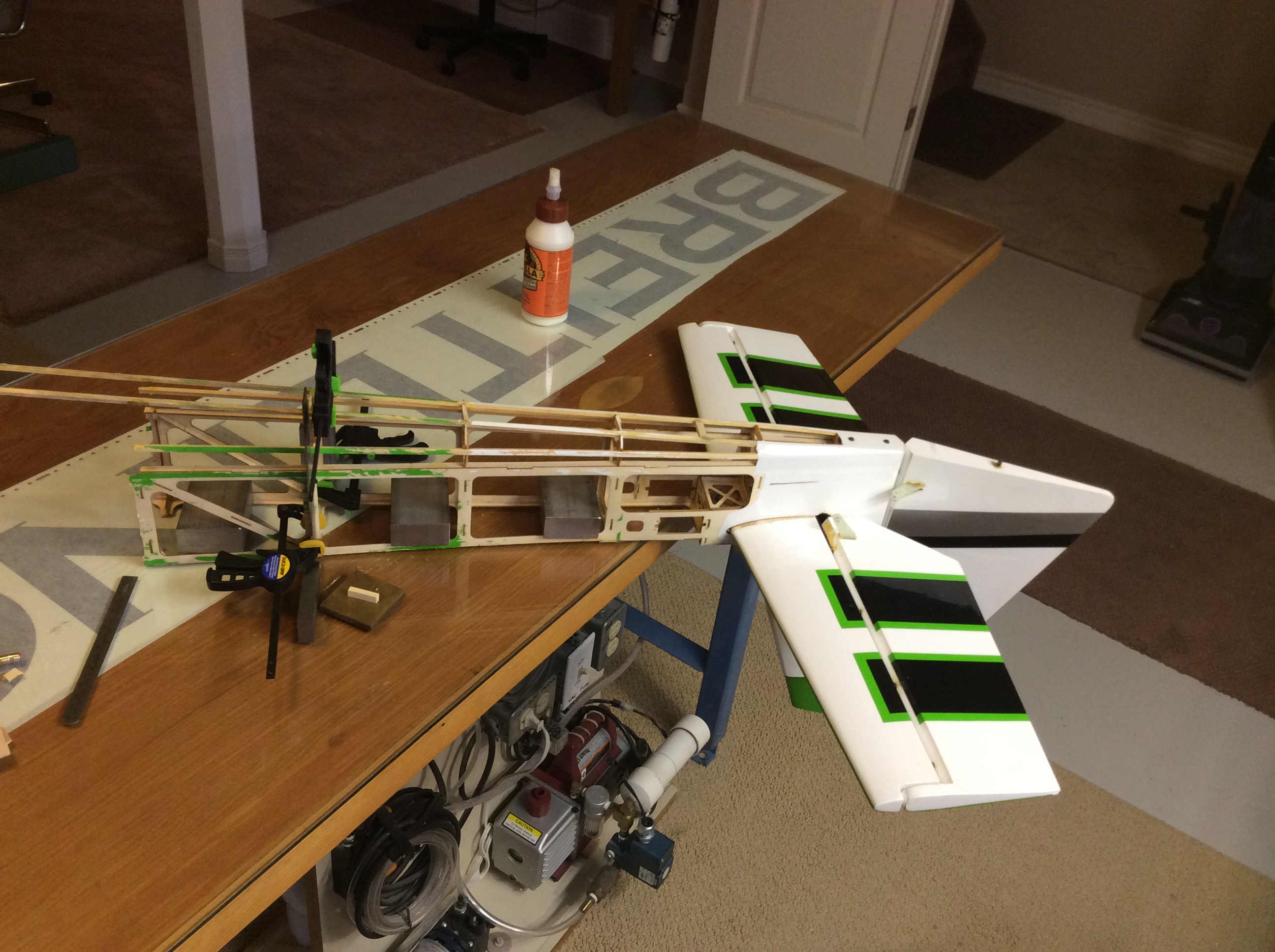

Well I decided to have a look at the 20cc Edge that I drilled into the ground earlier in the summer. See if I can salvage some thing out of it. Cleaned all the mangled wood of the fuselage. Will make quick layout on the workbench and see if it is a worthwhile project for the OS 22Gt. The stabilizer looks good in the picture but is broken loose and a couple of the hinges are broken so I will have see if I can remove it or try to fix it in place.
Well made a small start cut and sliced all the bulk heads and pulled the fuselage in to make it 2 1/4 inches wide from the tail to the motor bulk head. That will make things a little easier to line up. The show stopper can still be the stabilizer. Need to finish up on the fuselage to were I am and then tackle the stabilizer. If the stabilizer can be fixed without destroying it then that will be done and then finish of the fuselage to the motor bulkhead.
Hopefully by making it only 2 1/4 wide it will take out some weight.
