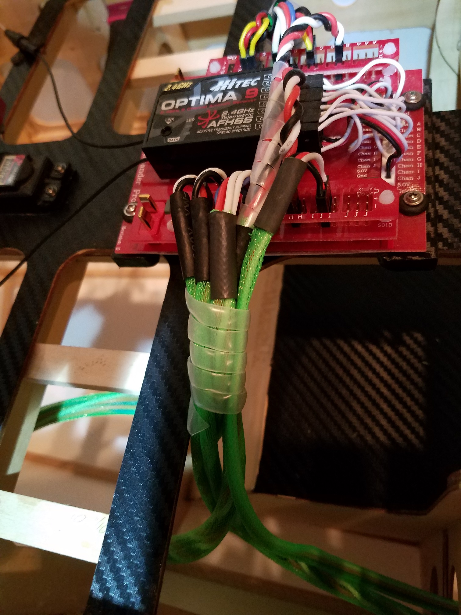

Rewired the entire airplane. Had fun with soldering, crimping, and routing. Almost where I want it...then need to fire it up and see if the problem is solved.
Does someone have a tip on terminating snake skin? You can see mine looks horrible at the moment.
What snakeskin are you using? I hate to admit it, but there are some brands out there that just really "SUCK" when it comes to getting a nice finish on your project. Ask me how I know this. And then you have this: https://www.cableorganizer.com/cable-sleeving/side-entry/
It truly is the best my son and I have had. The ends do not unravel as badly as some of the others. And a gentle warm flame will seal the ends quite nicely. For ending them, see @pawnshopmike post below.
I use shrink tube to terminate snake skin. Works like a charm.
This is also exactly what I do.

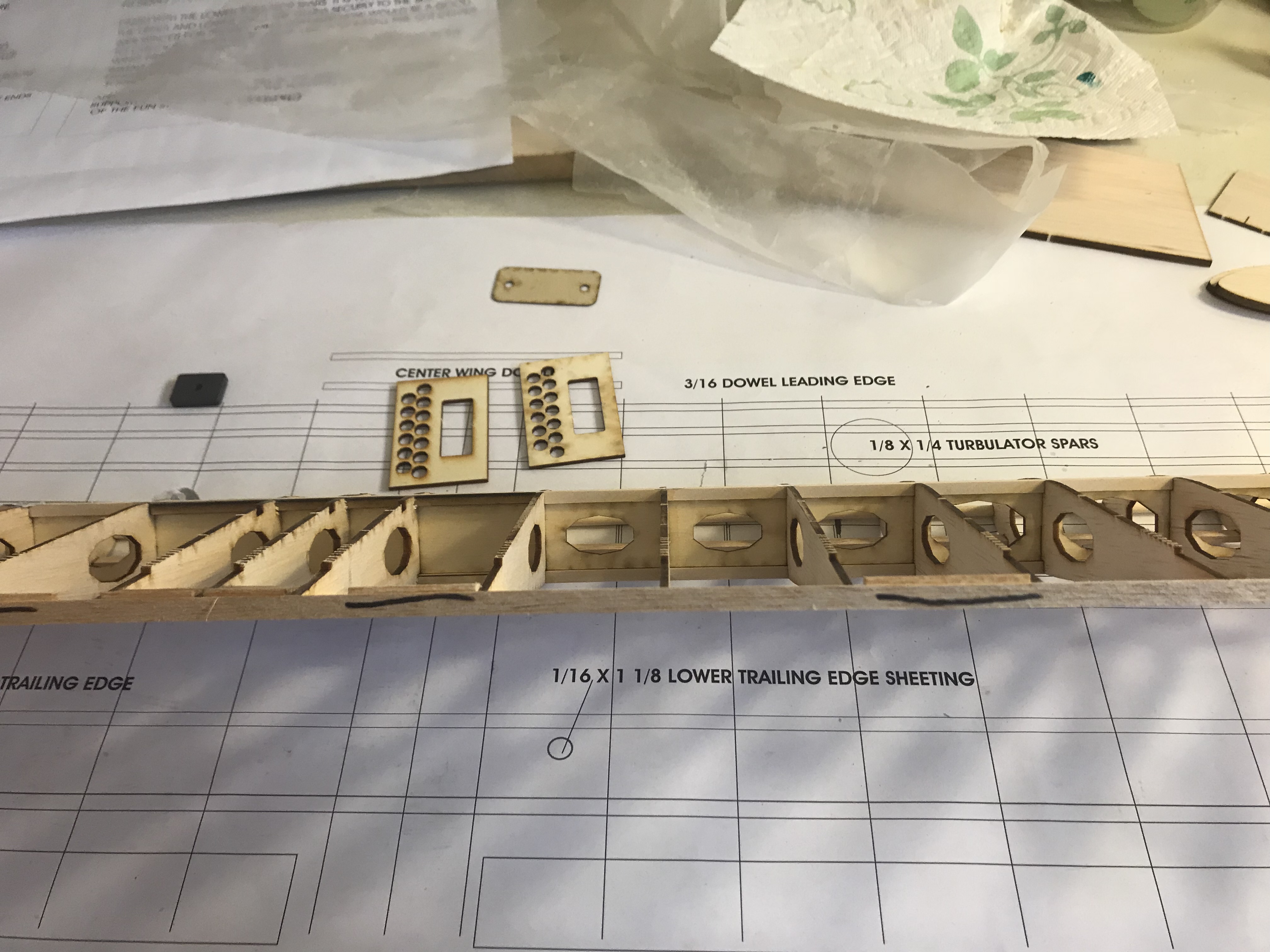

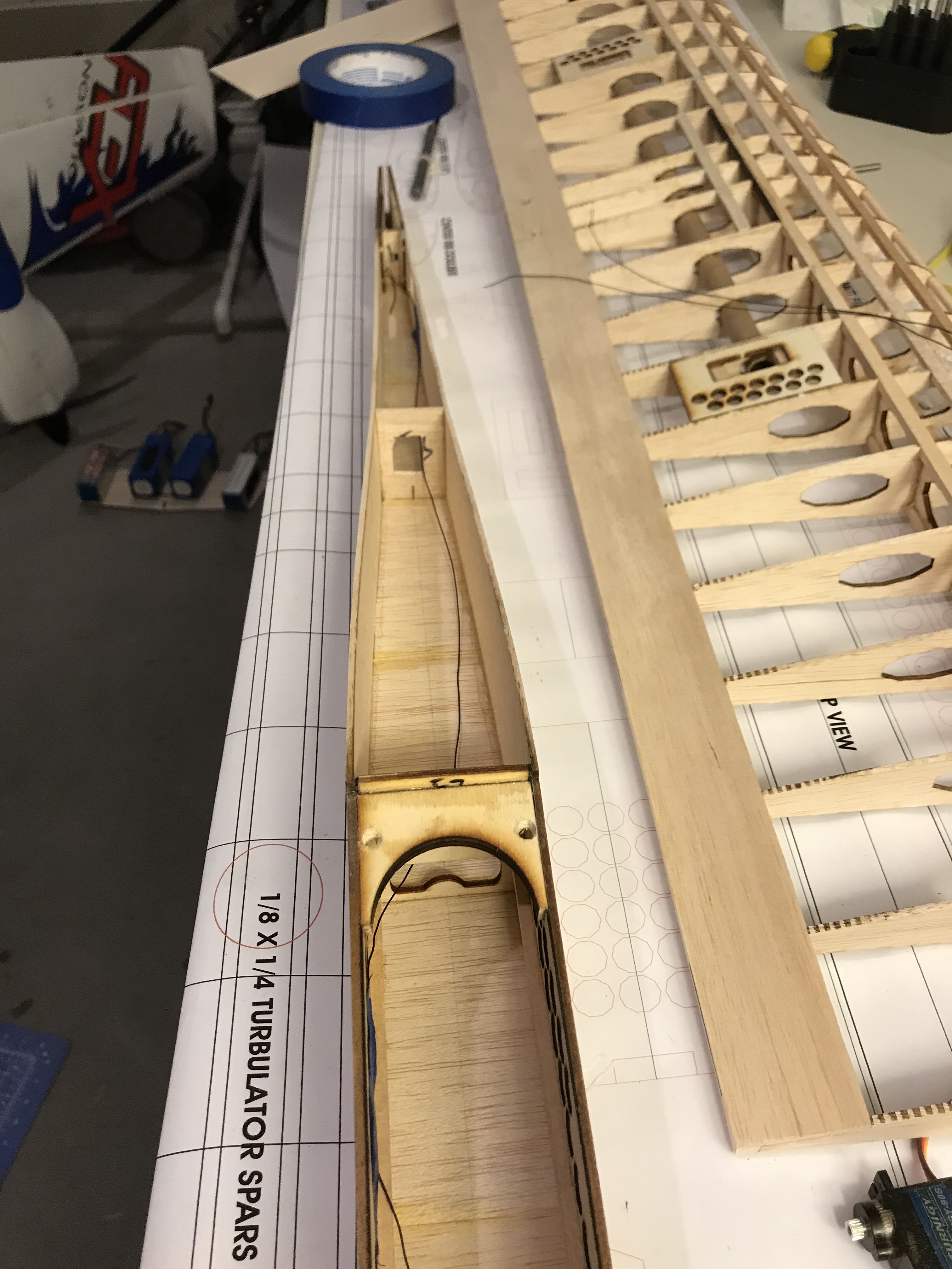

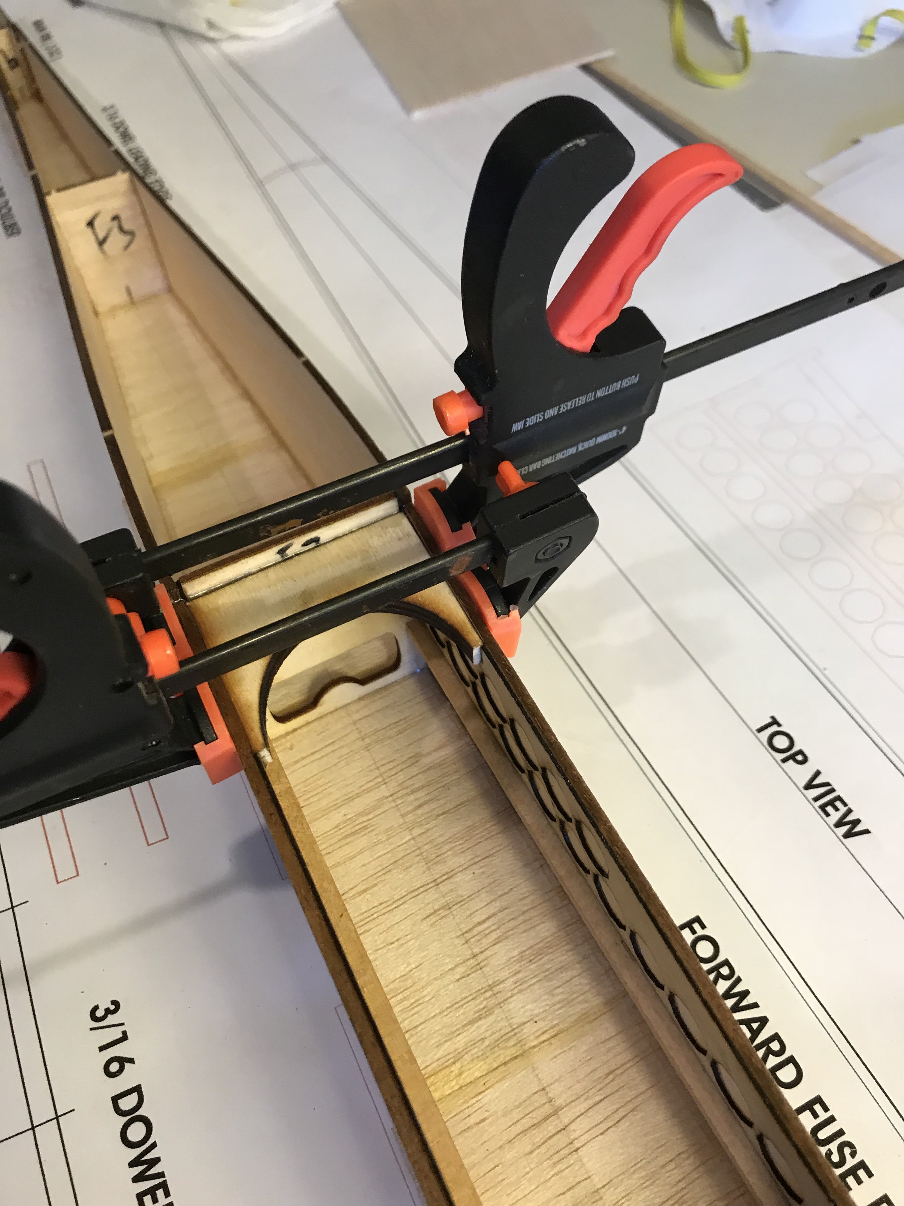

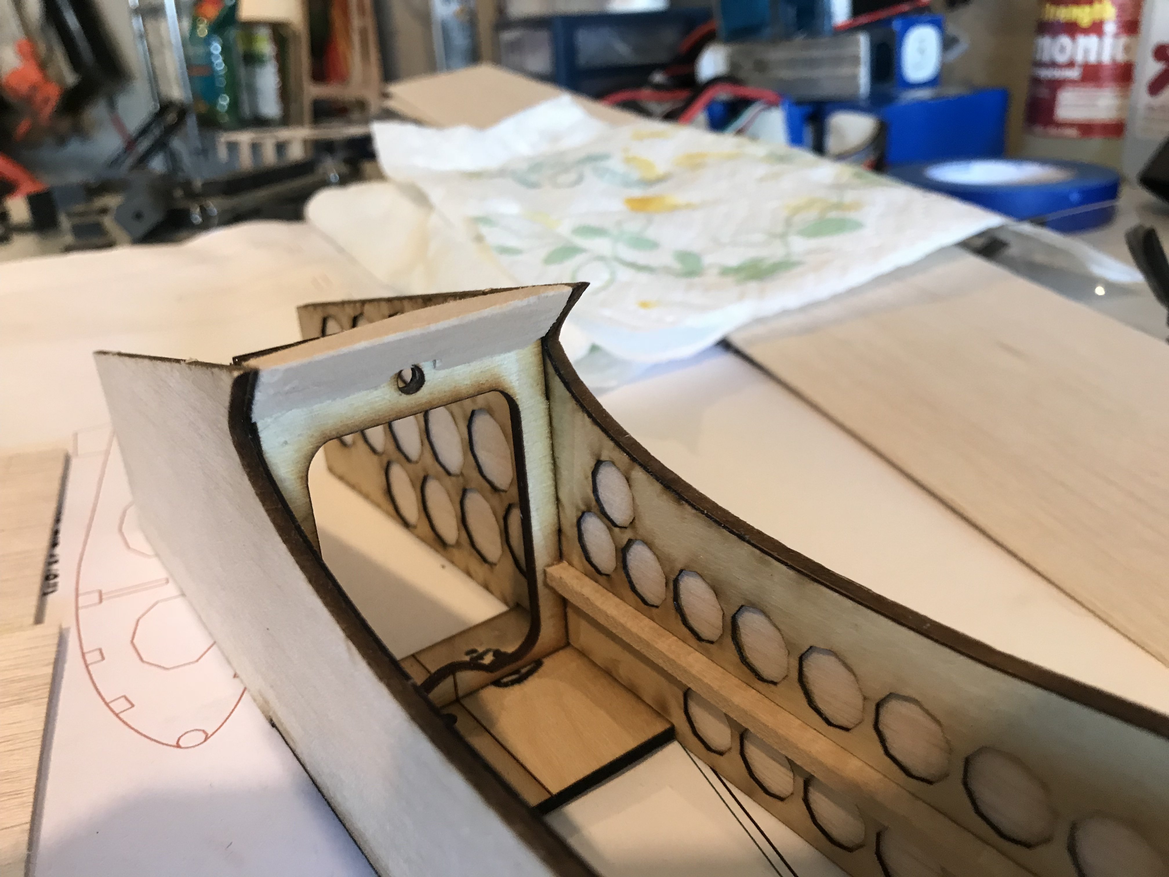

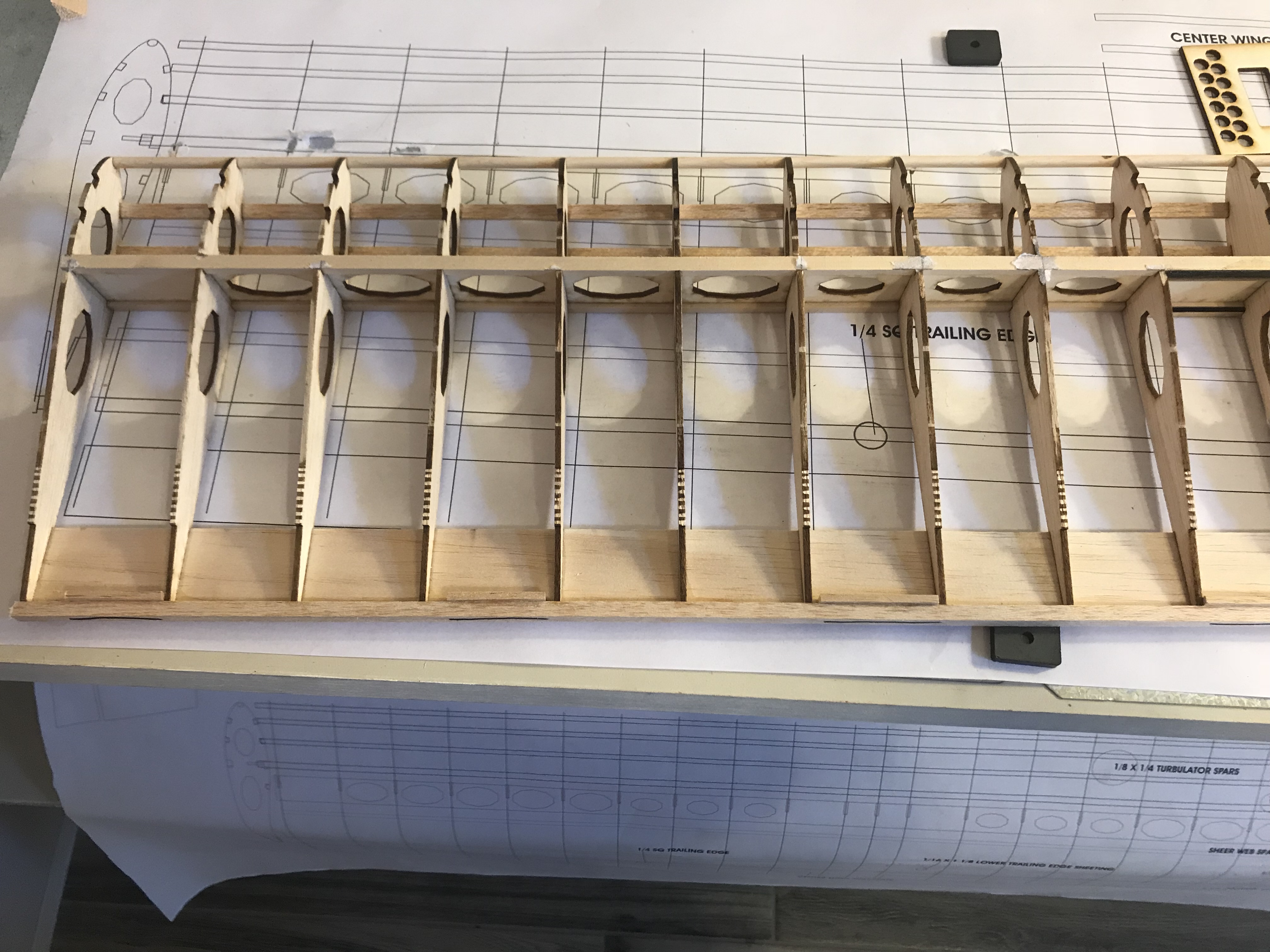

Here is the work that happened up through today on my laser-works.com Slim Jim 20. Just pics. Ask if you have questions.
