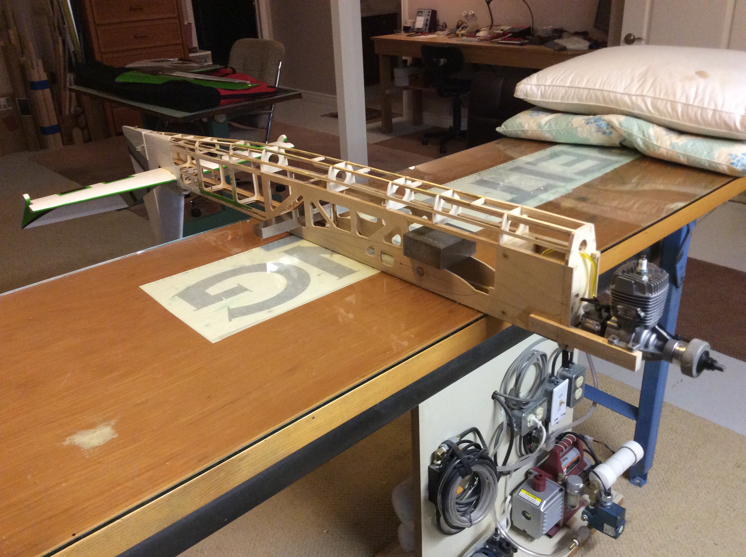

Did some more work on the profile 20 cc Edge. The bottom is done and all the small bulkheads are in and glued the motor bulkhead in as well. The two hard maple motor mounts are spliced into the side plates. Now I have to start the top section and the removable section to get to everything. It is starting to look like a plane again if I say so my self.
Hey Bart! How’s it going brother??So, I have to ask, at what point is a built up profile not a profile anymore?![]()
I do not have that answer. All I can say is this plane was originally I belive 8 inches wide at the cowl before I drilled it in to the ground. After awhile I thought I would give it a try to turn it back into 20cc plane. About profile planes the ones that I have seen are about 3/4 to 1 thick. I build a profile slab once about 3/4 thick did not like it it was not very rigid so built another fuselage 2 3/4 wide much better much stiffer and lighter. That was a 50cc plane I built a while back. So when I started this one I decided to make it 2 1/4 wide. Just wide enough to mount the motor and get all the equipment inside the fuselage, it is very tight. The fuel tank will slipped into the fuselage from the side and be the same width as the fuselage.So, I have to ask, at what point is a built up profile not a profile anymore?![]()
