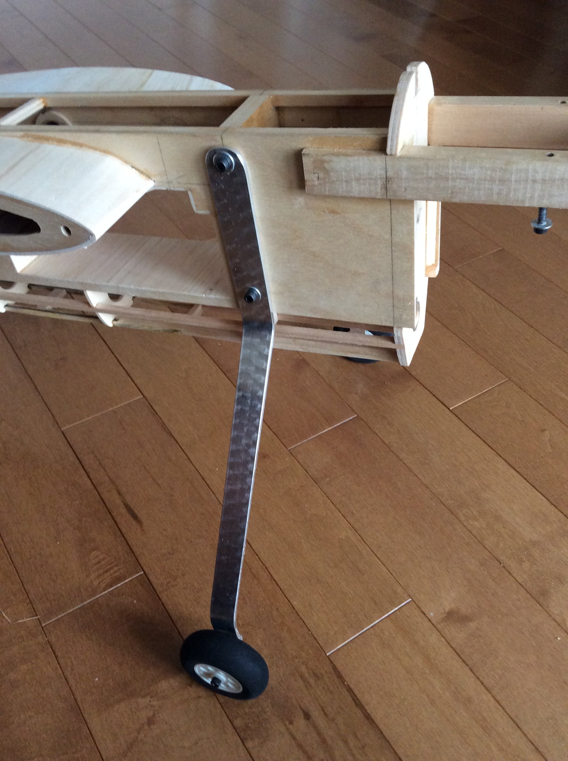

One more thing done. The gear is bent, circular polished and installed. Now I have build the top back bone and the removable hatch. The back bone is going to be fun has to fit from the rudder to the spinner in one piece with all the bends to try and make it look like a plane again.

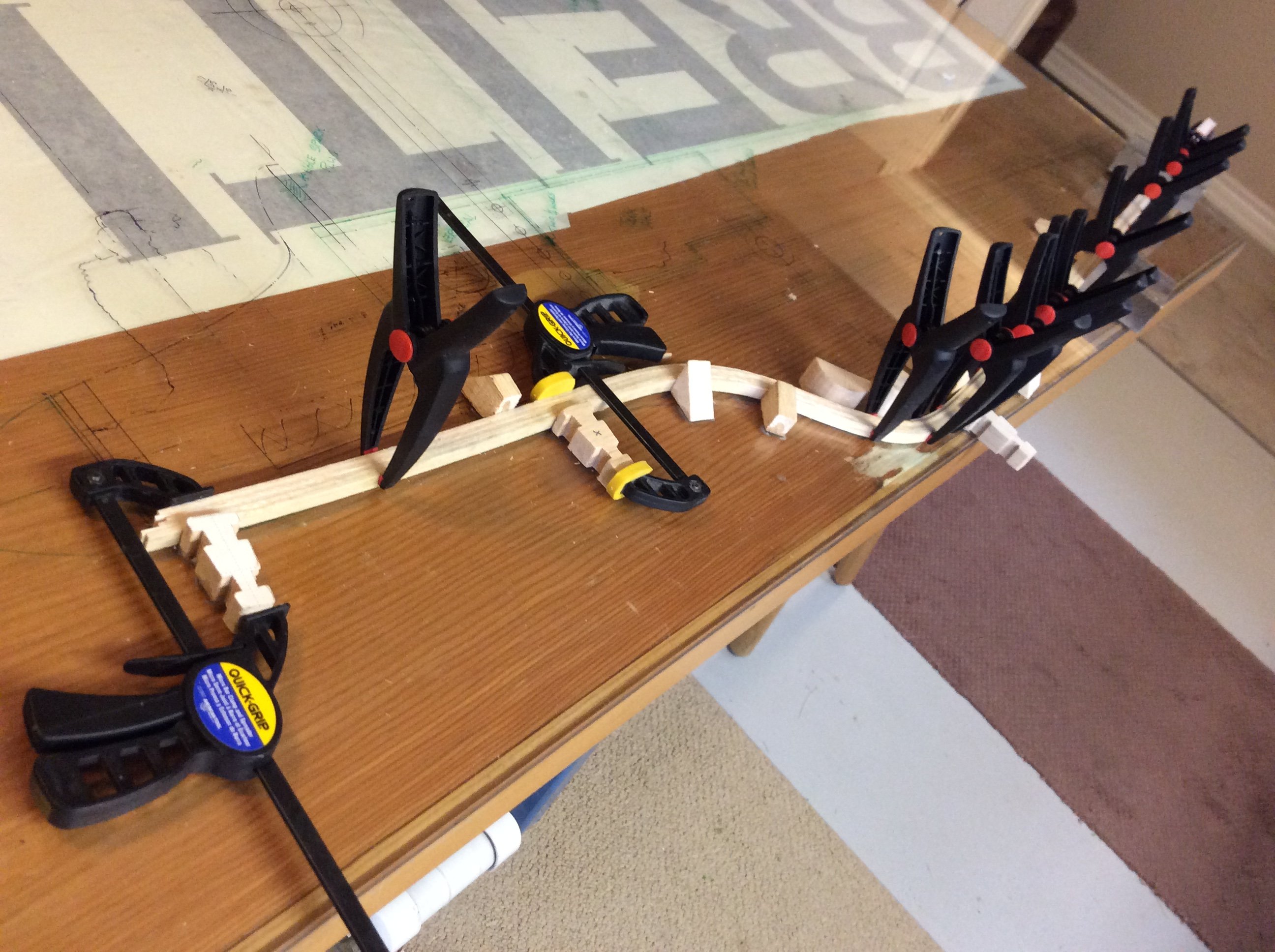

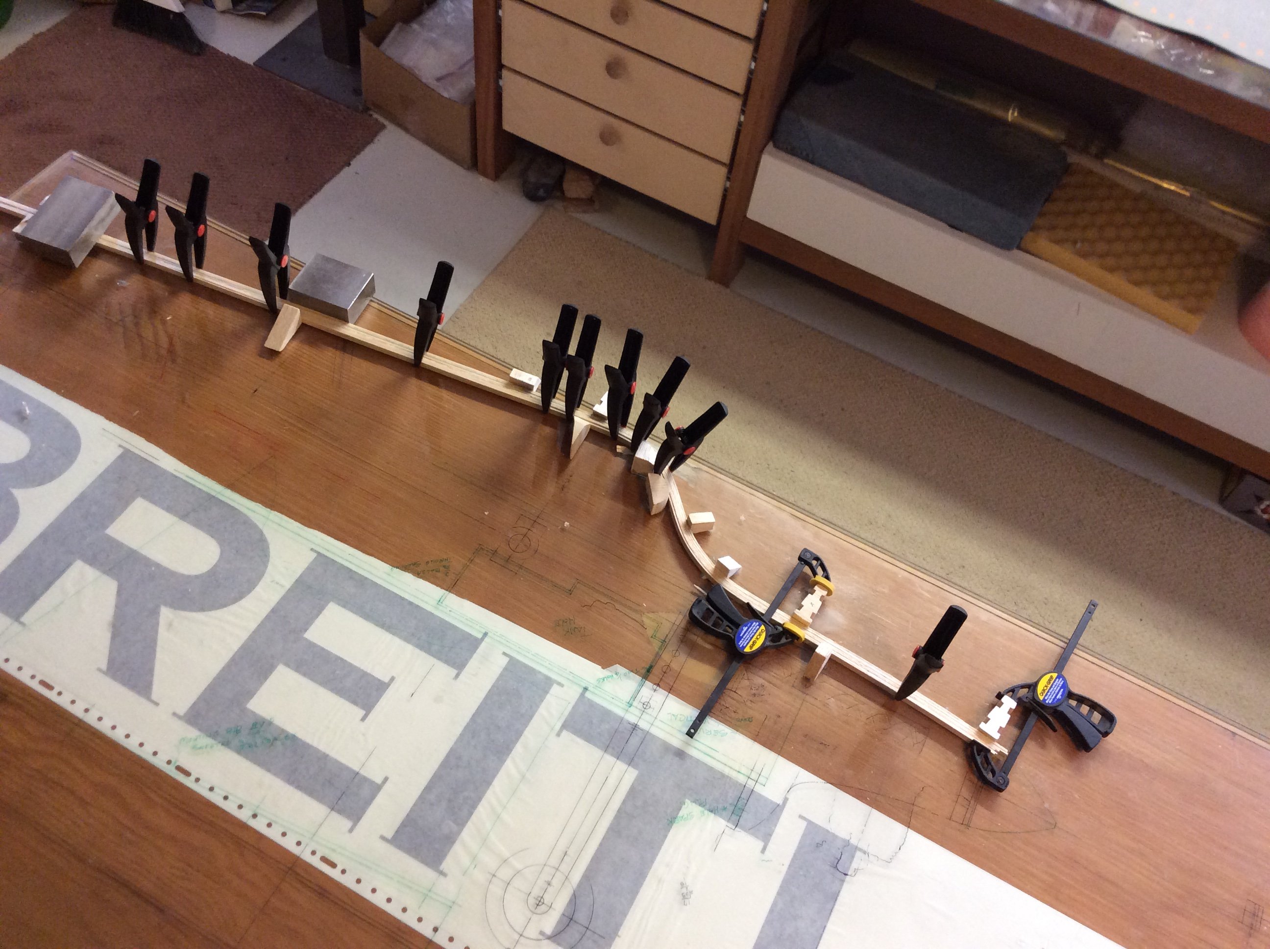

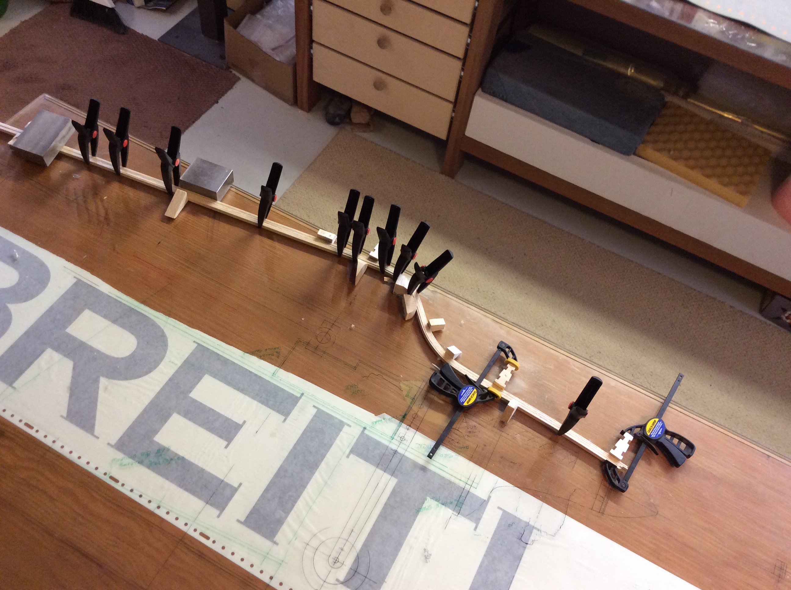

Got the back bone shaped. It some work getting it to bend and shape in the right places. But as we all know water steam and ammonia will let you do quite some bending with balsa. Now just let is sit there for a day and dry. Remove it all and then glue it all back together.
