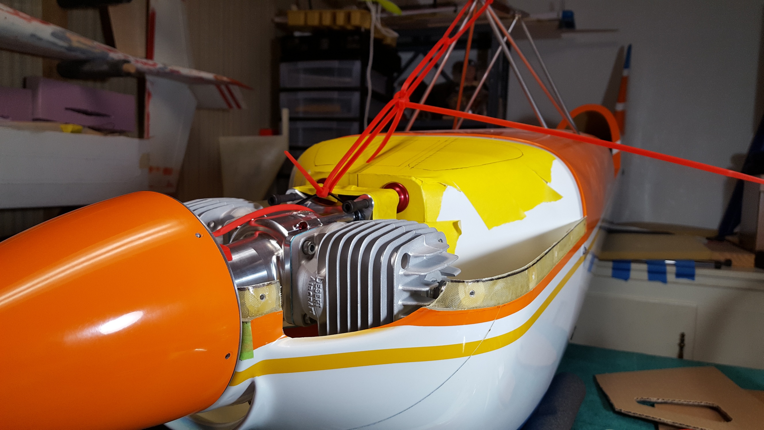

It's amazing the lengths a barbarian like me will go to to get something done. I hung the engine with wire ties to get the placement just right for the cowl. I drew around the standoffs then used that to drill my holes. It fits great!
I could have stood it on it's tail, set the engine on the firewall and stood on a ladder to make my marks, but I'm lazy.
