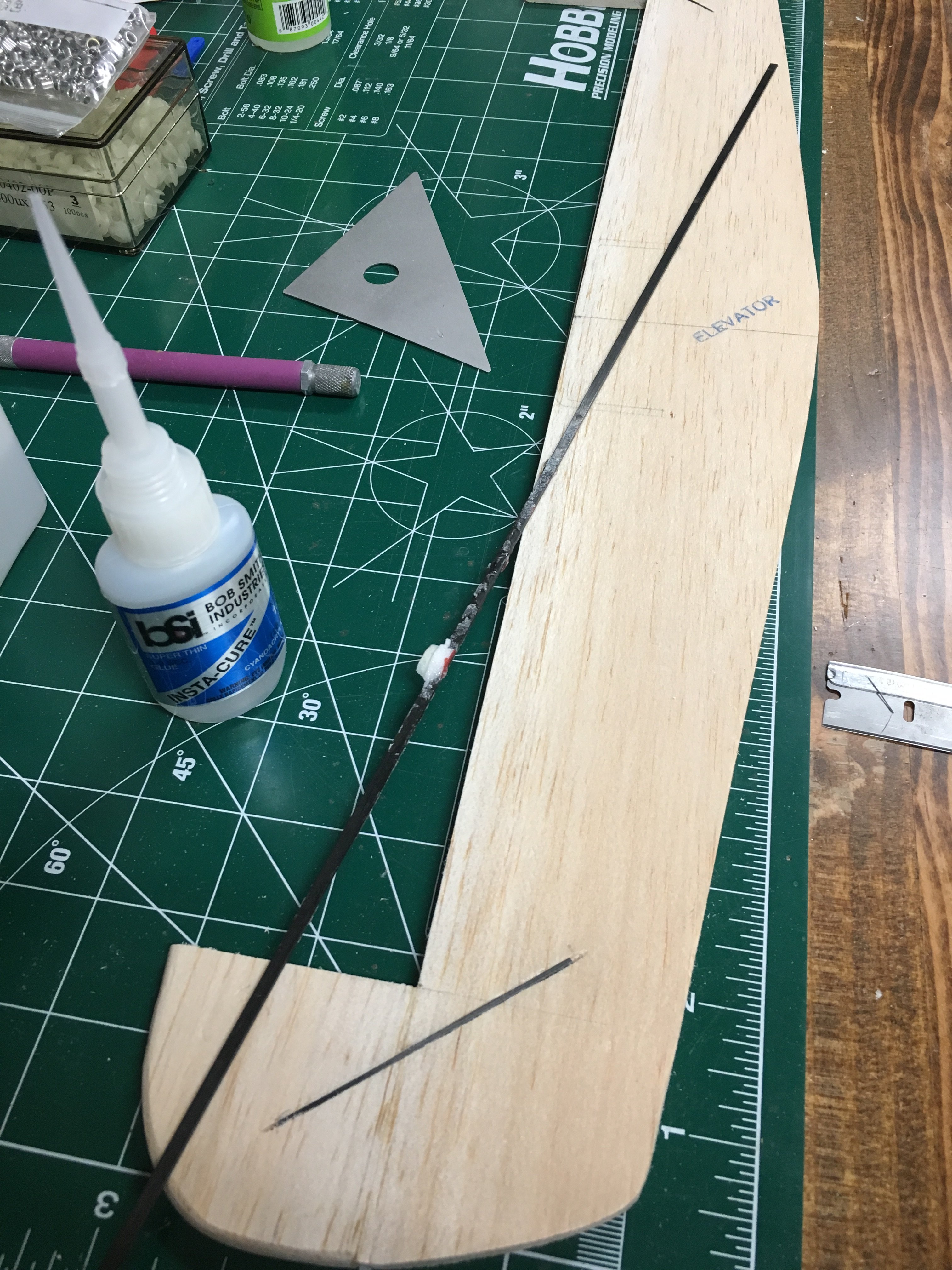

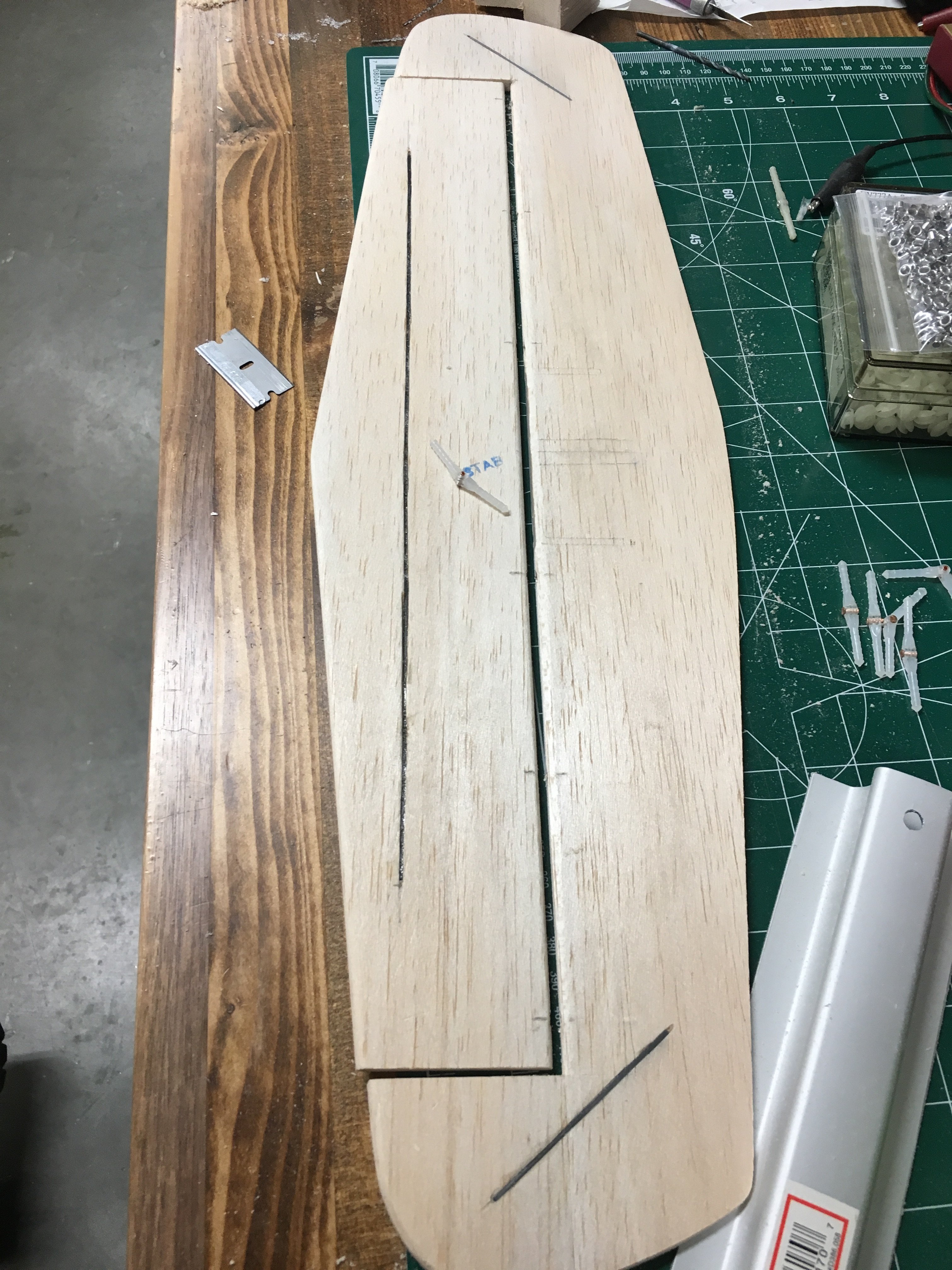

Played with the Super Otter horizontal stab and elevator. Put the tips on and repurposed a crack yak spar as a horizontal stiffener and elevator counter balance supports. Opted to go with Robert style (GP) pinned hinges. So now all of that is done, I need to finish shaping it. Might drill some lightening holes in it too later... we’ll see.

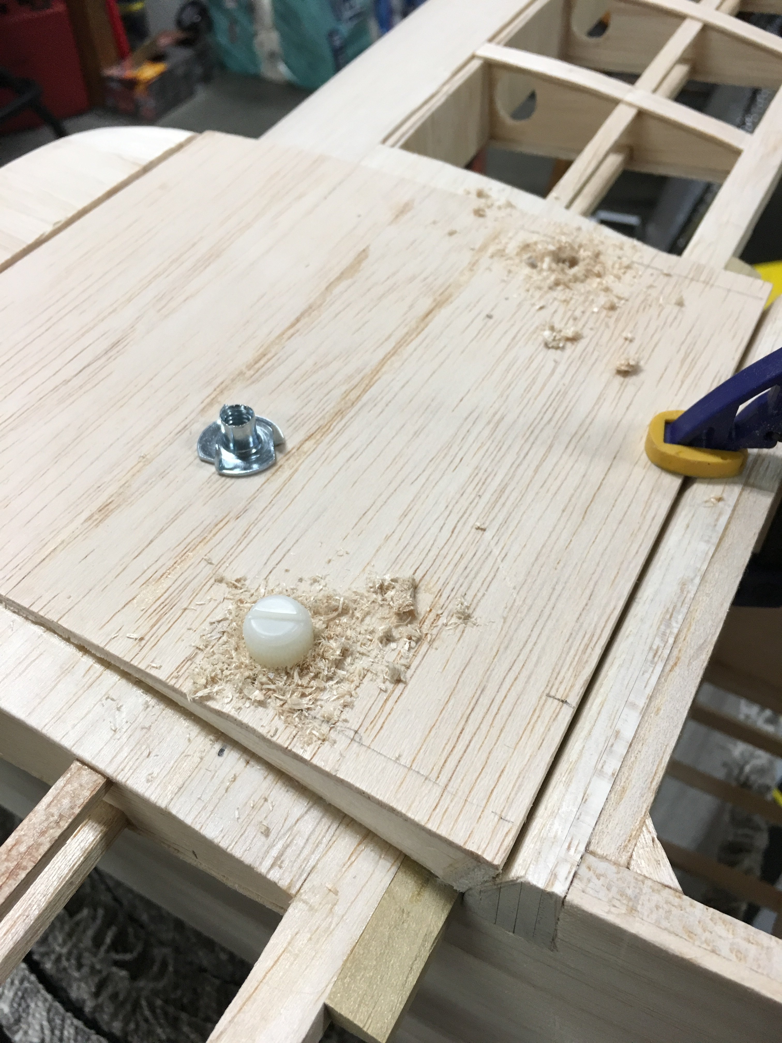

Finally got the guts to drill the wing hold down bolts on the super otter.

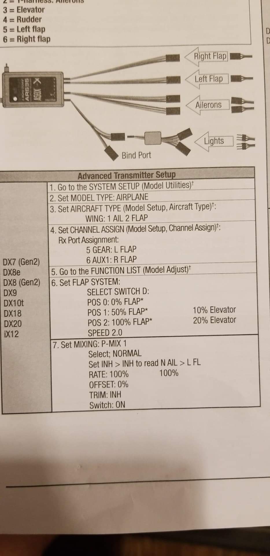

Maybe somebody spektrum savy can help me out. Setting up my new timber x to have full span ailerons. It’s setup per the manual page below with flaps plugged into channels 5-6 and ailerons on a y harness on channel 2. You can see in the video that it shows the flaps both moving with the ailerons but on the plane only the right flap moves and that’s both with the ailerons or flipping the switch to deploy the flaps. Switched the two servos between the channels and the left flap would move and not the right. Thought maybe it was the servo extension so I swapped it out for a new one and still nothing. Does anybody have any other ideas or is it possible I have a dead channel on the receiver.

My guess is it’s something to do with the programming in the radio. Something isn’t mixed or enabled correctly in the servo setup menu.

If I remember correctly, last time I had problems like that it was in the servo reverse setup. Both channels I was mixing had to be setup the same way. So make sure channel 5 and 6 are setup alike.

Make sure that you have the correct switch’s inhibited. Make sure aux1 and Gear inhibited. Normally I inhibit all of them and only activate the ones being used.
I will look into both those things when I get home tonight. Really would like to maiden it on Tuesday in the full span configuration.

Did you set your wing and tail configuration to one servo per control surface? The most basic set up. If you set the main wing as having flaps and 2 ailerons the programming will lock specific channels to support that. Remember AS3X is like any other gyro and needs to see the basic 3 channels of flight control. But I really think your on the right track with a connector or wire some where being faulty. Flaps should only use one channel and maybe the problem is in the Y harness. But I see that it calls for two channels for flaps. Hmn…..
I just looked over my Timber and yours is set up differently. I have one channel (6) for flaps and one channel (2) for ailerons.
Ignore what I have said :oops::D
