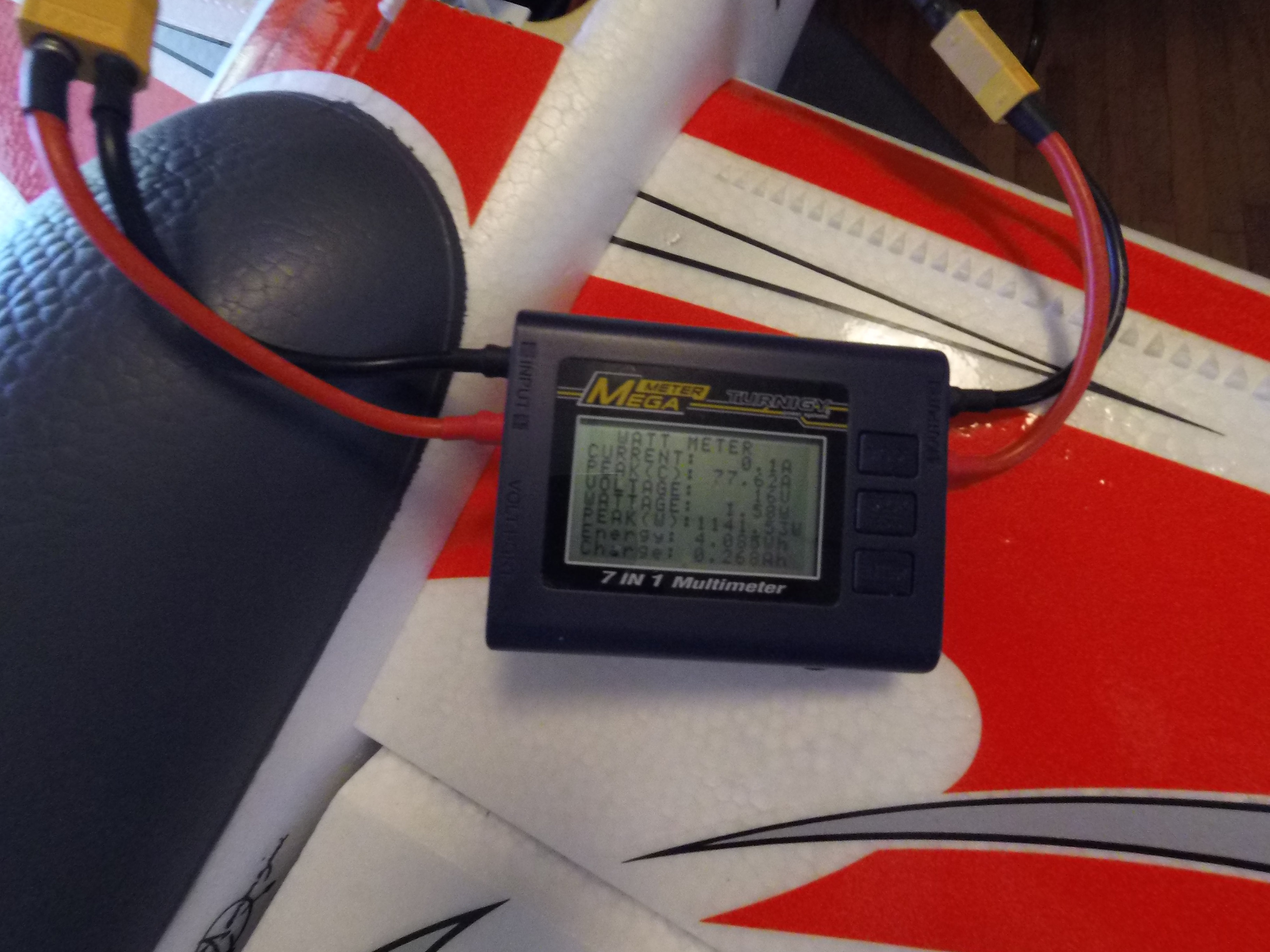

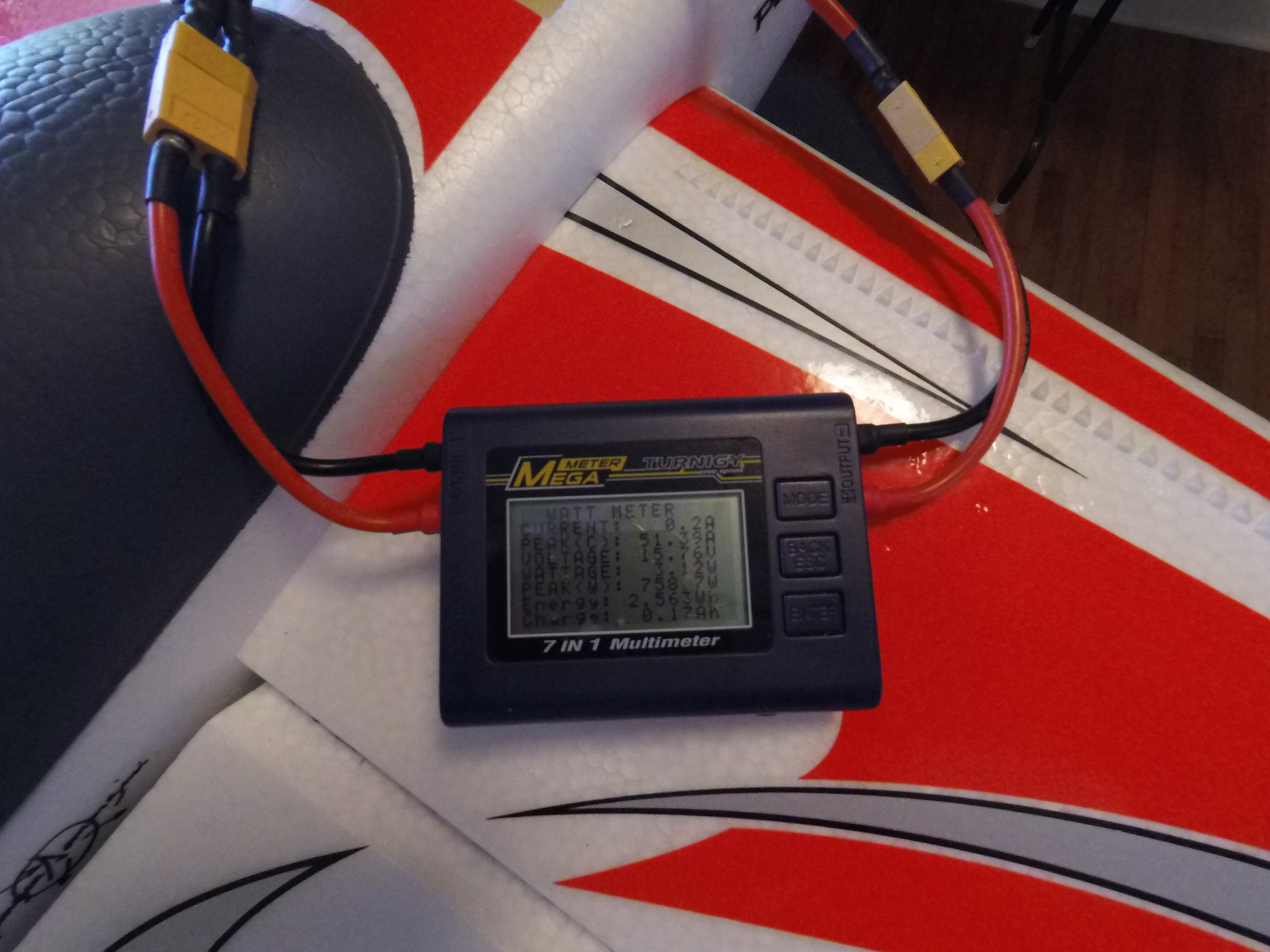

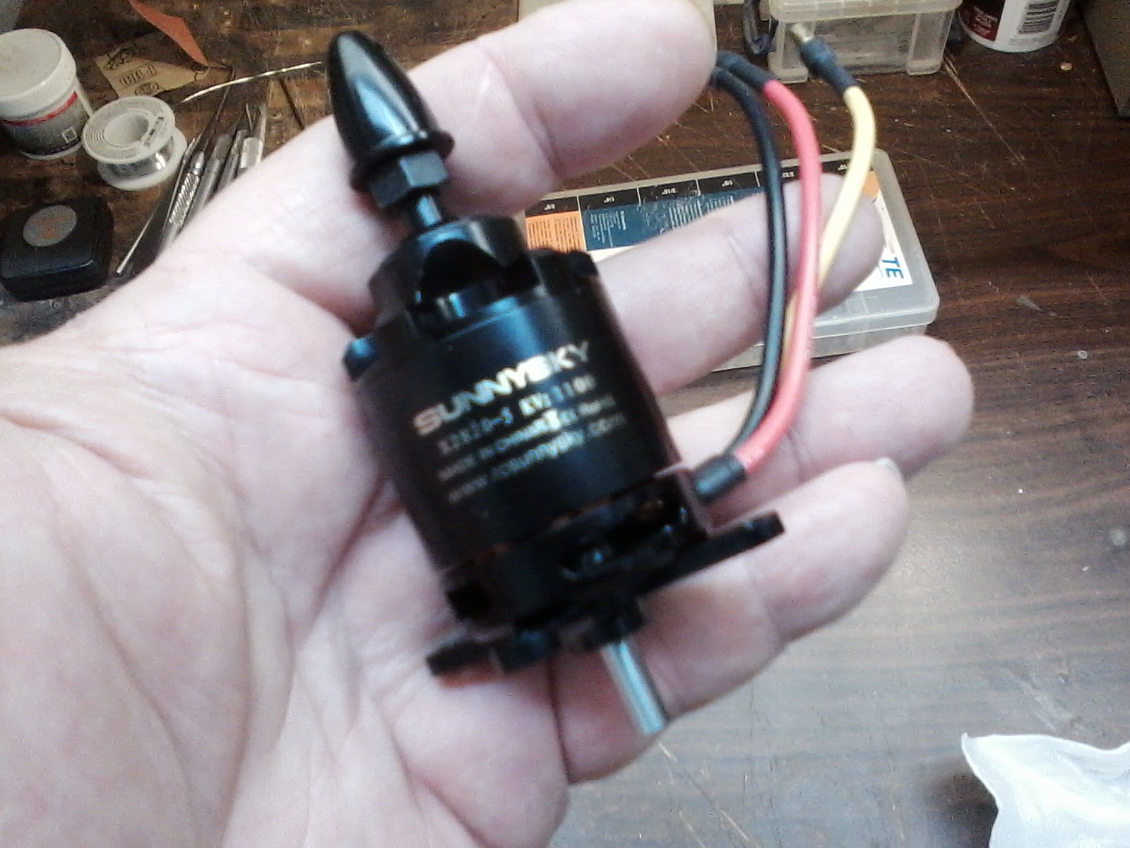

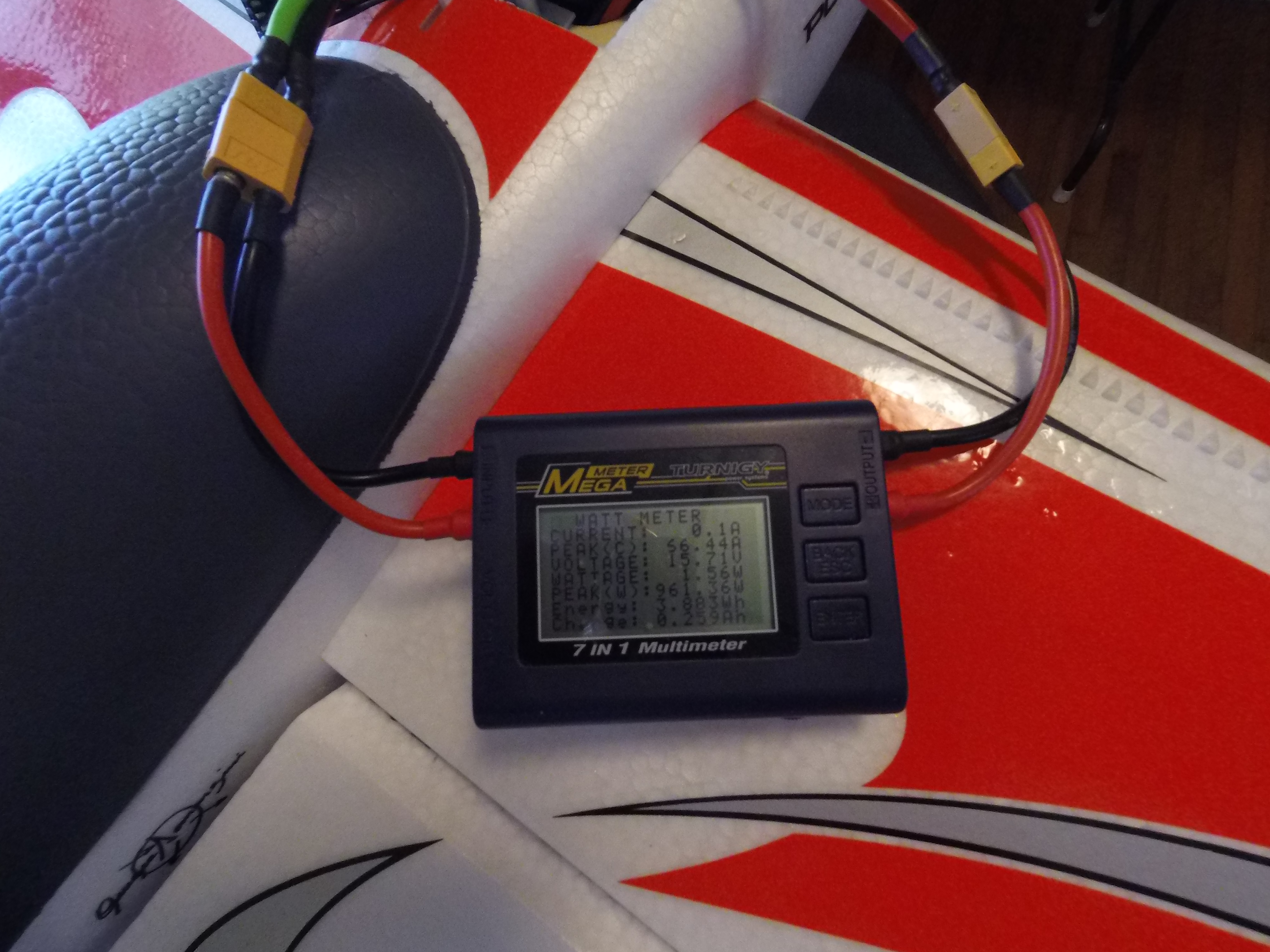

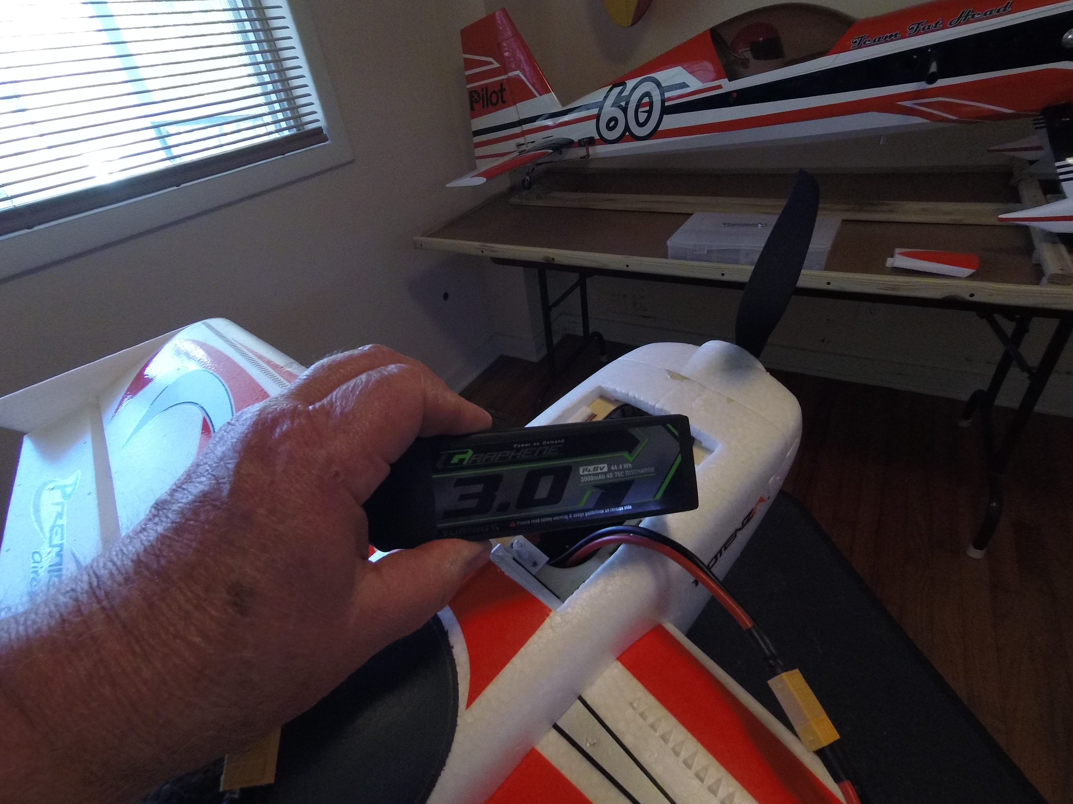

That is going to be a big difference, that is going to put a smile on your face for a while.@Snoopy1 Did some in shop testing of the Turnigy Graphene Panther 4S 75C 3000mah packs with the new SunnySky 2820 1100kv motor swinging a 12x6 ARES electric prop. All I can say is WOW. Glad I did a good balance job on the prop!
I would say almost 3X's the power of the stock Potenza 10 1350kv swinging a 11.5x4.5 electric prop. I think I could have gotten away keeping the packs 3S instead of 4S but like I said WOW! Ludacris power....Hovers 4pound 3ounce plane ( holding plane on wing tip) just under 1/3 throttle pulling 23amps for 389watts.
WOT burst produced 77 amps for 1141watts.
2/3 throttle produced 66 amps for 961watts ( about maximum for this motor).
1/2 throttle produced 51 amps for 758 watts.
This "Ain't ya momma's QQ300" going to be a real hoot I think.
View attachment 109473 View attachment 109474 View attachment 109475 View attachment 109476 View attachment 109477
