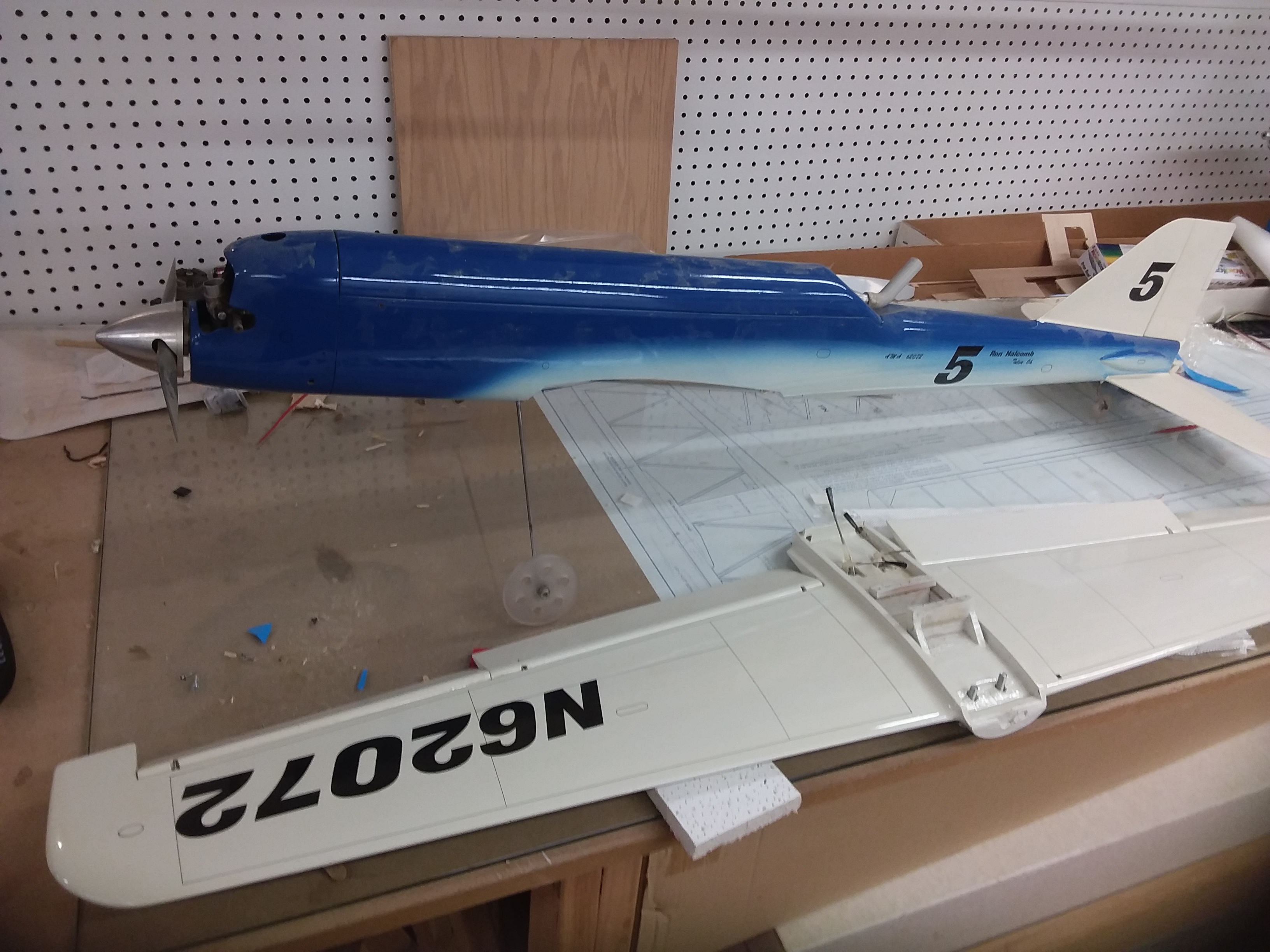

Thinking about getting this ready to fly
Discussion in 'Giant / Scale RC General Discussions' started by dhal22, Sep 4, 2021.
  1. dhal22
    dhal22 GSN Sponsor Tier 1
    Thinking about making this air worthy.

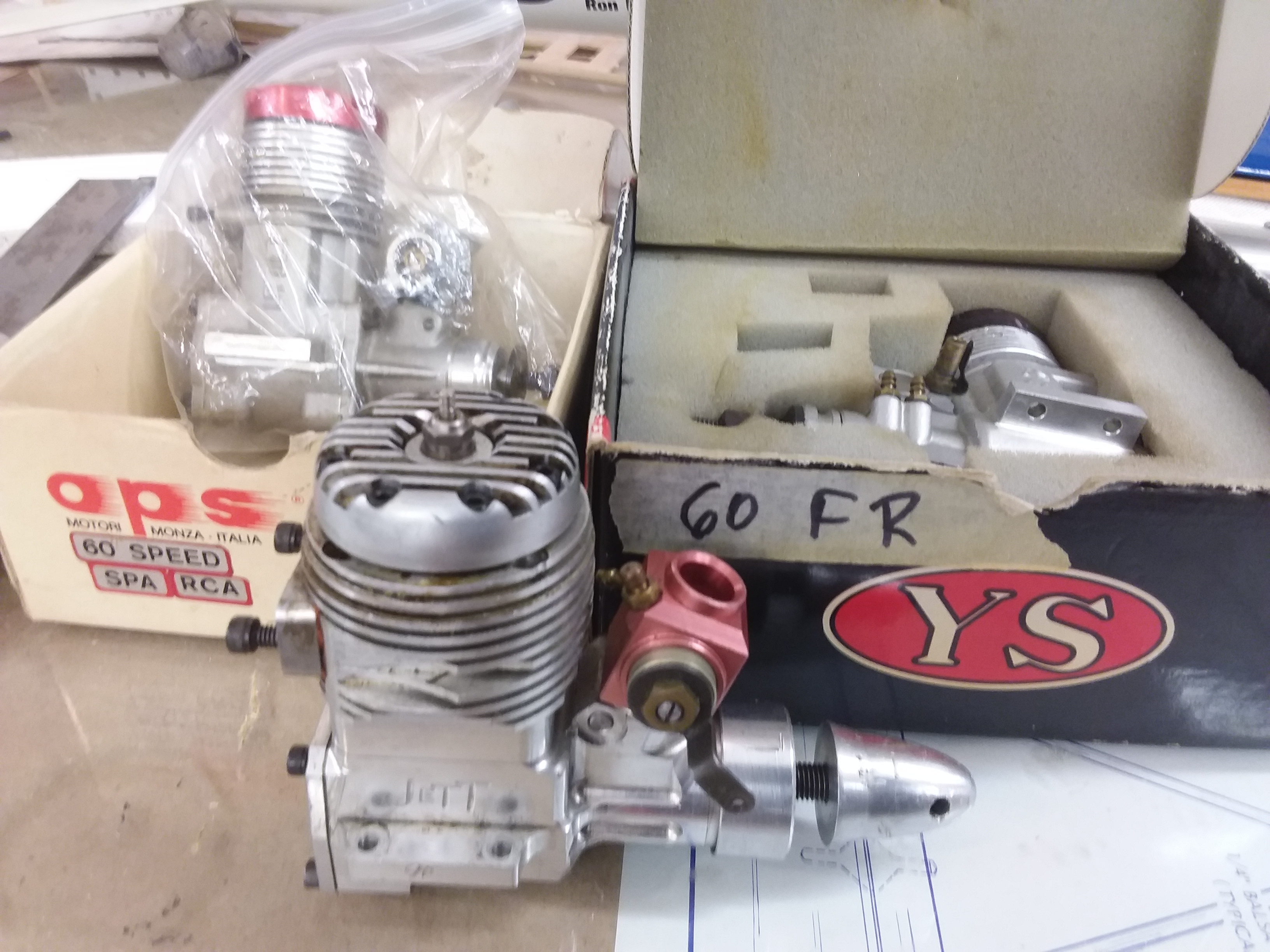

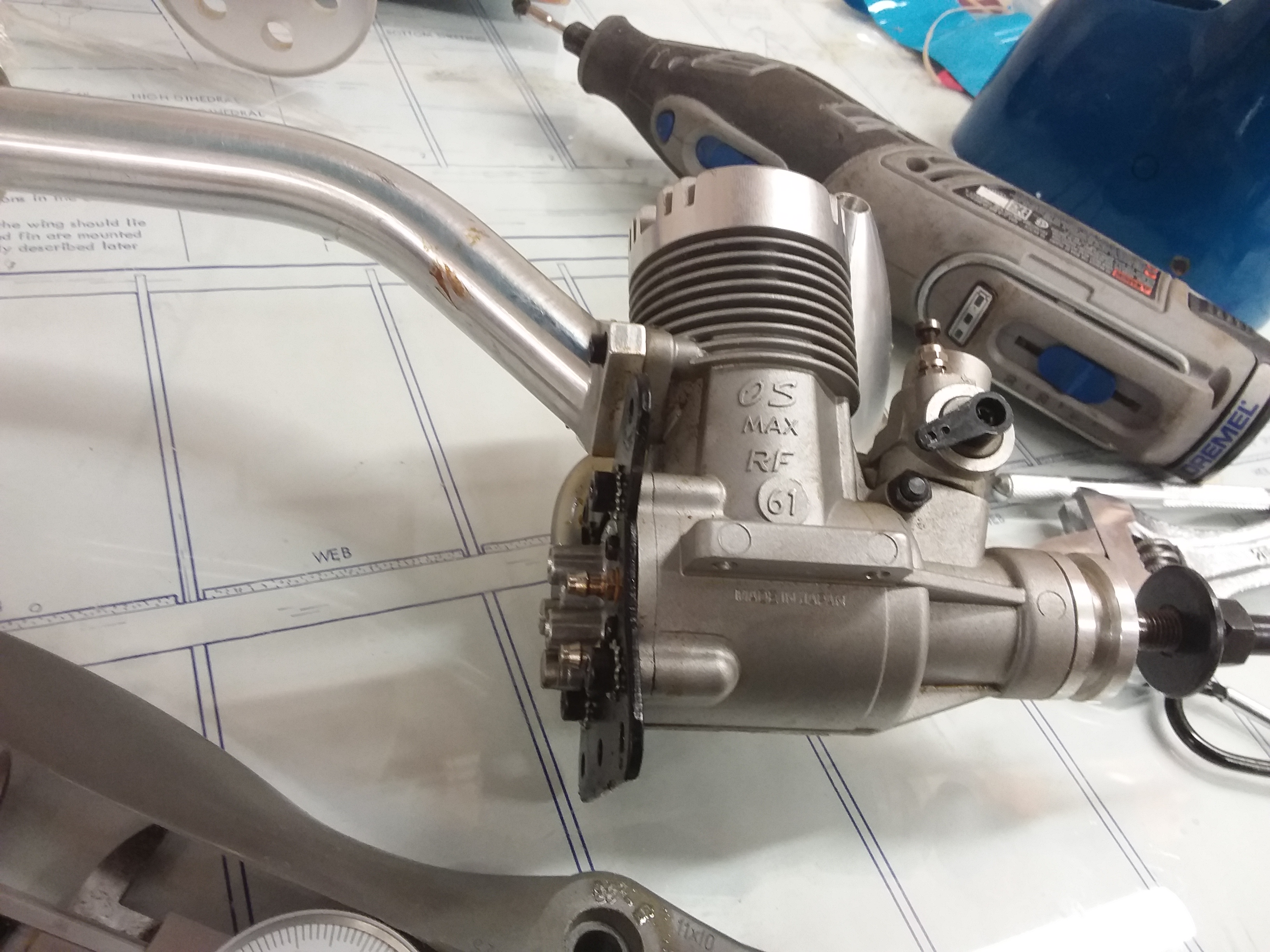

    I have always thought the pattern engine (OS 61 RF) on this plane wasn't the correct choice. Maybe a short stroke or the OS VF. Anyway the engine is frozen and pump may or may not be any good.
  5. dhal22
    But I have some options!
    OPS Speed 60
    YS 60
    Jett 90
    Now to compare mounting patterns, weight, headers, etc.

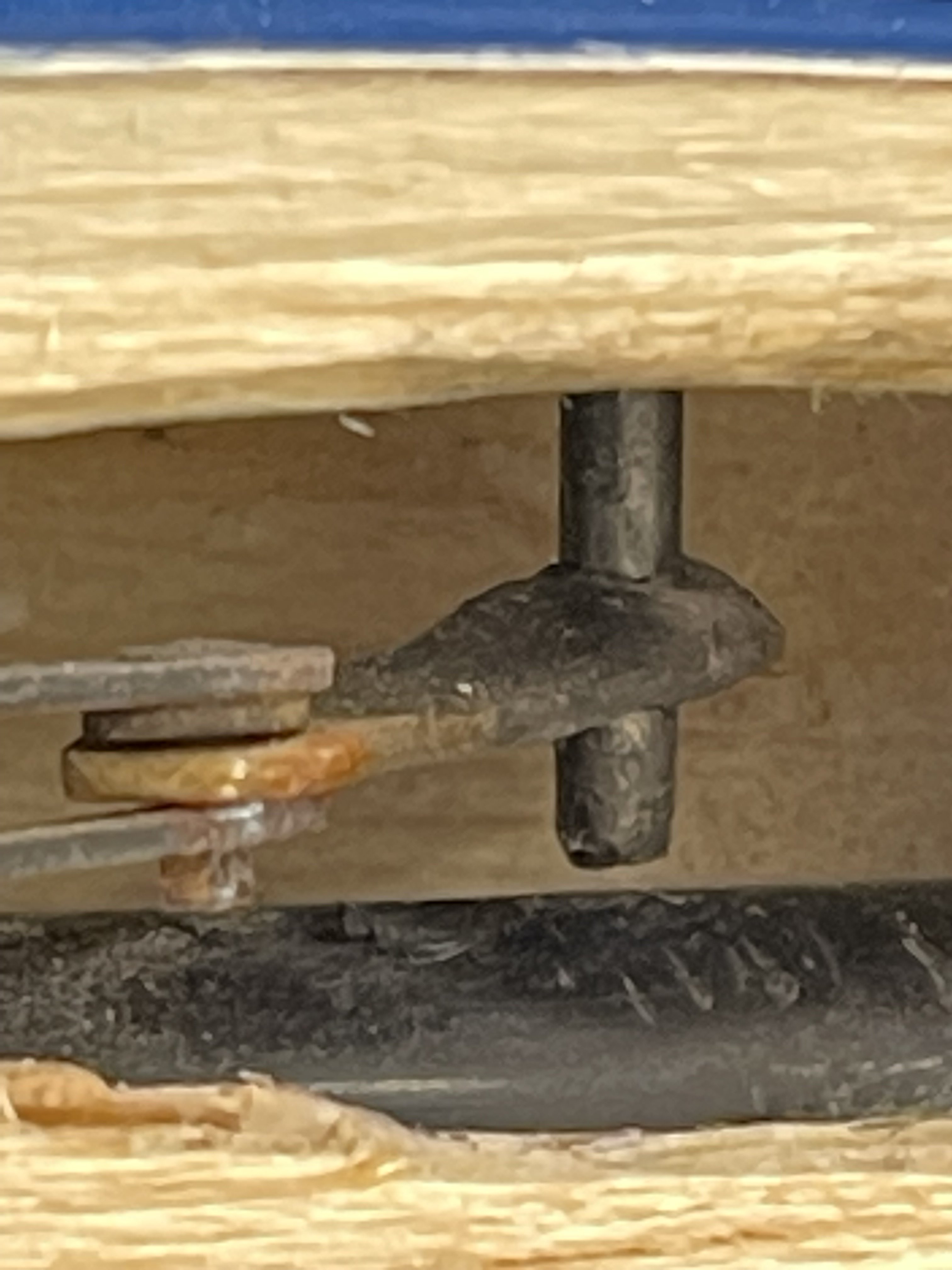

  6. dhal22

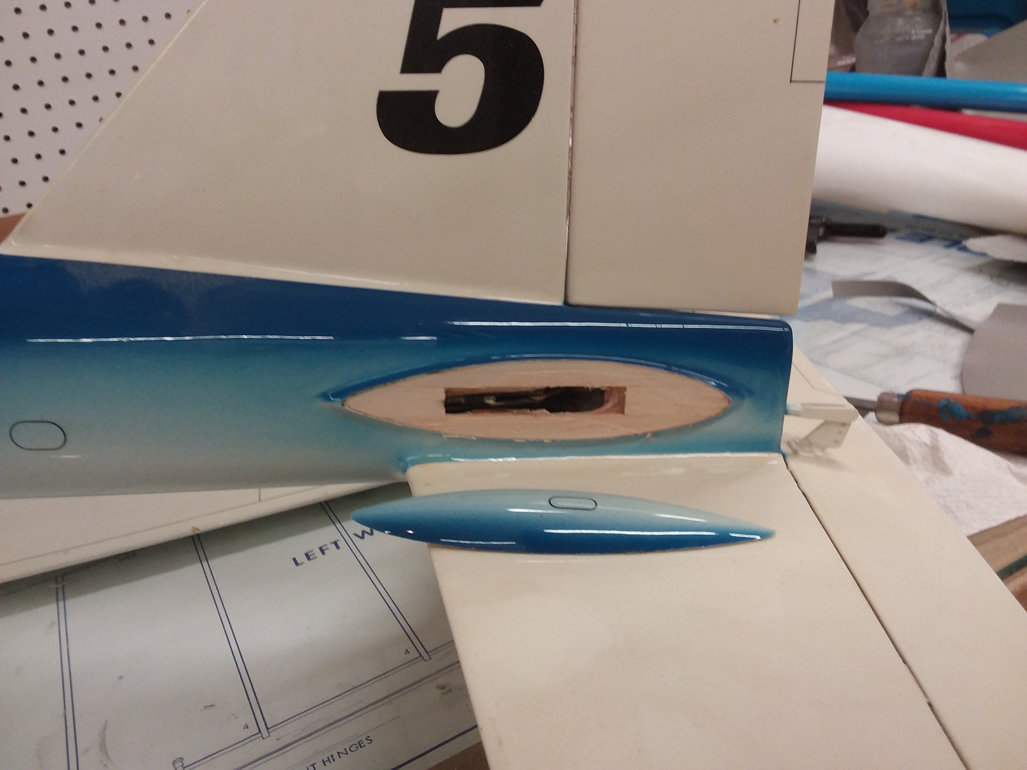

    The rudder control arm failed (probably soon after it was built) so i decided to finally expose the problem. Thin razor saw and away i went. Not bad actually, it should patch just fine.
    pawnshopmike likes this.

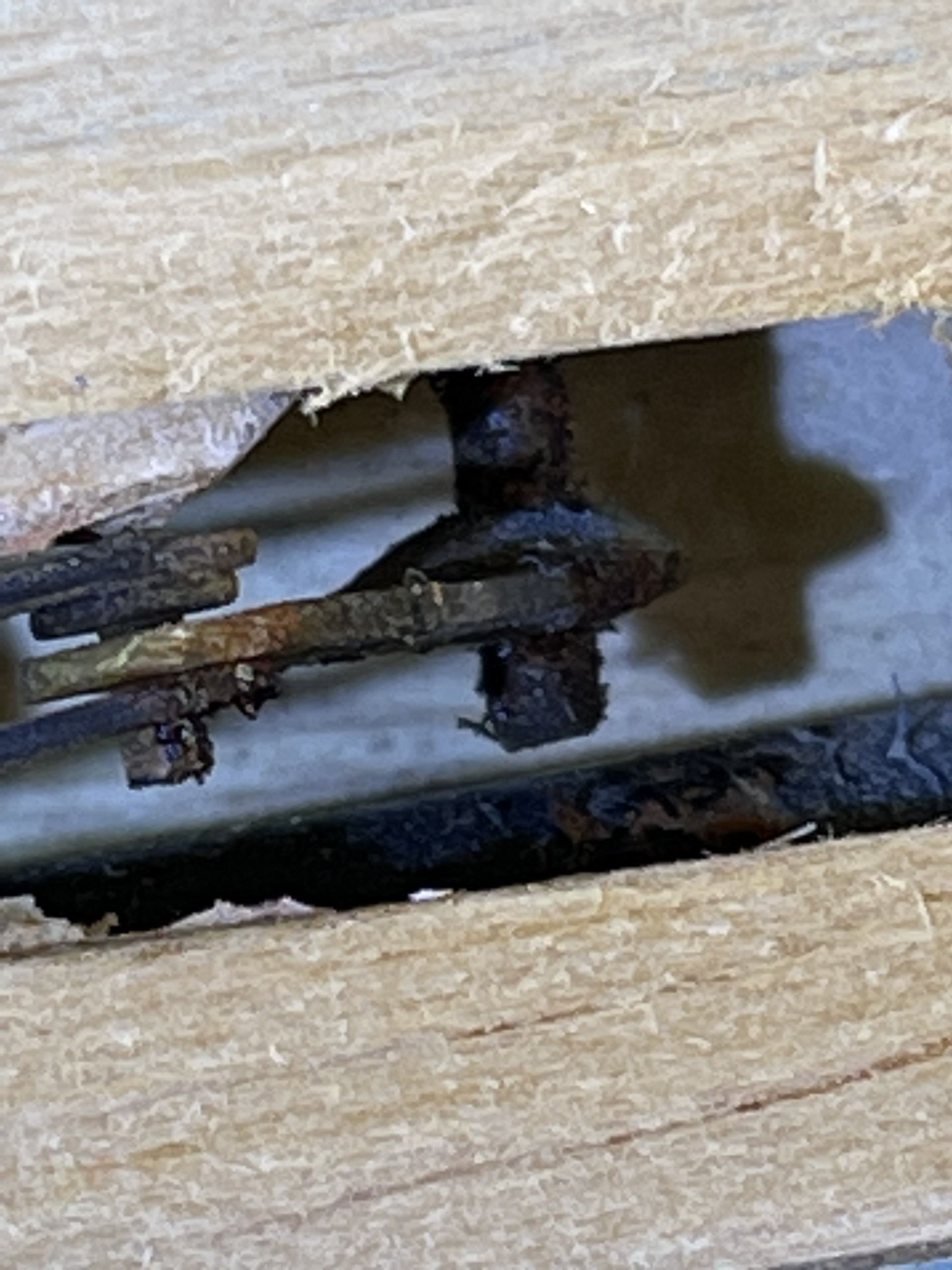

  7. dhal22

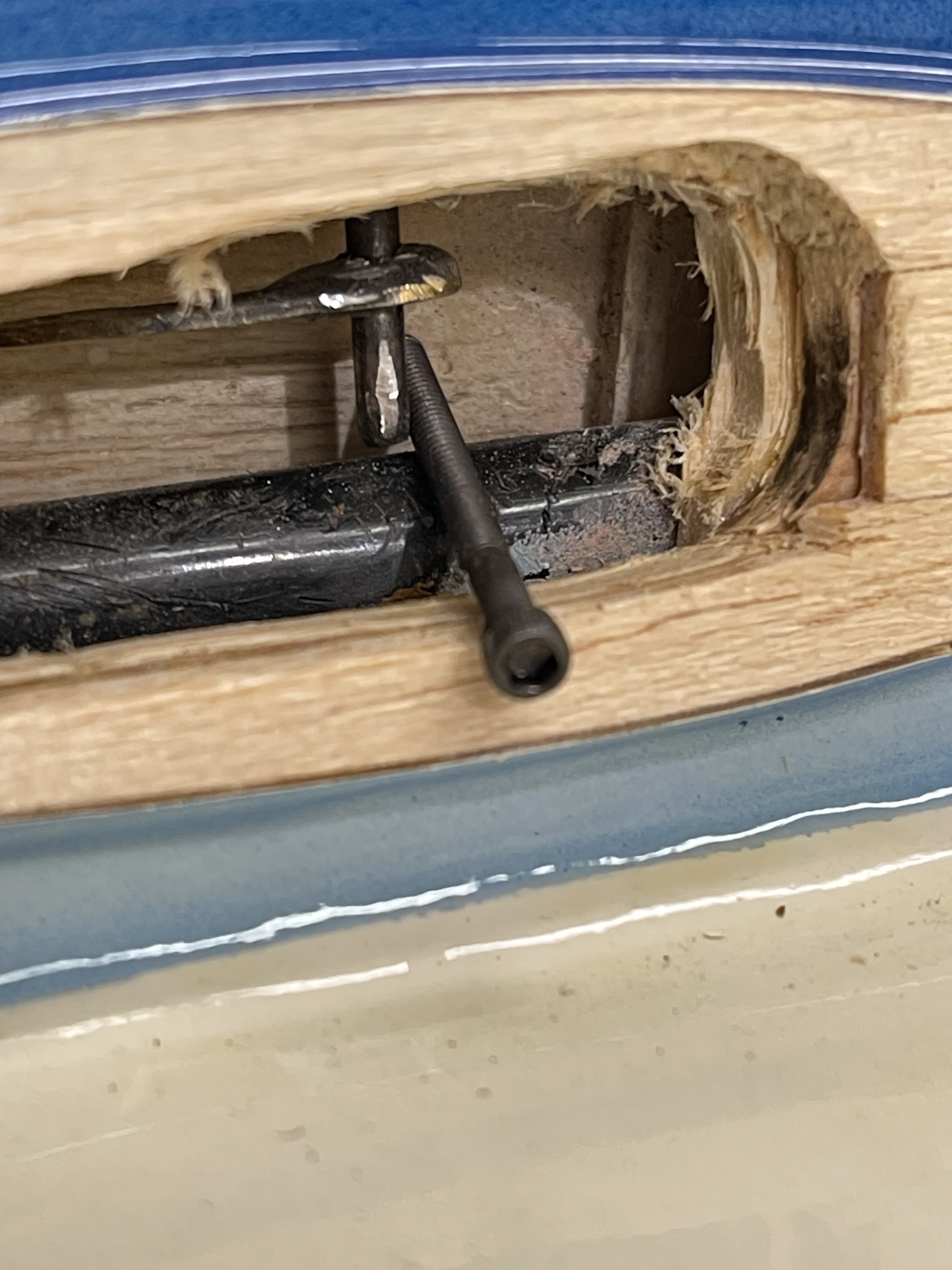

    Not good, brass to steel solder joint. I cleaned it up a bit while I think about how to repair.
    -Rick- likes this.
  8. dhal22
    Not much room to stick a torch inside and solder........
  9. dhal22
    Close up photo.
