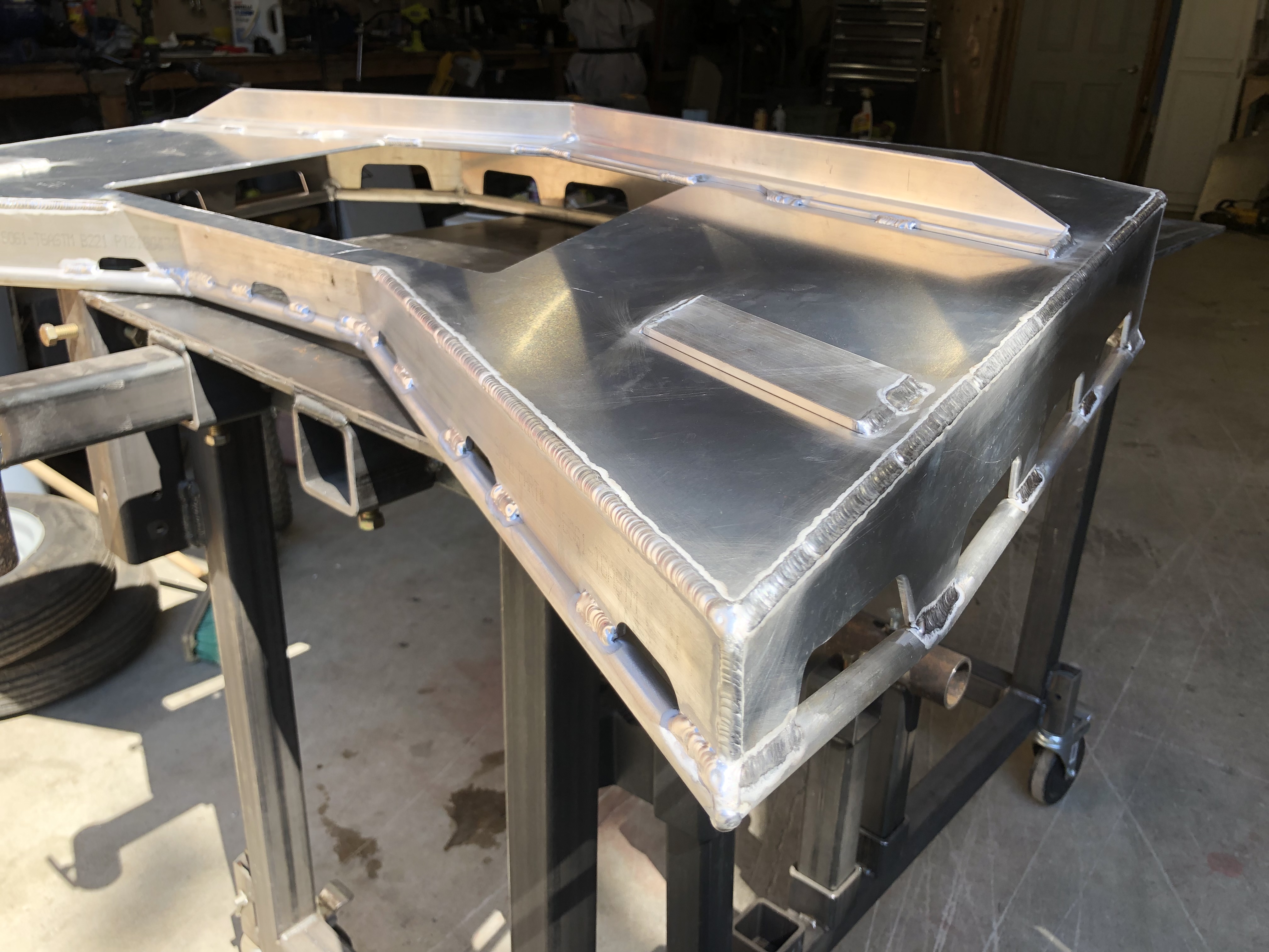

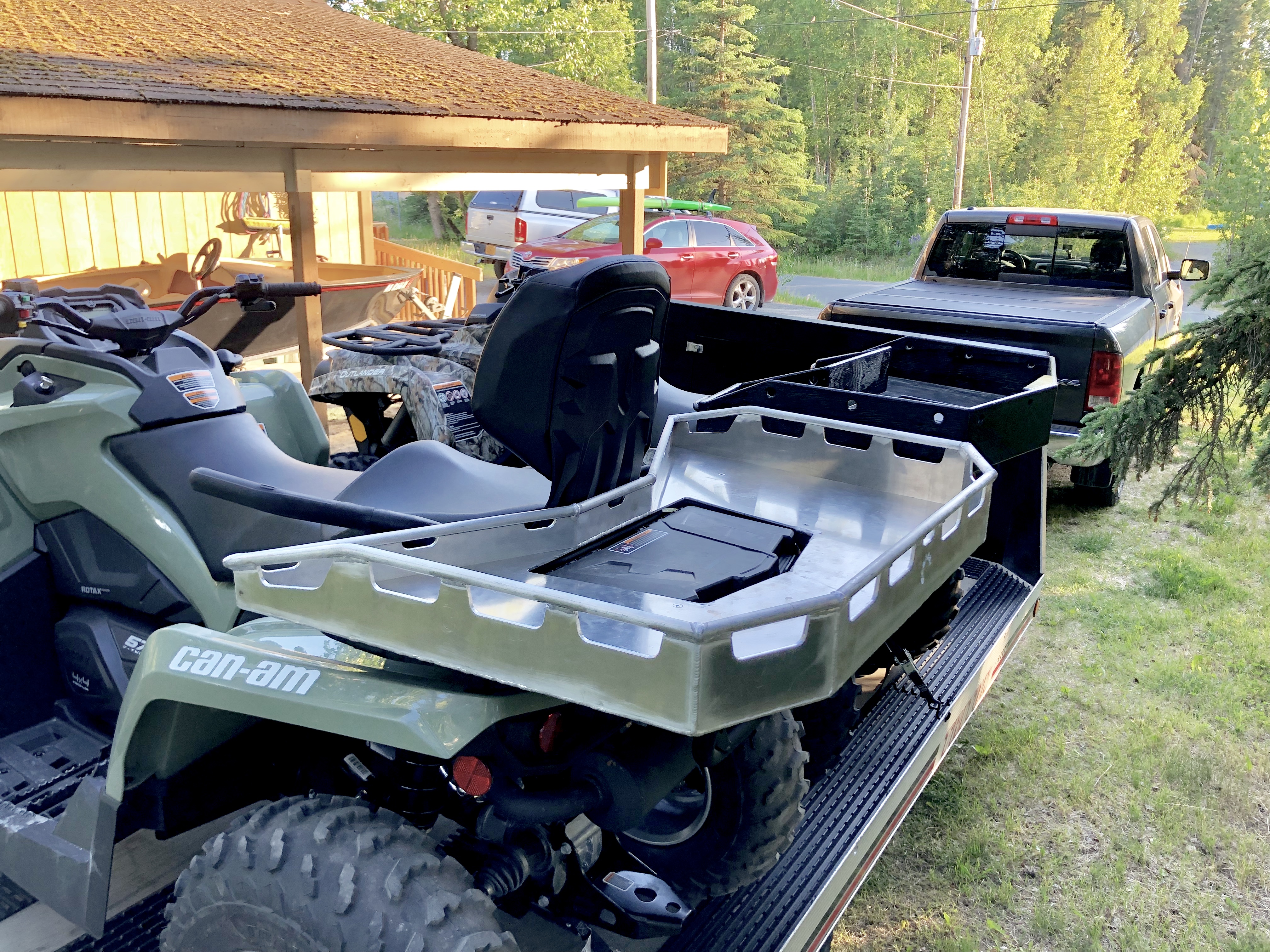

I built this ATV rack with my Miller Diversion 165amp air cooled torch machine. 3/16” plate. It took everything it had and the torch gets very hot fast. This size project and down with 165 or 185 amp machine. If you expect more go 200+amps with a liquid cooled torch.What is the smallest Tig machine we as hobbyist need for the hobby. Do not believe we will ever need to weld more than 1/4 aluminum.e
