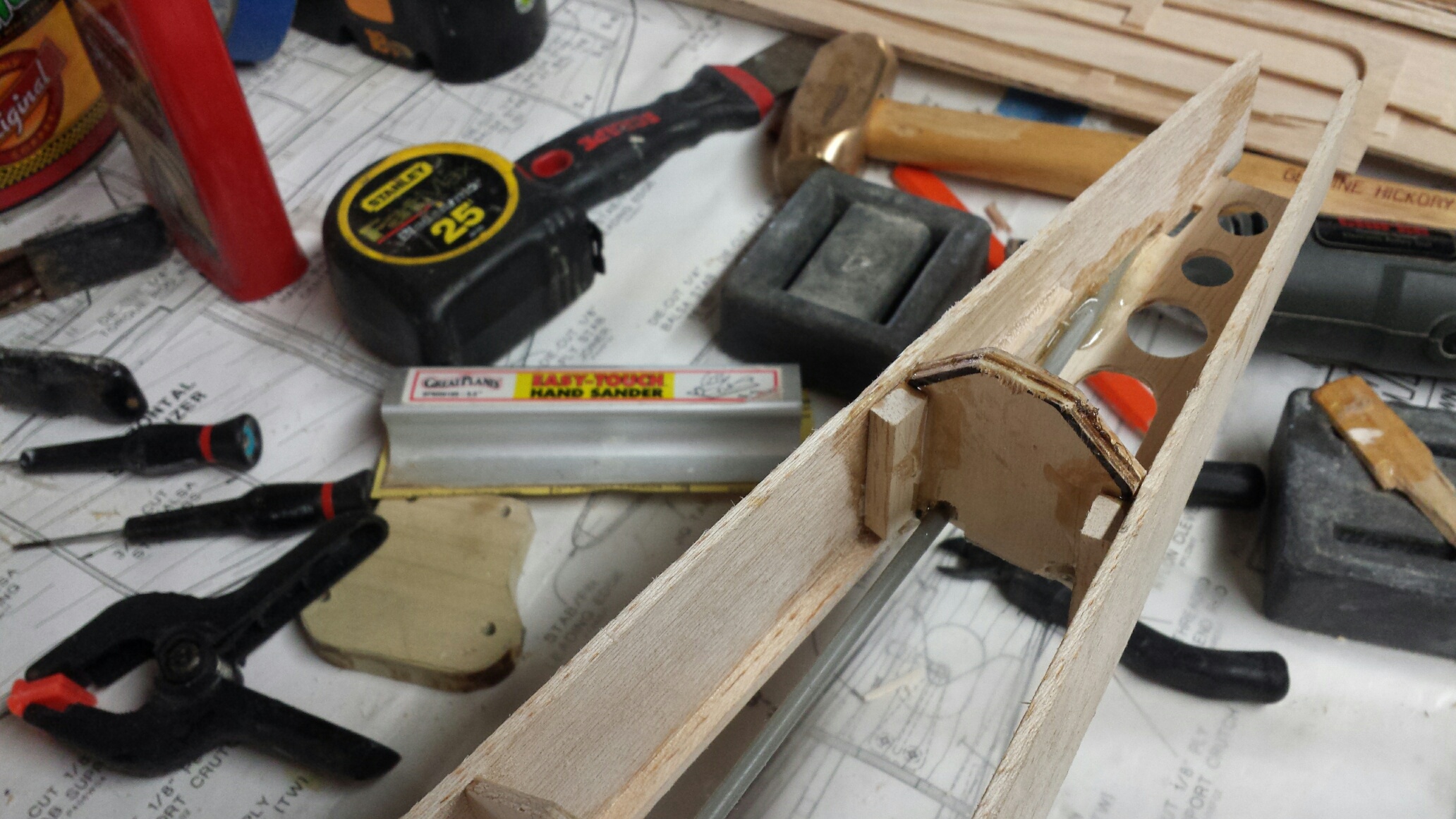

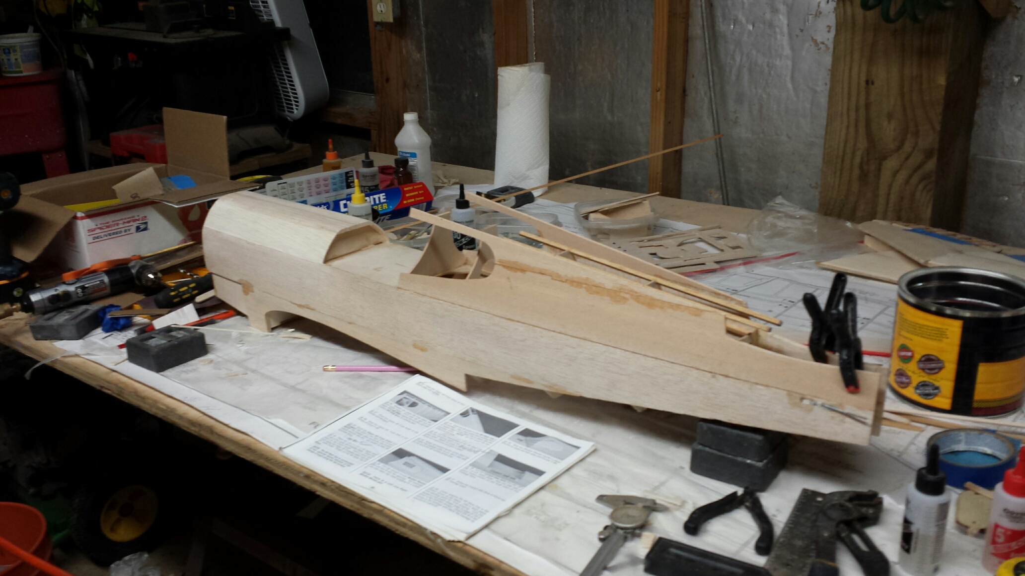

Glued the upper fuselage sides to the main fuselage with CA and waiting to set. I have to wet the sides to form them to the frame so I want the CA to set good. Make sure the rears are even.20141020_202828_resized.jpg

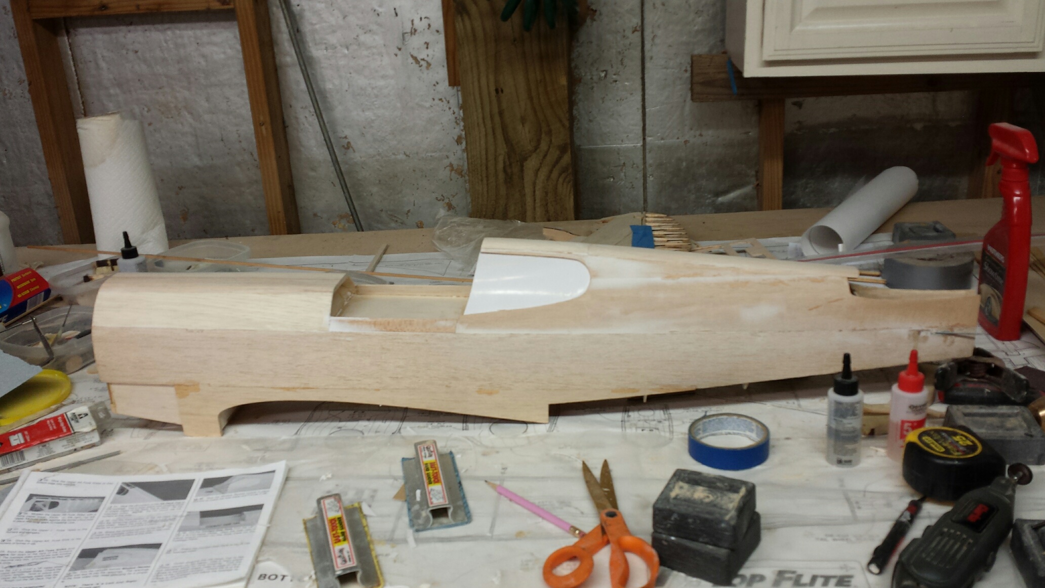

I glued the plastic inserts in with CA but am wondering if there is a better glue to use on the plastic parts? I still have the cowling and the canopy to glue.
rcdude07
Canopy glue should work, I think. If not wood glue. Epoxy always works. Maybe you could put some extra ply square on the backside as a tab and use 2 or 3 screws as backup.
Curious. Why you chose not to paint them first? Are you choosing them to be gray, olive drab, or blend with your cs?
