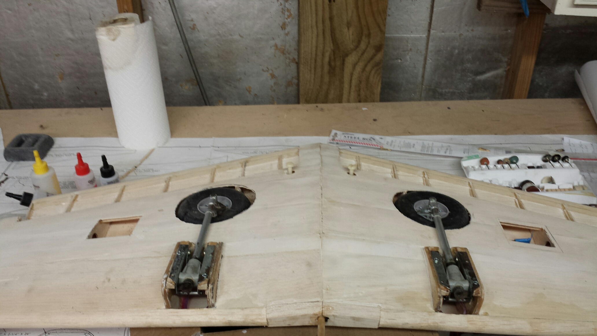

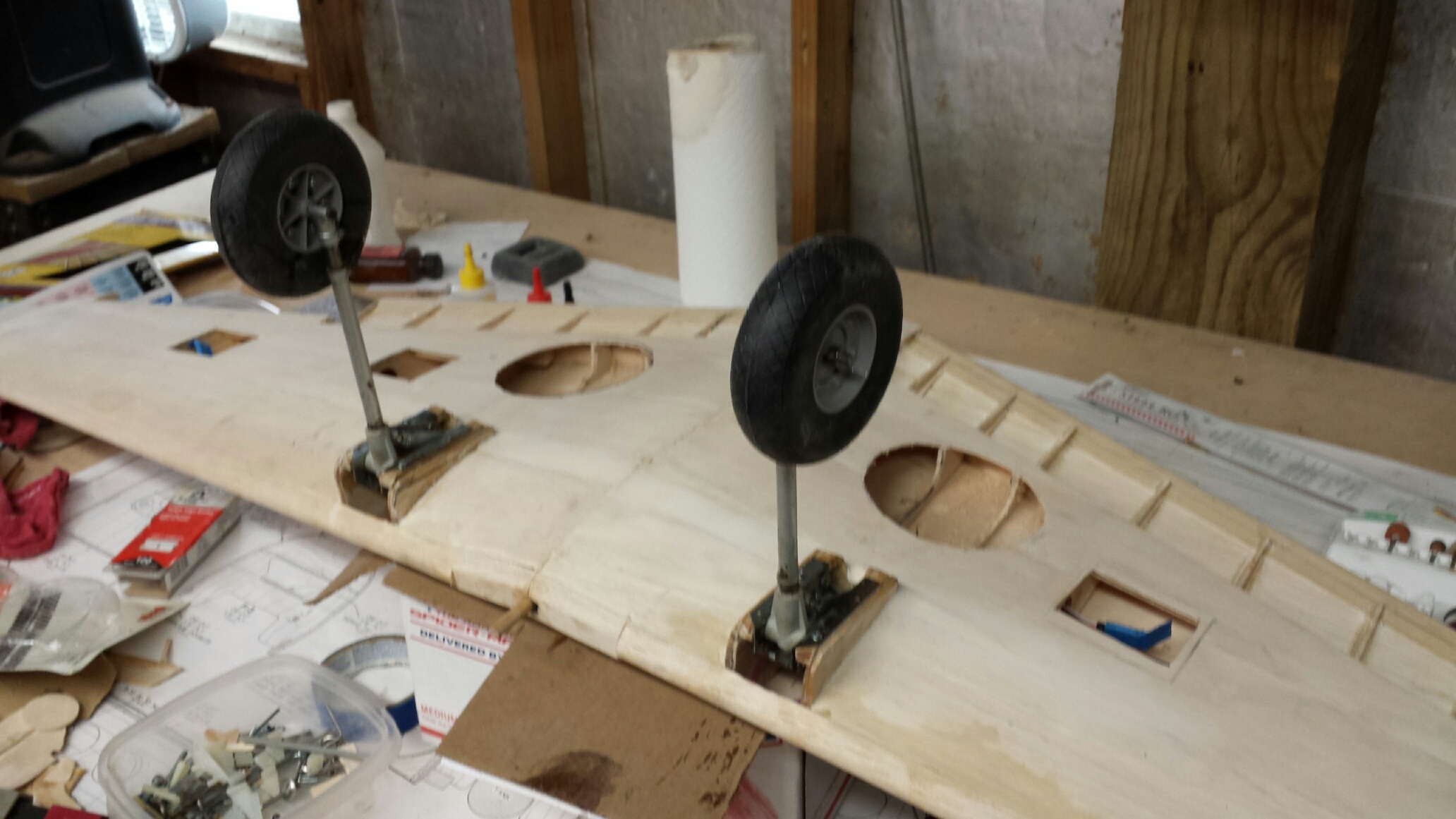

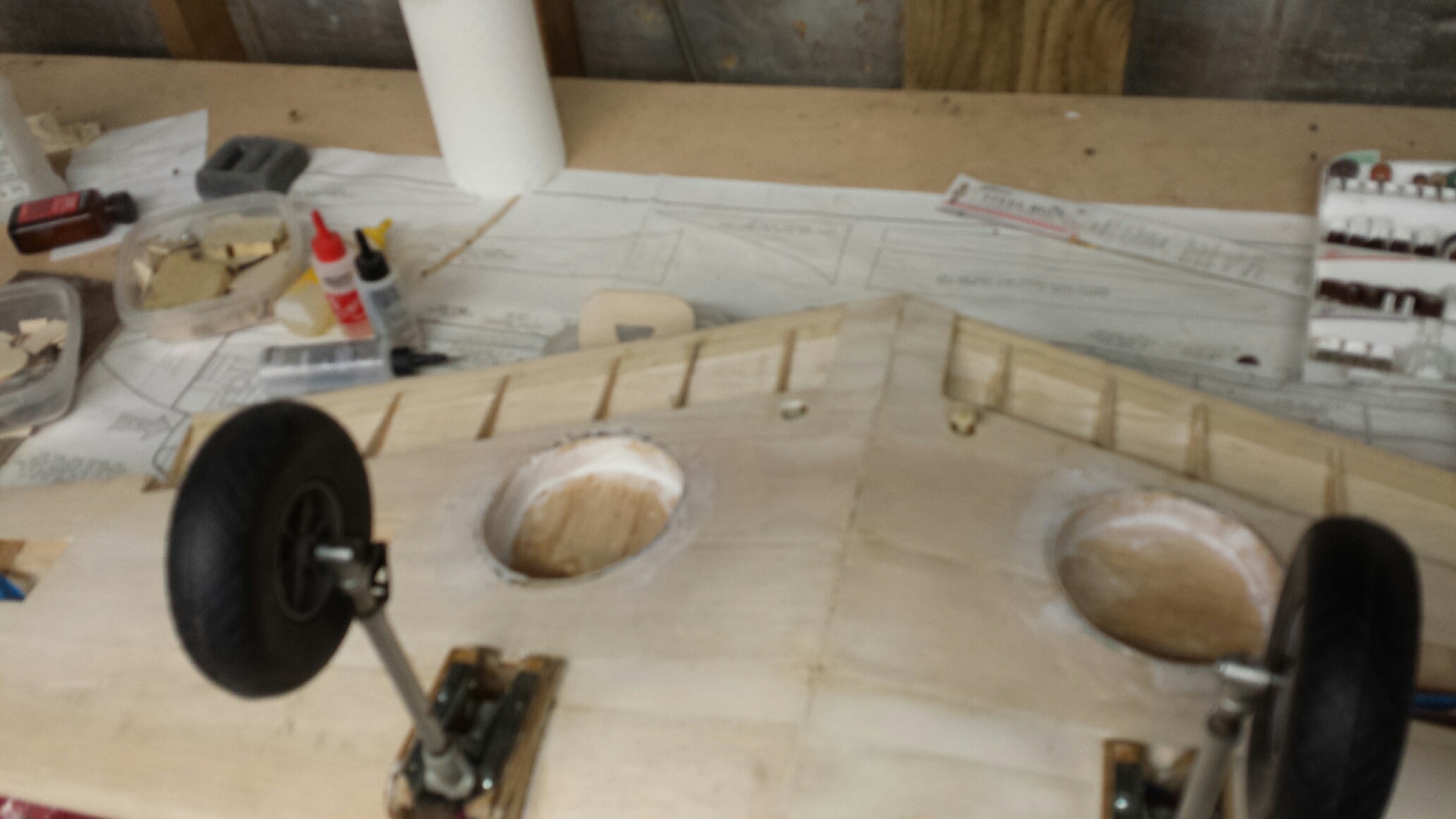

Charles

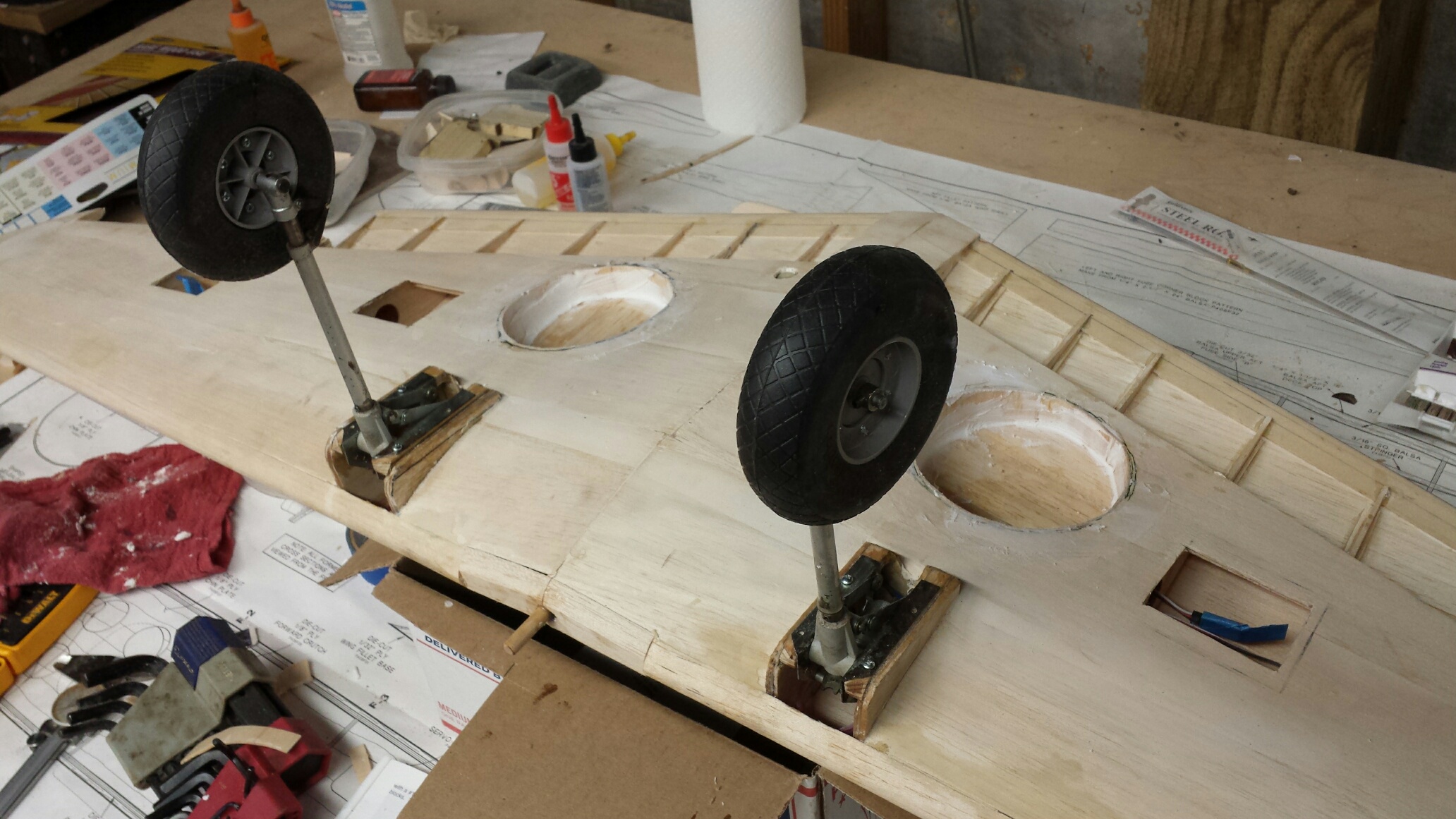

I did a little more work on the wheel wells fitting the wheels in. and also decided which setup to use for the tailwheel retract. I decided to go with an electric retract that is sold by Hobby King mainly because it is more compact and is better quality than the Robart air unit. I really havent been impressed by Robart and think their products are pure junk and not worth the price. I can also tie in a servo to operate the tailwheel and rudder together and one to operate the gear door.20141114_141747_resized.jpg20141114_141734_resized.jpg20141114_141728_resized.jpg

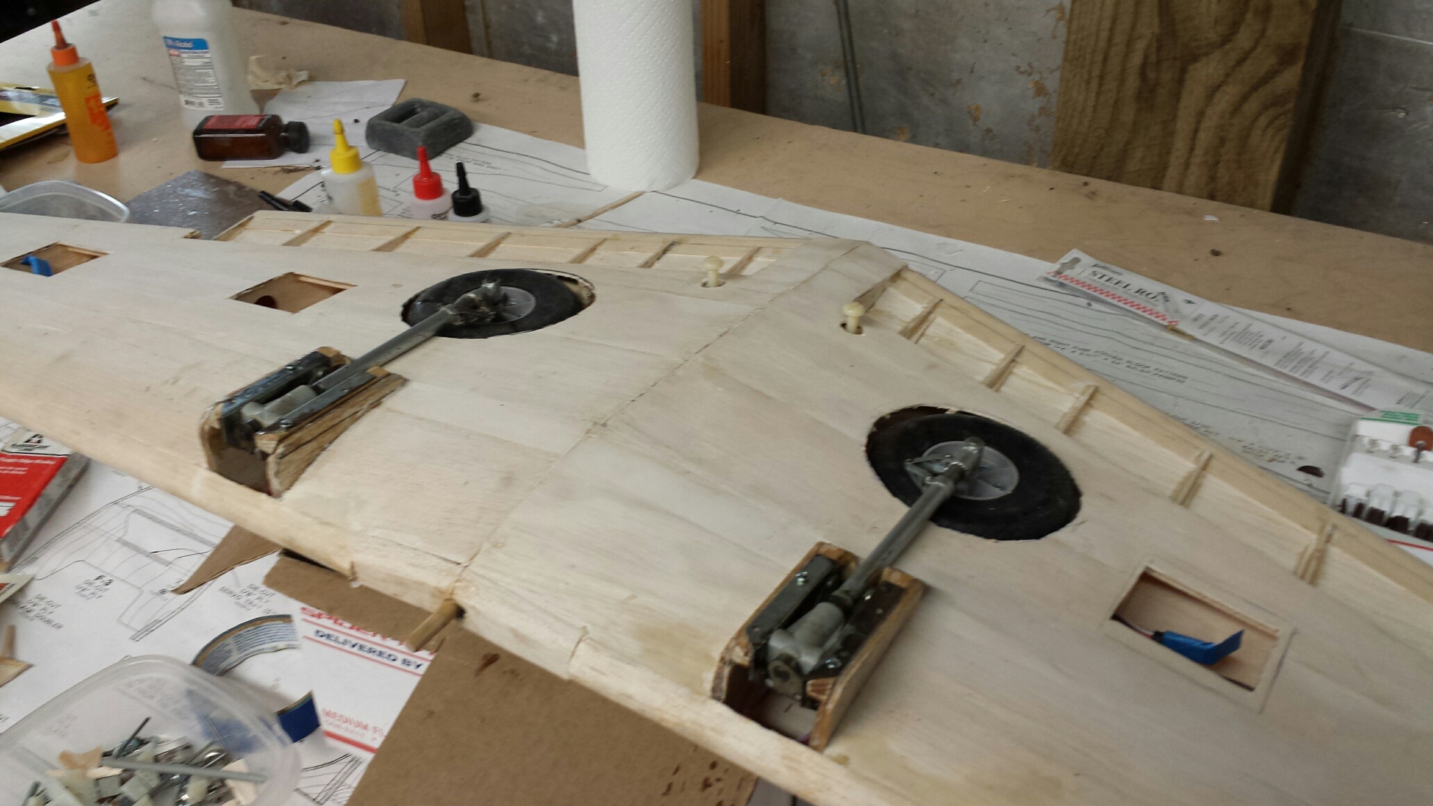

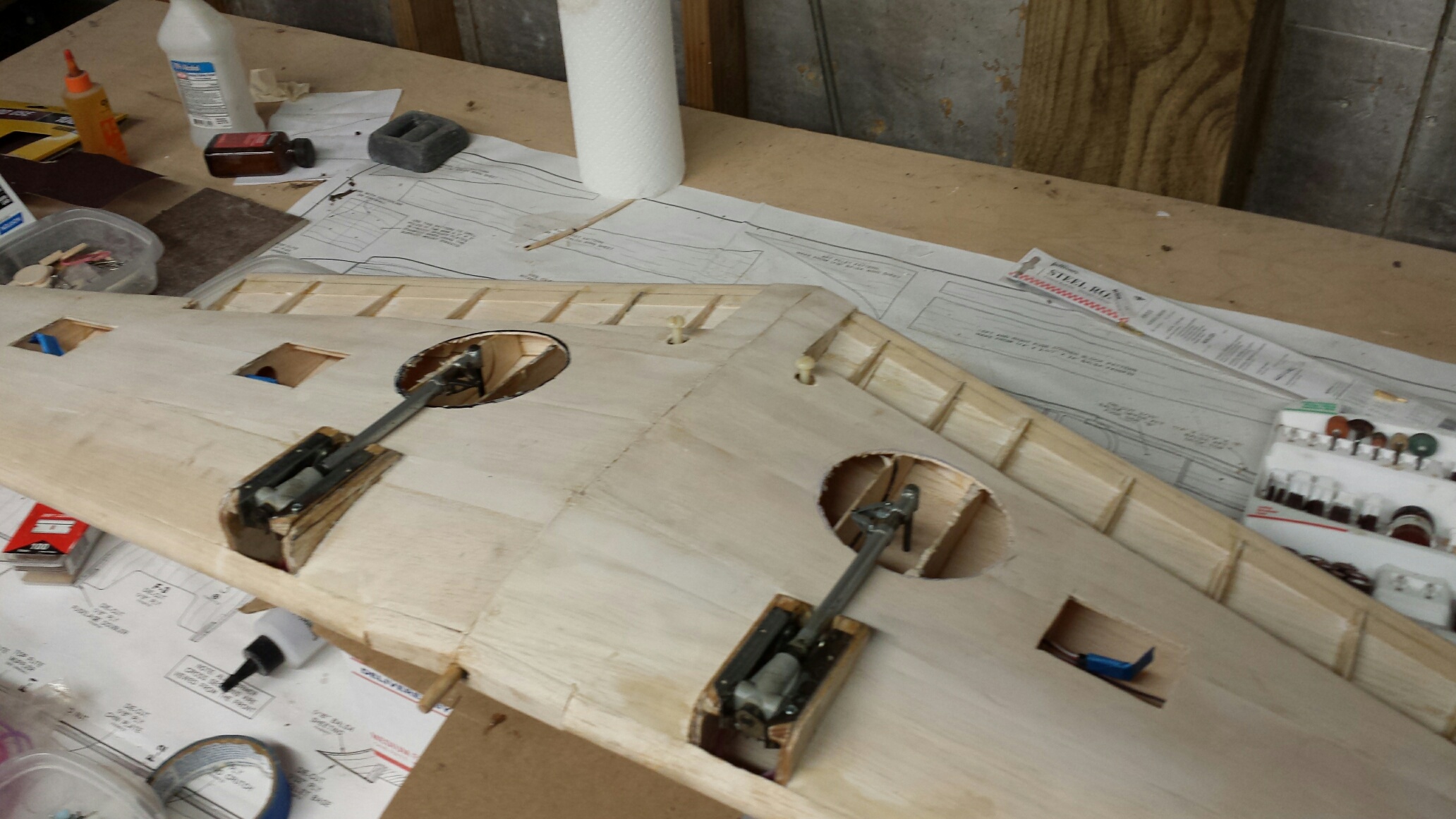

Charles
worked a little more and finished forming in the wheel wells and filling. All that is left is to sand the filler.20141123_180015_resized.jpg20141123_180008_resized.jpg

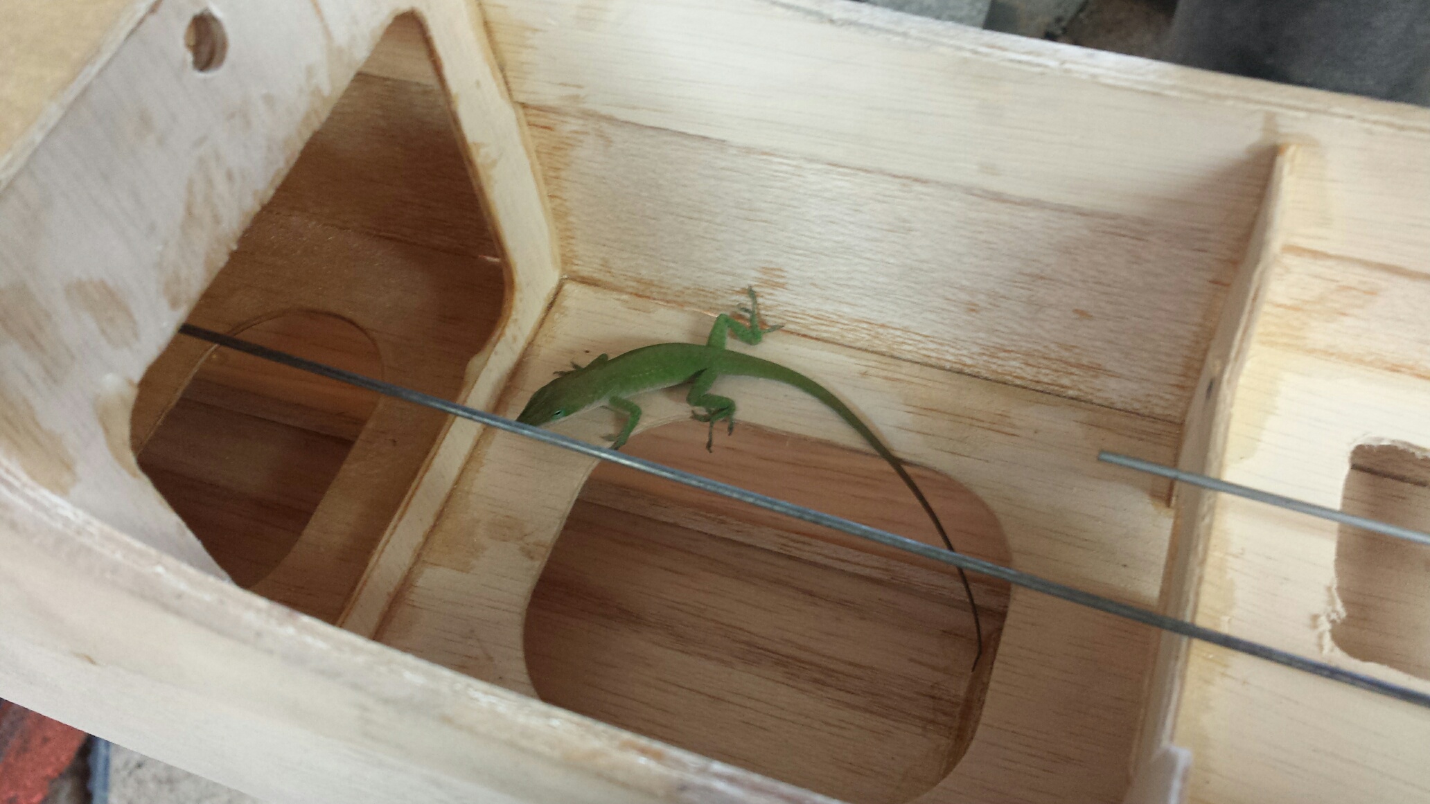

Charles
Check the plane and this little guy has taken up pilot training and his wife was keeping house in a pile of sandpaper in the work table.20141126_120620_resized.jpg
