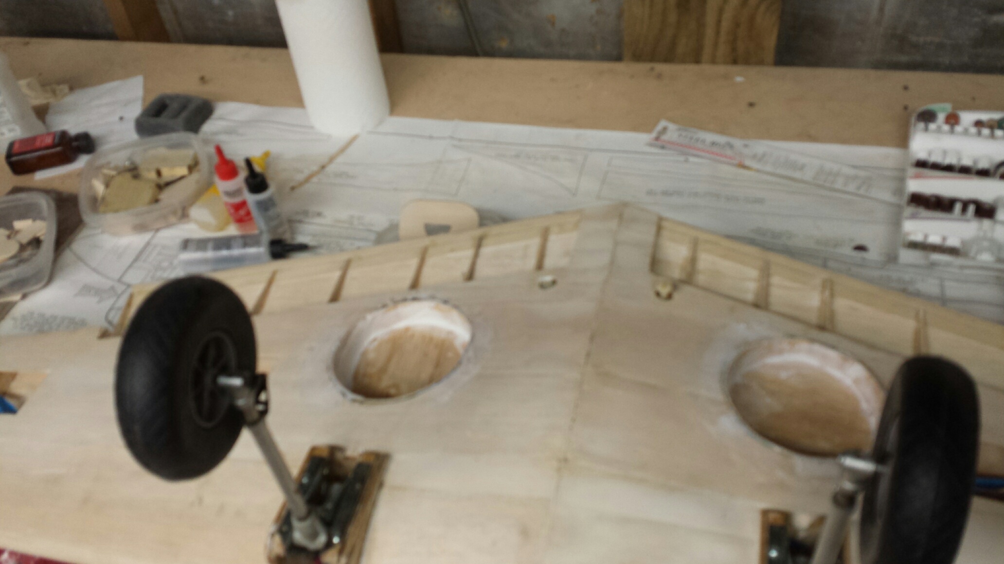

nice work. Are you going to leave the wheel wells open to the ribs like that or are you going to build a wall in the wheel well? I'm leaning towards building the wall to help fuel proof the area as well as add some strength.

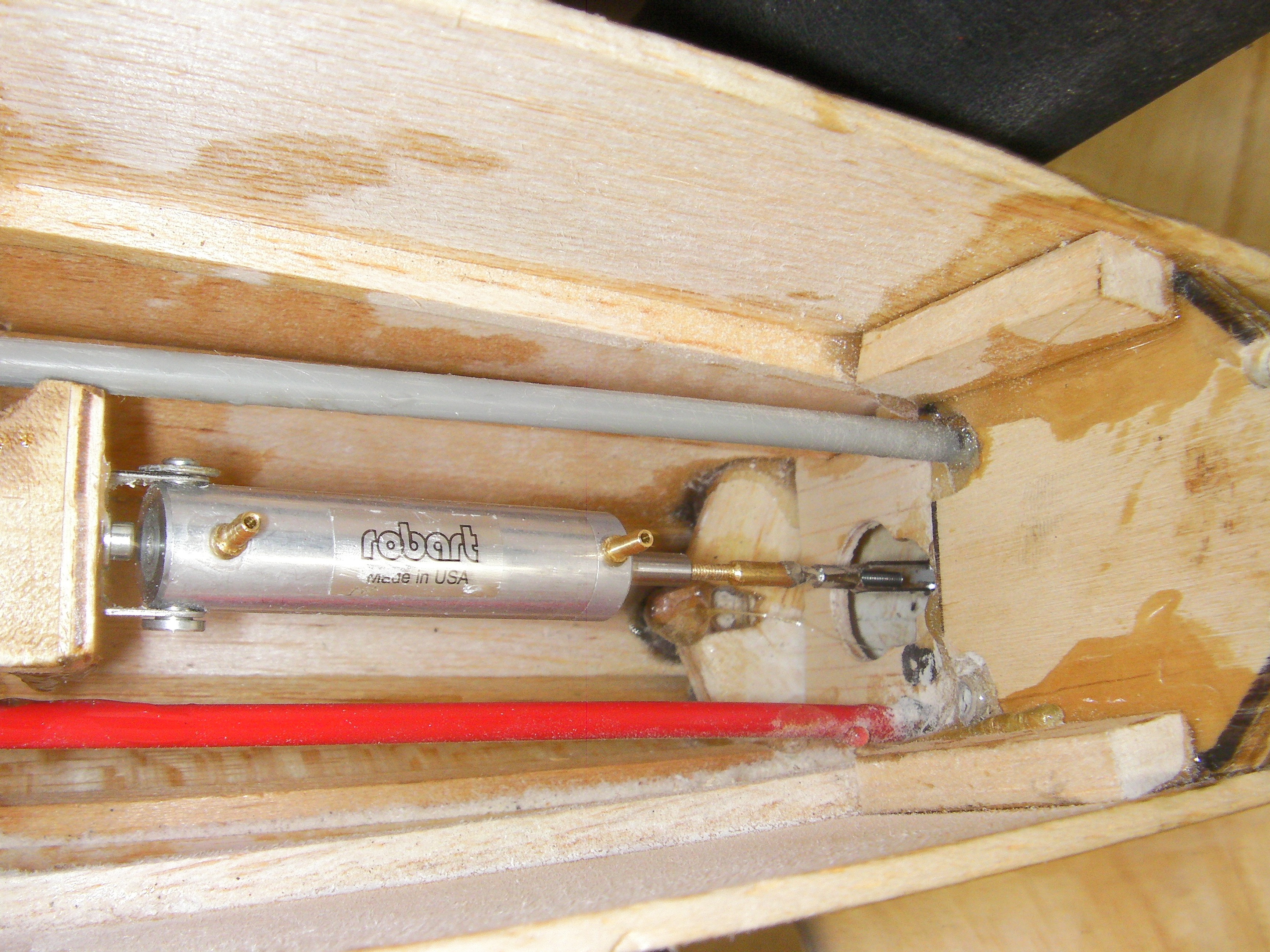

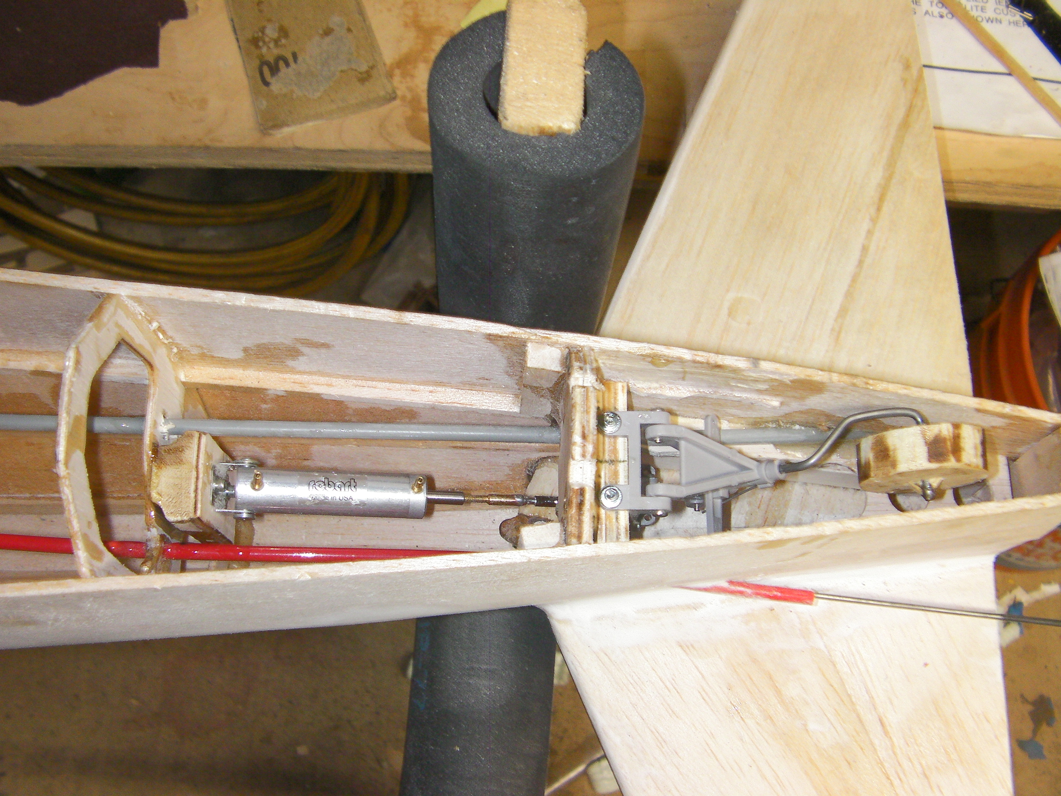

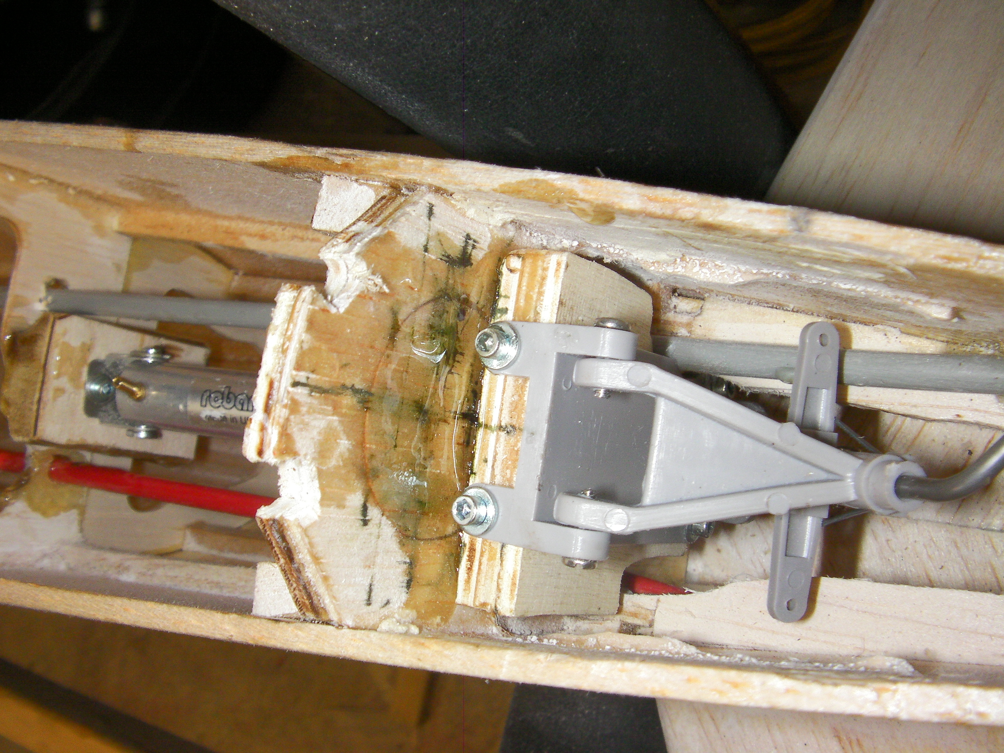

I got the tailwheel installed and then I think i am going to install an extra servo just to operate with a pull pull cable system so when it is up it will put enough slack in the cables to make it inoperatable and then Y the servo to the rudder servo.
